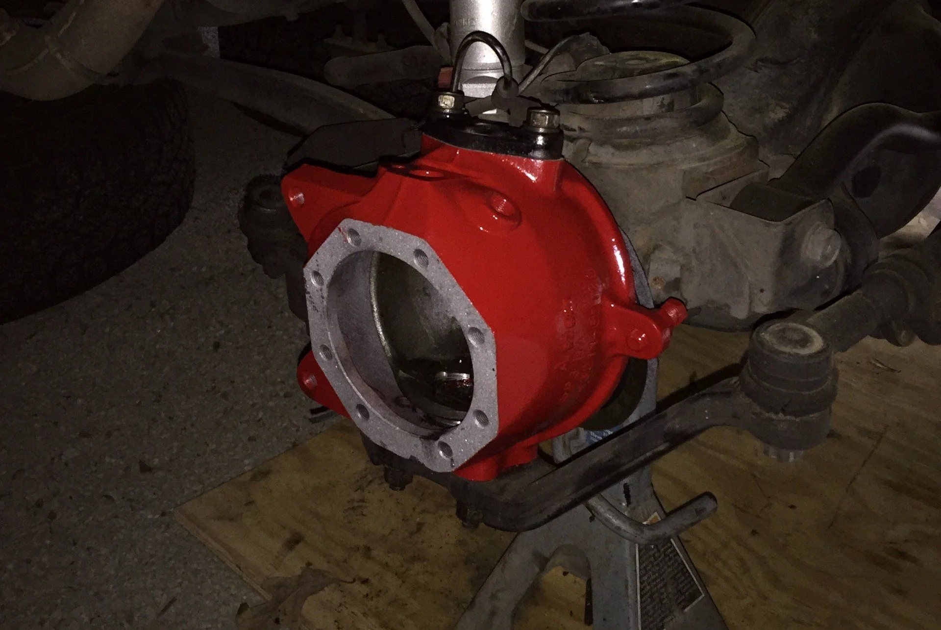

Coming back from Asheville I noticed a small front end vibration on the highway that I could feel through my steering wheel. I parked it when I got home and checked it over the weekend. Driver side failed the 6/12 test. There was more play than a few thousandths. This could also explain why I felt like my rotors needed to be turned. Due to small case of cruiser OCD, I'm going to go through both sides and replace all serviceable parts.
The order was made yesterday. Wheel Bearings, Trunion Bearings, Front axle service kit, a set of ceramic 100 series pads. Also going to have the rotors turned. Anything else I notice will be replaced also.
The disassembly was finished last night.

I picked everything up from being blasted this morning. Going to get a coat of paint on the parts and start the reassembly tonight or tomorrow.
I screwed up and ordered the inner bearings with out the race so it will be Monday before I finish up. :bang:
Update ...Did what I could before dark. Installed the passenger knuckle. I had some Red enamel from another project left over. I don't hate it.

I used O'Toole's Mobile Dustless Blasting It's a husband and wife team that do everything. Turn around times are fast and they have even met me there on Sunday to pick up parts. They did several parts for me when I was rebuilding my CJ axles. My experience has been top notch and I highly recommend them!
