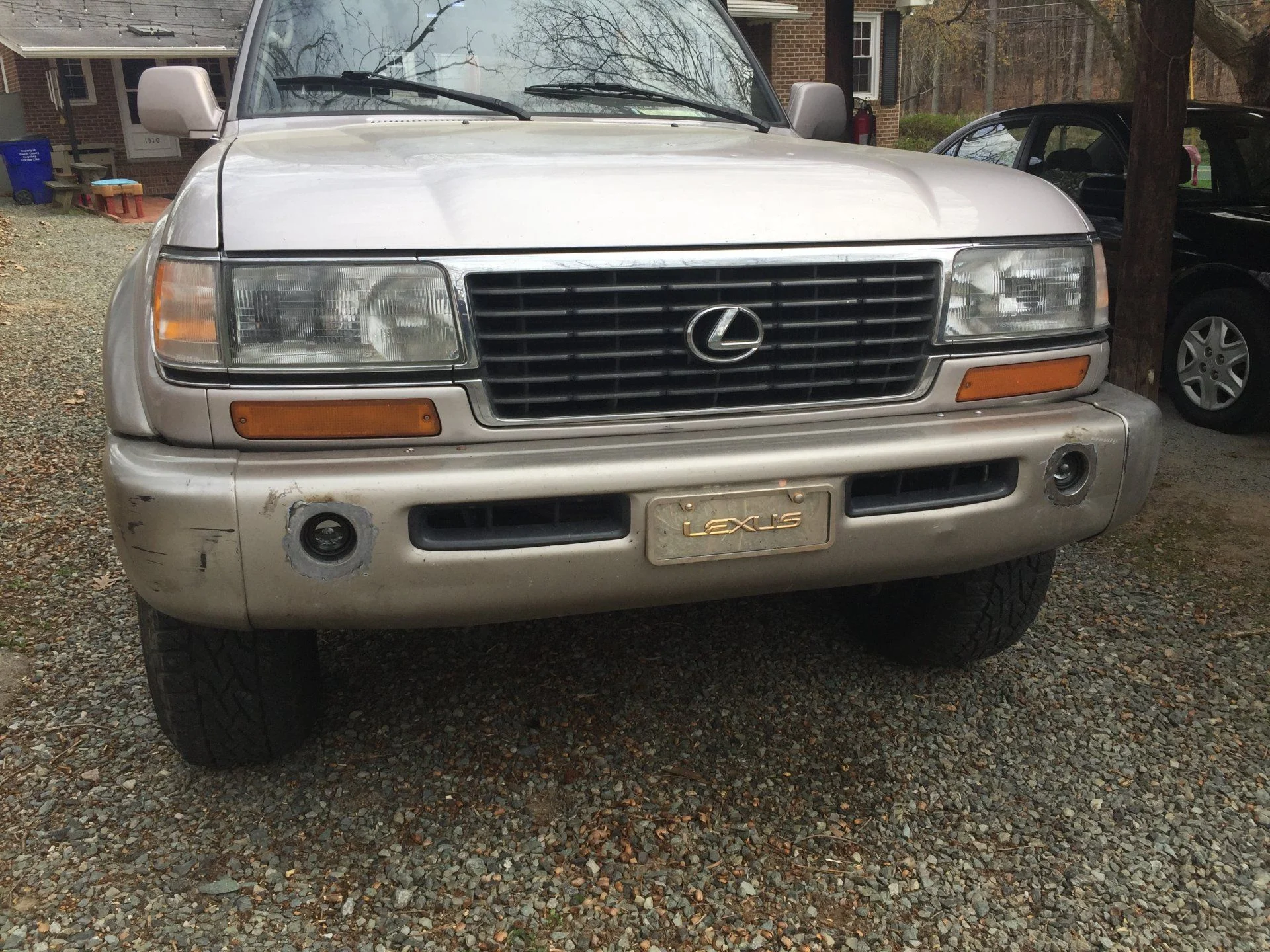

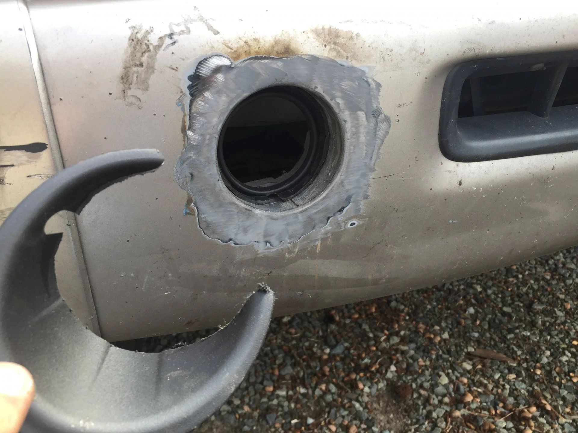

Apparently I was dreaming too. I realized I'm not a rocket scientist and decided to stick with what I know. Went with fog lights instead.
I used 3" exhaust pipe and a fog light kit for 2015 Camaro. Used a little seam sealer I had left from another project to bond the Camaro mounts to exhaust pipe.
Still need to paint the bumper and wire the lights. Im pretty happy with how it came out.

Aren't you one clever, creative son of a gun! I have a vision of doing something similar with my 62....cutting out sections of the front bumper for fog lights vs. mounting them above.
This has turned into quite a project.
Sand. Primer with filler. Sand. Prime. Sand. Glazing Putty. Sand. Another coat of primer and more wet sanding, I think it will be ready for paint.
Update: Sprayed some color. Saw a spot I missed and didnt like how the plastic trim for the projector lens blended into the bumper. Went with a 2.75" round led light instead. After more sanding and primer I finally sprayed the bumper and end caps at lunch today.
I put the bumper back on early this morning. Its amazing how not having scratched corners makes the entire truck look better. Now I realize how bad the rest of the plastic cladding looks. I have a lot of extra paint so I may have to do something about it.

Looks great!! Are they floods or did you have to aim them?
They are floods. Just a pair of amazon Chinese crap I had. I'm on the look out for something of better quality. I liked the look of the larger led lens vs projector.
