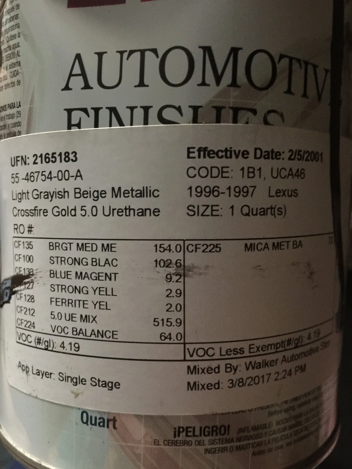

Forgive me if I missed it, but what paint did you use on your bumper? All my Lexus tupperware is pretty beat and I would love to just rattle can it.
Here’s the paint code. I had a local Napa mix it. I bet you could order it in a rattle can.
