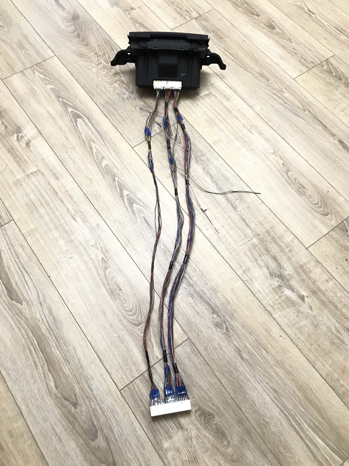

DIY Non-Nav Harness Extension and files for the circuit board and 3D print cover are posted on GXOR FB. I'll try to post it on here soon, but didn't know how to attach the .zip and 3D print files on here or if that was allowed.
Added a link in the DIY writeup for the print circuit board and 3d print cover files
Here's the link to the DIY Non-Nav Harness Extension, I didn't want to hijack this thread anymore than I already had.
DIY Non-Nav Harness Extension - https://forum.ih8mud.com/threads/diy-non-nav-harness-extension.1355429/

    2. Extend the wires (7 required... 1 additional to make life easier)

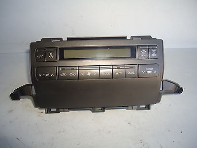

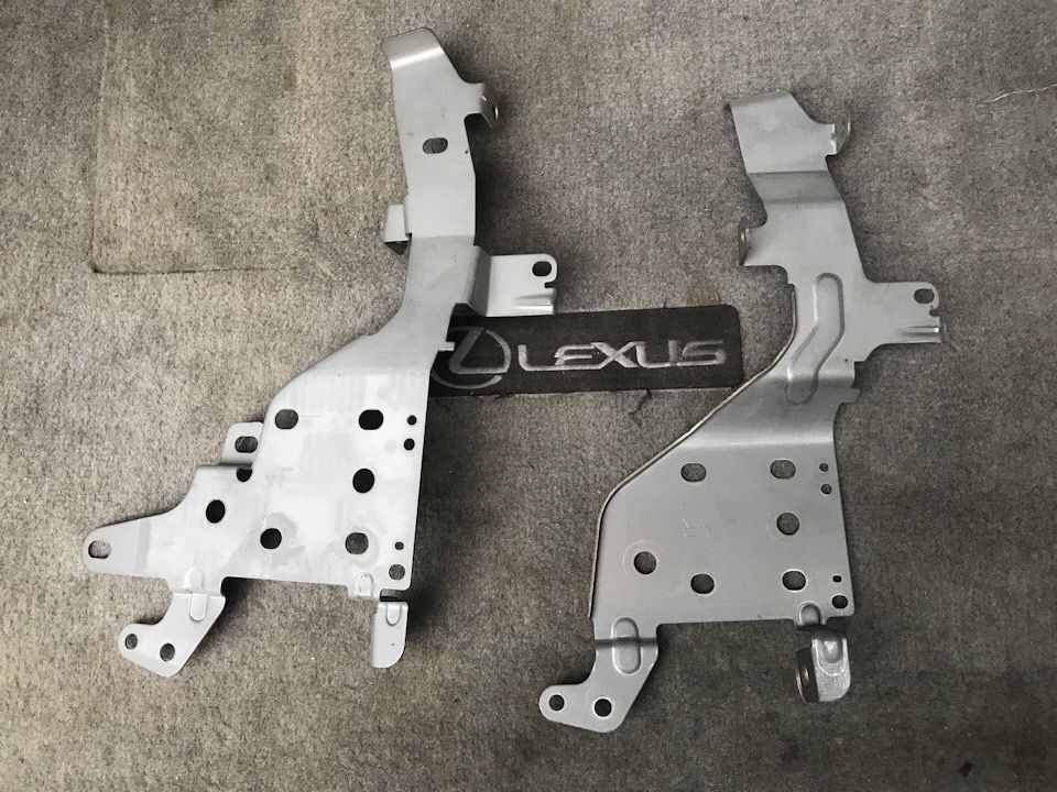

1. OEM Non-nav climate controls, brackets and bezel
- Sourcing these parts can be challenging... I'm in Southern CA and with the help of others, found them at a scrap yard in Texas. It cost me $225 to get the climate controls, bezel and brackets removed from the donor car and shipped to my doorstep.
Below are the OEM Lexus part numbers for the non-nav climate controls, listed by production year... (I lifted this directly from @theferg post below... he is also a great resource for this conversion!). It is essential that you get the right part number, otherwise the controls won't work properly.
88650-60770 (11/2002 - 10/2004) (folks have also seen an 88650-60B50 for these years as well)
88650-60771 (11/2004 - 07/2005)
88650-60772 (08/2005 - 12/2005)
88650-60773 (01/2006 - 07/2009)
You can find your production year in the drivers side door jam label:
(Also note that those with production dates on the switch-over months--ending/beginning months--seem to kind of have a crap-shoot of a time figuring out which one is the actual one since some sites list the production dates slightly differently. This list I posted has been spot for the good handfuls that have done this on GXOR fb page.)

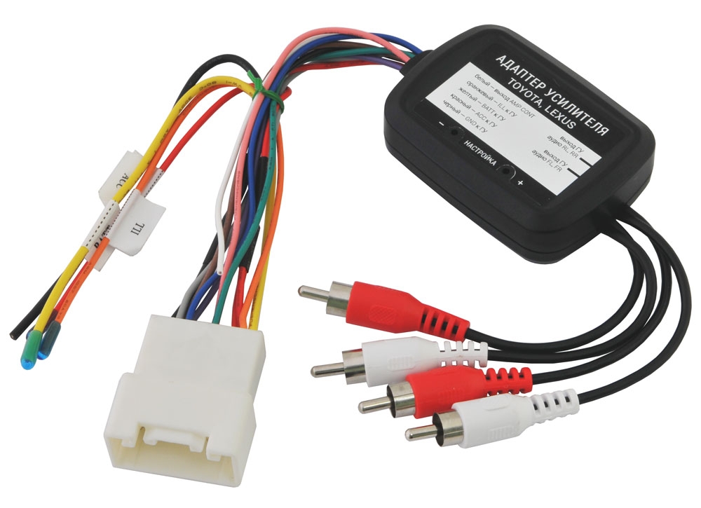

Interesting mod to install aftermarket hu into a factory nav setup. Still requires a bit of work, but you don't need to buy the non-nav components. And doesn't look as clean. But as those other parts get harder to find, this is an alternative option.

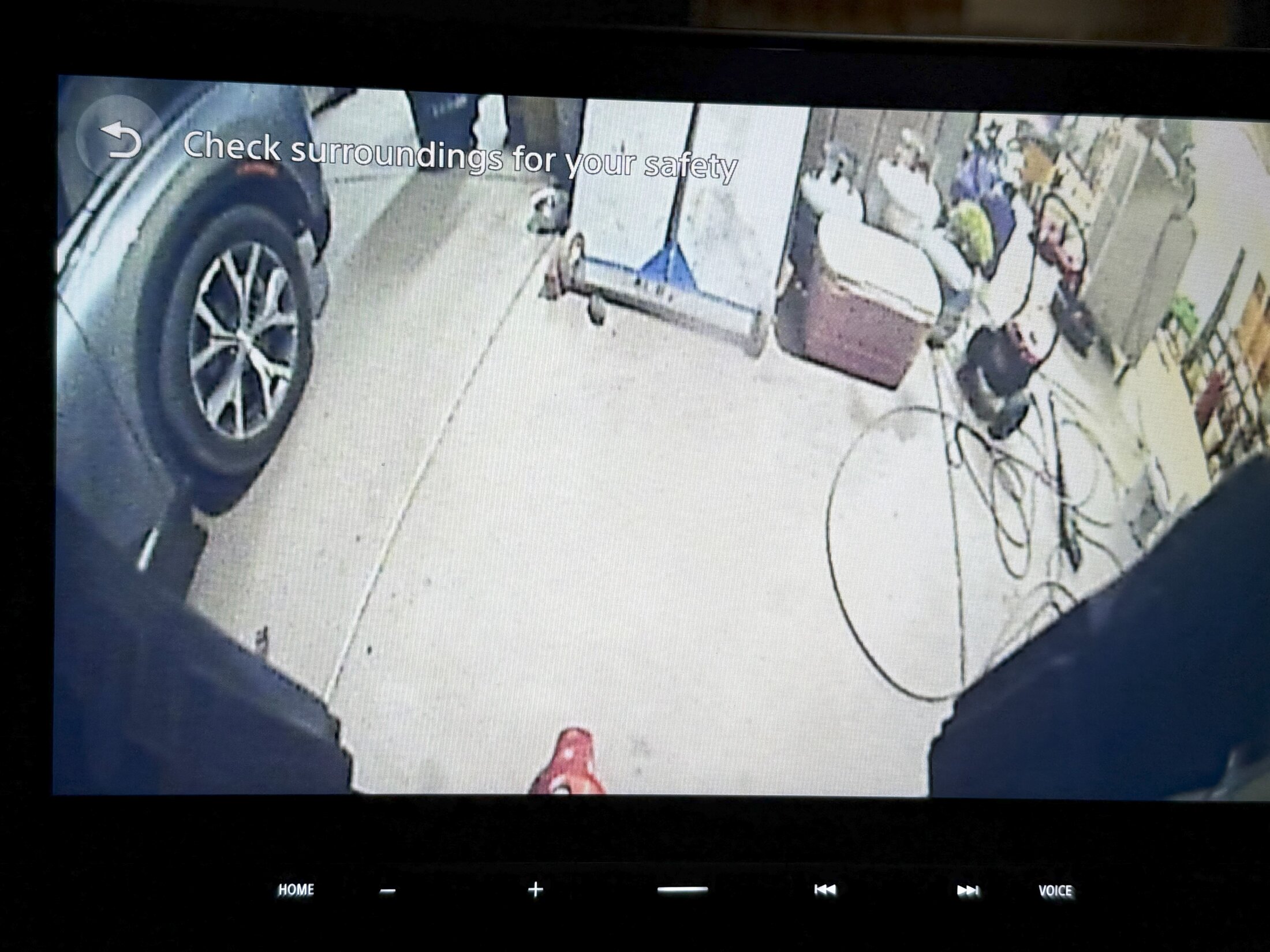

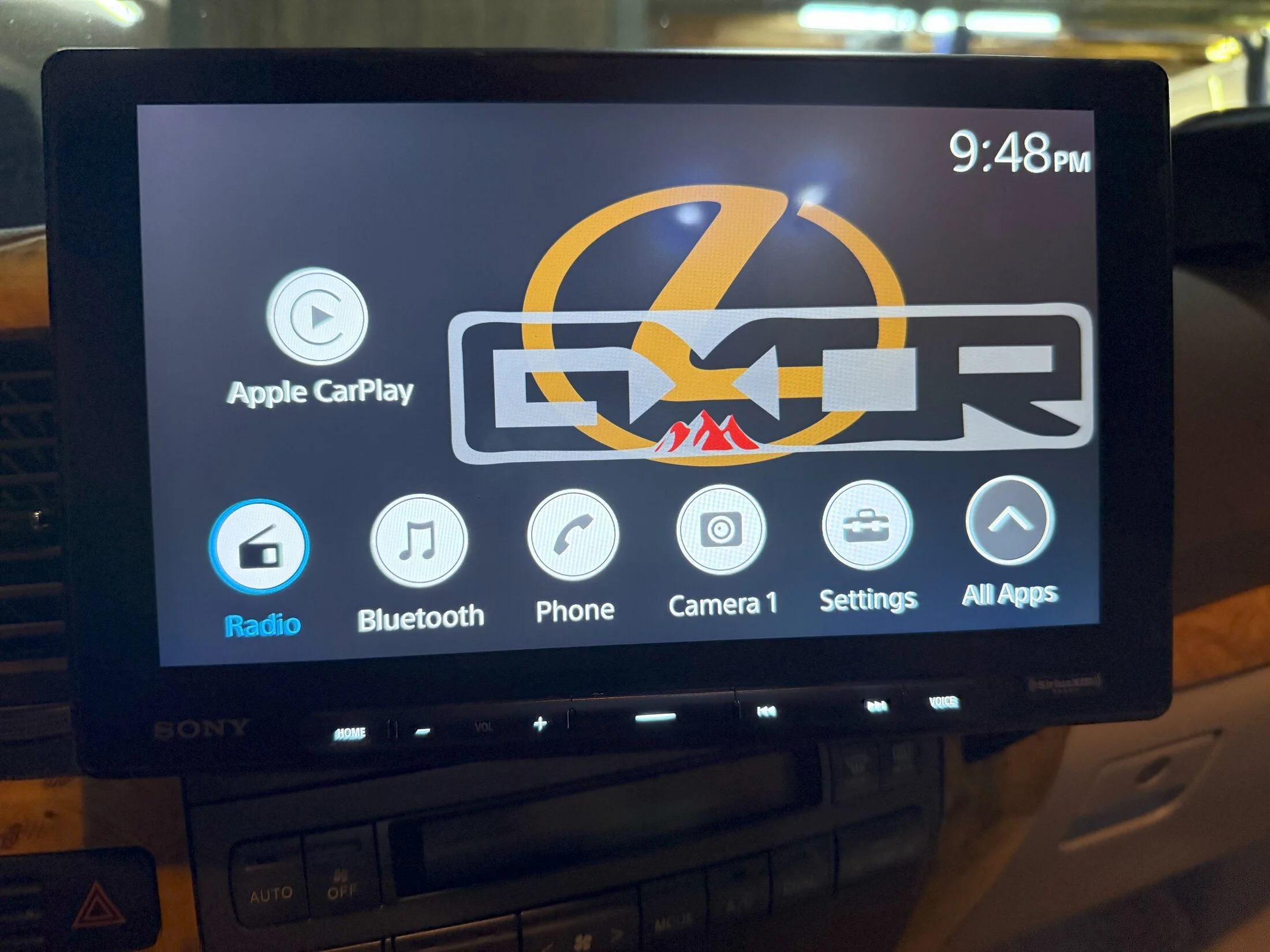

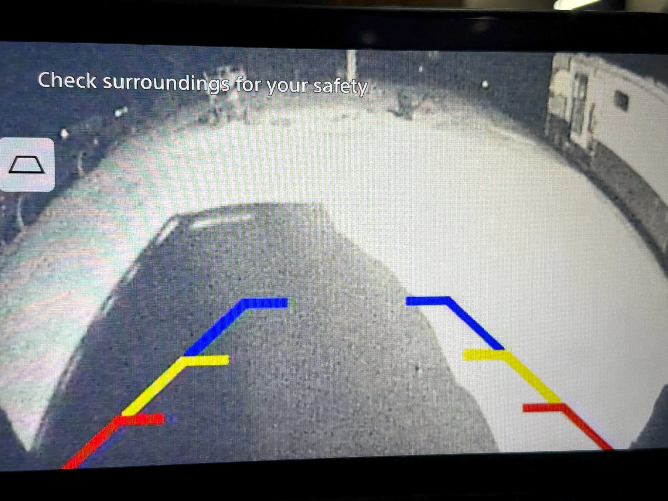

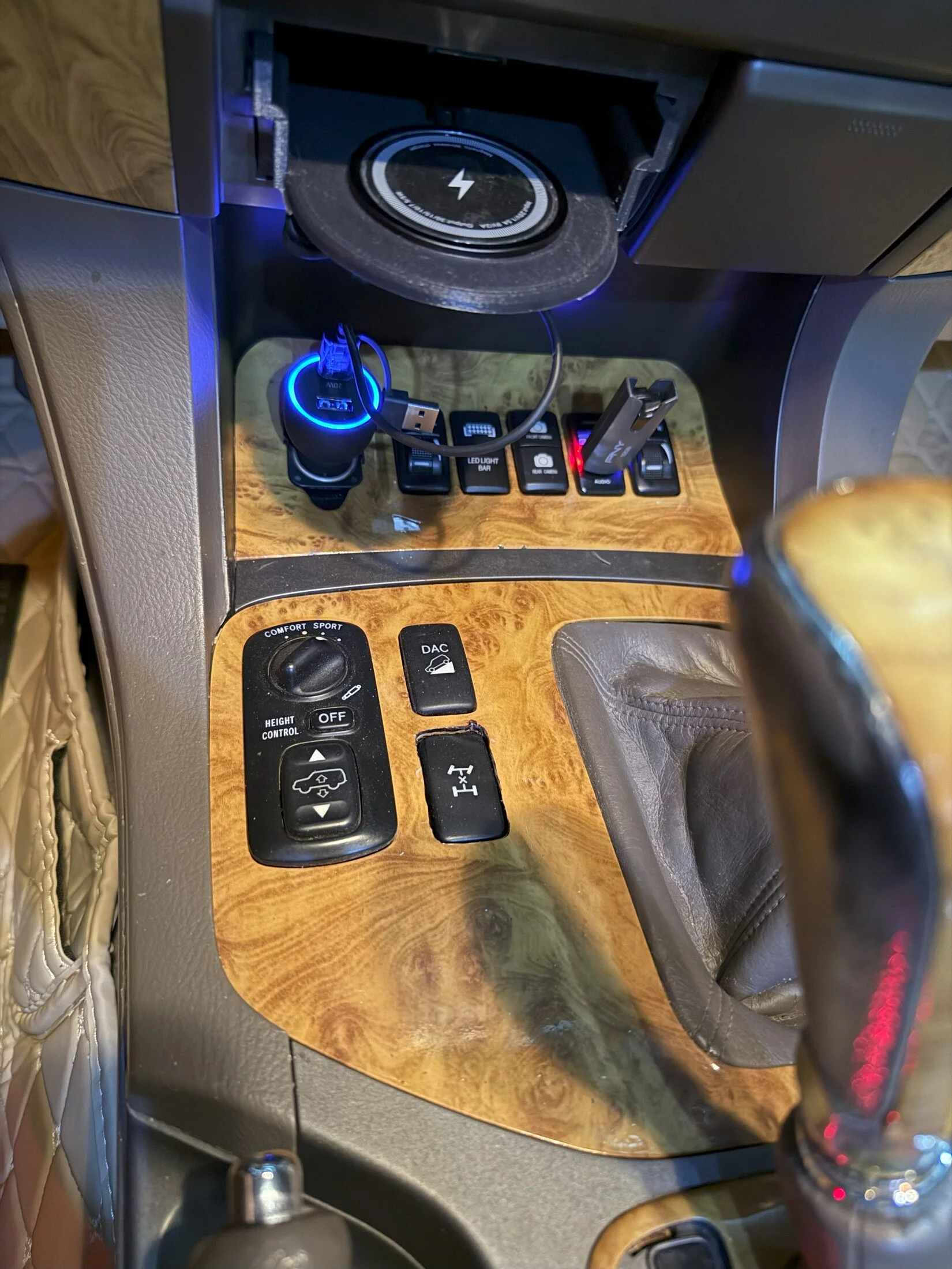

"Feb 14, 2025
Yes! It is possible to install a modern aftermarket radio with wireless Android Auto and Apple Car play in your GX470 with navigation and the Mark Levinson sound system. This was possible thanks to the Beat-Sonic amp interface adapter. MVA-81. I installed a single DIN 10 inch head unit that swivels. The steering wheel controls work too."

Hello to all and to whom ever can help. Thank in advance. Ive been doing my research regarding this conversion and decided to pull the trigger and buy the parts needed to complete this conversion. I have 2009 GX 470. I am planning to pull the connectors and extend on the 7 to 8 wires route. since logistically make senses to me, that to build my one Harness. I am not a wiring guru and my question is, what size gauge wire should I use for he the extension? and do I still need to make the pigtail to the cigarette lighter for illumination? I would like feed back from anyone who has gone this route.
20 to 24 AWG wire should work, and you would need to make the pigtail to the cigarette lighter for the controls to illuminate with the headlights. Congrats on finding the unobtanium '09 non-nav controls. Good luck with the swap, just take your time and test the hvac controls before you button everything up.
