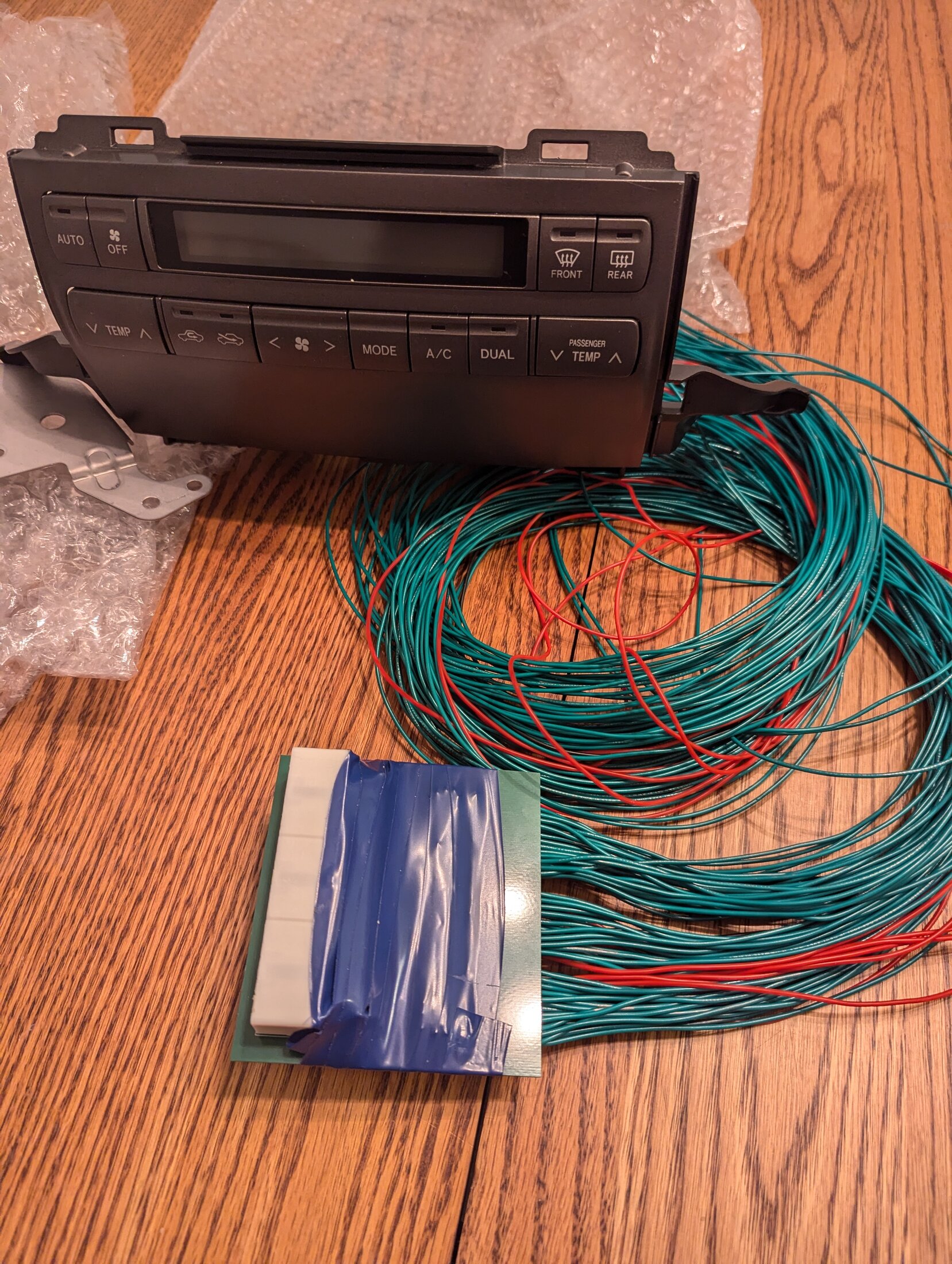

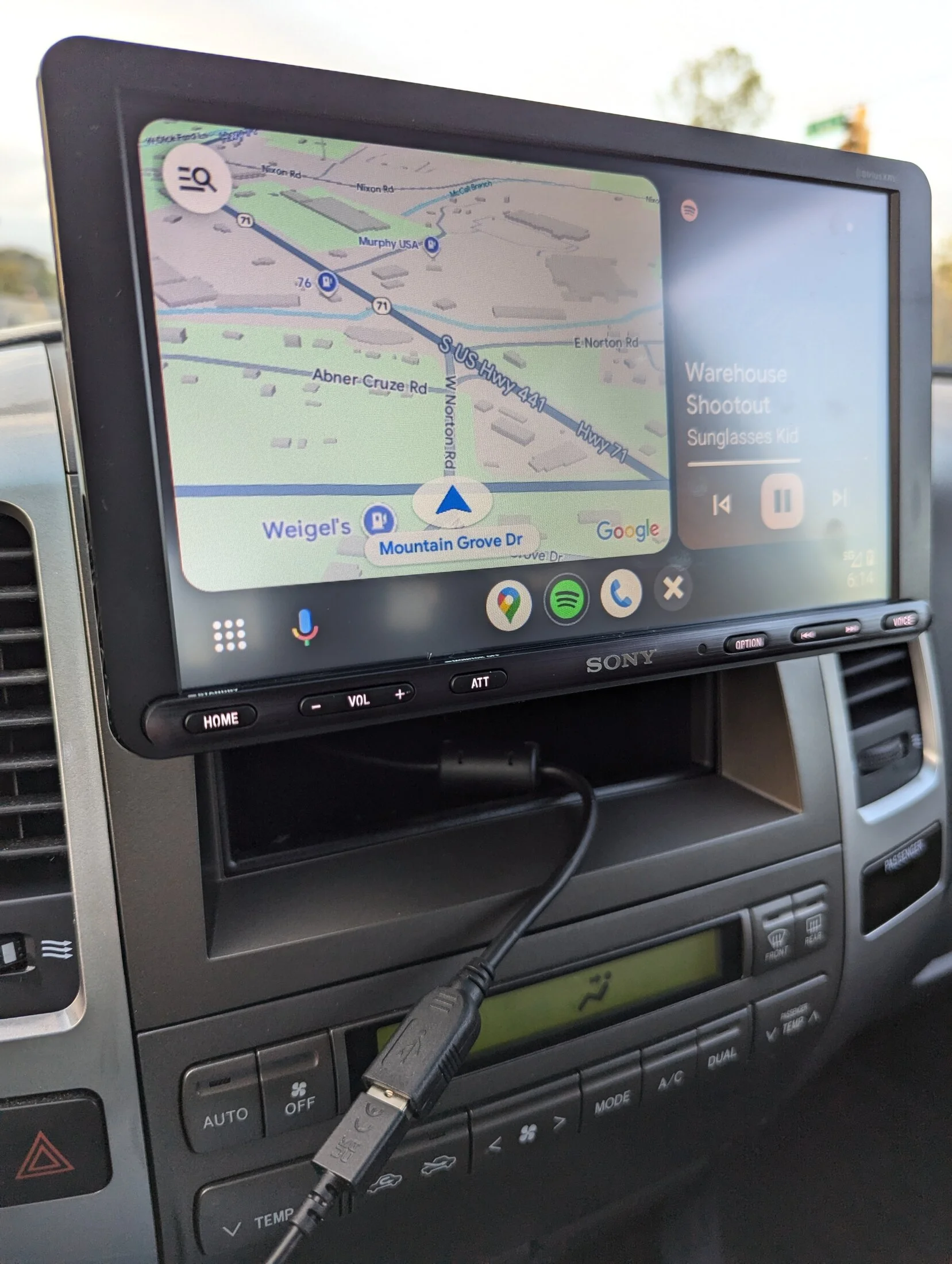

Finally did the thing!, still sorting out the heat on the drivers side only. Have a friend who figured out the part numbers for the the factory plugs and connectors and made a circuit board for easier soldering (might look at 3d printing an enclosure and trimming the circuit board for a cleaner install). Still R&D'ing it, but I preferred this route instead of cutting the factory harness. I know it looks a little messy, I loomed the wires as I fed them through the dash. Shoutout to The Sound Factory in Knoxville for the clean install of the stereo and running the wires for the new backup camera, and even ran the mic up by the rear view mirror.
Parts list:
Metra 70-8114 Steering Wheel Control Harness
Metra 88-00-9000 Dash Kit (black, has pockets)
Metra 95-8166G Dash Kit (gray, pretty much perfectly matches the gray on the HVAC controls)
Axxess ASWC-1 Steering Wheel Control Adapter
Axxess TYTO-01 Wiring Interface
RS-LP1 backup camera, mounted to license plate bracket
non-nav HVAC harness extension - might offer as a plug'n'play kit if my friend and I can get mine sorted out, let me know if there's any interest in that
Sony XAV-AX8100

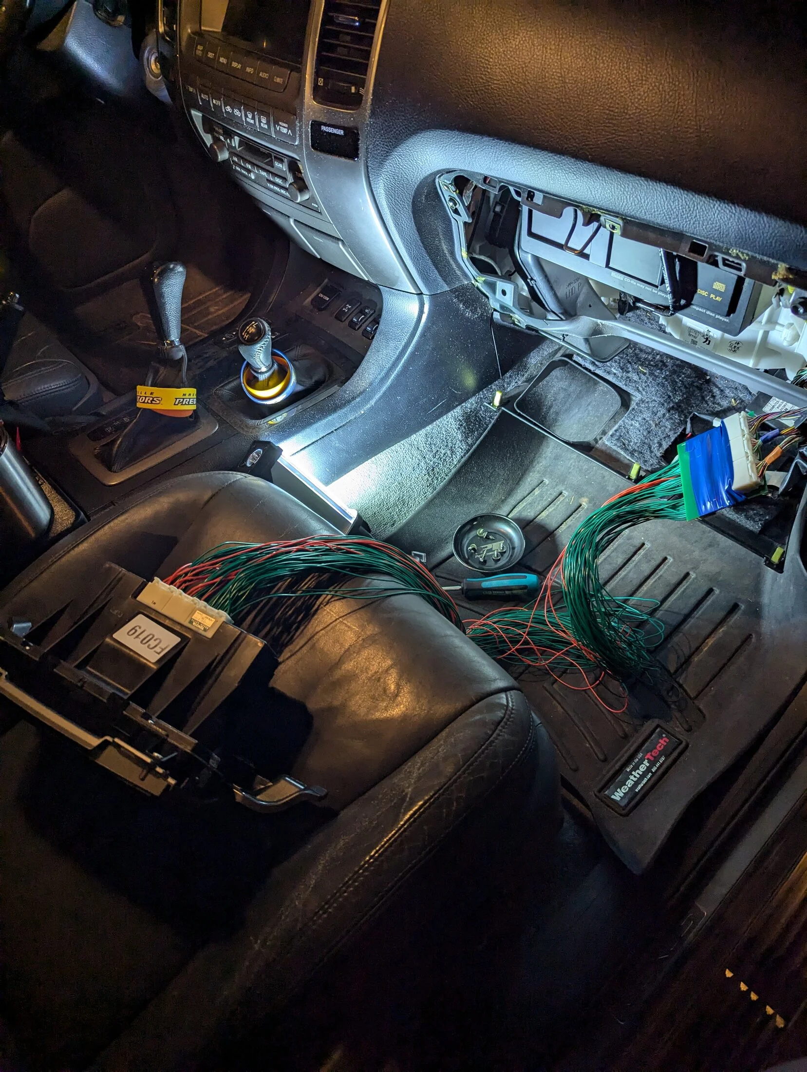

My friend who built the harness extension and I did a lot of troubleshooting last night in addition to getting the buttons illuminated with a disconnect plug.
Took it all apart and plugged in the old nav system and air worked fine on both sides, ice cold. So think that may rule out the blend door actuator.
Inspected the circuit board and connectors on the harness extension, plugged back into the non nav controls and back to hot air on driver side. Unplugged the stereo and everything from the center stack and plugged the non nav controls to the factory harness in the passenger footwell and same result, hot air on driver.
That leads me to believe that it might be the non nav controls themselves. Didn't realize my GX was a carryover month (11/04 build), so I guess only thing left to try is to source a older part number non-nav controls and see if it works. Unless anyone else knows of something to try.
It's almost like the current non nav controls are not getting enough or the right signal to shift the blend door down to cold air because when we switched from the old nav controls that blew cold air back to the non nav controls, it wasn't as hot on the driver side.
