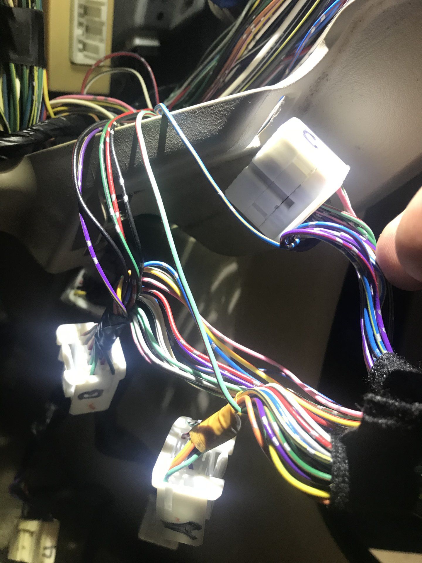

Here is a close up view of the 7 wires (going up) that need to be extended on my ‘04.
I am going to try to run a CAT5 cable and use 7 of the 8 strands inside.
FWIW, I ended up extending 8 wires. There is another one that comes from up higher--around middle of the passenger airbag area--that was just super-duper tight when I got these other 7 extended. So I went ahead and extended that 8th wire a bit and it helped make it feel not quite so stretched. But I still felt like there were a few more wires that really kept it pretty tight. The perfect solution for this would be a custom harness. I've been thinking about making one. It would make this swap incredibly easy.
