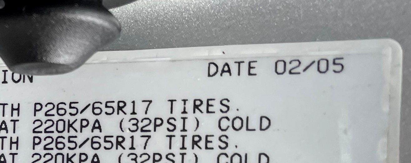

For my production year 2/05 it says to use 88650-60771 as the non nav replacement for the climate controls. Took me awhile and I found it, went to do the swap and the male to female parts don't seem to match at all. I'm terrible with electronics, but can generally follow guides. The second picture at the top is the non nav portion for conversion, and the bottom is the who nav piece that I'm taking out. What am I missing? Any help would be greatly appreciated as I'm kinda in the dark here

For my production year 2/05 it says to use 88650-60771 as the non nav replacement for the climate controls. Took me awhile and I found it, went to do the swap and the male to female parts don't seem to match at all. I'm terrible with electronics, but can generally follow guides. The second picture at the top is the non nav portion for conversion, and the bottom is the who nav piece that I'm taking out. What am I missing? Any help would be greatly appreciated as I'm kinda in the dark here View attachment 2745798

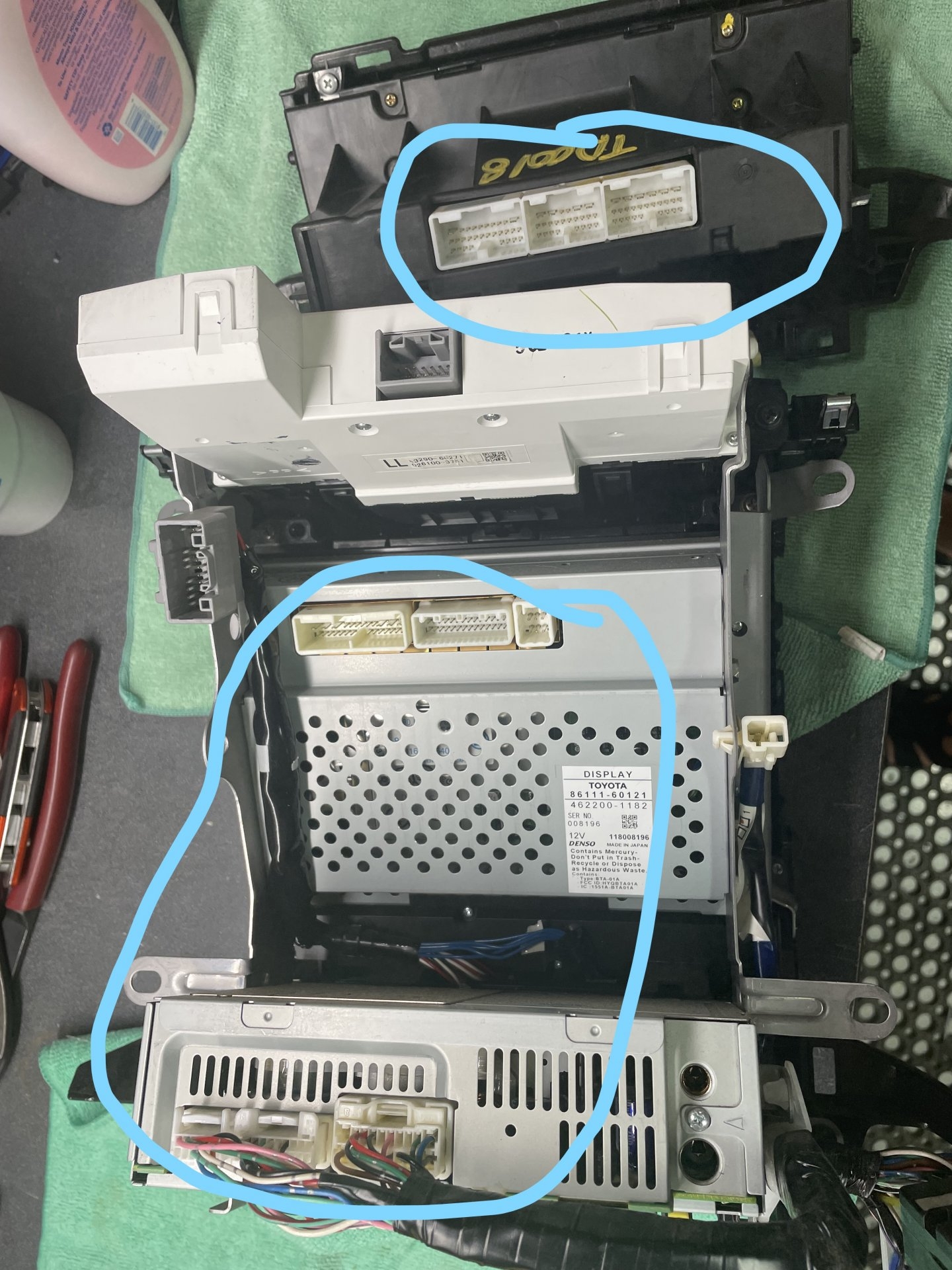

The correct plugs for the non-nagivation climate control are somewhere else entirely. On navigation models, the A/C is controlled by a computer on the right side of the passenger foot well. You have to remove your glove box, and relocate the three plugs from there all the way over to the center console to plug into the non-navigation climate control unit.
