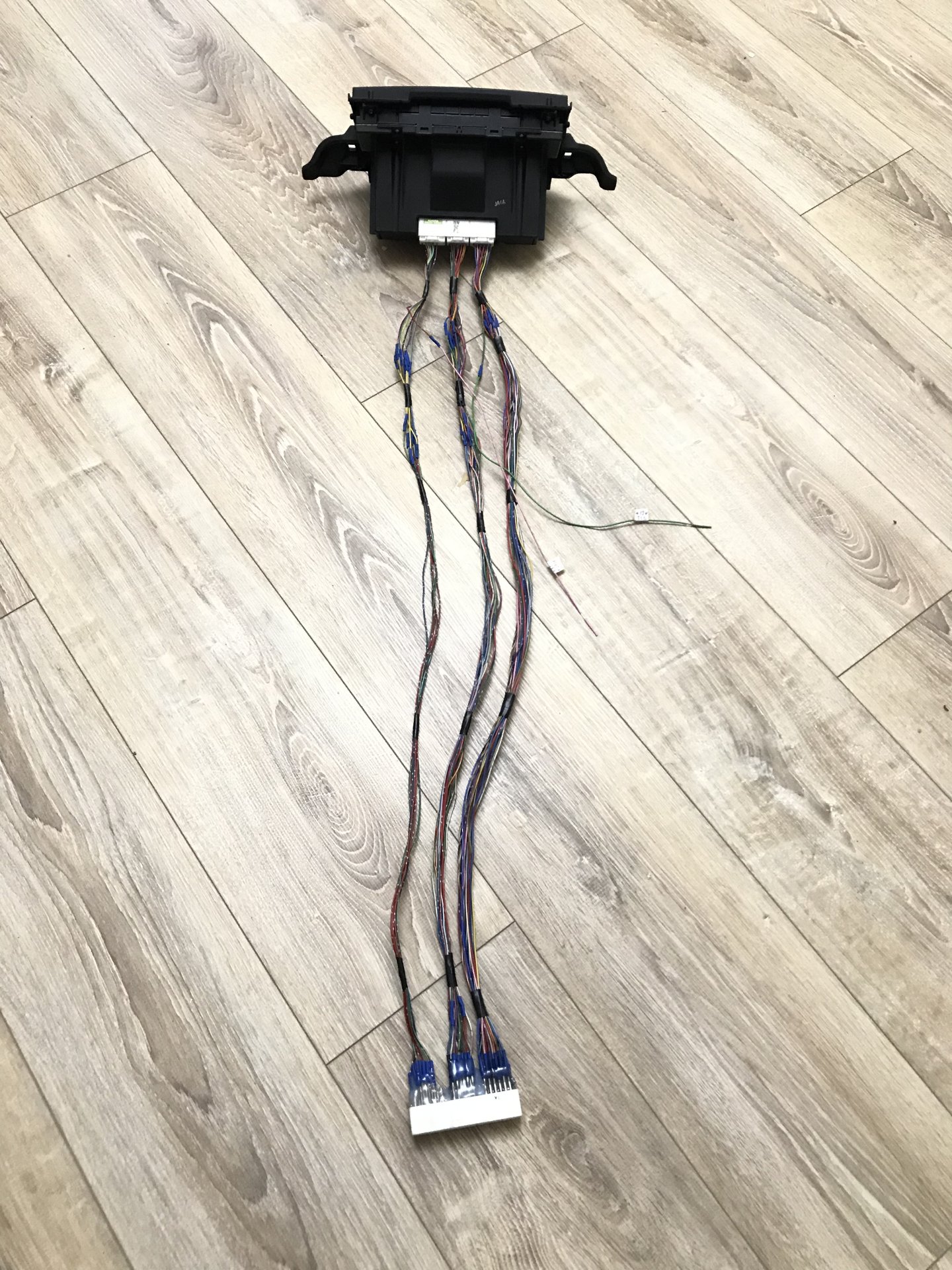

if anyone needs climate control for the GX470 2003-2004, I can sell it for $270 with brackets for the radio, plus shipping.
I can also make the extension wiring plug and play 50$.
I have the controls and brackets, but I’m very interested in buying this harness. If I buy this harness, do I still need to cut and extend the 8 wires, or is it just plugging things into the harness?
you just need to connect, only two wires for the illumination of the buttons need to be connected.

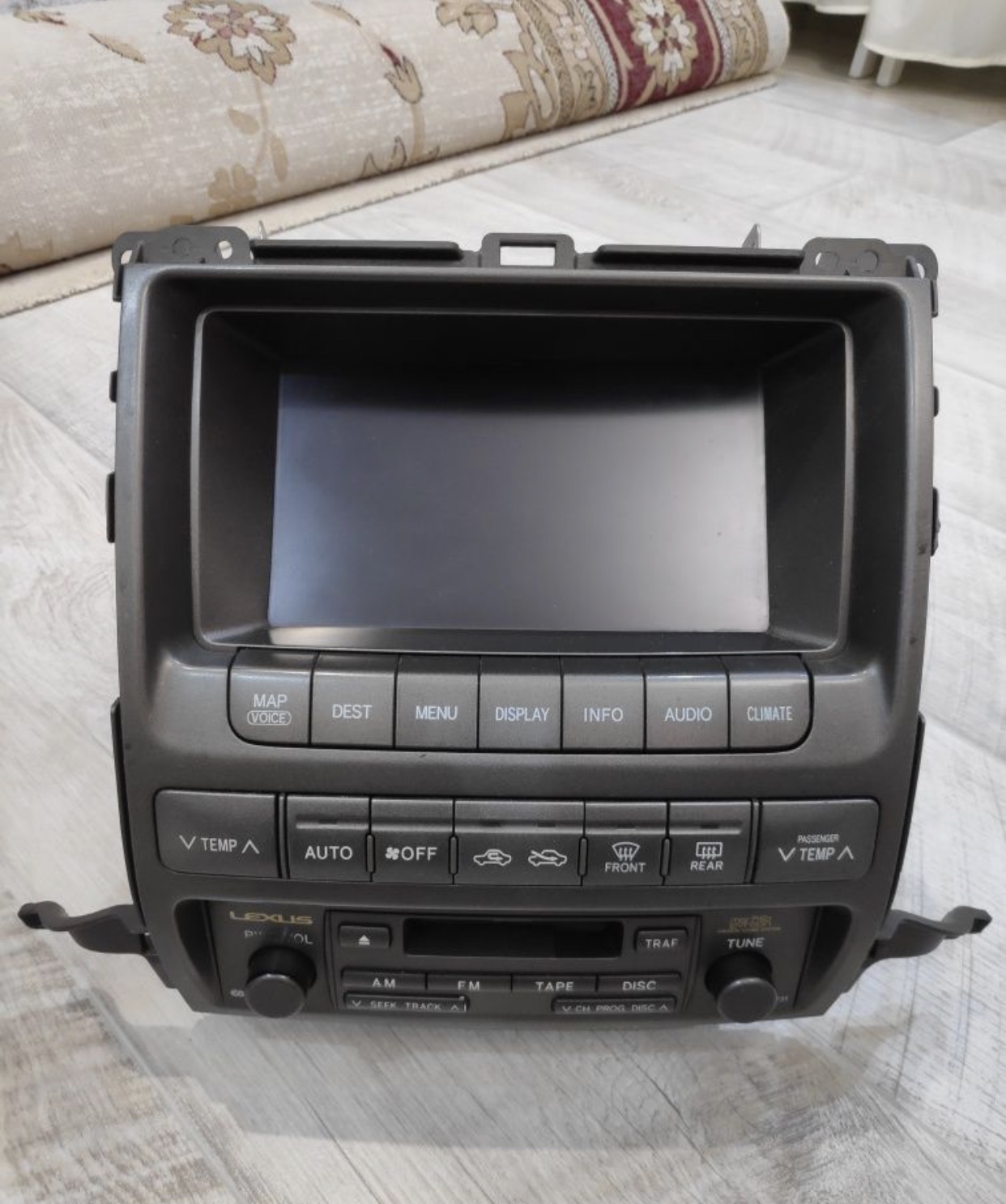

The part numbers 60771, 60772, 60773 etc are just the board portion of the assembly. When you punch it into the Lexus part sites yes your just pulling up that back half of the assembly. They just reference those numbers in these write ups because you typically buy the whole assembly used and that # is what is specifically compatible for your year. The full assembly with the circuit board/amplifier, as well as plastic face plate and buttons/etc is around $1200 brand new. The amplifier is usually only $~600 ish.
Am I right in thinking this is every thing (amplifier, HVAC controls/LCD, buttons), not including the trim/brackets: 2005-2009 Lexus GX470 Dash Control Unit 55900-60833 | Longo Lexus - https://parts.longolexus.com/oem-parts/lexus-dash-control-unit-5590060833? From the parts diagram, it looks like this includes the amplifier as well. Was having trouble finding just the front controls separate from the amplifier. $1400...:frown:
Yeah that looks like the entire assembly. You can see why people scour for the used ones . Took me a year to find one for my 2005 just randomly browsing eBay. They are becoming increasingly unobtainium due to the surge in GX470 buyers.

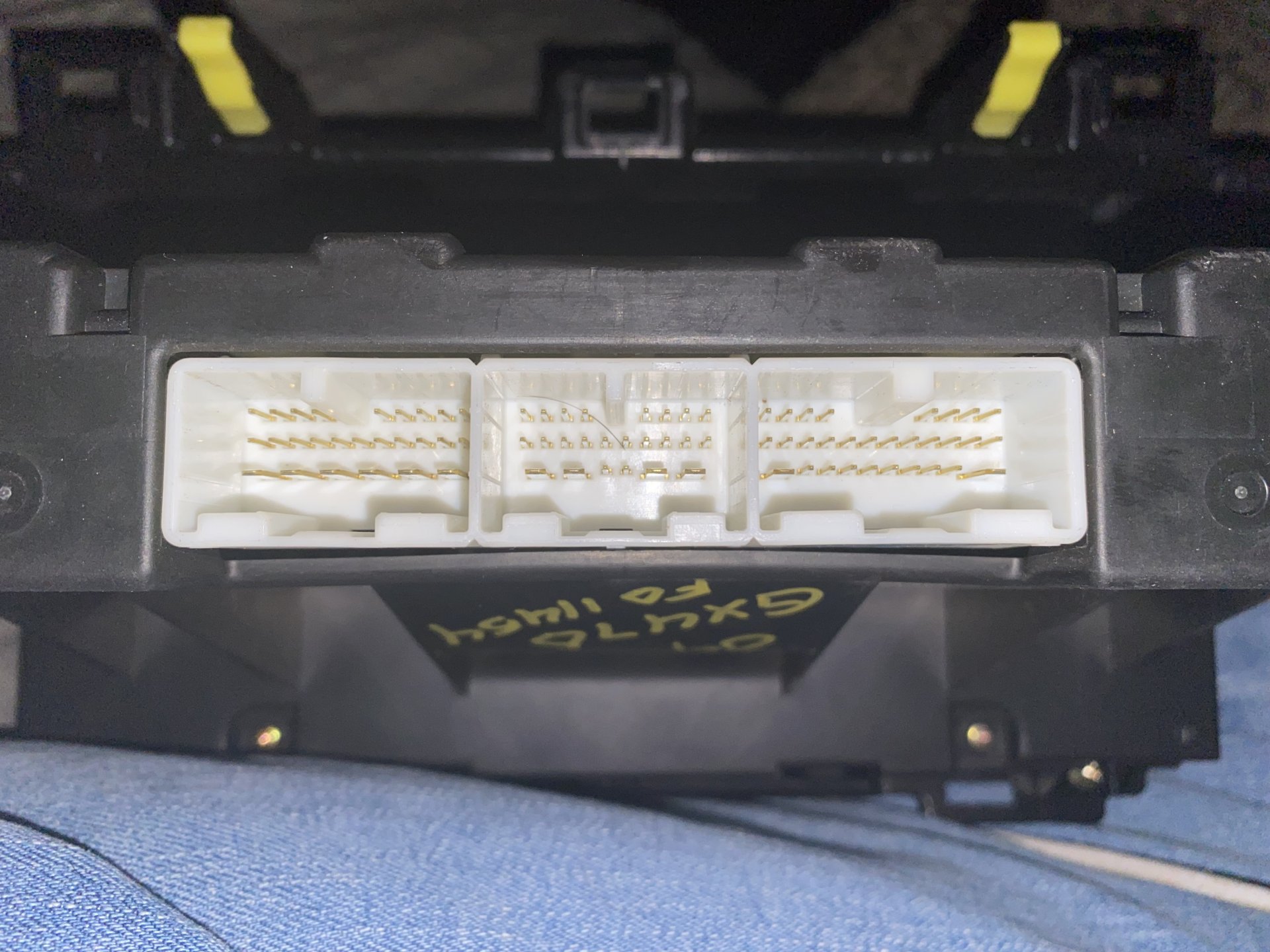

Does anyone know the part number or the type of plug for the 3 female plugs on the back of the HVAC panel, and the corresponding male plugs?
the female ones are labeled A13, A14, and A15 in the temp illumination wiring diagram in this thread, but I don’t think those are meaningful part numbers. A couple hours of searching google hasn’t yielded any results.
the female connector is not sold in the free market, you need to buy an original electronic unit like this and take the female connector from it. this is exactly what I do when making a harness for a climate control swap.
