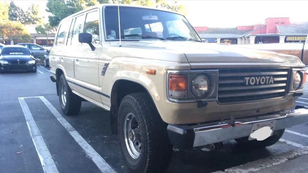

I’ve been looking across California for our first FJ60 for quite awhile now. Finally found the one for us. Tan 87, 233k miles. It was purchased and spent most of its life here in San Jose, only migrating less than 100 miles north before I brought her home.
Good visual bones/virtually no rust but needs some mechanical attention. As background, I’ve done pretty significant engine work on old Fords and rebuilt the top end of a Disco II. I hope to do most if not all of the restore work myself (along with my 17 yr old son) But, wrenching a Toyota is new to us, as is significant suspension and transmission work.
It’ll be used as our occasional driver at our new home in the Sierra mountains. I hope it will get us into many fish, birds and adventures.
Not sure how often I’ll be able to update, but, thought I should capture the trials and tribulations anyways. Thanks for the wonderful resource here!

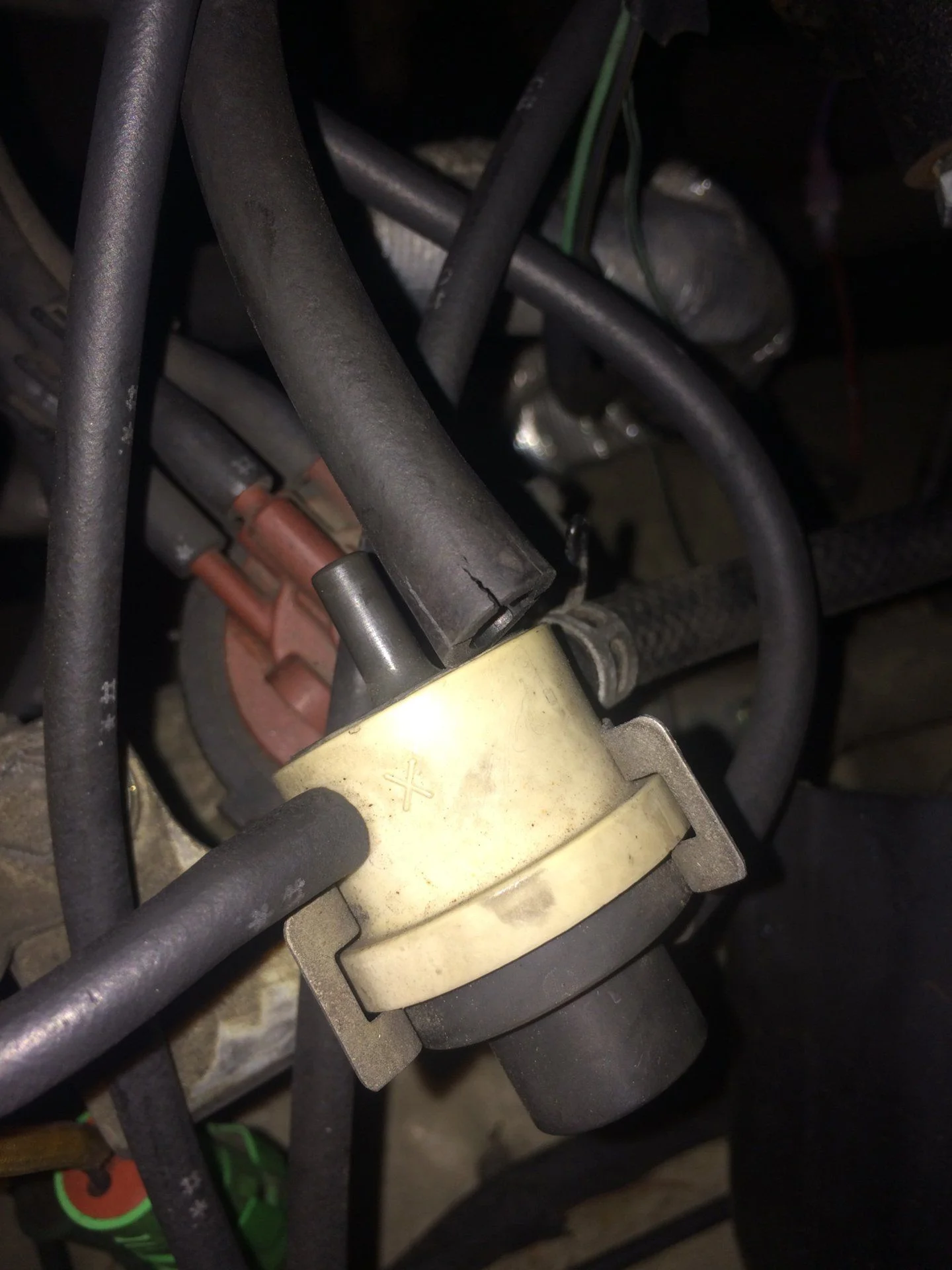

Also, the idle was a little low and chunky. After staring at the pile of spaghetti on this Toyota piece of engineering magic for a good 20 minutes I finally heard, then saw, the source.
Plugged it back on and it fixed the problem.

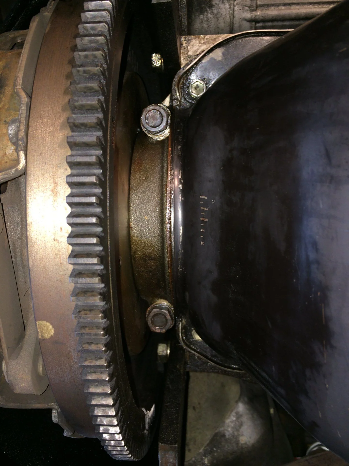

A quick post about leaks:
The source of the leak coming from the transmission dust cover appears to be the rear of the oil pan gasket. Actually, the whole gasket is leaking but an active drip here. Would this also potentially indicate a rear main seal?

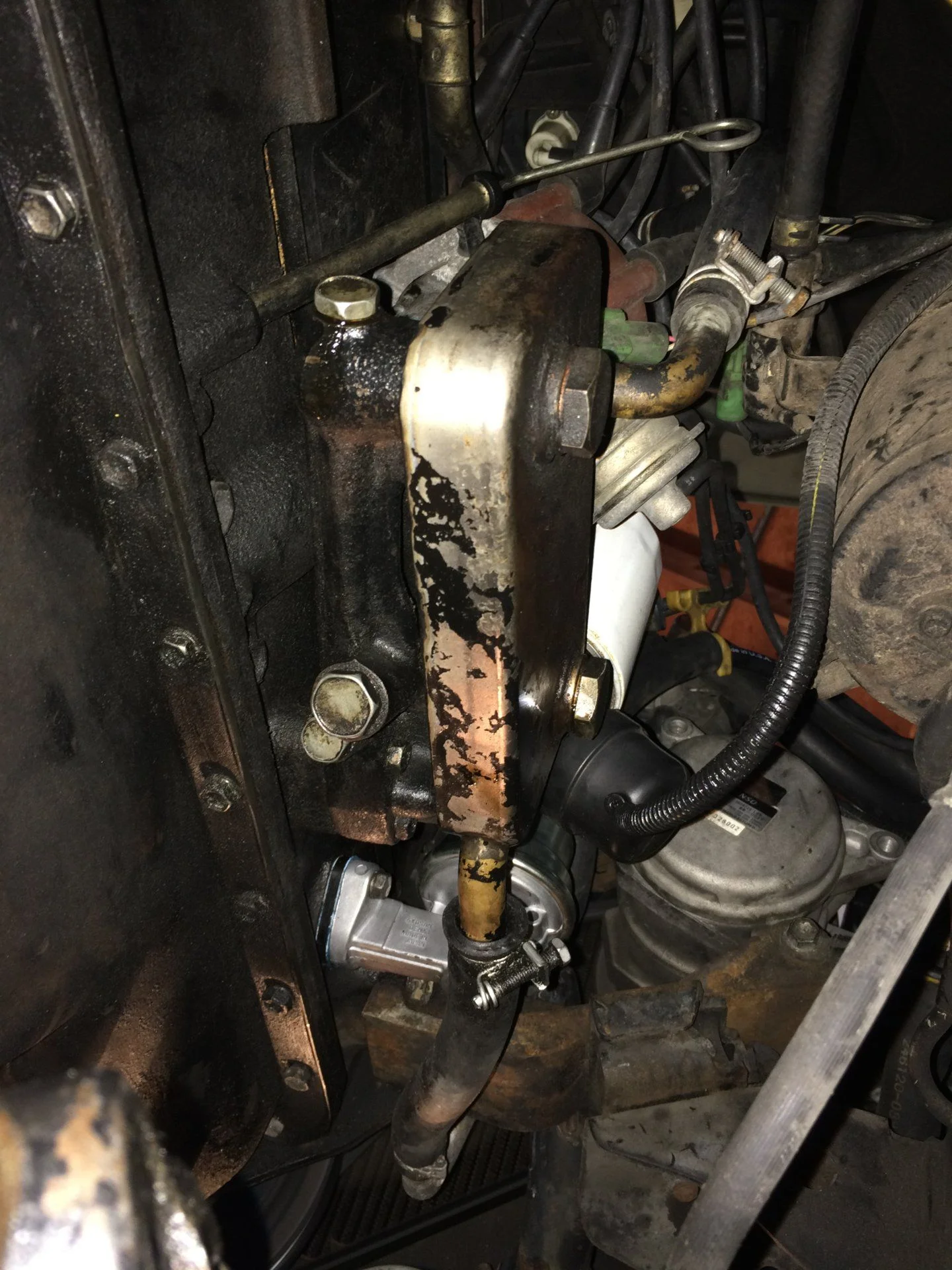

Seeping from the oil cooler and oil pump thing as well (I forget what is called). Parts on order.

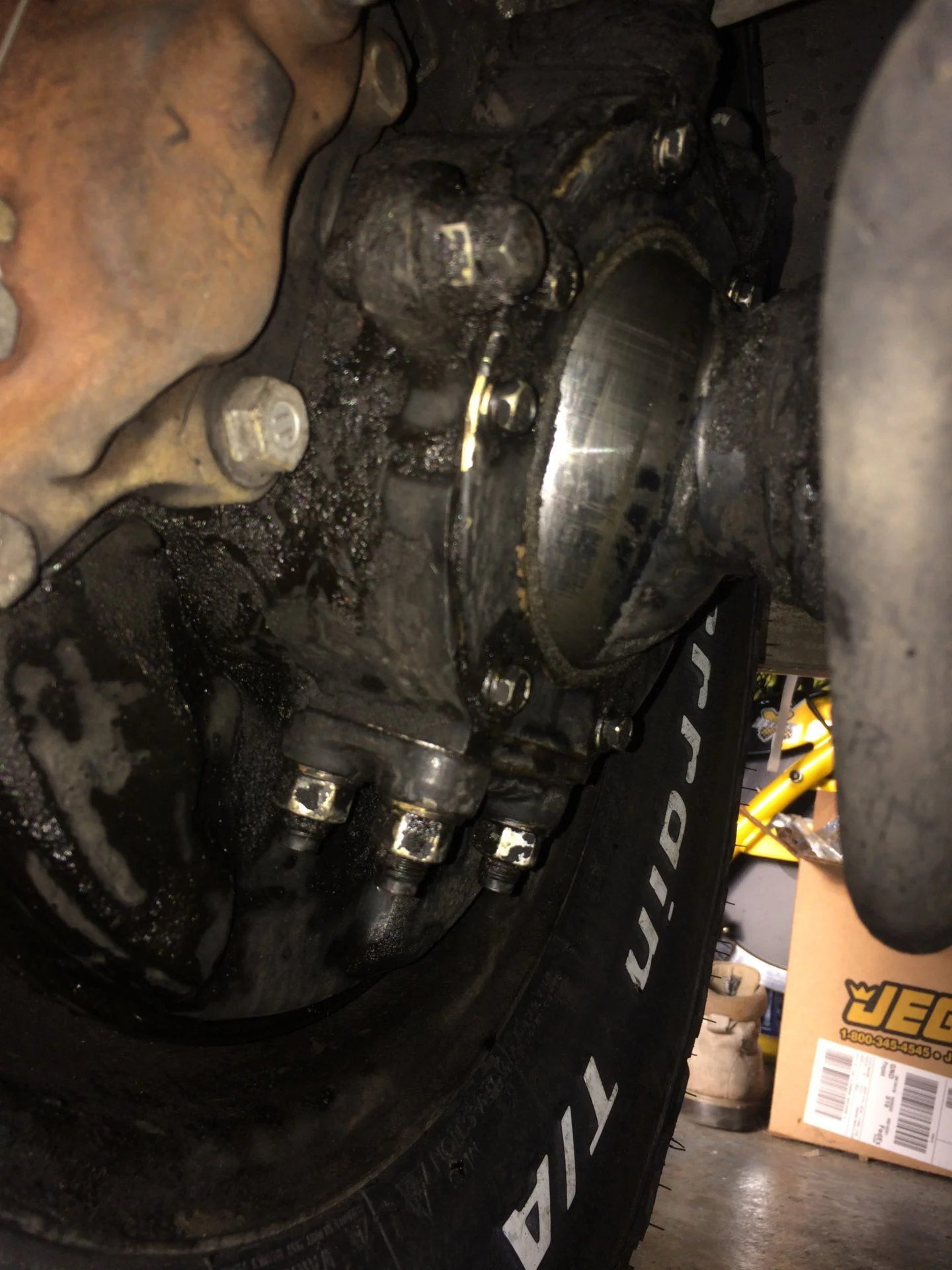

Donated a little time trying to clean up the knuckles. Here is a lava cake before and after. Not totally clean but will hopefully help me ID what needs to be fixed. Any ideas? I’m no expert in this area.
After
Rear main seal is needed along with a front axle rebuild. Nice rig! I use to live off Hwy 4 and spend many winters in Bear Valley. The oil cooler is another common leak area, all fairly routine items for a 30 year old rig.

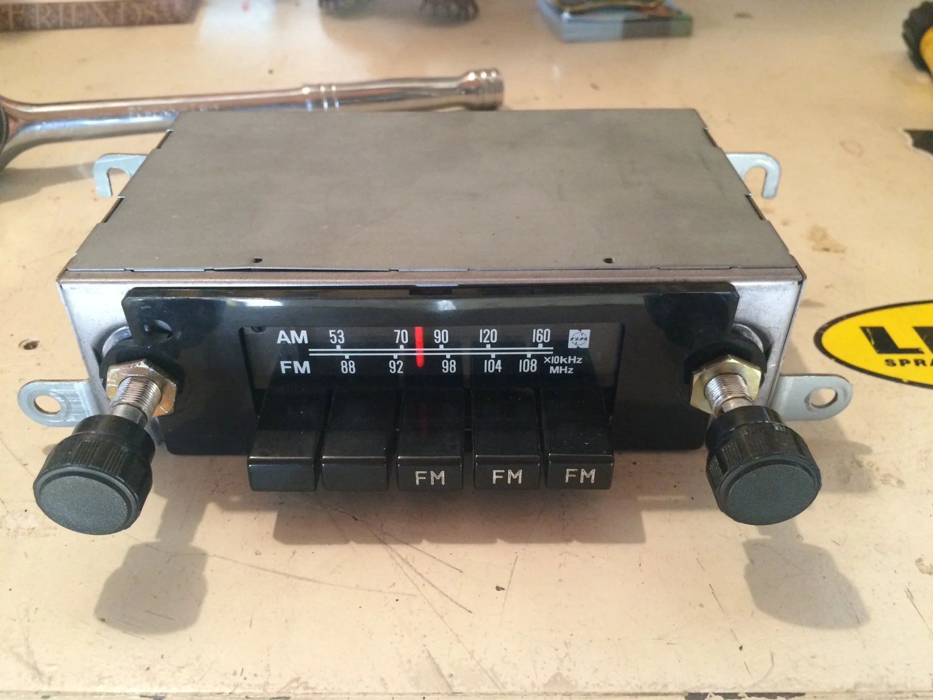

While I was away the neighbor fixed the stock radio that came in a box supplied by the PO. I’m debating whether I try to put it back in and fix the wiring or go with some sort of new tech old look option. Would love ideas if you guys have them.
After
You need a knuckle rebuild. Search "Knuckle Rebuild" here on Mud and you'll get plenty of information on how, parts needed, where to buy parts, etc... Knuckle rebuilds are rites of passage to new cruiser owners. Good looking 60 and keep us posted on your progress.

Is the clutch having issues? It's normal for the clutch to engage in the last bit of the pedal travel even when brand new. To replace the RMS you have to pull the transmission, clutch, and flywheel so yes, those would be done at the same time.
Lift and knuckle could be done at the same time, you will want the axle u bolted to the springs when you do the knuckles (not necessary but you will be driving races and such) but the lift may be easier with it down to a bare knuckle...just more room to work.

The knuckle (axle) job is not hard but very messy. Might as well do the brakes and wheel bearings while you’re at it.
After
sometimes that nice cake build up serves like a blood clot and stops bleeding/leaks. Once you remove that build up, you may find more messy leaks ensue.
