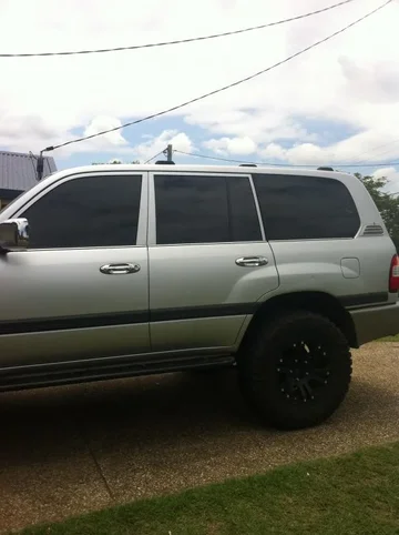

Windows are now tinted, and inside the cab feels nice and cool and comfortable now :rolleyes:
I ordered 15% for the front to windows, and the rest are 5% so it is all legal. 5% is probably a bit dark, but for what I am using the car for, it won't be any problem, I'm not doing any serious off roading at night time, and most of my recreational use will involve long trips on the road.
Here are some before and after shots
Geez mate they are really dark looking from here. Is this only legal in QLD? I tried to do mine darker in Vic but the installer said 35% was the most I could go.
It is technically darker than Legal yes. I ordered the tint myself, and got a friend of mine (who has been doing the tinting for Toyota and Lexus here in rocky for nearly 10 years) to fit it for me as a cash job. Obviously because she can do a much better job than me haha.
She said that I would get away with it because the front two are lighter, allowing me to see down either side of the car clearly, and that is what makes it legal. And I can always try the factory fitted privacy glass option, as an excuse.

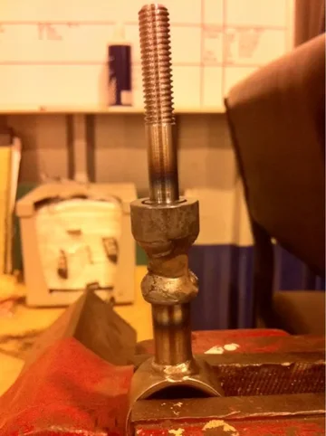

Front sway bar extensions are done!
Now was a good time to get this job done, as you can see the link pins were heavily corroded, close to the point of breaking.
To make the extensions, I cut the ends off the links pins, where the bushes actually sit. Then cut out the shanks of a couple of high tensile bolts to use as my new link pin.
Then, with the help of Dean, the machinist that I work with, made a recess in the end of the bolts to fit over the stub I left of the existing link pin. At the same time, we machined down the bolt from the opposite end and put a thread on it for the nuts to go on.
Then we welded the new pin onto the old pin end, and welded the spacer seen in the picture back up the top of the post, an inch further up from the standard mounting surface.
After a tidy up, some paint, and new bushes, I had the finished product. 1" extended front sway bar links.
I'm pretty sure that 1" extension is all that is needed to clear everything. It will be interesting to feel the difference ice the sway bar is fitted again. I've been driving round for nearly two months now without it haha.
