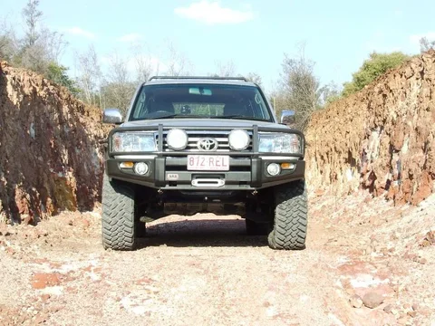

I'm out at my parents property, on a working holiday driving a harvester for my Dad. My wife got bored of sitting on the tractor so I told her to go get some poser shots around the place. So no changes have been made, but here are the shots.
I couldn't be bothered editing the number plates out this time..

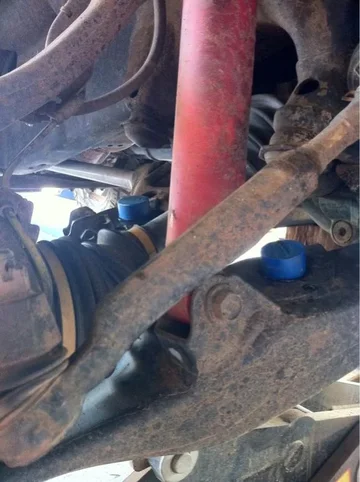

After driving out to the property and going through a few dips, I discovered it doesn't take much for the wheels to touch the guards on up travel. So here is my temporary fix that I came up with. I cut some 20mm shims out of a broken semi-trailer hoop we had lying around out there and, as you can see, I 'bonded' them to the lower control arm, where the bump stops contact them. I hit the same dips in the road coming back to town, at the same speed and I could feel the bump stops hit the shims before touching the guard. They've last 500km now and haven't come off so I think they'll last until I get around to a permanent fix.

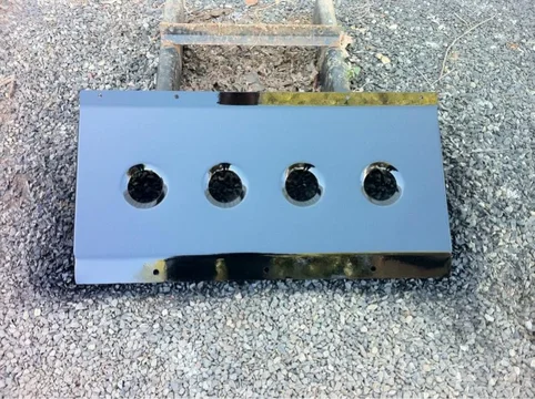

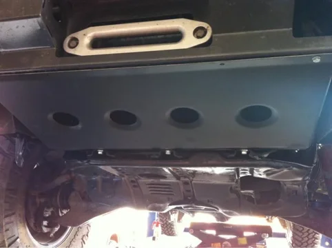

The bash plate that joins from the bullbar down to the front crossmember was fairly well rusted too, so Nathan at Fatz Fabrications, the guy who did my inner wheel arches, made me up a new one in return for me giving him my old torsion bars. Here it is.
