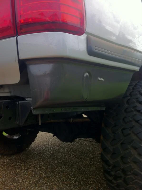

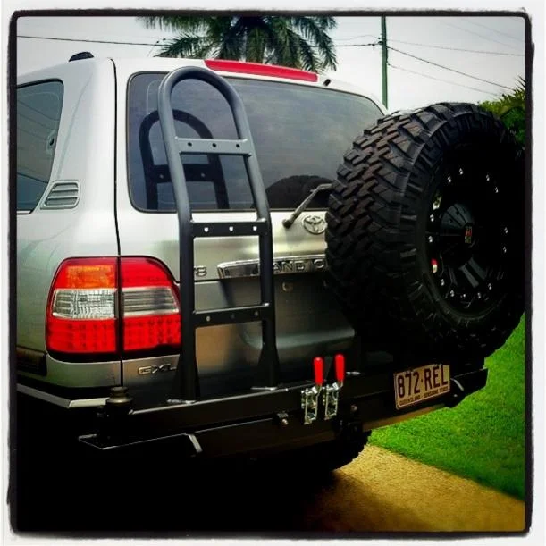

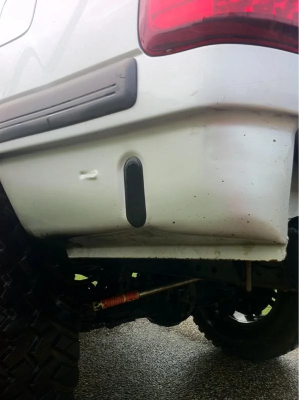

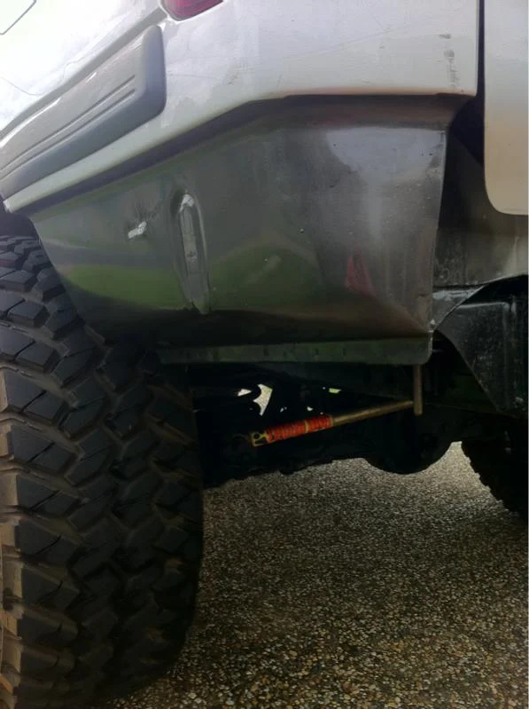

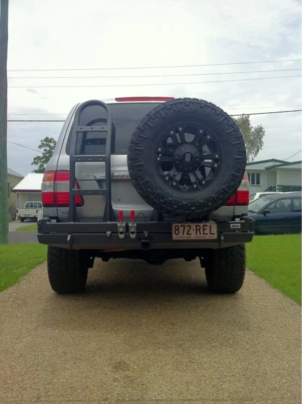

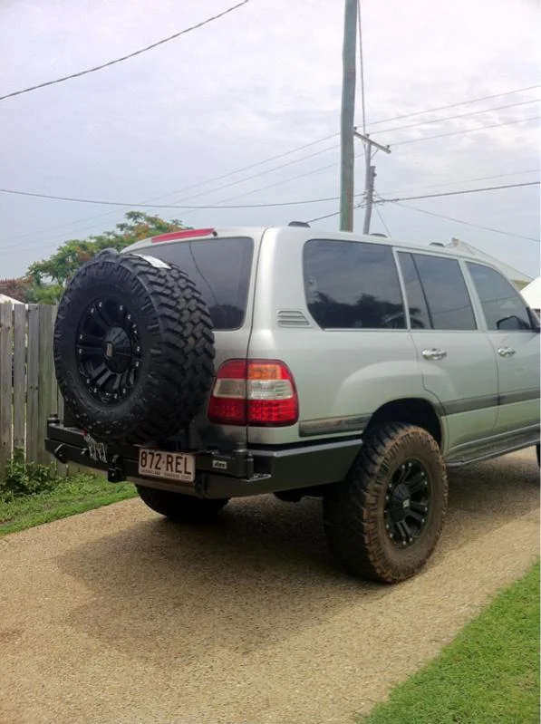

Thanks Darren, I picked it up on Thursday last week, and got it fitted a couple of days ago! Here are some pics of the prep and install.
I got a batch of paint made up into rattle cans to match the colour of the front barwork. So I also painted the rear quarters of the car, behind where the bar would sit with the left over paint.
The instructions were very clear and easy to read. And I'm very impressed with the quality of work from Slee, so a big thanks to the team at Slee from the other side of the world in oz!

Nice built, how you feel the off road ride after the rear bumper was installed?
thanks
Thanks, the ride is much smoother now with the rear bar fitted. The extra weight over the back end now suits the way the Kings are valved. They still control the car well in the corners, and absorb the bigger bumps. The fronts I think are still a little stiff, but nothing bad enough to warrant re-valving them in the near future.

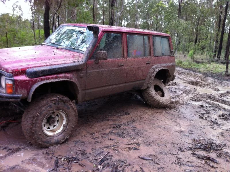

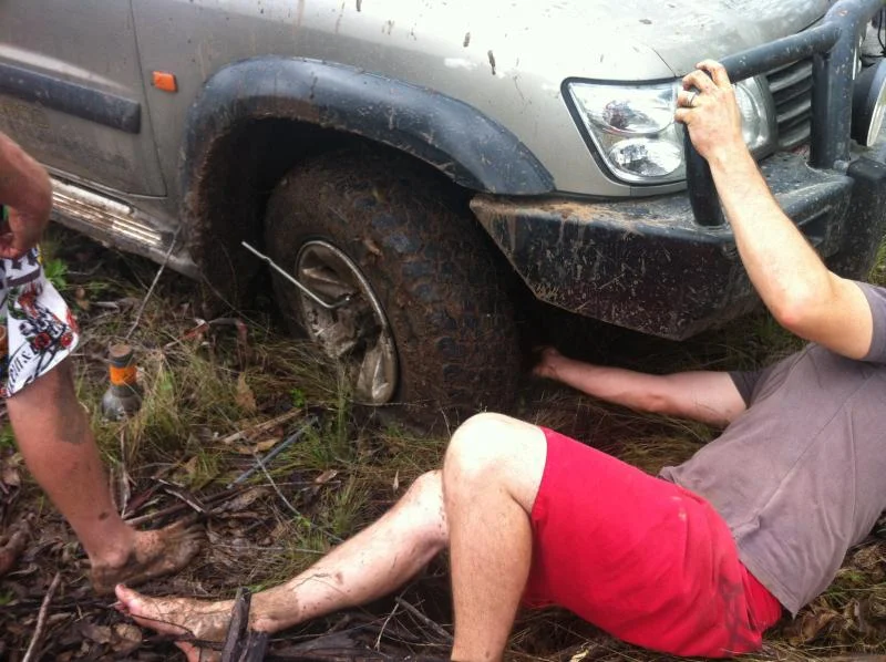

It's been raining a fair bit over the last few days, so I decided to round up a few mates to go for a good ol' fashioned mud bash. It was a good opportunity to test out the mud grapplers, and they didn't disappoint! The trusty 100 lead the pack and I only got stuck once while pulling the red GQ Patrol out (for the 3rd time, after dinting his rim and rolling the tyre off) but I was able to winch myself out.
Speaking of the winch, the 9.5XP was incredible! With the 100 doing 8 recoveries over the course of the afternoon, and 6 of them with the winch, it didn't miss a beat.
Here are a couple of pics
The red GQ Patrol
Another newer model GU Patrol
Here is a group shot of all the cars, minus a Mazda BT50, that only lasted the first 100 meters or so before he gave up and jumped in with someone else.

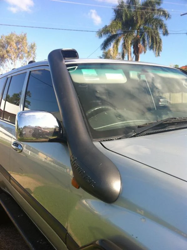

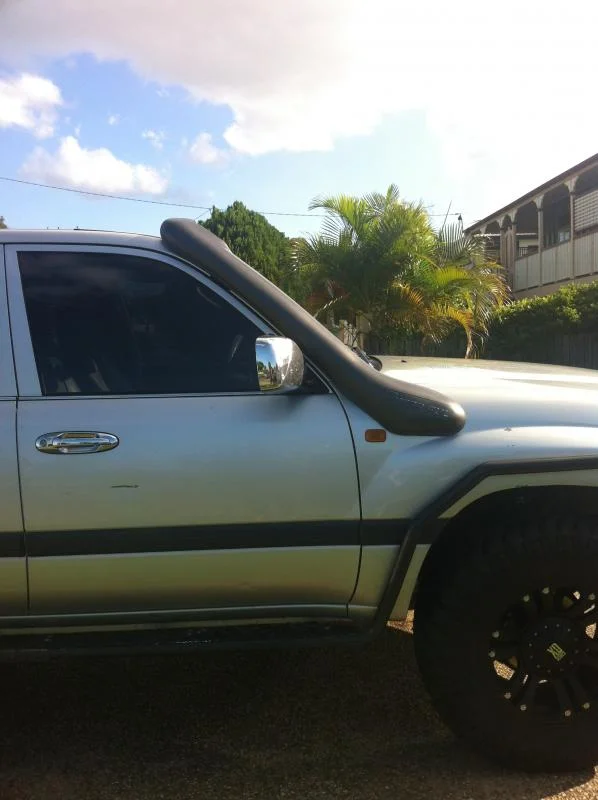

Fitted a snorkel this afternoon. I got it from a company call Powerful 4X4. Its basically the same design as the Airtec snorkel that TJM sell, but instead of $475, it was just under $200.

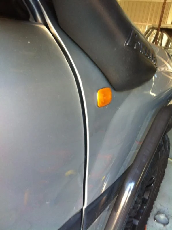

I did run into a problem whilst fitting it though, and that was that the plastic elbow that the snorkel connects to inside the guard didn't fit up inside the guard properly. I had to take all the bolts out of the rear half of the guard and pull it out a bit to squeeze in the plastic elbow. Then put a bit of force on the guard to bolt it back on. This makes me think that the plastic elbow will only last so long until it starts to rub through on the inner guard. So on Monday I'll be ringing powerful 4X4 to see what they have to say about it.
As with most of my posts, I like to add a little picture or two, haha. So here ya go! :popcorn:
Here is how the guard was sitting before I bolted it back on.

One interesting thing I noted with the gauge is that the intake air temp is on average 10 degrees C cooler with the snorkel fitted compared to before, so that has to be a good thing!
