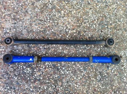

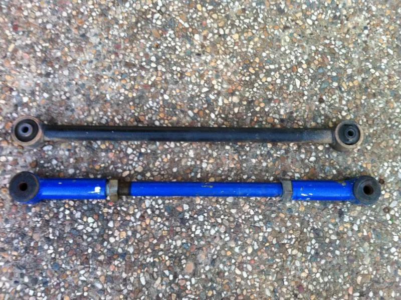

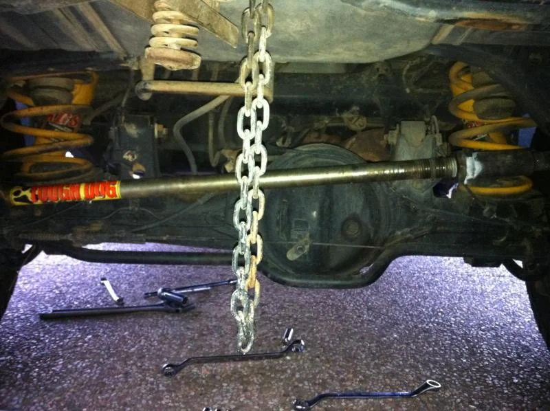

Then recently (yesterday) I fitted all my suspenion, in the rear that included 2" lifted Ride-Pro springs, my adjustable panhard rod and Snake Racing adjustable lower control arms off the last car.

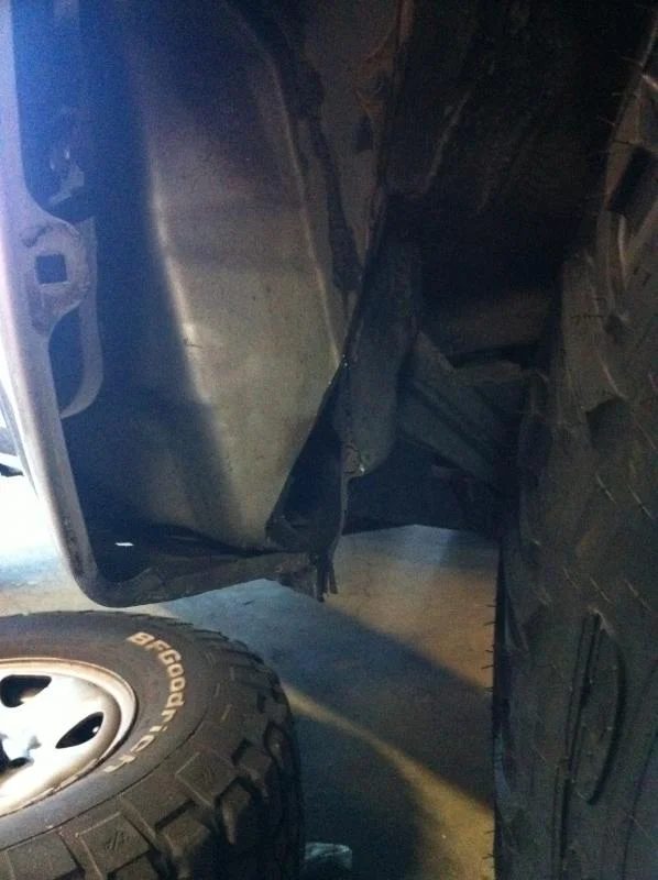

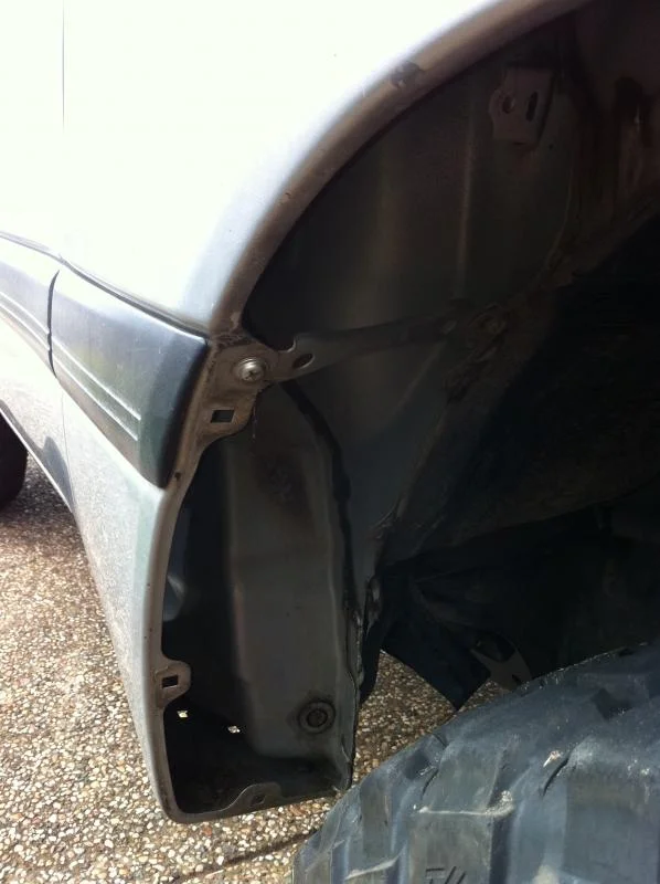

Along with the lift, I wanted to give the 35's I have a little extra room to do their thing, so instead of hammering flat the pinch weld in the body, I decided to actually cut the body back to give even more room.

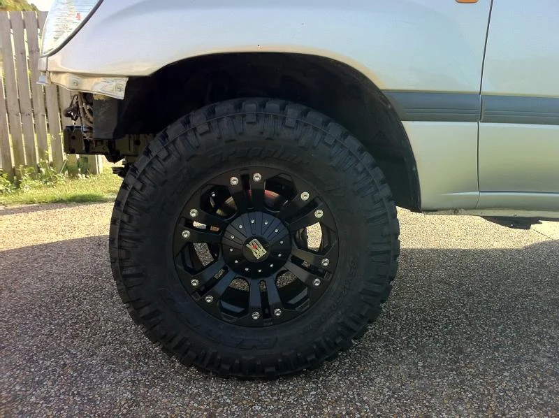

Once all of this was done, all I couldn't think of anything else until I fitted the new shoes haha. I got a set of 5 - 18" XD Monster Rims fitted with 35X12.50 R18 Nitto Trail Grapplers shipped over from the U.S. I was a little unsure of my choice at first, but once they were on, any doubt was gone, haha.

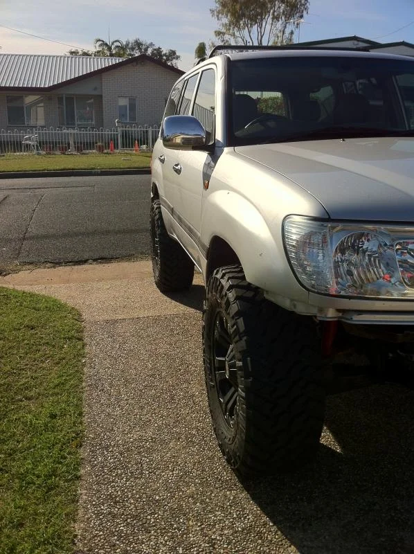

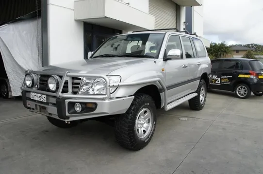

Here is a photo of Sway when I got it, and one of how it stands now.
The ARB Bullbar and Side Rails - Side Step Combo are at Rockhampton Powdercoaters at the moment, getting blasted and coated as they were in pretty bad condition and a little rusty. I get them back on Tuesday, when I'll fit them, then I'll do a final adjustment on the height and take it for a wheel alignment.

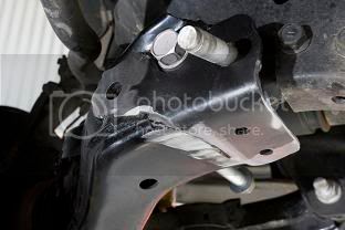

What are these strengthening plates for the lower arms that you speak of?
The 100's crack the a arms from the joint weld along the path of least resistance, to the torsion bar, or arm pivot mount.
Mostly from hitting the bumpstops often.
We normally remove the arms, weld them internally, and externally, to prevent it happening, when doing suspension on the 100.
rims and tire combo are very nice! Very nice rig indeed!
Thanks guys glad you like them haha.
No-pistons - The strengthening plates are sold at arb, in the last picture of Auscrafts you can see the plate that has been welded on has two holes in the under side of it, the instructions just tell you to secure the plate with the mounts for the torsion bar, and drill two holes to bolt the plate underneath. Obviously welding them on is going to be stronger, but I was doing mine on the ground out in the sun, so i just wanted to get the job done haha, rather than spending the time and pulling the arms off to properly weld them up.

That's very interesting. I've never heard or seen anyone in the U.S. installing one of those, however I may be out of the loop.
I don't even see it listed on ARB USA's catalog. Do you know the part number?
Definitely only 2" haha, might look a bit tall due to no side steps and bullbar? The rear iss sitting at 810 or 820mm from memory and the front is something like 790mm. (measurements were done with the 16" rims still on)

I rang ARB this morning and they said the part number for the kit is " FK27 "
Seems like a short part number, but that's what they gave me.

As far as the LCA supports, Camel sells em with the Ironman lift in the US.
