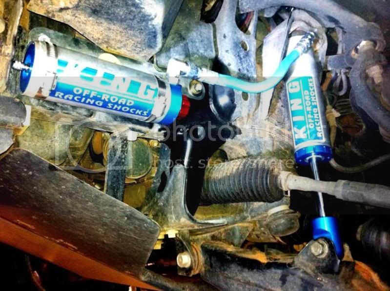

OK! So as of this morning, my Bolt-in King Shock kit has been ordered. I went with Sonny from downsouth motorsports for the simple fact that he is the most competitive with pricing. There is a 2 week build time on the shocks and then they will be on thier way!
Seeing as I'll be waiting now for them to arrive, and between now and then all I'll be doing is getting the UCA's fitted, I thought I'd take the time and run through the rest of the mods I have planned for the next few months. Sort of a "Watch this space" if you will. Starting from the next planned mod, to the last on the list.

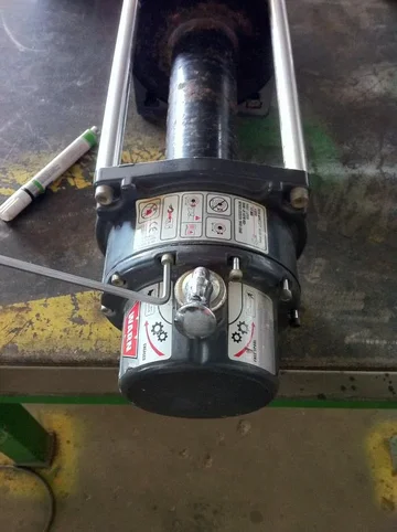

Got around to pulling my winch back out this weekend, and re-orientating the free spool leaver. On this particular winch, a Warn 9.5 XP you can only move the gear train around two bolt holes at a time, if that makes sense. I don't have enough experience with winches to know if this applies to others as well, but I imagine they are fairly similar. All you do is undo all the hex head bolts, (4mm allen key) and slide the drive assembly off the drive shaft and move it around as far as you want, (going two bolt holes at a time) and slide it back onto the shaft.

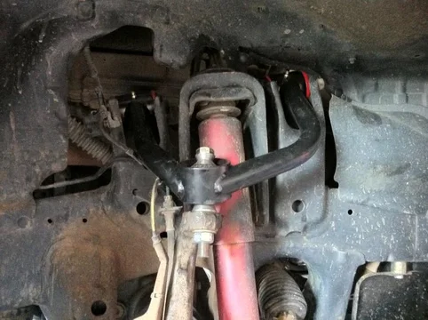

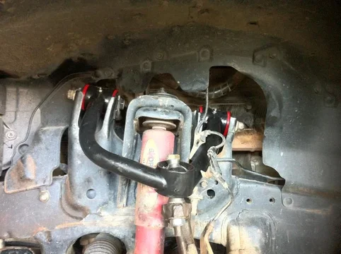

I also got around to fitting my Upper Control Arms. This was virtually a one banana job. I just used a bench vice to press the bushes into the arms. I had to give the mounts on the chassis a bit of treatment to fit the new arms in becuase with the bushes fitted, they were just a little too close together.
Here are some photos for comparison

The Kings I've ordered are longer than the current shocks, I'll measure how much more droop I get after fitting them.
Darren do you find the need to use limiting straps anywhere to limit droop with the longer shocks?
The bushes do a pretty good job of limiting droop with 760mm long rears, If I were to fit a limiting strap, I would fit it to the centre of the diff for when jumping it, rather than restrict it on the outsides, when it articulates at slower speeds.

I was referring to the front suspension when I asked about limiting straps. Having the longer shocks up front, would the UCA's pull up down travel before touching the shock?
