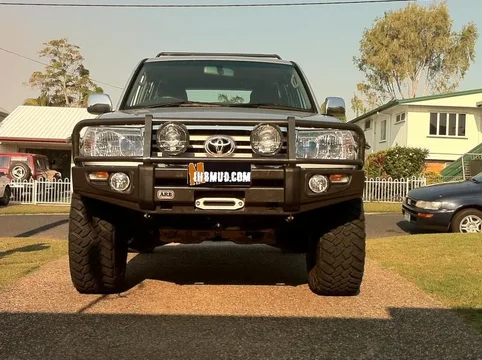

Alright! The bullbar and side rails / side steps are back on, wheel alignment done and lights are all wired up, just going to wait til its dark to adjust them...
The colour of the bar work looks brownish in these photos due to the lighting (a lot of people are burning off before fire season over here and its really smokey.) Its actually metallic graphite. I was a unsure about the colour at first but once I got it all on the car I was happy with it!

Enjoy the eye candy, cos this is the last post until i get my UCA's on, which will be a few weeks haha. I'll try and take pics of fitting them as I go so anyone who isn't sure if they can do it themselves can see how to do it. I am guessing its going to be a pretty straight forward job... touch wood haha.

So your neighbor drives a Safari!
Awesome truck Nathan! Love the feaux ih8mud license plate:D
Haha, I thought the plates would get a laugh, Im not sure what you call a safari, over here they're called patrols, Nissan did make a spec'd up model of the patrol called a safari if thats what you mean, but the neighbour's is just a DX model Patrol (base model ... I think.)

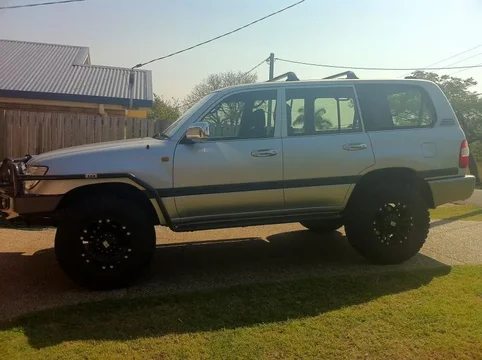

Haha, I'll get a couple of side pics tomorrow :rolleyes:
Quick question, if you where to go over a big bump quickly, and both front wheels bottomed out simultaneously...i s it buy buy fenders or have you made some form of mod to fix that.
From the pic it looks like of the tyres travel 5" up its game over for the body work. :frown:
Just wondering cus my tyres protrude far less than those and I tore a fender innards out last weekend.:rolleyes:
Correct you are mate, this is why I am refraining from going offroad for now haha. Once the UCA's and kings are in, and the final height adj's are made I'm going to address the situation... not 100% on how yet though. I was reading a thread the other day about those timbren bump stops .. they may be an option, but I'll post up what I end up doing anyway ;)

Here are the side pics anyway, to be viewed on a very small supercomputer :p
Mother of Sweet Baby Jesus, that looks tough!! I have never liked any non-OEM wheels on the 100/105 but those look downright evil.
Whats the deal with the OZ trucks not having blacked out trim around the windows? Are all they all like that down there?
That's actually something I've ne'er noticed haha, yeah they're all like that over here. Are all yours blacked out like that haha? I like the black look now that I've taken notice.
