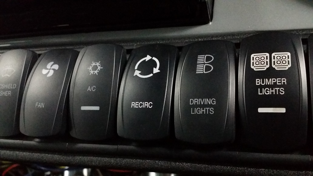

So, here is another short clip for those interested. Since my heater/AC unit is mounted to the firewall, I can no longer access my passenger kick vent. I really wanted to be able to open it though, because the 'intake' for the unit is right behind where it opens. My solution was to get an actuator to open it. The actuator is tied to a momentary DPDT switch labeled RECIRC. When it's open, I get fresh air inducted in my HVAC system. When it's closed, it's recirculated. The best part about the actuator is it has built in limit switches, so I can hold the button down as long as I want and it will automatically stop when it's fully open/closedd

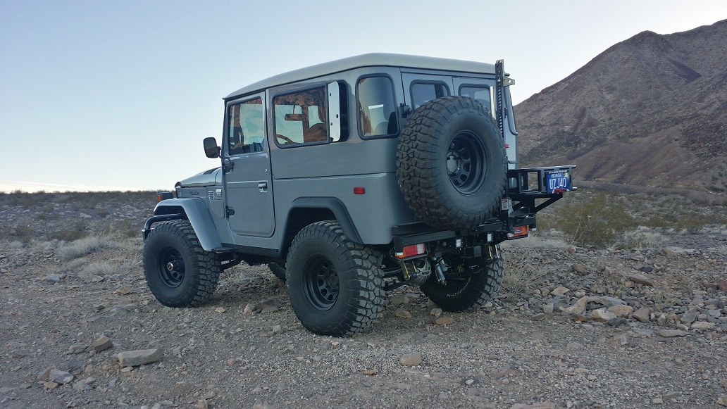

And.... another poser desert pic
That is awesome. I definitely am going to have to come see you again and get some help improving mine.

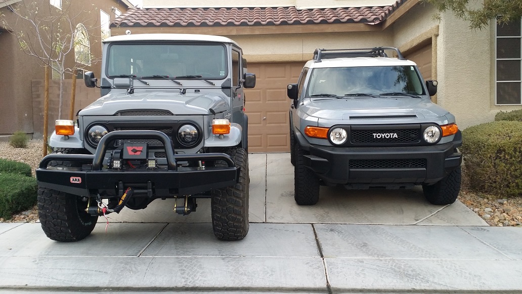

Found a cement gray FJ cruiser in a neighborhood near mine. Owner didn't mind if I snapped a couple pics.
Old VS New
Wish Toyota had stayed closer to its roots with the FJ... I thought I read somewhere that they reached out to the ICON folks but then scrapped their ideas. Too bad. Don't tell the guy your Cruiser looks WAY better... ;)
Some people post videos of their truck driving around... others post videos of their engine running... you post videos of your latest actuator installs.
And I'm totally cool with it! Love what you've done with the rear windows and kick vent.
I appreciate your comments!
Mike's right - your's is MUCH better!!
Thanks! I'm happy with how they turned out!
I just about fell out of my chair when I saw the automatic vent! Very slick and cool idea, nice work!

are you using Dakota digital linear actuators for your windows and kick pannels? man you truck is sweet. I'm reading and rereading it. blows me away each time.
Yes, Dakota actuator for the kick panel vent, but the window vents are actually vent window motors from a Ford Windstar minivan. I figured I would use what somebody else had already invented!
Hey! Those Windstar window motors must be good, and popular. That's what I use to open the rear quarter windows in my 94 Chevy K2500 extra cab. I used the drivers door panel out of an early 90's Suburban. The Suburban window switches for the rear door windows were re-purposed for the controls for the quarter windows.
