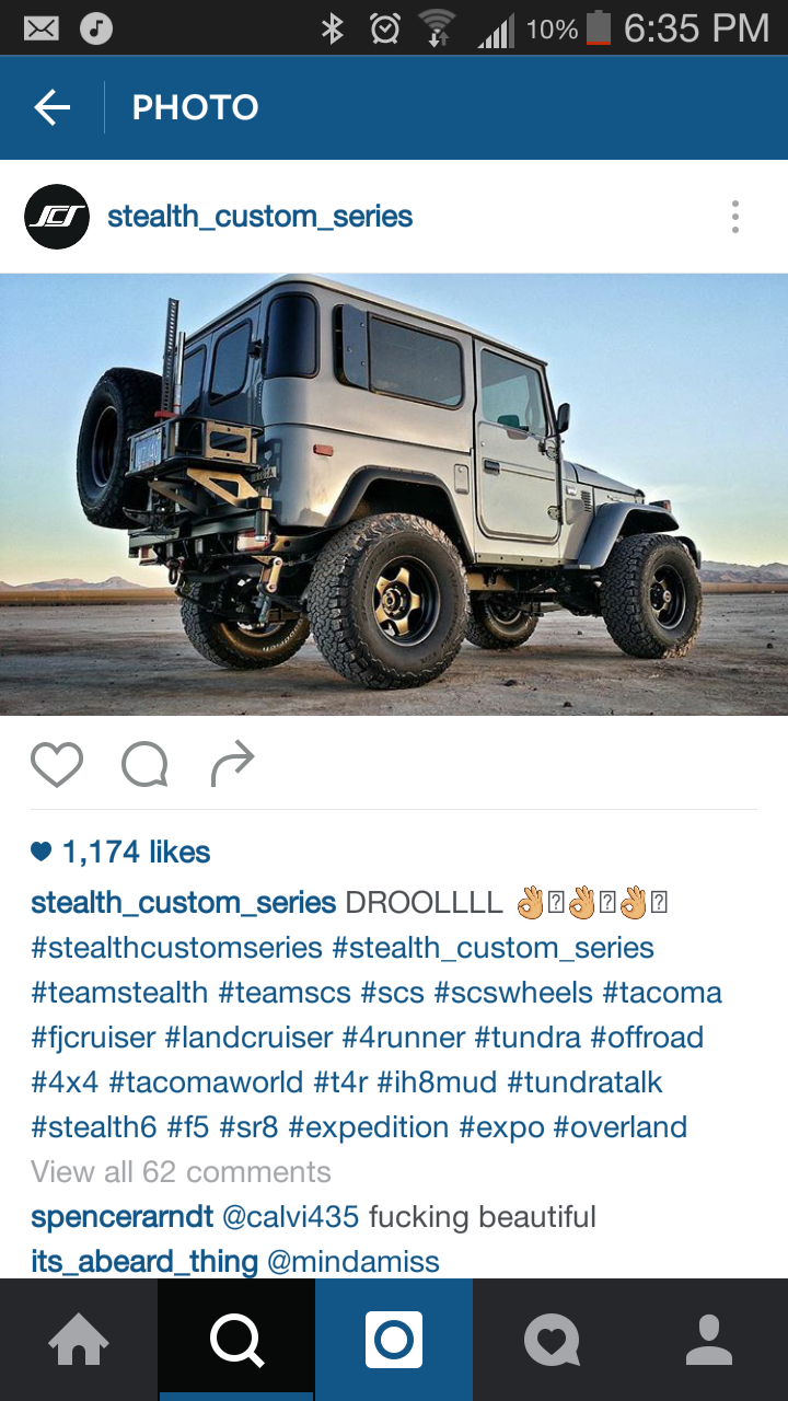

Thanks! The guy that I bought the silver Tacoma from just sent me this screenshot and asked if it was my 40... I thought it was pretty funny because I had no idea SCS posted it. I really don't do any social media, so I'm glad SCS is able to use it for them!

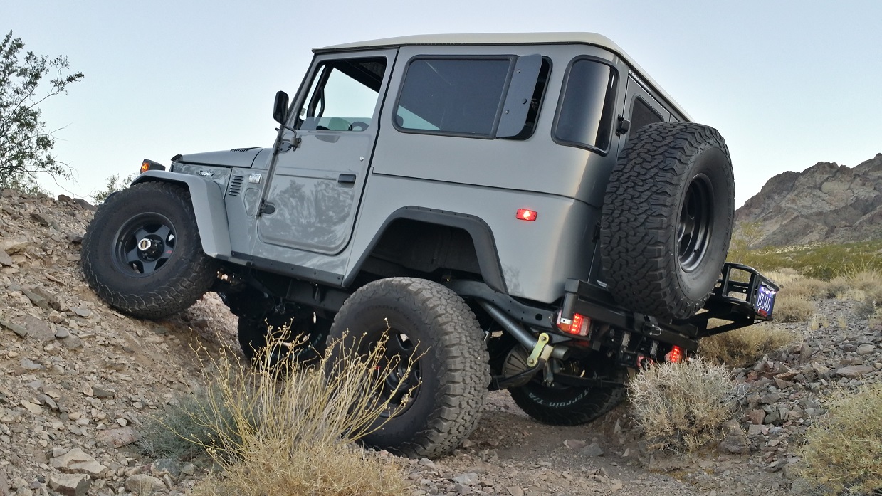

A few pics for your enjoyment... For anyone curious how much flex you can get out of OME Dakar springs. These aren't even broken in yet, they have have 2500 miles on them. I think I need longer bump stops!
I'm assuming you've already checked for rubbing to make sure you don't tweak a fender... but sheesh that looks close.
And it looks gorgeous! I love pictorial updates to this thread.
You are running 35" tires on OME 2.5"? I've always heard that 33's were max, and you needed a 4" lift to squeeze 35's... Are you running a body lift?
There is a bit of rubber-to-metal contact in the photos. It's actually only the front fender support, the rear isn't even close.
Yes, I needed a 1.5" body lift for my transmission and transfer case. I also have longer shackles. With all of the components, it's close to a 4" lift.
