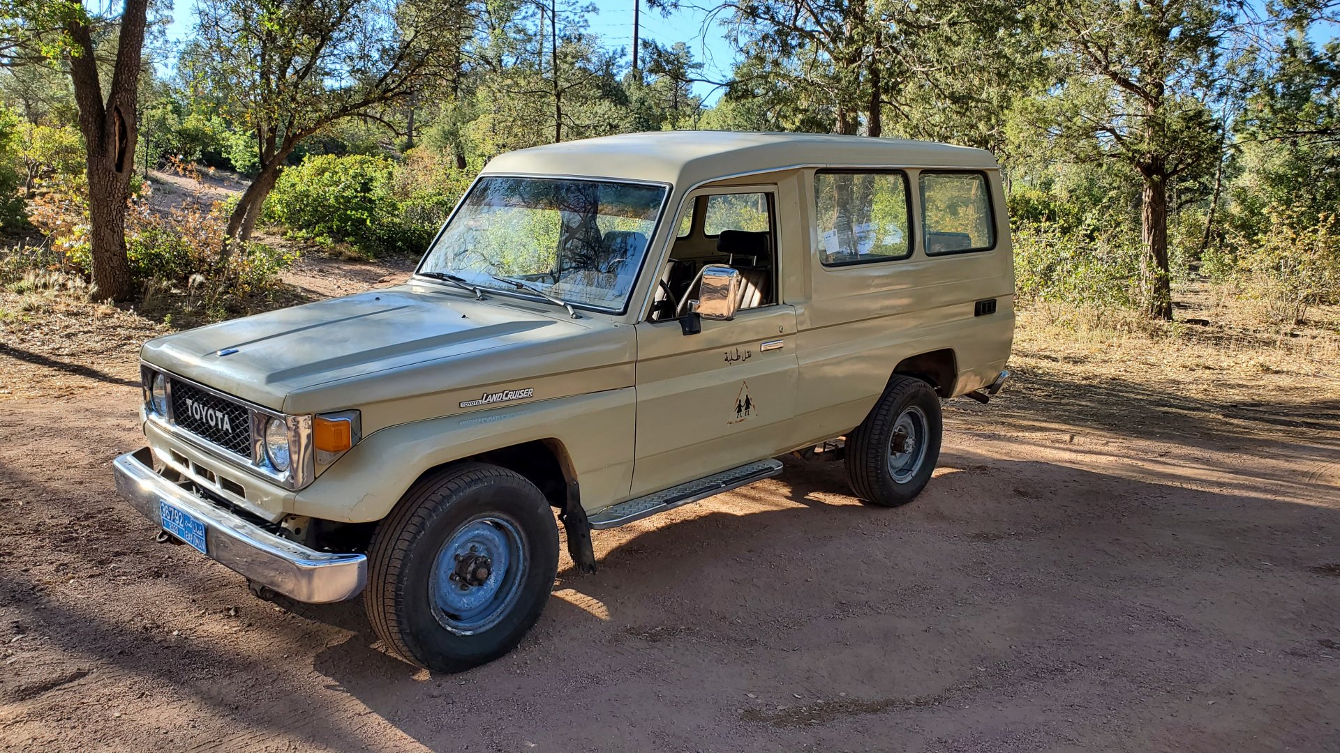

After a long time coming, it's finally my turn to join the club.
1988 FJ75 GCC spec from Oman
3F H55 and split case
The rumors of school bus troopies are true, I spent an afternoon scraping and cleaning gum, candy leftovers and children's stickers from inside this car.
I'm in the process of stripping it down and inspecting everything. So far the car looks to be original and minimally molested, and i plan to drive and enjoy it as i continue the repairs and updates.
I had it shipped from L.A. to Phx az. Where I drove it up to my home in Payson az. I debated the long drive across I-10 but glad I opted to ship, turns out all 4 ujoints are shot, maybe it would have made it, maybe not. I have a vibration that gets very pronounced above 120kph, so I kept it under 120 all the way home to 5,000ft elevation.
This thread will be less of a real build and more of an owners story and chronicals of use, care and feeding.
