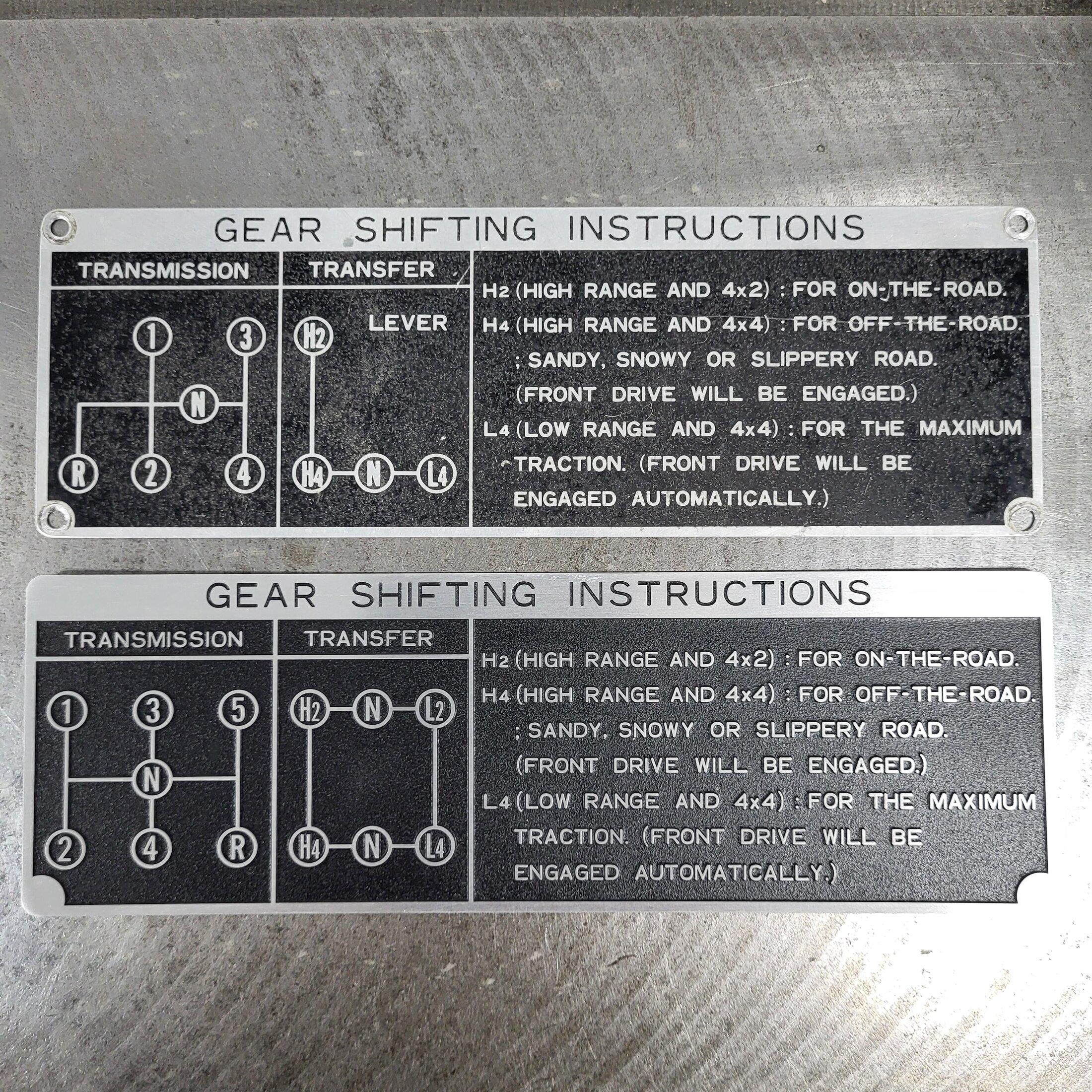

Never fear kids! I have a win.
Went to the Post Office today and not only did I not get shot, but I also picked up the mail which had my new shift plaque in it.
Looks mint. (original on top)
and water beading on my rust makes me laugh.
every. single. time.
Looks great. What thickness did you go with for the shift instruction plaque?
