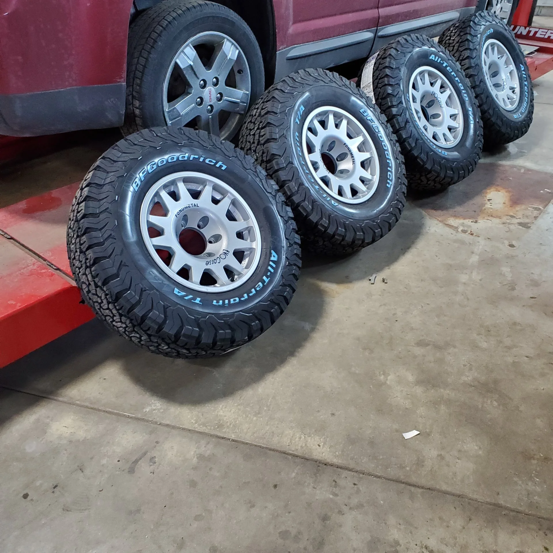

I like them more with rubber on them. The color is growing on me as well. Now, I'm not sure if that's because the lazy side of me doesn't want to strip and repaint, or what...
Even though my rig is a long ways away, I can still screw around with projects.

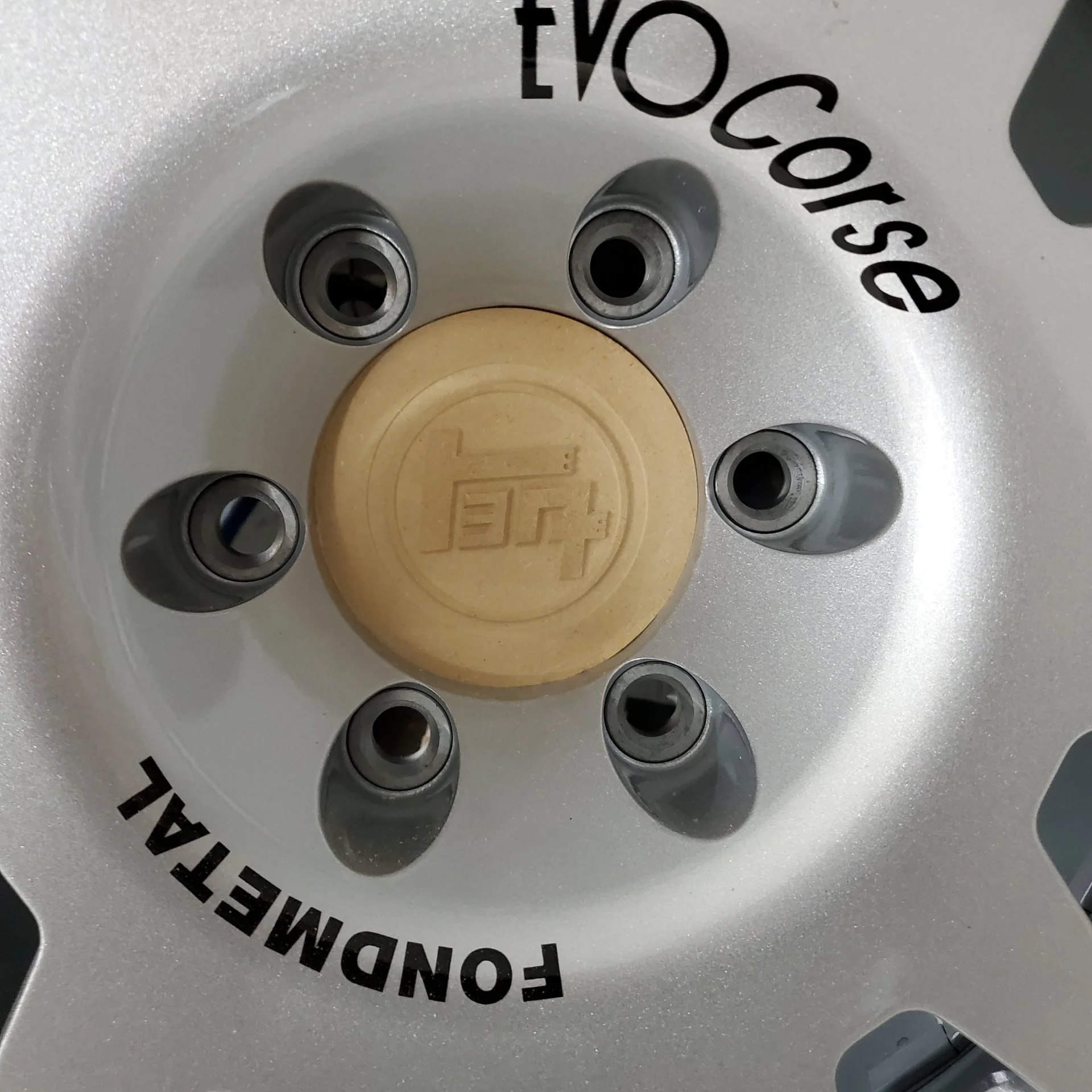

The wheels don't have a center cap available, so I'm just going to make my own for the rear.

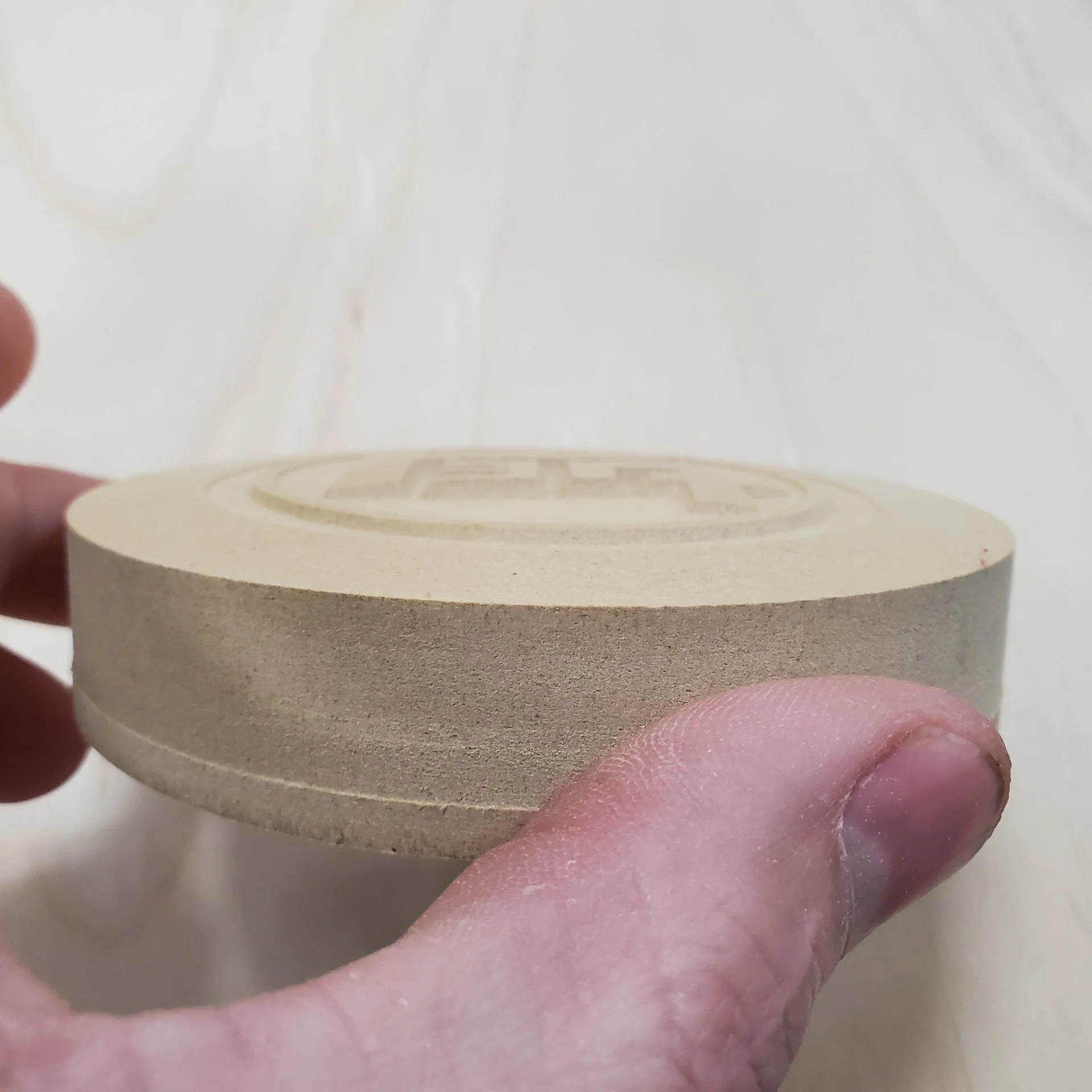

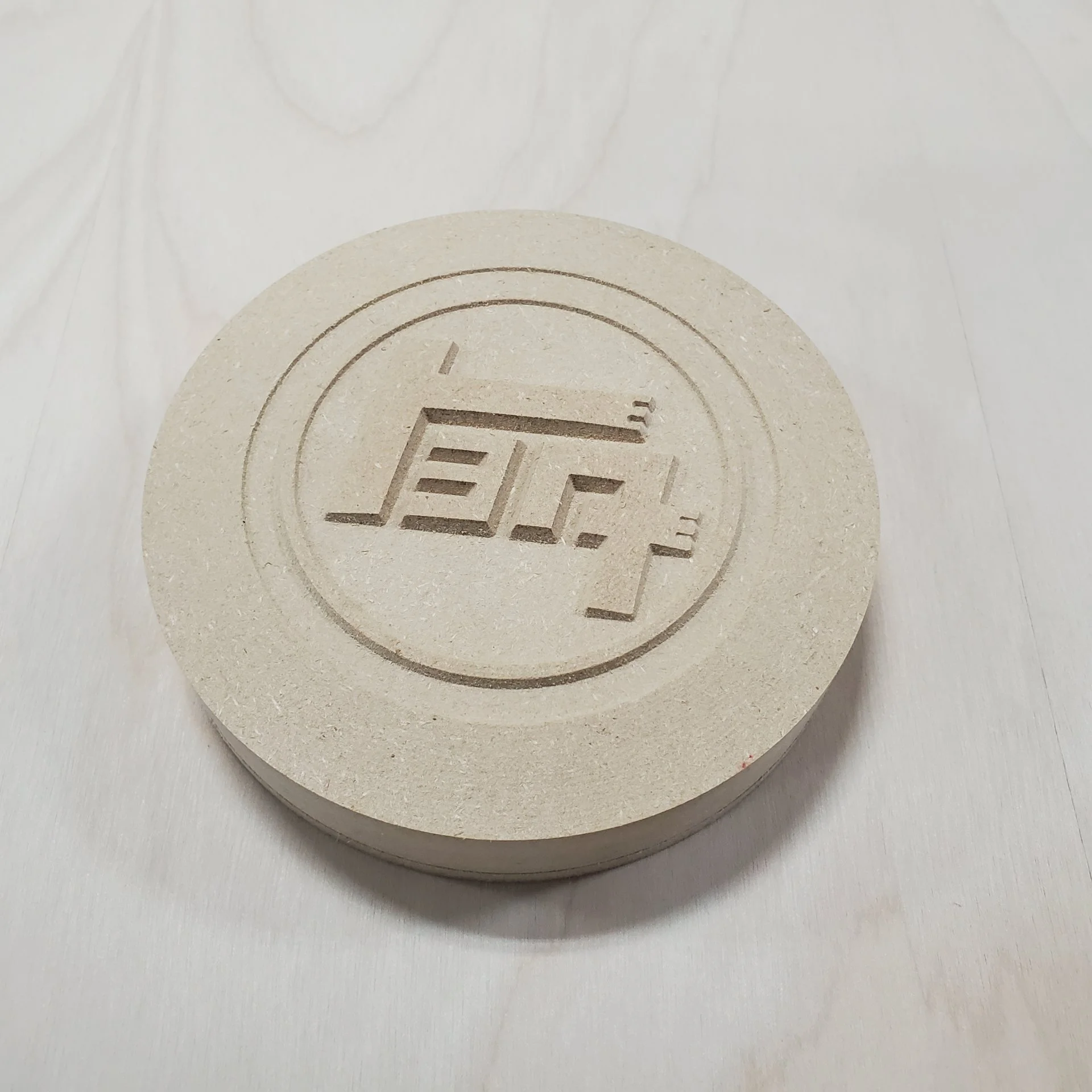

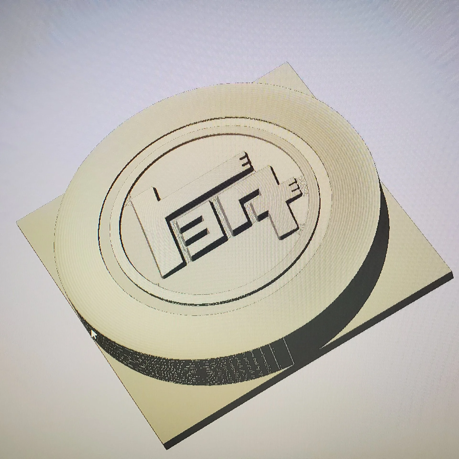

In the software.
Test cut in MDF. MDF is a good cheap way to test. I measured the hole in the wheel as a little less than 4-3/16 with a tape measure. I don't have a caliper that would fit and get an accurate measurement. That's pretty close to 106mm, so that made sense to me and I cut the first one at that number. Too tight. The second test run is on the machine right now. I dropped the size to 105.5mm. That should be a good fit.
13 minutes of run time on the cnc.
Took me a minute to figure out how to get the software to dome the top face. I like how it turned out.
and in the wheel. I'm thinking I'll have to drill a hole at a shallow angle, and tap it for a set screw to hold it in place. That's going to be a royal be-otch to not have it look like garbage.
Are hubs going to clear on the fronts? We have a lot of problems with that and have to clearance wheels to fit the hubs.
Depending what the shape of the face of the rear is like, (I never looked at it with this in mind), I might be able to hold these in place with some neodymium magnets?
Should.
I've been wrong before.
A quick google search came up with a mud thread where somebody said they bore wheels to 4.175" That's probably exactly what I am at. if it's 106mm, that's 4.173"

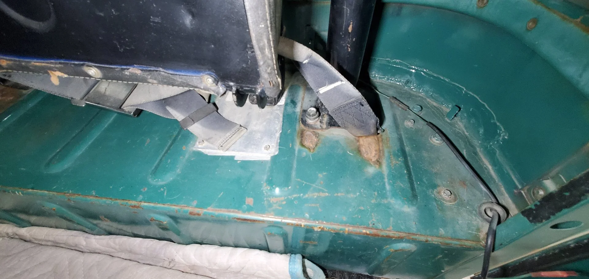

6x9's in the rear in the corner of the tub. Got a good start today coming up with a box and getting a decent fit. I'm not sure I've got enough clearance to the roll bar. I'm also not sure how I'm going to fasten it down. Final box I'll make from ¼ plywood and wrap in fibreglass. Then paint or hose down with bed liner.
The back edge, I'll use a bendable plywood and wrap around that radius.
A buddy of mine has a 40 project that was disassembled, but no real work started on yet. So while I don't have my rig, I do have access to a tub to check fitment and mull over ideas.
Hmm. It's going to take some effort to work around that roll bar. I'm guessing I'm pushing way, way too far forward at the moment.
I'll have to rethink how this will work and it'll take some effort to tuck it more into the corner. I'm thinking the face will have to be raked back to get the top face lower and sneak under the lip of the tub. Maybe that back side can just be notched for the lip.

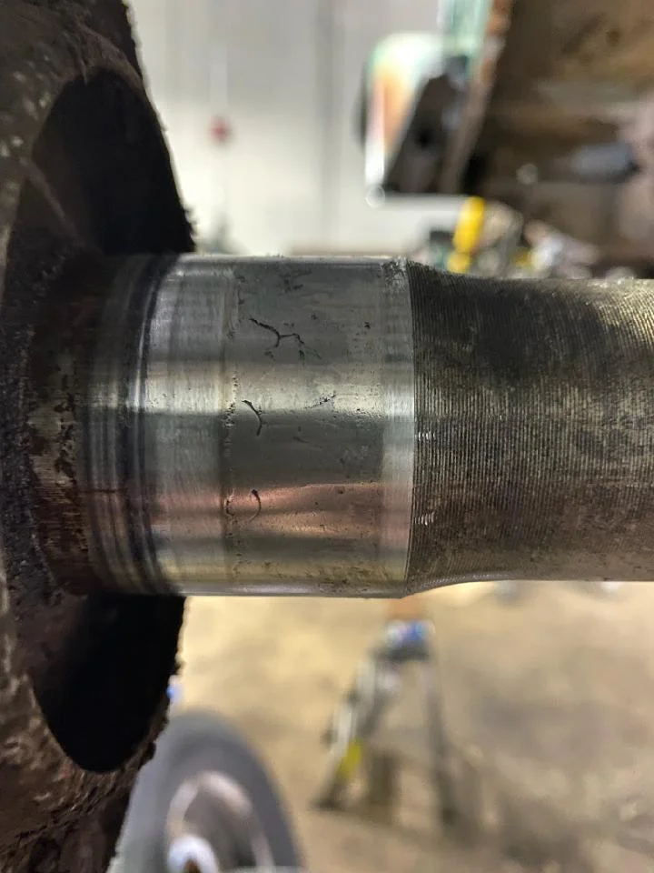

Rear axle shafts. Recommendations on getting new?
My originals were toast. When I had both axles rebuilt, I got a set of used shafts from Classic Cruisers, and they were way better than what I had, but still not terrific.
I have to pull the axles anyways to put the locker in, so I might as well drop new ones in at that time.
Do your rear axle shafts have pressed on races for the bearings? If so, curious how you removed and replaced as I'm about to do the same.
Thanks.
Thanks.
These were the originals. I don't think there's anything removable there.
