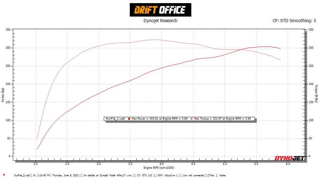

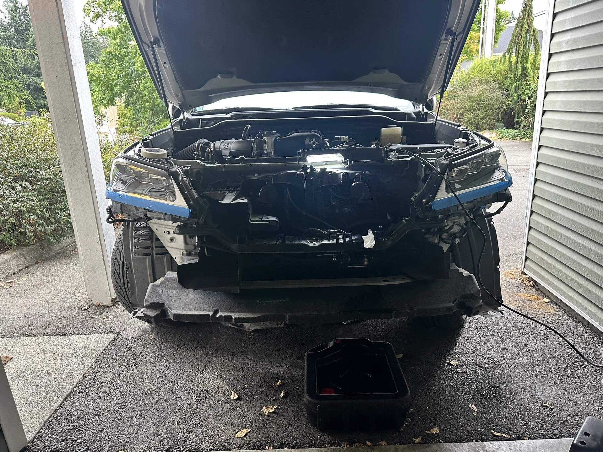

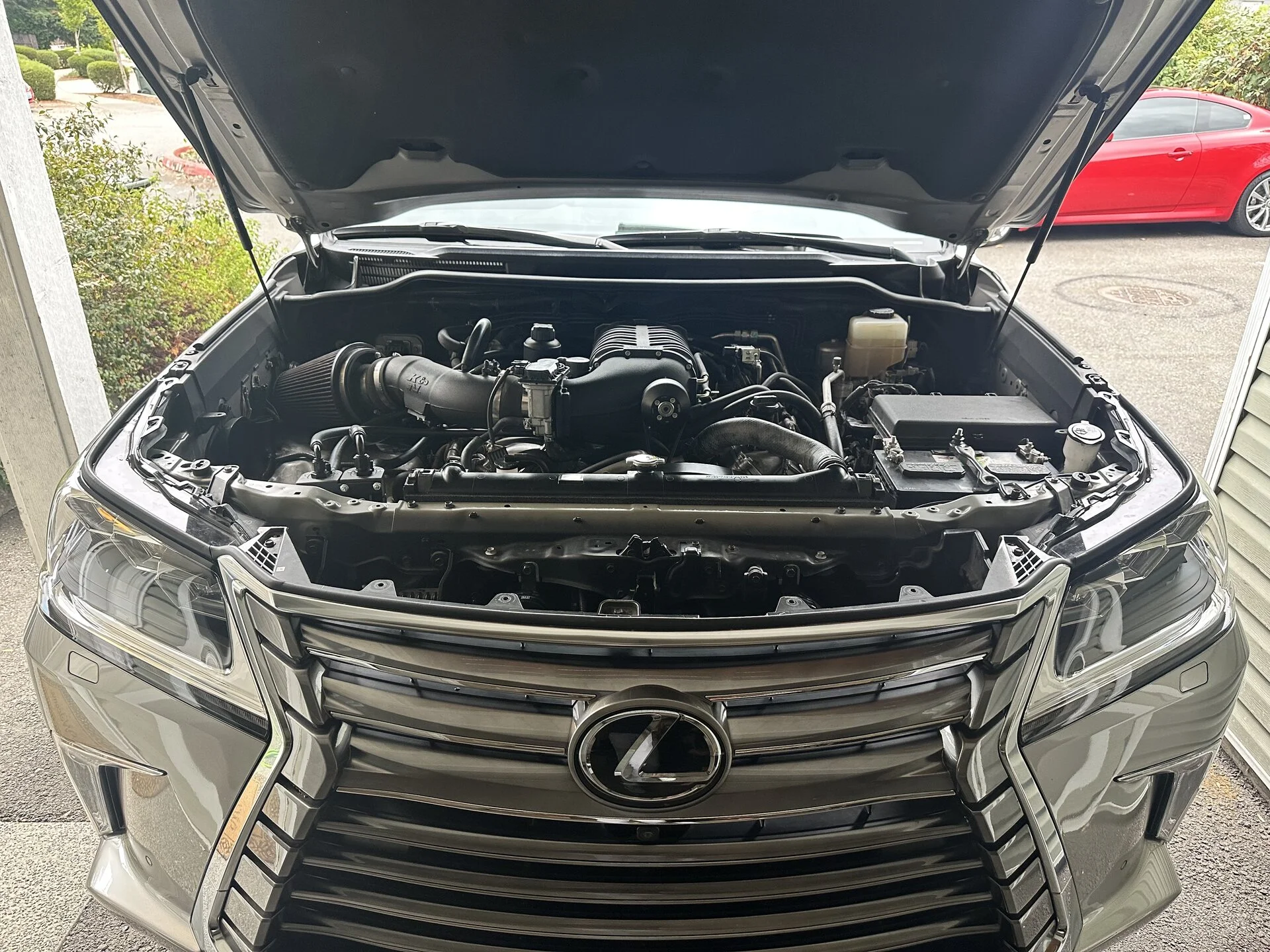

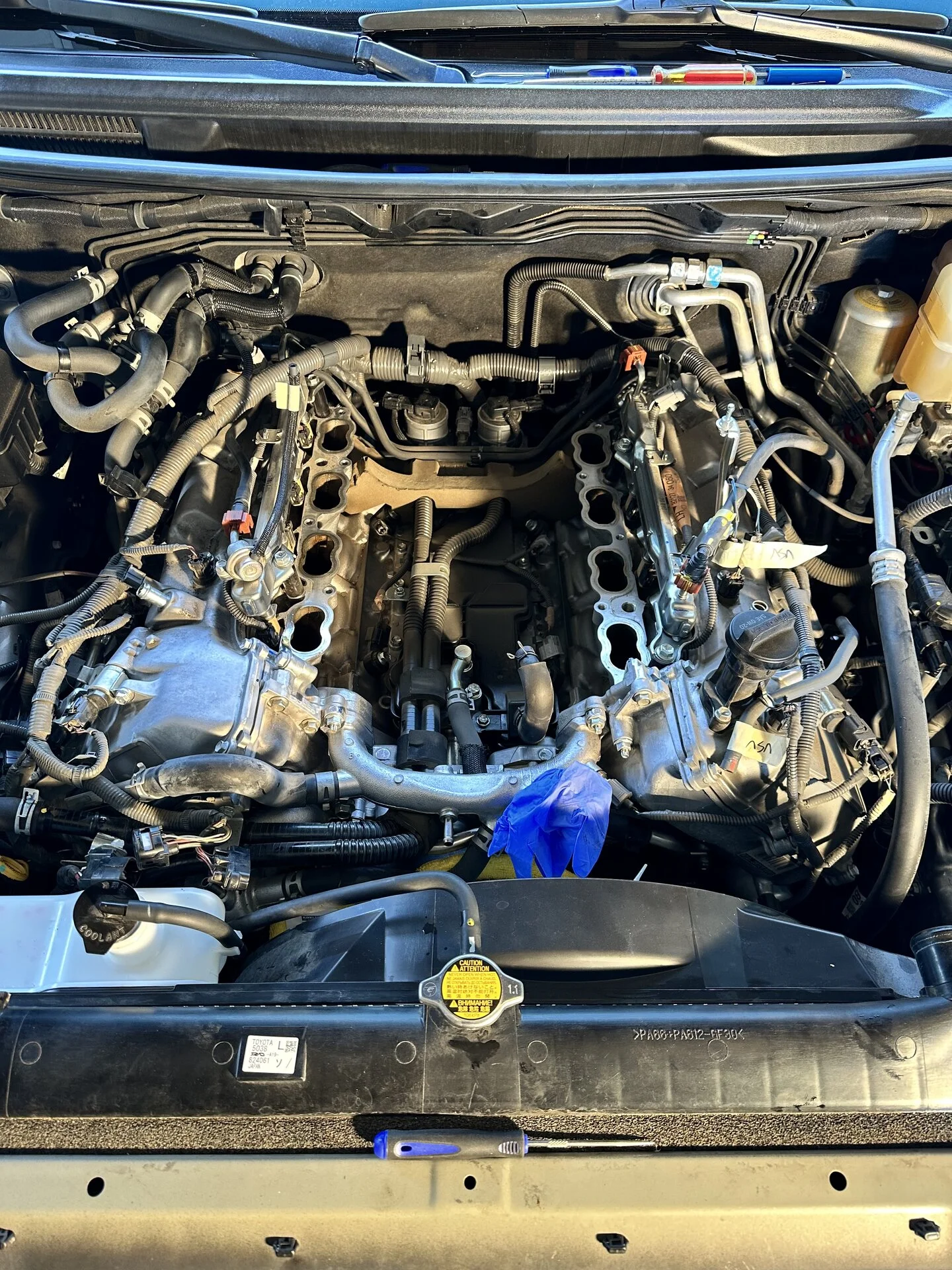

So I purchased my 2016 Lexus LX with the goal of supercharging it at some point. After deciding to go with Harrop I pulled the trigger this June and installed the S/C in my garage over a weekend. Needless to say the install was super easy and straightforward especially with an extra set of hands to help. The truck starts, idles and drives perfectly and if I didn't tell you it was supercharged you would never have known! But there is one exception which happens only sometimes at WOT and that was the transmission not shifting fast enough and bouncing the rev limiter or hitting fuel cut right at redline.
So the next step was to find a tuner and get my truck properly tuned right? Wrong.
There was 0 support for 2016+ models due to the ecu... I pestered so many different shops and tuners but the only one I found was VFTuner aka OVTuning and they said that they did "crack" the 2016+ ecu's but I would need to send my ecu out to them in S. Korea to have it unlocked and calibrated so that a tune can be performed. So I bought a 2nd ecu so that while my first one is sent off I could still drive my truck and thank god for that because long story short it took 5 months to get a working ecu back! It was a roller coaster of emotions during those months but I'm glad to have done it because now the truck drives absolutely perfect!
Those of you guys that want to S/C but are hesitant because of the tuning ecu issue no longer need to wait because according to my tuner I am the guinea pig and they are building a good tune file from scratch. So far we have just baselined to make sure the engine isn't going to melt down and fixed the fuel cut and shifting issues. The next session is to see how much power we can extract and the final session will be when I install the stage-2 upgrades (650cc injectors, 80mm pulley) which should be sometime in January.

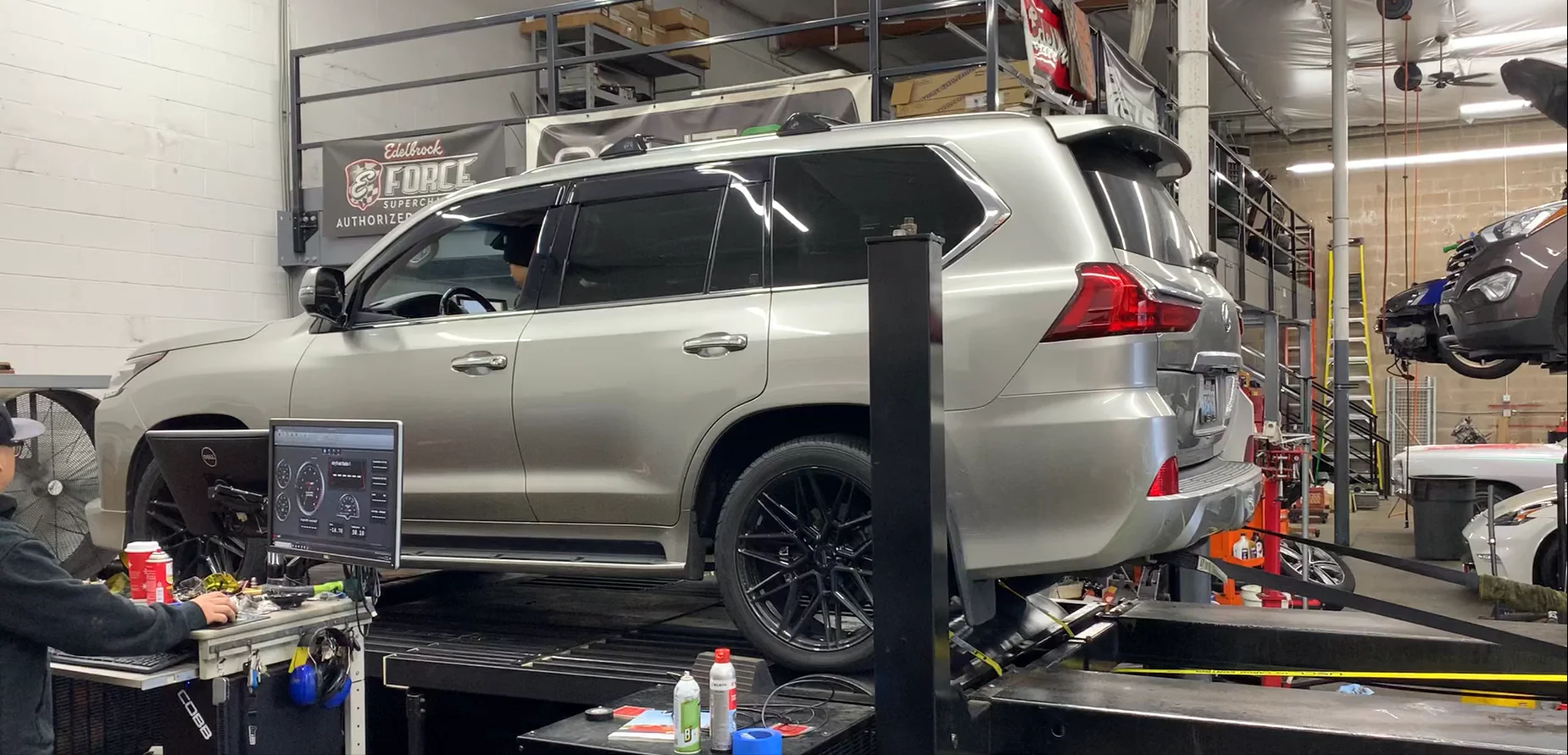

This was my last dyno session over the summer. Currently pushing a tad over 600hp & 620trq at the crank.
Harrop Supercharged Stage-2
80mm pulley
650cc injectors
Walbro 450lph fuel pump
Custom Snivspeed 4.0'' intake pipe
Custom DD exhaust/ muffler delete
Tuned via OTT (Very rich and conservative tune)
3.5'' "fmic" aka heat exchanger on top of Harrop provided HE

Nice setup. How are you running the charged air through the FMIC before it gets to your motor? Any photos of the plumbing?
I took that to mean he put in a thicker liquid exchanger in front of the Harrop supplied exchanger, but I could be wrong
I took that to mean he put in a thicker liquid cooler in front of the Harrop supplied cooler but I could be wrong
Ah, yes, that would make more sense. I would think you'd just replace the supplied cooler with a larger one instead of adding a second one. But I guess that works too.
Dyno numbers were 470hp & 490trq
Although I believe she had a little more to give because that day was insanely hot for PNW'ers. Ambient was 90* and I literally drove 45 mins to the dyno and we immediately strapped her down and ran, and she was extremely heat soaked. The dyno operator was estimating at least another 20-30hp and trq were left on the table.
And sorry for the confusion regarding the massive Heat Exchanger haha.
Yes I am running both the Harrop supplied HE and the significantly larger FrozenBoost HE that looks like a FMIC lol.
