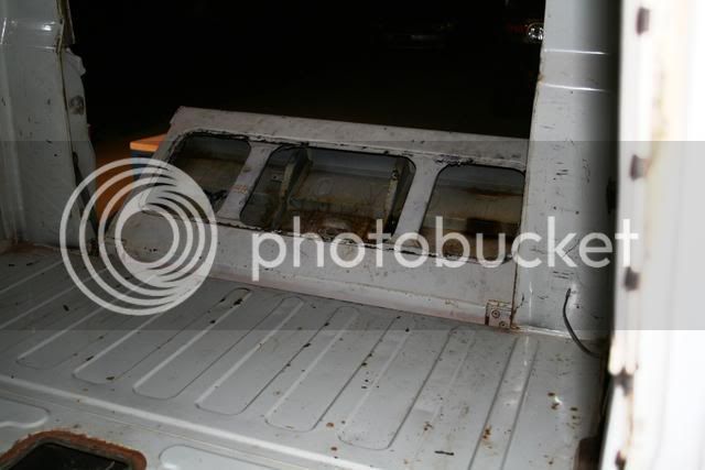

Well...I got off my a$$ and did some work tonight. Many thanks to my brother for coming over and helping!
Now the piggy is naked (well almost) and about ready for some serious sanding, cleaning, welding, and what not.
I did find a good amount of rust on the driver's side, which sucks. But I am going to try to keep after some parts on the piggy that is giving it's parts to make mine whole again.
We haven't pulled the headliner yet...that's tomorrow. Also the front doors and tailgate are still on. I can't get the darn tailgate off because all the screws are stuck. PB blaster is on and I'll just wait to see if I can get them off later. Oh, and I need to pull the glass as well.
Then working on the doors, and then....and then....
Good progress Heather. Your rust doesn't look too bad. Are you set on welding in patches that are factory? Sometimes a little cheap sheetmetal makes the job much easier. I recreated my entire driver's door sill and floor w/ regular old 16 gauge sheet. I'll post pics tomorrow.
Thanks! And I'd like to see pics. I might even try to convince you and your wife that you need a day in ATL...I sure could use a little welding help. :) I am not set on getting stock patches, but if I can get them, I am going to try this weekend (or maybe I'll have to take a day off to have enough time). :grinpimp:
Um...my welding skills :censor:. You probably want Richard, Marshall or someone liek that to teach you how to weld. My welds are ugly but they work for a trail truck. I would be happy to come down some day and work on the Piggie and even weld if you sign my disclaimer!
