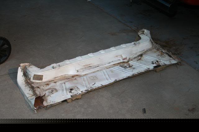

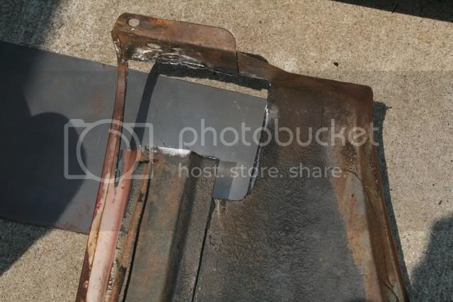

I have a few of the donor piggy and the floorboard and other stuff I scavenged. I'll have them up when I get home from work tonight! I will also be finishing taking all the stuff off the truck for cleaning and painting, so I hope to have some pics of that too!
Here are the pics of the donor pig and the giant hole we cut in it. Also pics of the parts I picked up this weekend.

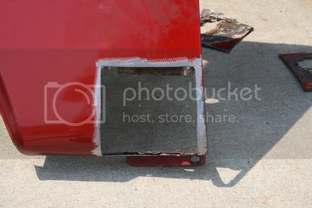

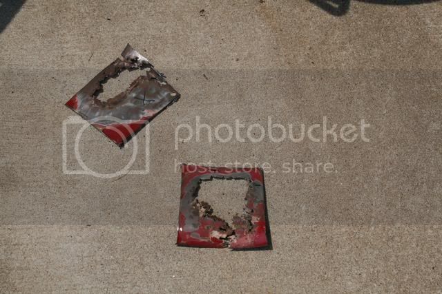

Anyway, I did make a decision about the fenders today and Steve (eventhough) helped me to cut out the cancer on the front fenders and we began fabbing up a patch. Slow and steady...Miss piggy will be on the road and better than ever soon!
