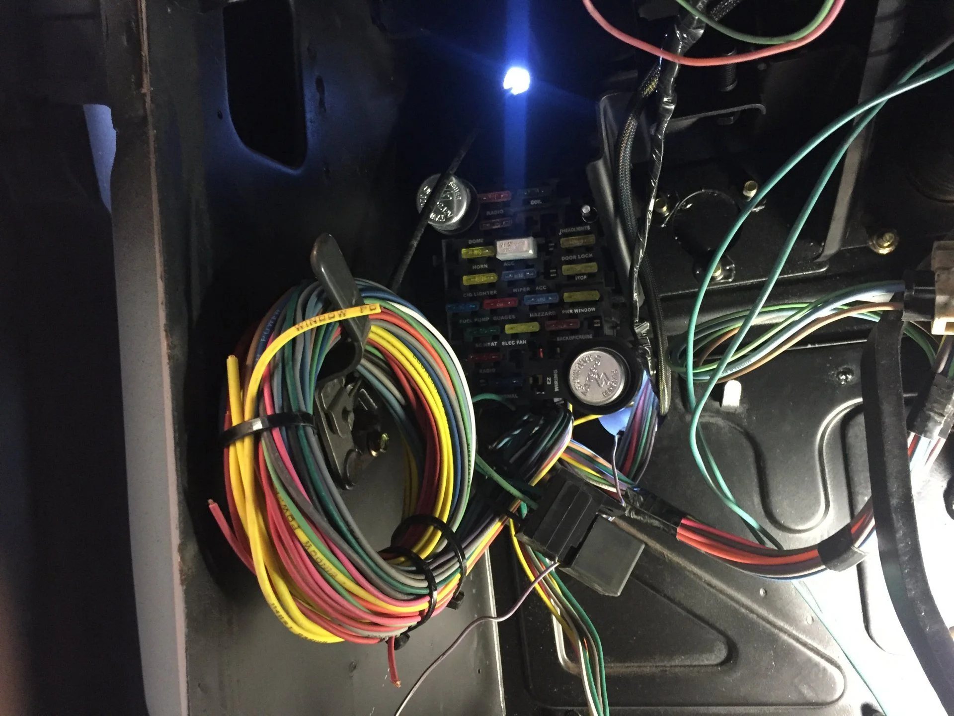

Anyway, I placed the fuse panel in its final place on the firewall and started hooking up the basic connections. My goal is to be able to run it on and off the trailer as I drag it to do my painting. I should be able to start it up tomorrow and get it up to temp now that I have the radiator in and all the pulley driven items connected.
Who knows, maybe I'll get brave and see if I can pull it out of the garage under its own power. Maybe even get crazy stupid brave and drive around the block.
I assume that is a Painless Wiring, or similar multi-use kit? I also assume you cut it into the firewall like a stock GM setup?

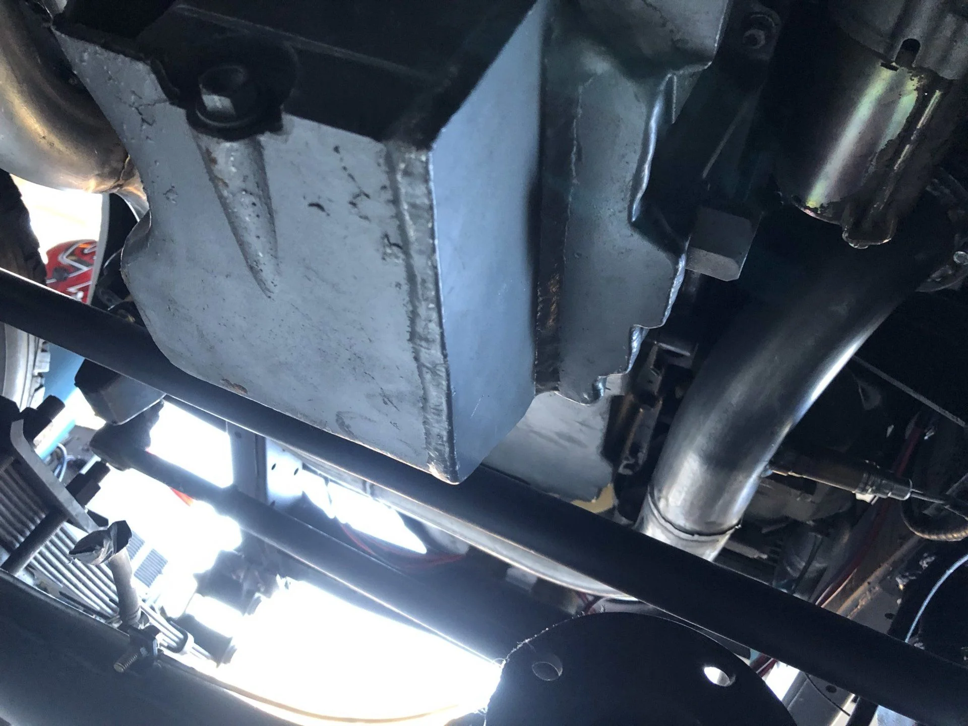

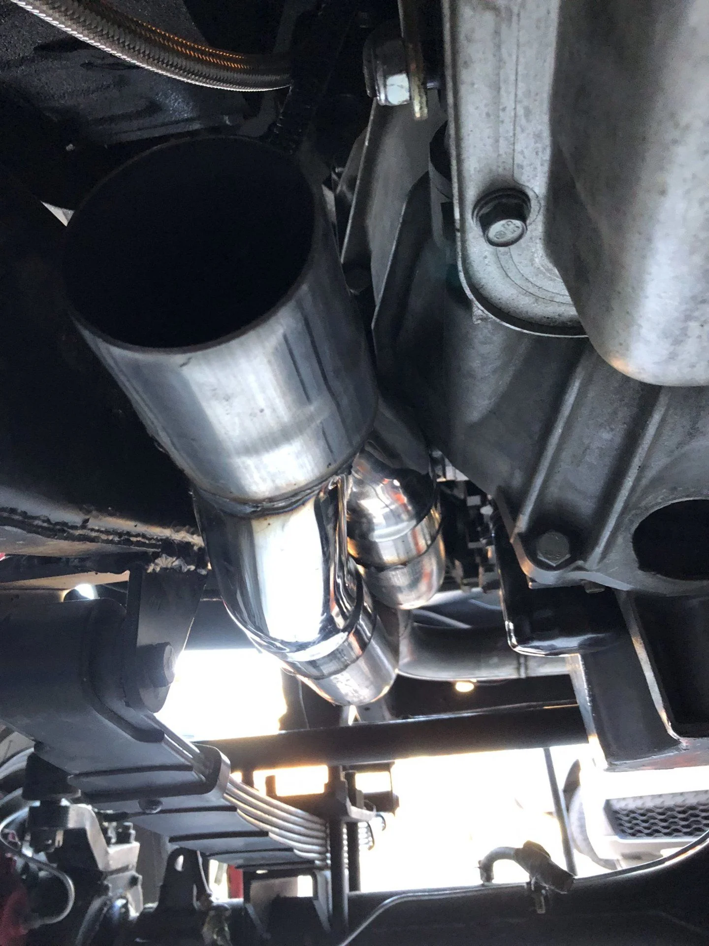

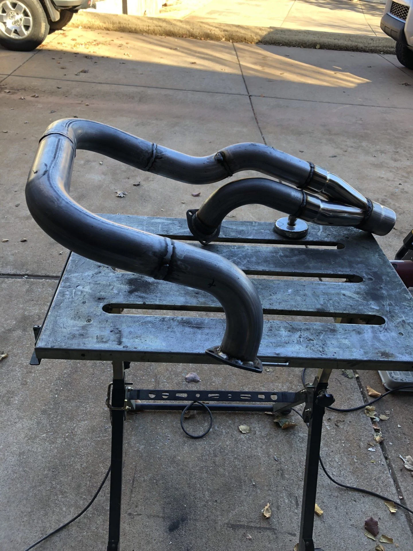

I then focused my energy to other items needing my attention under the vehicle. I built up a cross over pipe for the exhaust. PITA since my high steer puts the tie rod on the rear. I had to drop down and wrap around the front of the oil pan. My SOA is high enough I could have dropped under the pan but it wouldn’t be nicely tucked in. I never do things the easy way. I had it all welded up and installed and the driver’s side O2 sensor hit the frame so had to completely remove and reposition.
You obviously have mad skills.... do you have a bender or did you buy bent sections and invent this? I'm kinda worried about how to run the exhaust...
Ez-wiring harness but from I understand it’s pretty close to the painless but less expensive. Not sure about what you mean about cutting into the firewall. I just bolted fuse panel in and ran wires.
The GM ones, that look like that, actually fit in to a hole in the firewall. The fuses fit and look like that, but most of the wiring comes out on the engine side. The engine side bolts to the interior side with a thru bolt.

I was talking about your exhaust cross over. I think I responded wrong to the pictures...

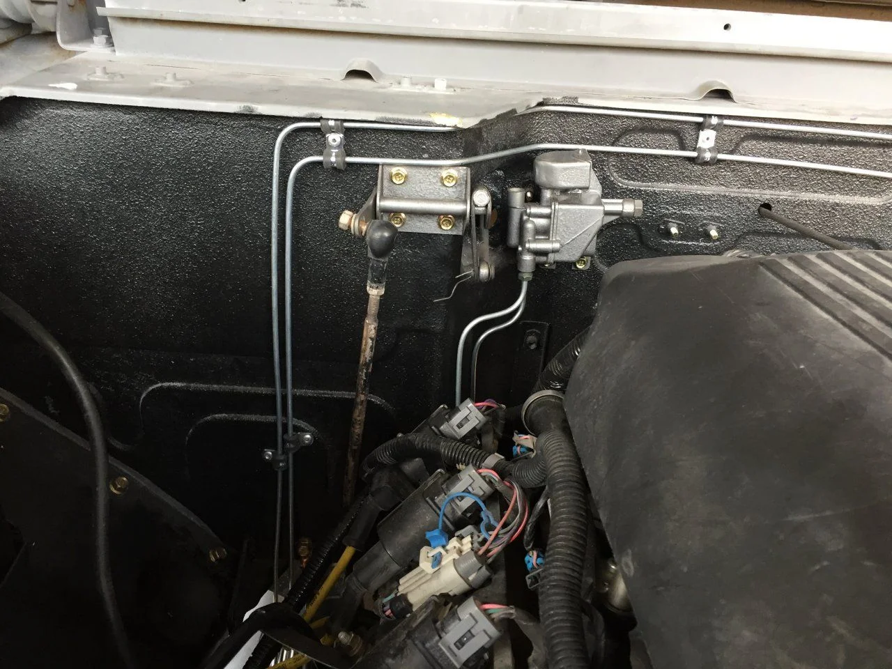

In that first pic,, what is the device with the two vertical brake lines going up in to it?
That’s the vacuum valve for the 4wd selector. I kept the stock vacuum selector because I liked not having a lever sticking up through the center hump. Kinda cool just to pull a button on the dash to engage 4wd.
