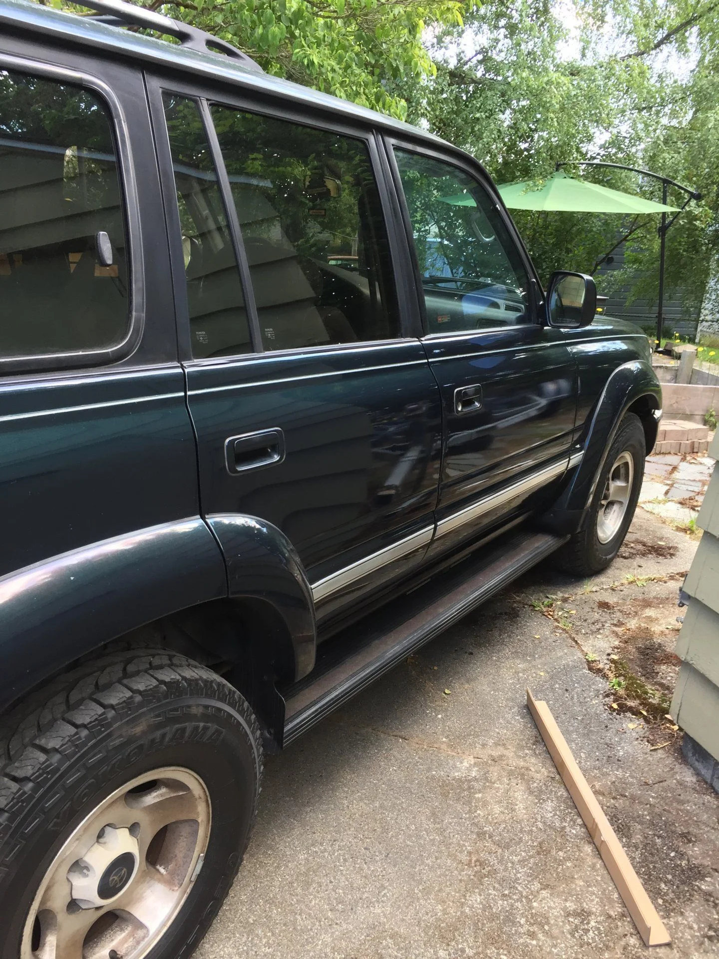

Hey, so here are some pics of the rig.
It's a '94
Has all of the locks
173k on the odo

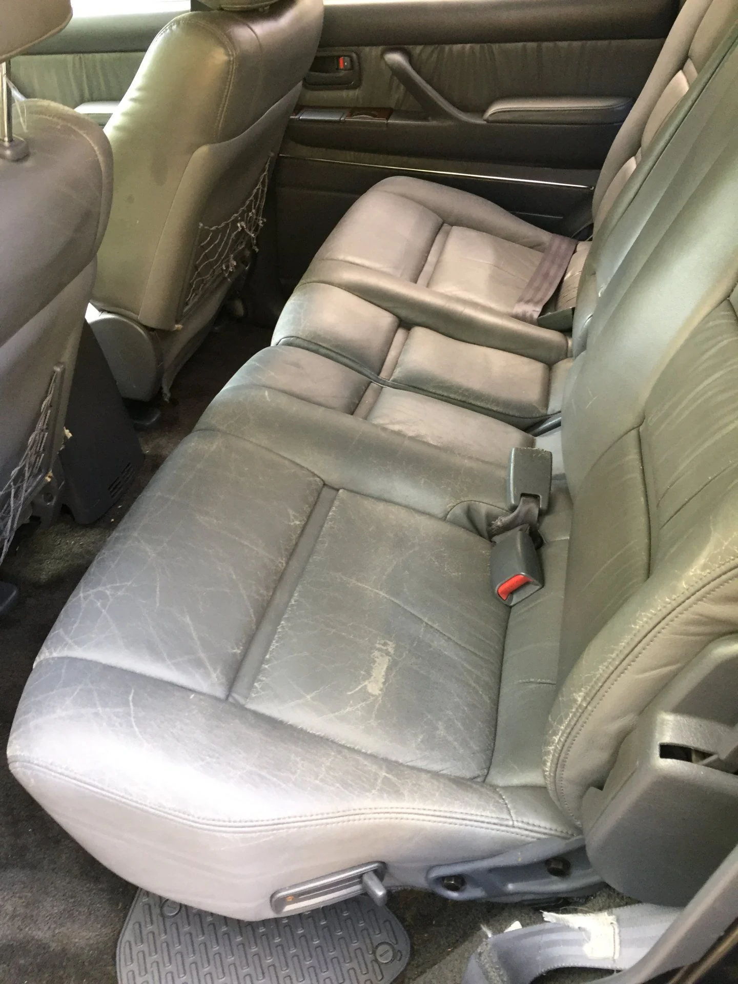

fairly distressed leather.

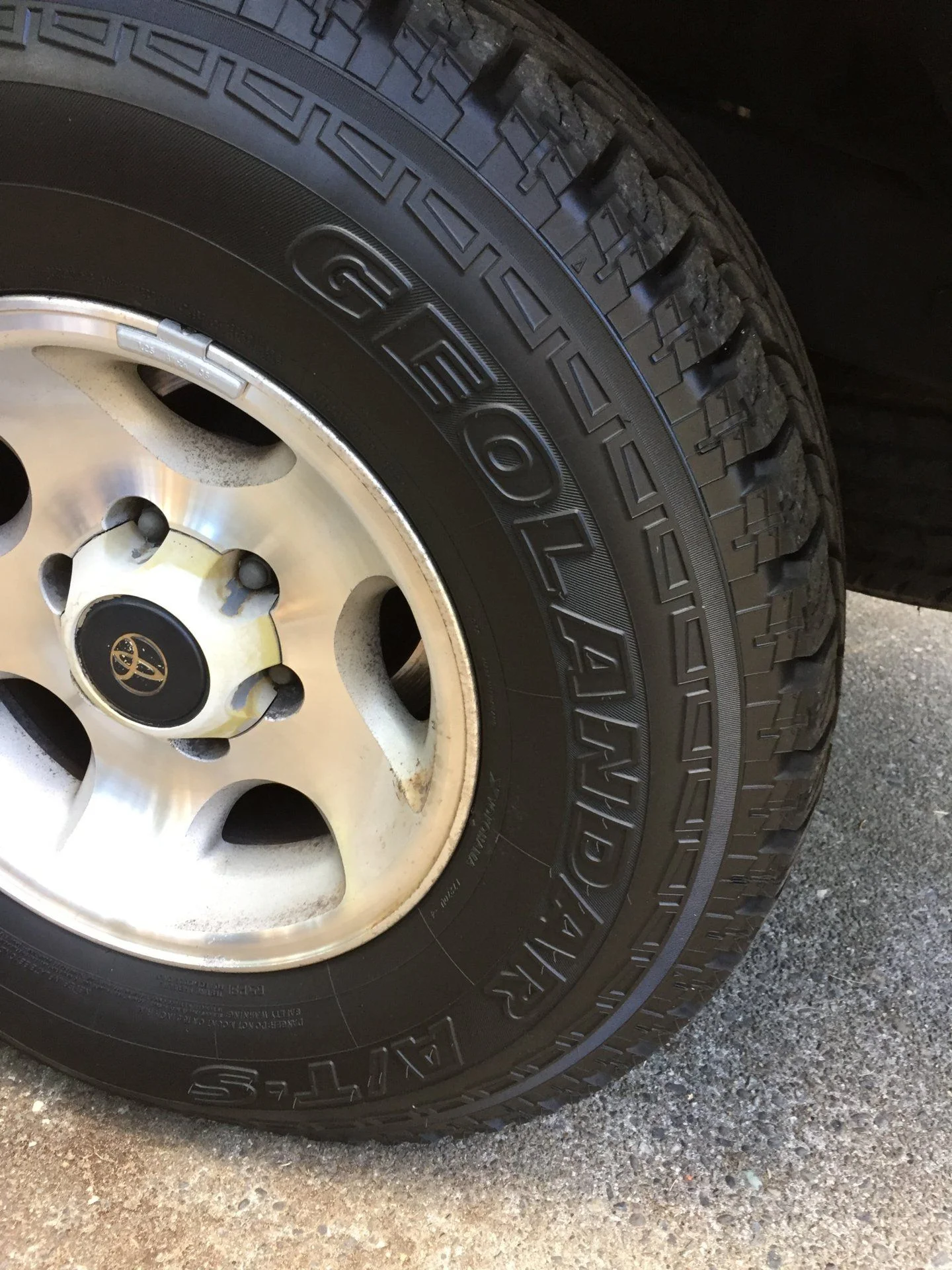

fairly new tires (Yokohama Geolander at/s in stock size)

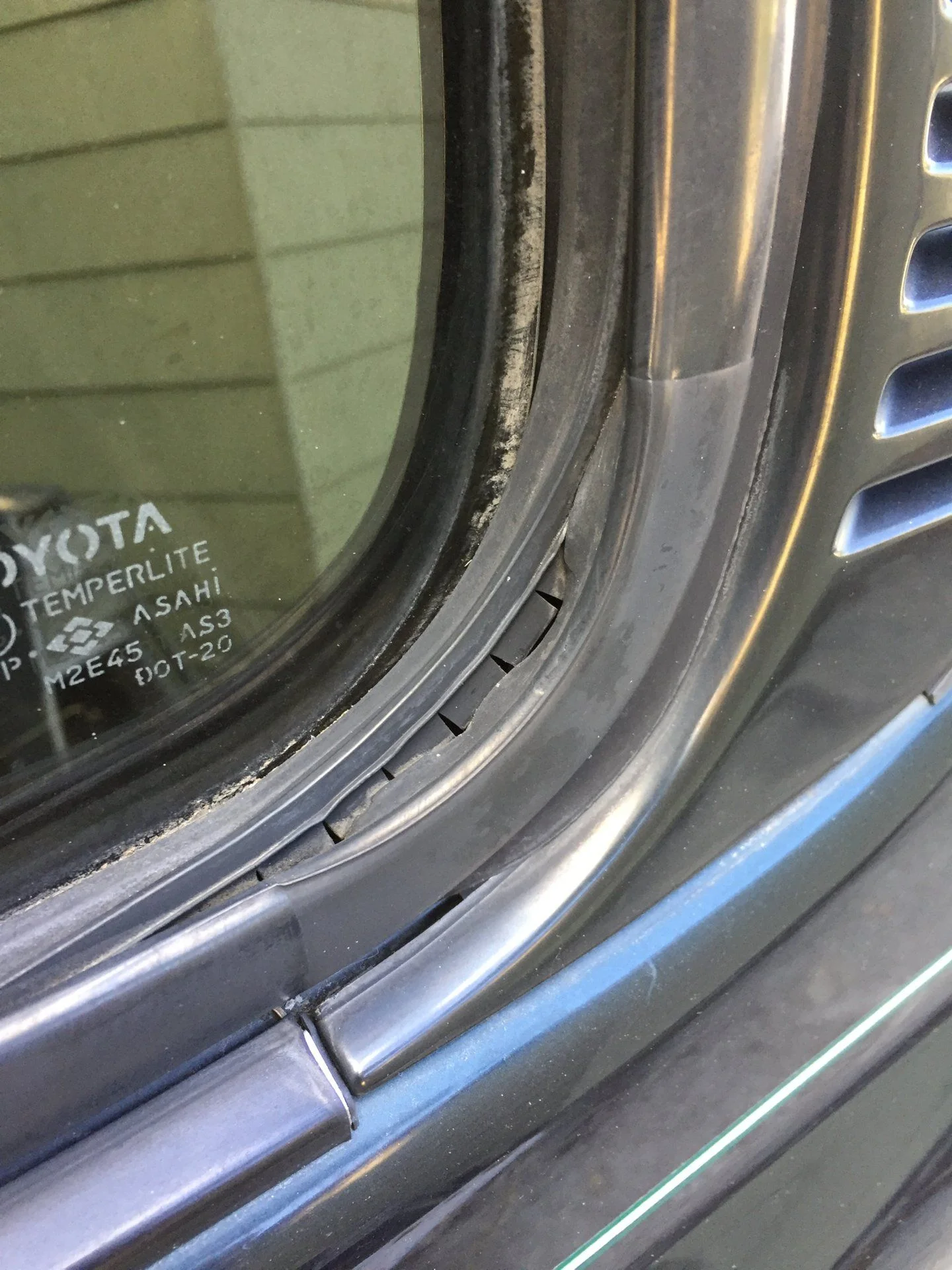

Things of concern; Yellowing of heater control valve, definite issue at rear drivers side slider window gasket, some oil/grease/fluid underneath (need to clean more, and watch for new seepage to determine source), missing antenna mast, center diff lock light will not turn on, rear passenger window seems to be dodgy/partially able to get off track, nicely yellowed wheel center caps, missing one rear wheel lug, etc etc

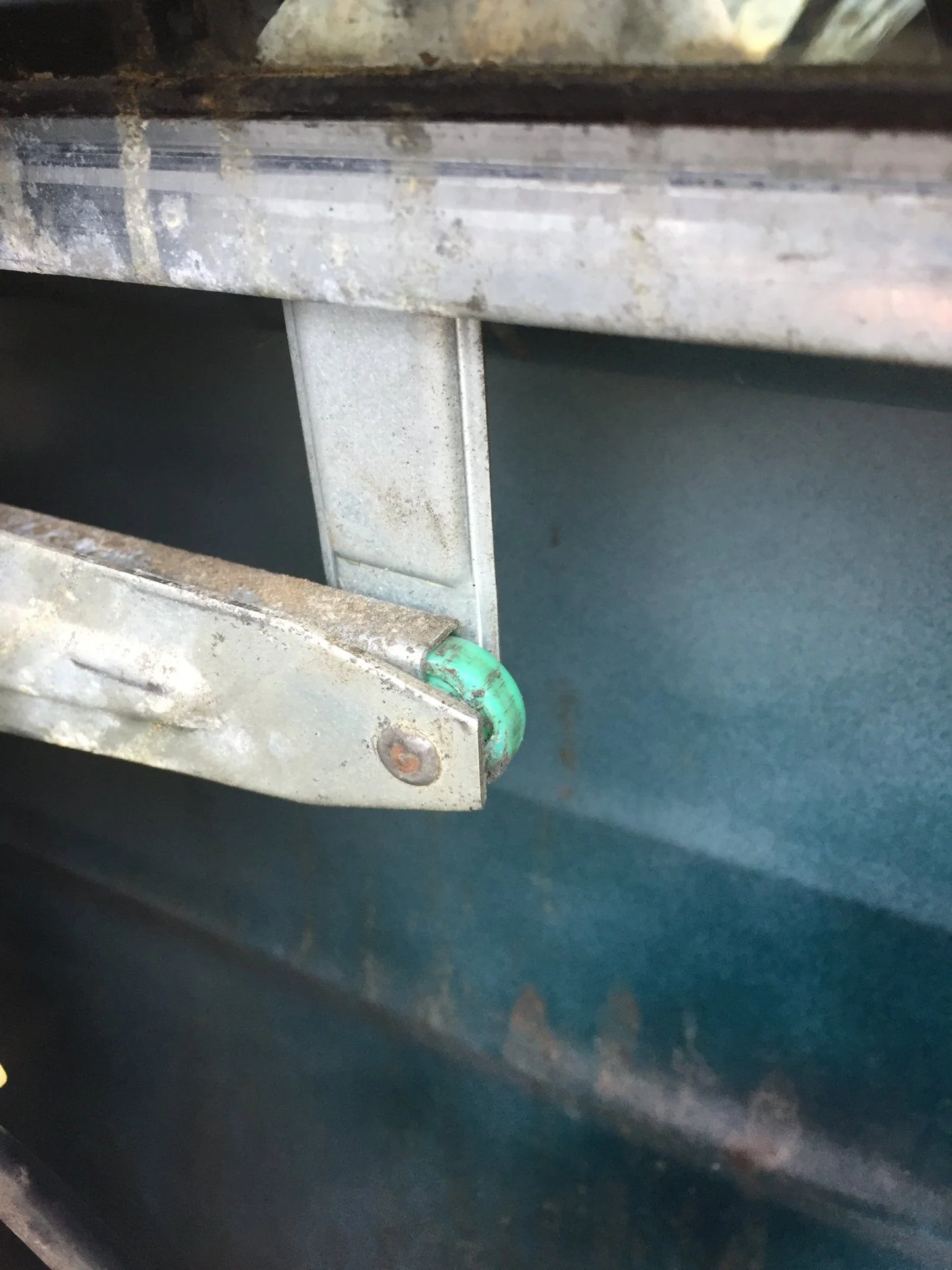

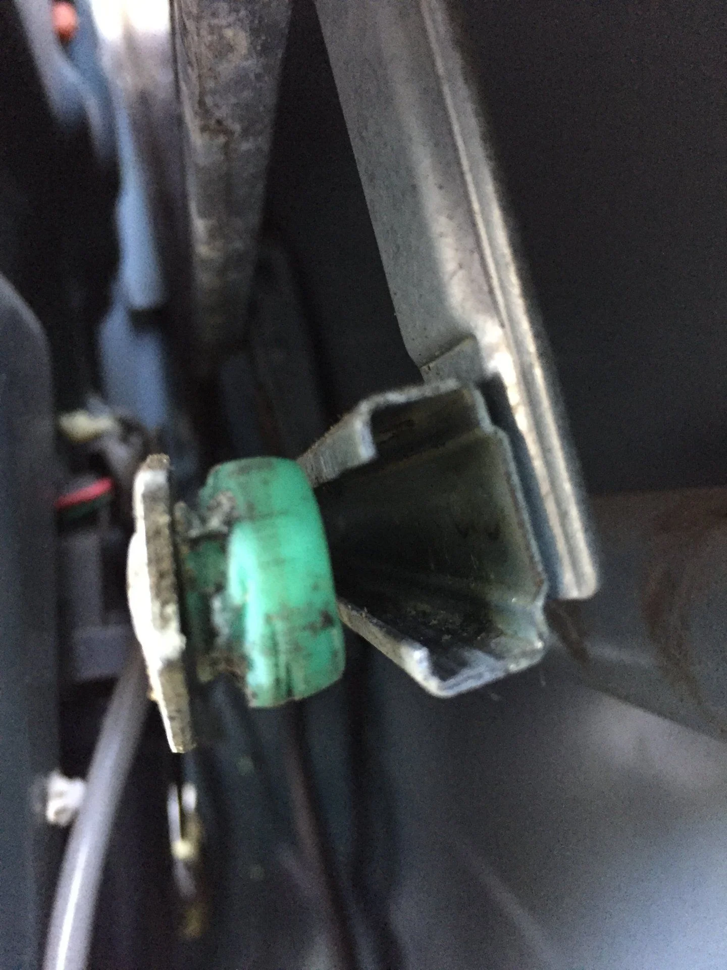

I found the passenger rear window issue. It seems like there's a point in the travel of the whole mechanism where the wheel can simply run out of the track. The wheel is fairly worn which can't be helping. I got it back in the track, lubed the channels and the track a bit and cycled the glass a few times. Everything seems ok now.

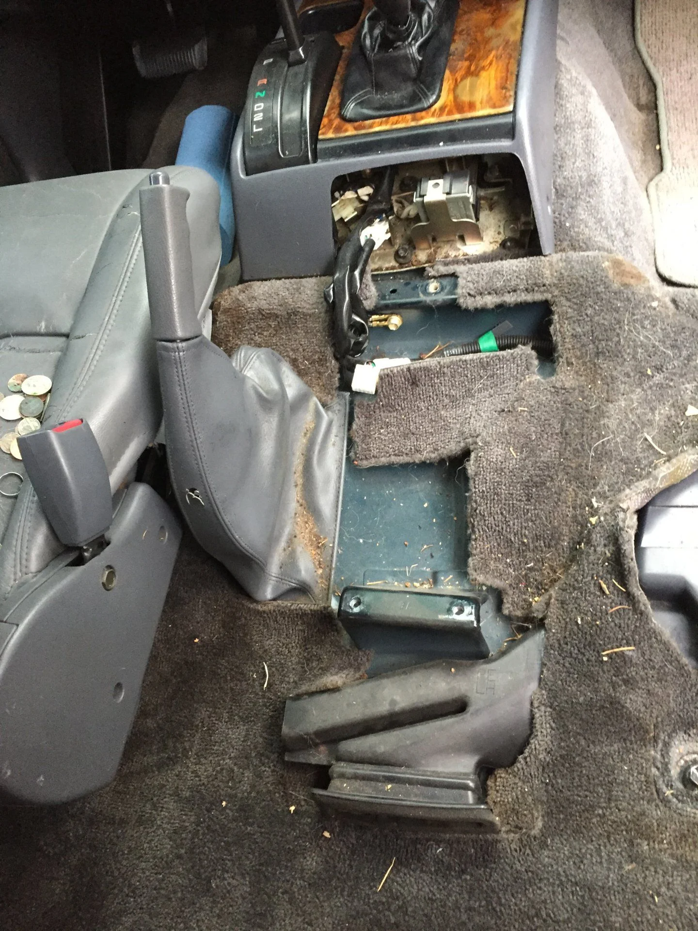

I've mostly been dismantling the interior stuff to get looks inside things (i.e; the stuff I can do without driving it, and without buying parts)
I'm really impressed with the basic lack of rust in this truck. I did find what I think is just an exposed end of the washer fluid hose which should lead up to the rear hatch nozzle. It also looks like that hose is "NLA" on the parts sites?
I'm missing that cover that allows access to the torque converter bolts. And it seems like my dash has definitely been apart before just judging by the missing screws.
