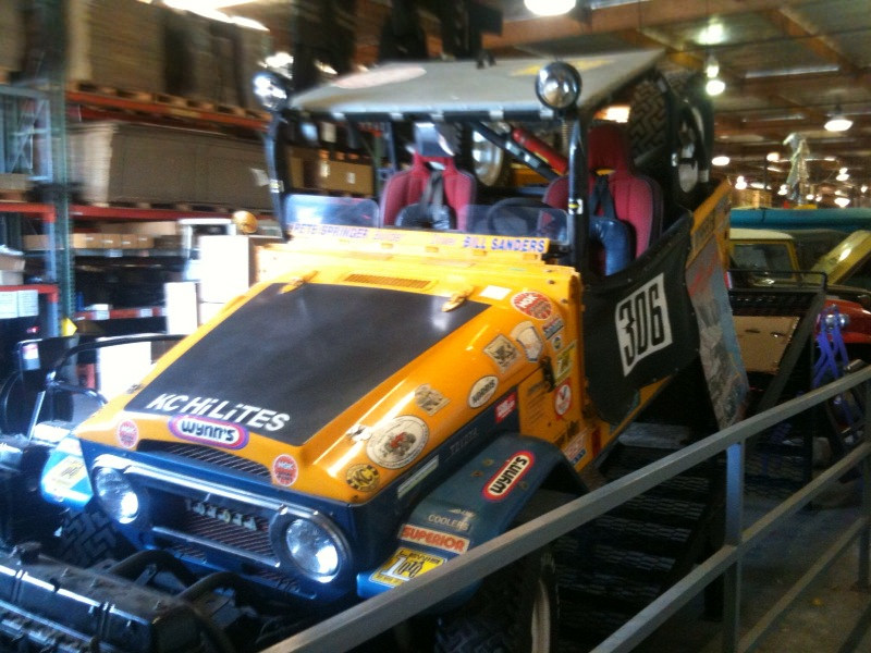

The best part of going there tho is the mini-museum they have as you walk in the building. An amazing display of LC's from all over the world. I snapped a few pics when I was there last.

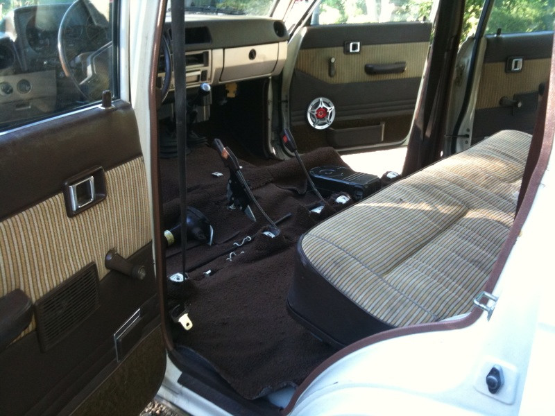

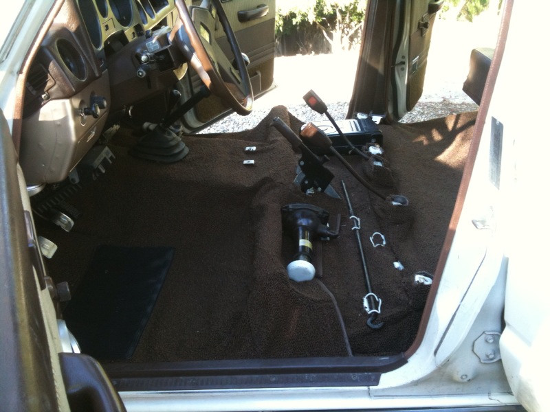

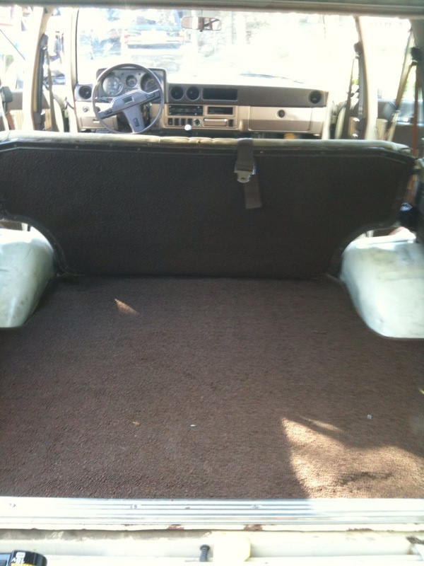

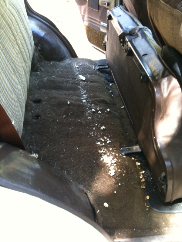

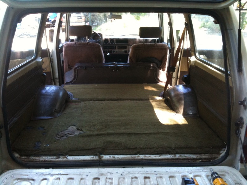

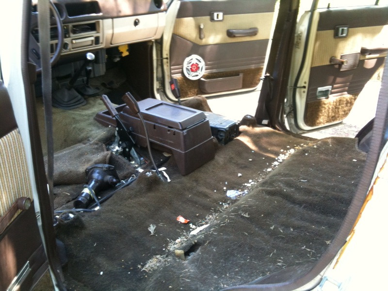

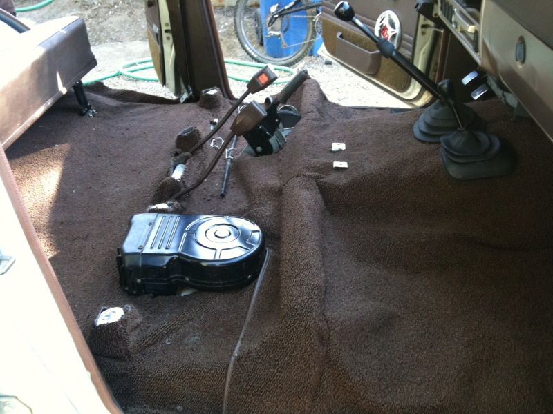

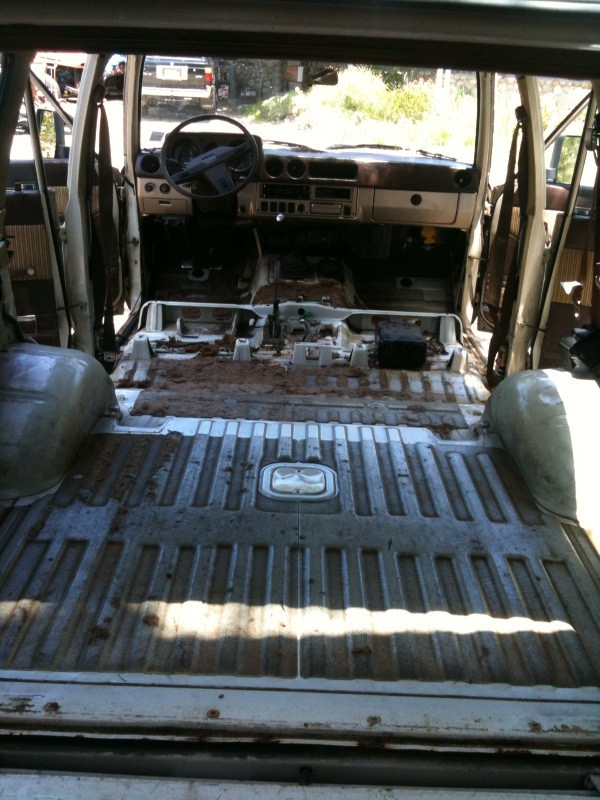

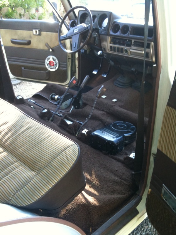

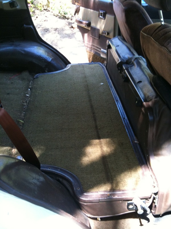

OK, carpet went in today.

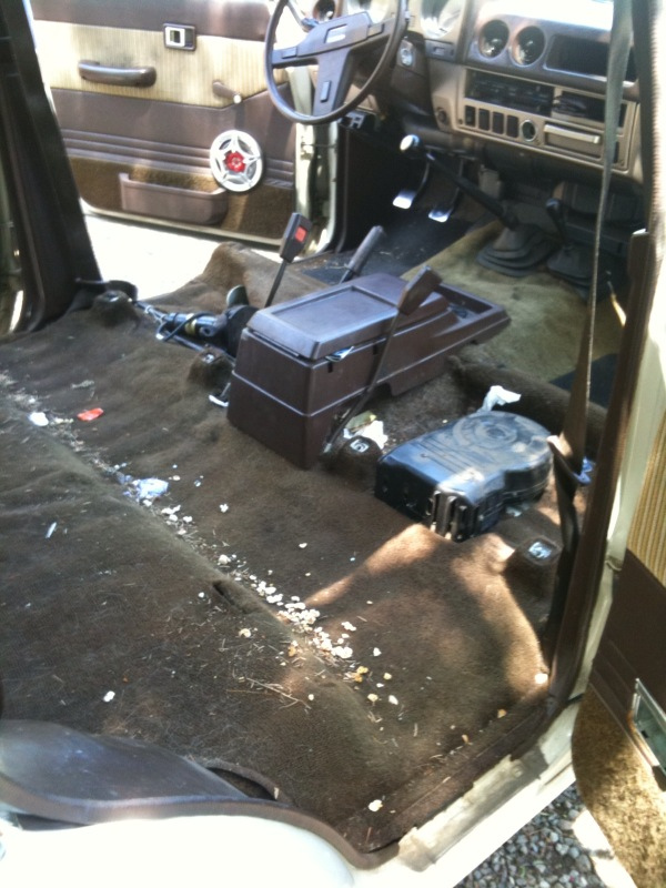

Let me tell you, if you have the original carpet in your cruiser, replace it. Like, ASAP. 28 year old automotive carpet can hide a lot of crap. A couple of pounds of spare change, a bag or 2 of spilled sunflower seeds, lots of spilled soda/coffee (something sticky), popcorn, pet hair, pine needles... you get the picture.
Anyway, I pulled the old carpet, did a thorough rust inspection and cleaned the hell out of the floor (removing said crap, as well as the old wool insulator). I did not do a secondary insulation at this time, as I plan on pulling this out once more when it goes for paint.
Ill let the pics do the talking for the rest.
Old rear carpet
Old center carpet
Seats out

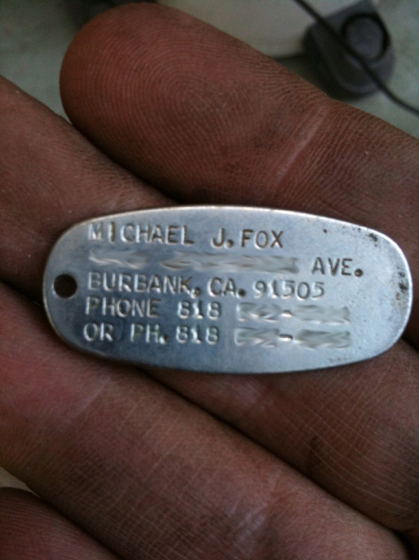

Amazing the things you find
Every wonder who may have owned your cruiser in the past?
Carpet out
Front and center (post cleaning)

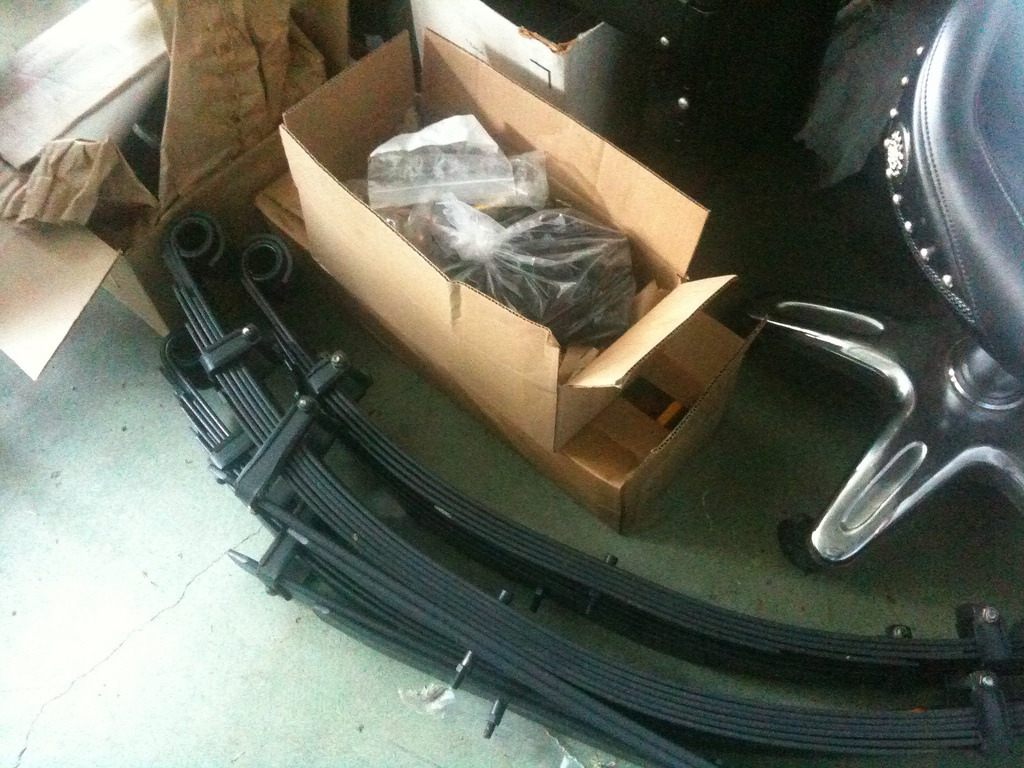

July will be the month of the lift kit (after I get back from vacation on the 11th).

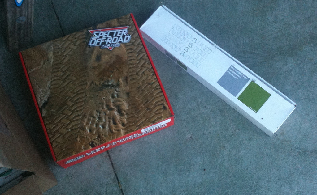

I have the lift kit (OME MAF 3" with shackle reversal), complete axel rebuild kits (front and rear from SOR), all new tie rod ends and relay rod kit, and finally all new u joints. So, once I get working on the lift, Ill go through both axels, steering and u joints. And clean the hell out of everything.
I also got another load of stuff from SOR; Headliner, SOR rear sliding cargo windows, windshield gasket and Hella H4 headlights!
This mess should get me through the next month or so in parts. More to come soon!!
Springs, bushings, shackles, etc
Front axel rebuild kit & U-Joints
Rear axel kit and TRE kit

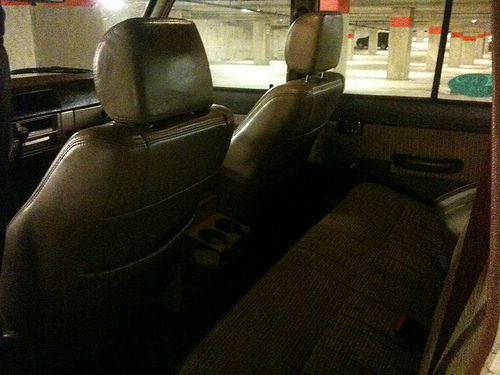

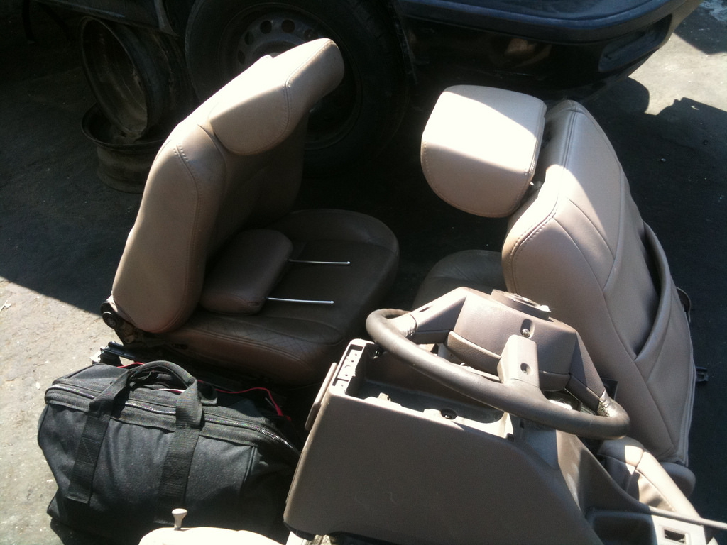

Finally made a decision on seats;

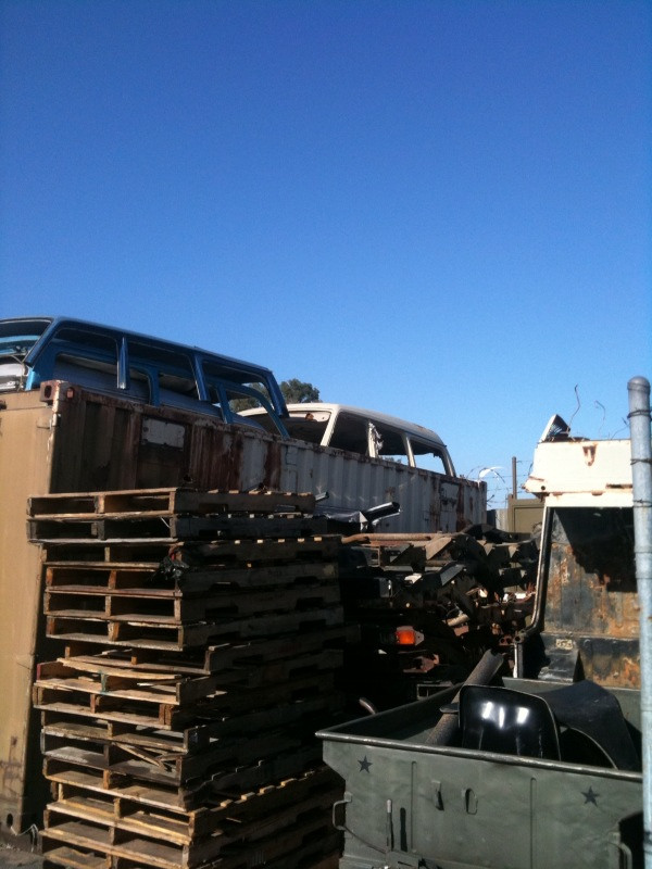

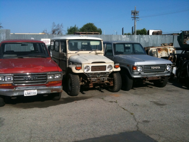

I went to the junkyards yesterday with my dad and my nephew, looking for parts for their projects ('65 Caddy Eldo convertible and a '53 F-100).
While at the Pick THE Part in Santa Paula I stumbled across a pretty decent white FJ60. Mostly there and very little rust. If anyone local needs some 60 parts, head on out. Its in the last row on the right hand side. Right about... HERE
We also headed to Pick A Part and U-Pick-Parts out in San Fernando. My dad was looking for a tan center console lid for his '95 4Runner and we found one a great donor vehicle. The interior was the tan leather, was in great shape and 95% complete. So, we gutted it! I'll be running 4Runner seats soon! Once we got them home, I did some measuring, and its remarkable how close the mounts are. Front to back is identical, and the width only needs to be narrowed by a small amount. Cant wait to get them installed! Unfortunately, thats going to have to wait for a couple weeks since I am going on an extended July 4th camping trip. Leave this Friday and get back on the 11th. So, no work on the 60 until the 17th! :bang: :bang: But, thats when Im going to start pulling the suspension apart too! Can't wait! :clap:
Anyway, here are some pics of the new interior;
My nephew standing next to the donor vehicle and a pile of interior parts
The seats! The center console is for my dad. This model had the rear heater (which he has always wanted) so we pulled that too.
The (near) complete haul! I also pulled the rear seats since the price was so good.
We pretty much gutted that poor 4Runner. Front seats, rear seats, center console (dash to back seat), rear heater, steering wheel, O-s*** handles, plastic molding, etc, etc, etc. The front seats are definitely not 100%, but they will be great until I can get someone to recover them for me. I got the complete haul for $150! Can't beat it!!

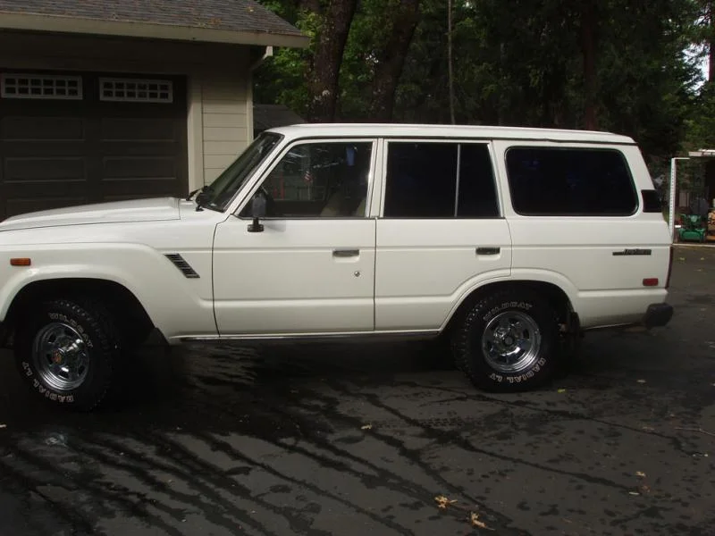

P.S. couldn't resist posting a pic of my new white 60 - hope it follows a similiar path as yours soon :cheers:

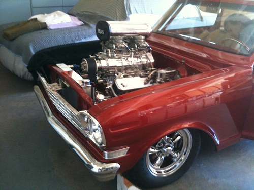

Its been a few weeks for an update, but that doesnt mean Im not getting anything done. I've been helping out with some of the old guys toys (read; my dad and some of his buddies).
This one just got done, including new interior. This Nova belongs to a friend of my dad.

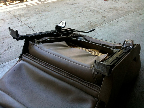

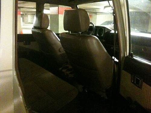

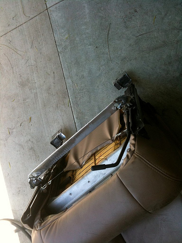

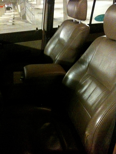

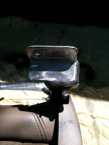

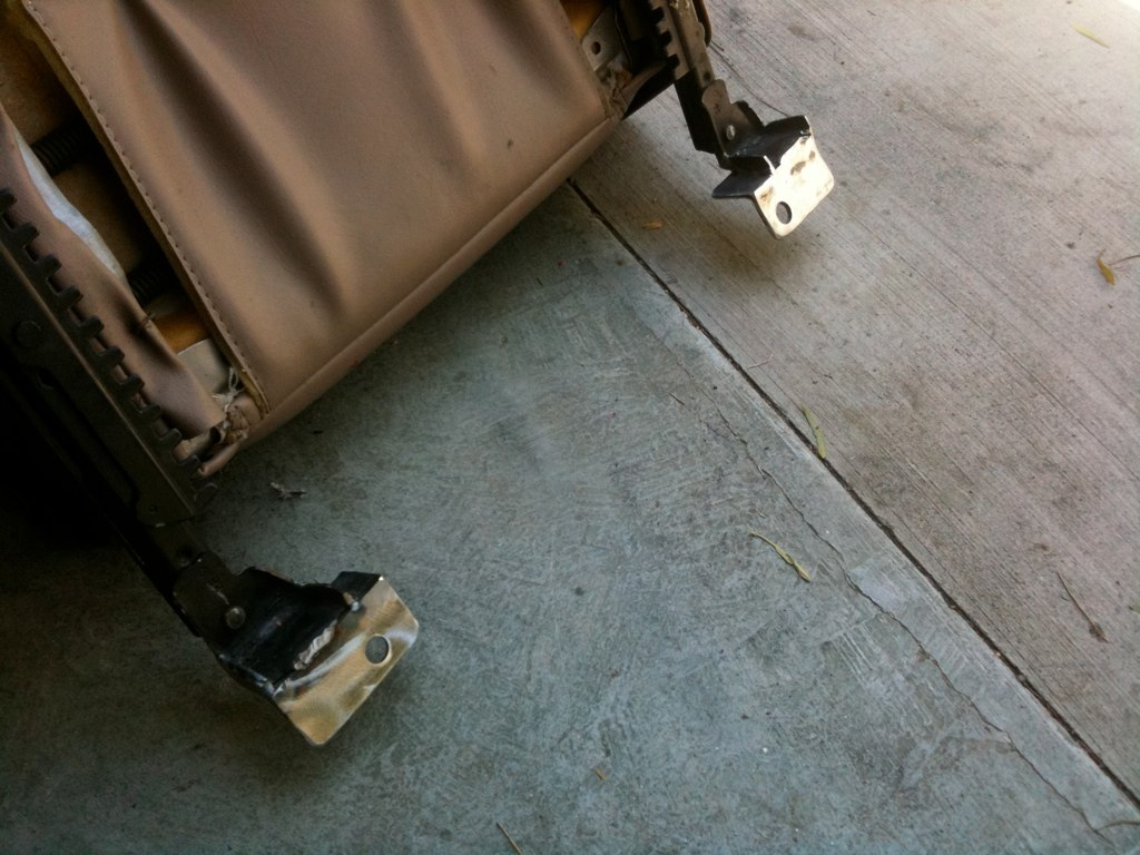

I got the seats installed, as well as a new 8" Tuffy console and a steering wheel. As I mentioned before, I pulled these seats (and steering wheel) out of a junk yard 95 4Runner, so they are not perfect by any means, but they are light years ahead of my stock 60 seats - and COMFY! :steer: . At some point Ill get them recovered, but they will last a while in their current state.
The 4Runner mounts were 1.5" too wide for the LC mounts. But the front to back measurement was exact. For the front mounts, I trimmed the inner mount (to clear the curve of the tranny tunnel), and ran a piece of 1.25" flat stock between the 2. Then drilled new holes the appropriate distance apart.
On the rears, I cut off the tabs, and welded on 3" long pieces of 1.23" angle. Ground them smooth and drilled new holes. Thats it. Worked great. Take a look.
This is the PS seat. Ive already cut and clearanced as mentioned above.
This is the new front cross rail, with mount holes drilled.
These are the first steps complete of the new rear tabs.
Cleaned up a bit. Deburred and sharp corners and points removed so rear seat passengers wont cut their feet.
Font seats in (sorry for the s***ty pics in my work parking lot). You can also see the Tuffy and the new steering wheel (sorta) in these. Ill get some better daylight pics at some point.
