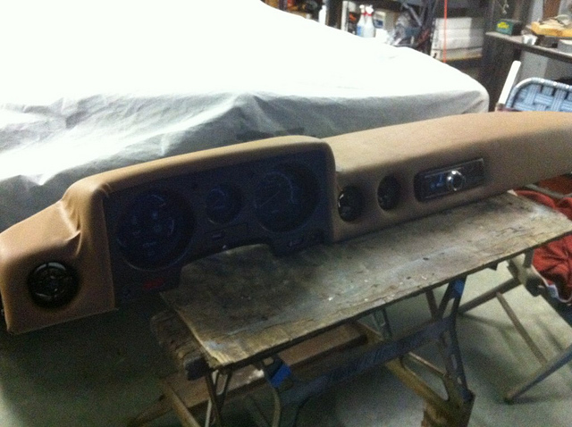

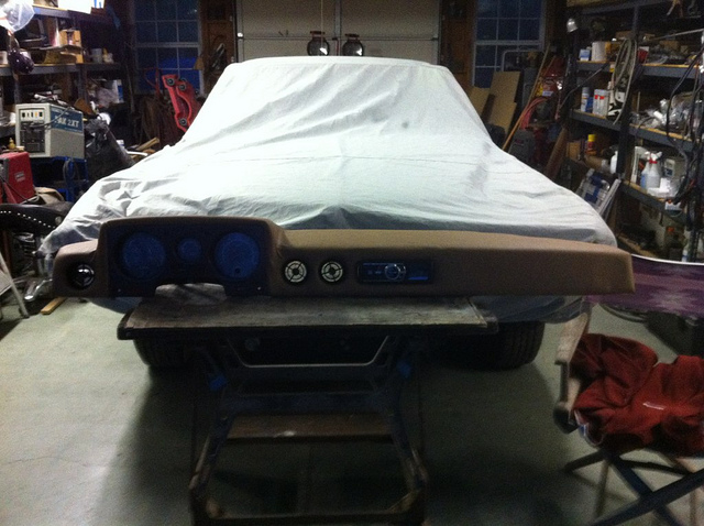

I also attempted to recover my dash but I'm not happy with this attempt at all. I knew that this would be a temp version, but I didn't know I would be this unhappy with it. While the vinyl that I am using works great for the door panels, it doesn't have enough stretch to conform to the curves that our dash boards have. Ultimately I will redo this with a completely new dash panel and graft in some additional pieces that I would like. Including mounting in a second "radio slot" above the glove box. This would house a HAM radio. At that time I may also modify the way the gauge bump flows back into the dash.

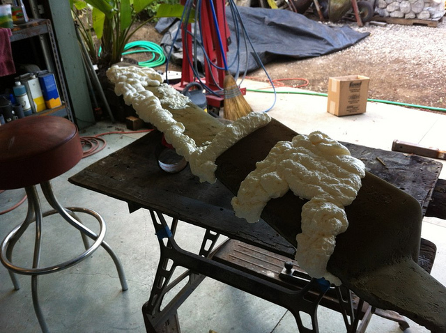

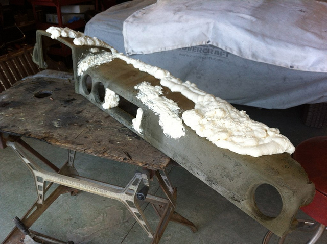

Anyway, I pulled off the dash cover, and then completely removed the factory vinyl. I then cut out any foam that was cracked, split or other wise damaged. I then filled those holes in with a two part foam:
I let that foam cure for a week and then filed and sanded it down and matched the shape of the dash. Interestingly enough the density of the 2 part foam matched that of the factory foam pretty well.
Once I had that all ready, I attempted to cover it. That's when it went bad. Not a total waste, as I learned quite a bit about the process and its livable for now.
You can see here the amount of folding I got on the edge of the gauge bump:

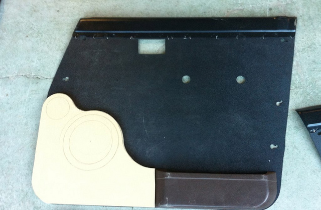

One pic I forgot to include on my door panels was on that includes how I am going to re-use my door pockets. Moving them towards the back of the door, and using their lines to build off of for the speaker pods.
Dude I need more close up pics of your new doors if you have them.. This is something that I am going to attempt this summer and want to retain the old tops like you did but put vinyl over them. How much was the ABS plastic vs. going with something like Reevsci did (1/4" MDF). You definitely gave me some ideas for the speaker pods for my new Fosgate 6.5" speakers.
Hey Greg,
I'll get some more pics of these once I get the process worked out. I actually plan on doing a complete write up for this one, seeing as how not many have. The short version on the door panels is;
  • Salvage the old metal tops. Sandblast, paint, powdercoat, whatever. Its amazing how rusty they are under the stock vinyl.
  • I used ABS for several reasons;
    • I wanted an additional layer of moisture resistance between the door cavity and my speakers.
    • I needed something more stout than thin MDF to mount my speaker pods to.
      • BTW, factory panels are only 1/8, not 1/4. Running thicker becomes an issue if you want smooth action on your window cranks and want your door release to mount and look right. This is why you see the relief around the window crank on my design sample.
  • My speaker pods are a little thicker than necessary for most installations, but I think you will want to run them as thick, if you are going 6.5" speakers (like I am). The reason being, moving the speaker mounting surface away from the inner door skin, allows you to lower the overall height of the speaker (without cutting into the inner door), moving it AWAY from the window crank and giving you more room to roll your windows up/down without hitting your knuckles.
    • My front pods are 1.25" to the mounting surface, plus an additional .25" that essentially recesses the speaker into the pod.
    • My rears are only .75" + .25"
Everything else is just design. But put some thought into it before you start. The hardest part is attaching the metal tops to the ABS.
