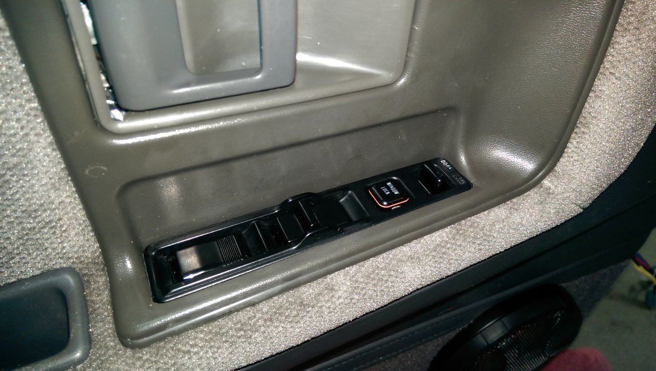

Windows & lock switches. They cleaned up pretty well...

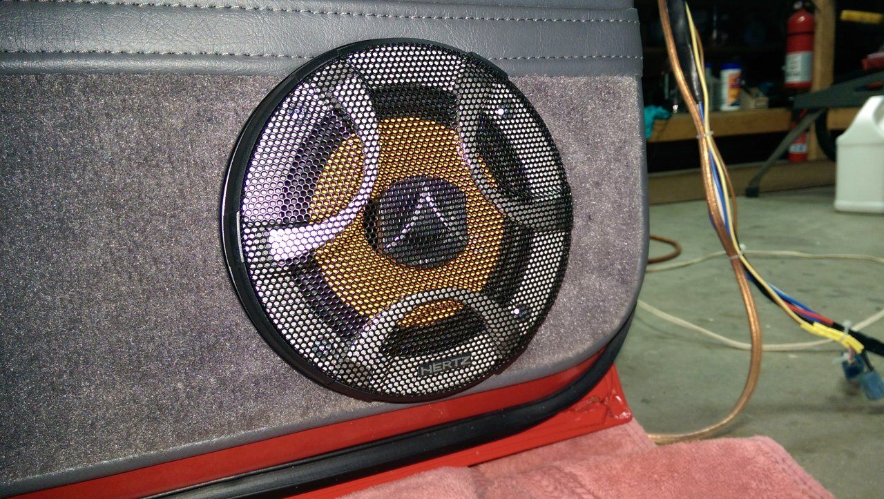

Speaker: Hertz ECX130 5-1/4" coax. Had to make the spacer rings out of some scrap MDX because of depth limitations to the window track. Also had to use the "spacer on the window track bolt" trick.

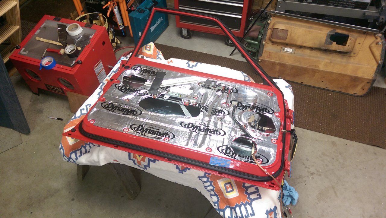

Today's status is getting the driver's door done. I'm installing 4X Innovations quick-release hinges, so they had to go thru the blast cabinet and fresh paint today. To make door removal easy I've extended the door wiring harnesses about a foot so the connectors are much easier to reach, instead of being buried behind the dash.
Doors are heavily sound-deadened. Inside the door is CruiserCrap, and I have Dynamat Extreme on the inner door behind the panel. I'm upgrading the panels to the sculptured 4Runner ones, they look great. I'll post some more when I get the door back on.

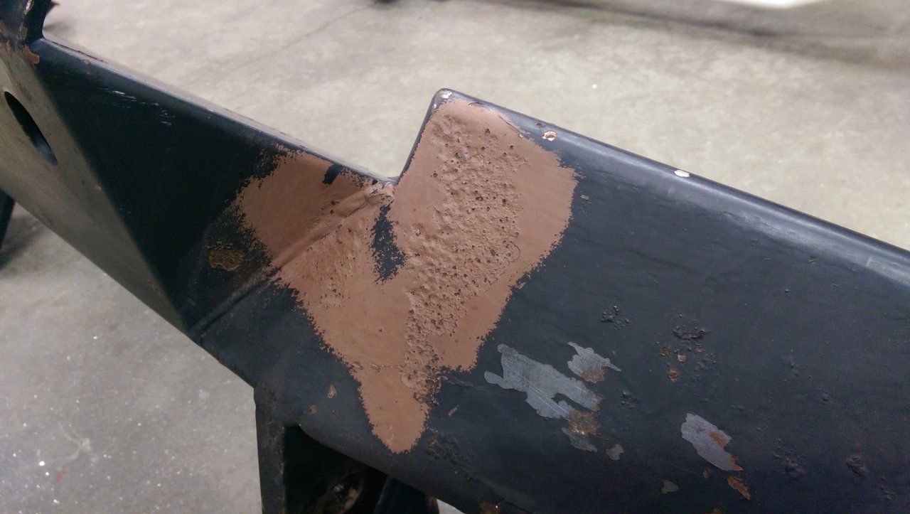

In a quandry about my front bumper. When it was new, I primed and sprayed (with my HVLP gun) it with Rustoleum, but I'm not happy with the longevity. It's decent paint, but just can't take the abuse of road spray and grit hitting it, I had a lot of pitting that eventually became some bad rust spots. So, I'm looking for another more durable option. I'm gonna have it sandblasted before painting.

How the bumper looks now. Really needs a sand blasting and a decent coat of paint. I'm thinking of using Monstaliner, but I'm gonna call them tomorrow with some questions.

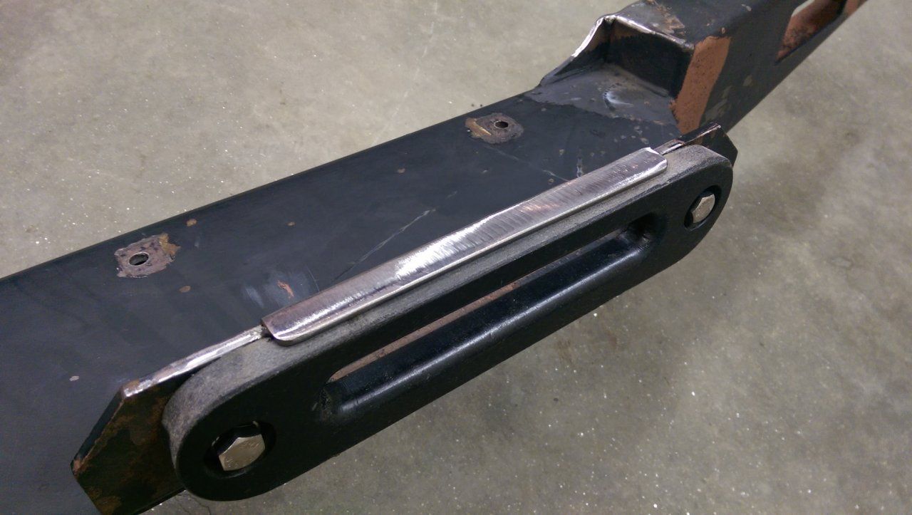

I had to add some flanges above and below the hawse, to keep it from flexing if I have a hard pull from above or below.

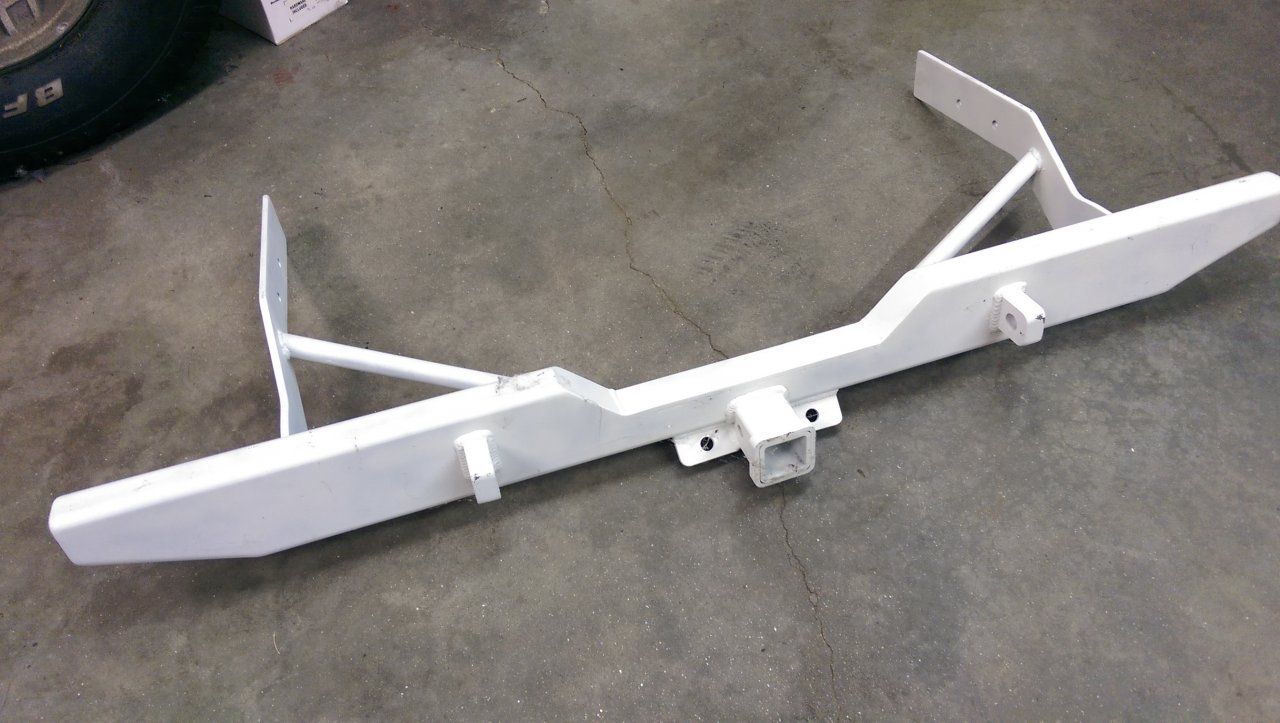

Rear bumper, with just a quick coat of primer:

Who made the rear bumper? That is sweat looking.
Funny story about that rear bumper. I happened to pop into the classifieds on Pirate one day back in 2007, and some guy in Florida had listed the bumper minutes before. It was just the main 2x5 part but it also had the tow hooks and the trailer receiver in it already. He was having it made for his Tacoma, but changed his mind. I think I snagged it for $100 shipped, I couldn't even buy the steel for that. I had to make the mounts out of some 3/8" scrap plate and some 1" tube, they actually go all the way through the 2x5, it is super strong. I also did the cutout for the plate on the stock bed location. It came out really nice. I may try to add a swingout some day.
