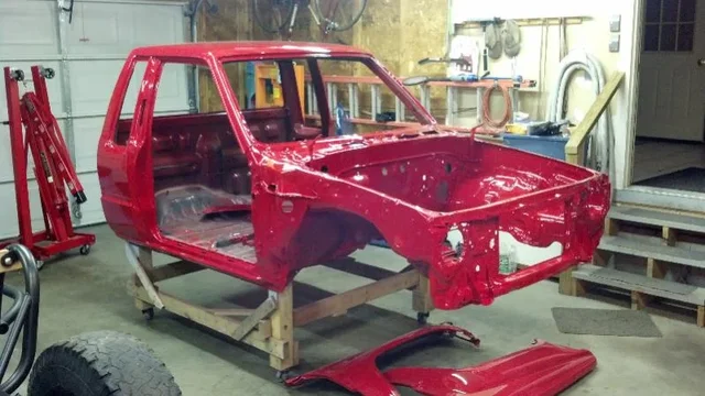

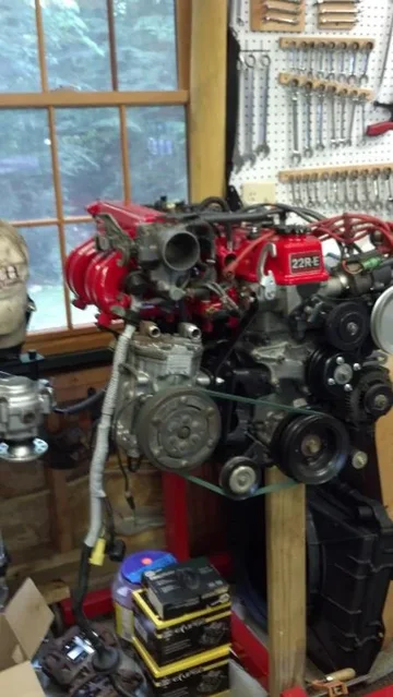

The past few weeks has been spent cleaning, washing, sand blasting, priming, and painting all the various parts in preparation for final assembly of my '87 Xtra cab. I am officially sick of cleaning and painting. My goal is to have everything ready for the big assembly when I finally push the chassis into the garage. The bed is done being painted, looks amazing, much better than I expected. The cab is at the paint shop now with the doors, cowl, fenders, and hood.

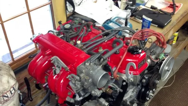

The engine is 100% done and ready to drop in, as is the tranny/transfer. I pulled off the t-case e-brake, cleaned it up and re-installed. My plan is once the cab is done and back here, I'm gonna push the rolling chassis (previously sand blasted and painted) into the garage, drop the engine and trans in, and start putting small parts on that I can. Then plop the cab over the engine (with lots of help of course), and then it's on, getting all the clean parts installed. I really want this thing moving under it's own power ASAP.

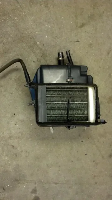

Anybody want this evap coil? I removed my ac long ago, don't need this anymore. Still in perfect condition, but its the only remaining part from the system that i have left. Pay shipping and its yours. Goes to the trash soon!

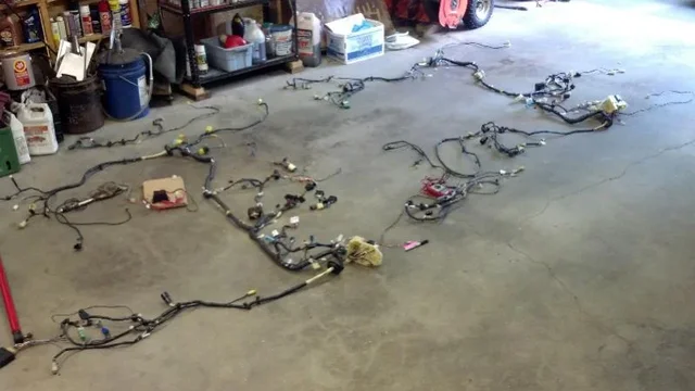

My current nightmare: wiring hell. That is 2 complete main harnesses on my garage floor, the one from the '87 and the original one from my old '84. The '84 had every option so I'm harvesting some wires and plugs to add some stuff to the '87.
Adding:
Power windows
Power door locks
Power antenna
Add'l interior/dash lights
One odd thing i discovered in my '87 harness, the plugs and wires are in the harness for power mirrors and rear defrost, even though my truck didn't have these features.
I was gonna add power mirrors but changed my mind. Anybody need a switch?

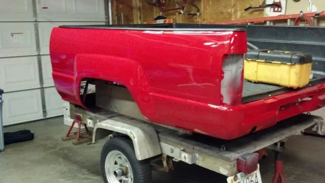

Crappy cell phone pic of the bed sitting on my utility trailer:
I decided to drop the bedliner back in, but not before I slathered all the inside seams with cosmoline, then I hosed it down the Fluid Film.

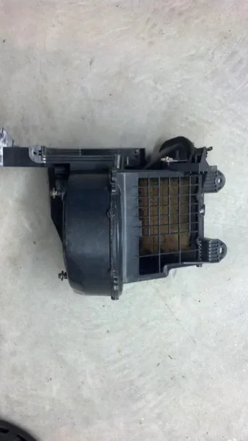

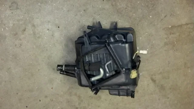

Has anybody ever taken one of these apart? There's a metal stiffener inside mine that is really rusty, and the foam on the fresh/recirc baffle is totally shot, needs replacing.
It appears to be held together with pins that they melted together, plus there seems to be some adhesive on the joining seam. Trying to cut through with a razor saw. I do have a spare if I break this one. Not sure what to use for an adhesive to put it back together, Super Glue (cyanoacrylate) doesn't seem to work well on this plastic.
I've had mine apart, however I've not come across the melted pins nor do I remember a metal stiffener, but It seemed as though a previous owner had had it apart at some point.
Devcon plastic welder seems to work pretty well on the black plastic pieces. I have used it on several parts successfully.

Thanks for the help, I'll try some ABS cement on a test piece, see if it works.
