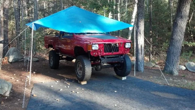

Shhh.... Truck is sleeping... (hibernating)

I will hate coming home and seeing it like that every day, but I've put off too many other things, I need my life back. The tarp is only temporary for a couple more weeks until all the leaves are down. I also have some other "inside" things to do, that I can work on in the meantime.
