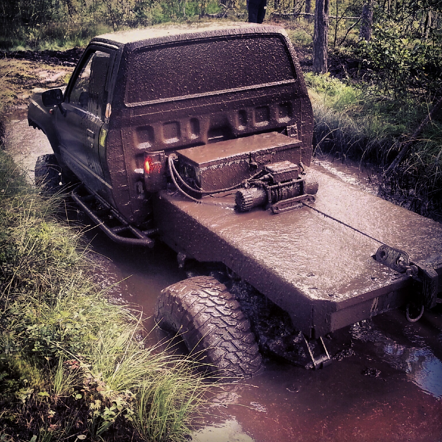

Cut the rear off, allpro springs, hydroassist, arb front, mid mounted the winch to pull both ways (rope runs alsmost straight all the way to the front), rocksliders and some other small stuff.

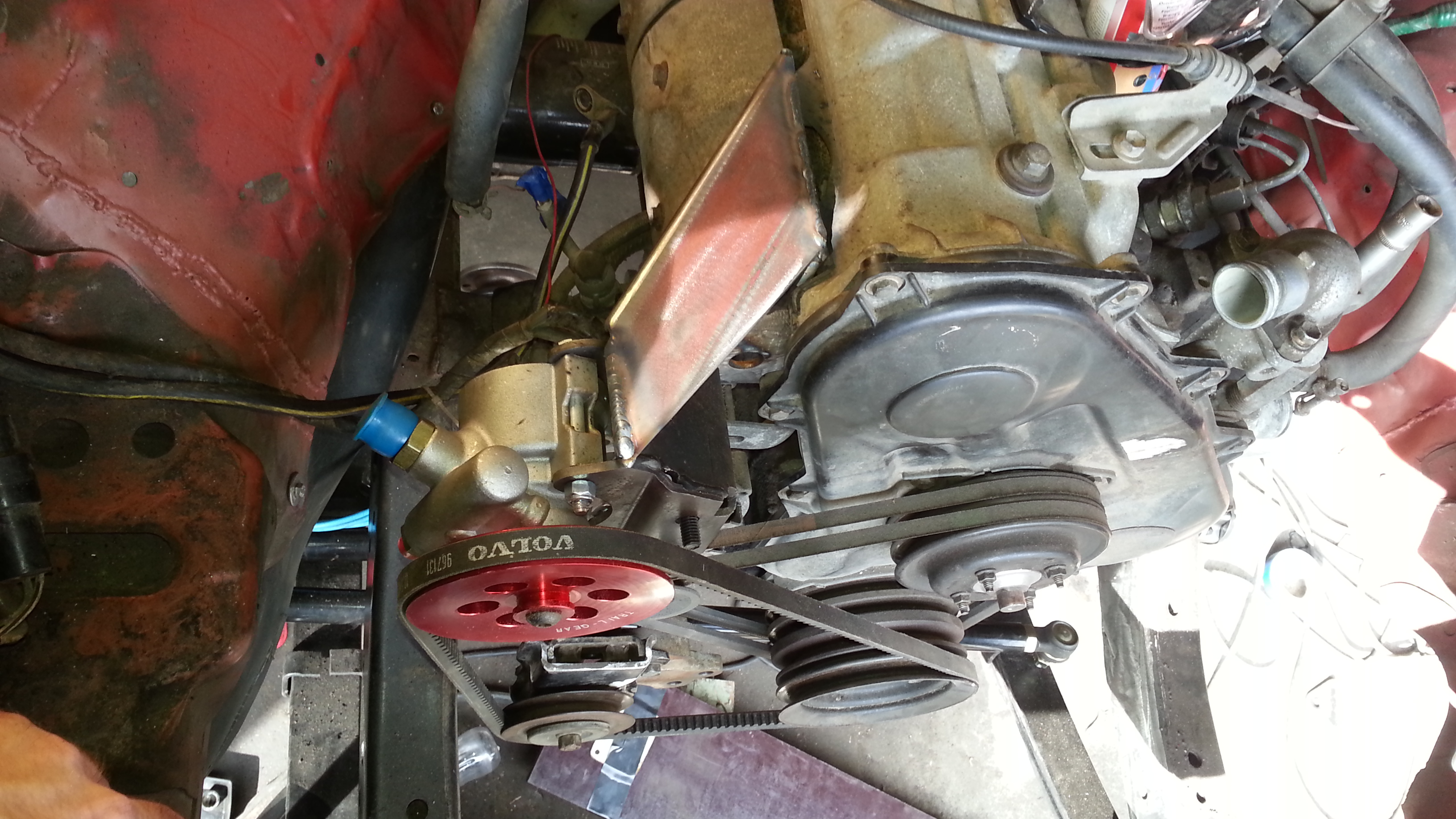

trying to make things fit.
perfect tap on the ps box.
Pump in, this is the old 2L diesel, making it fit also on the upcomming 2LT2 engine.

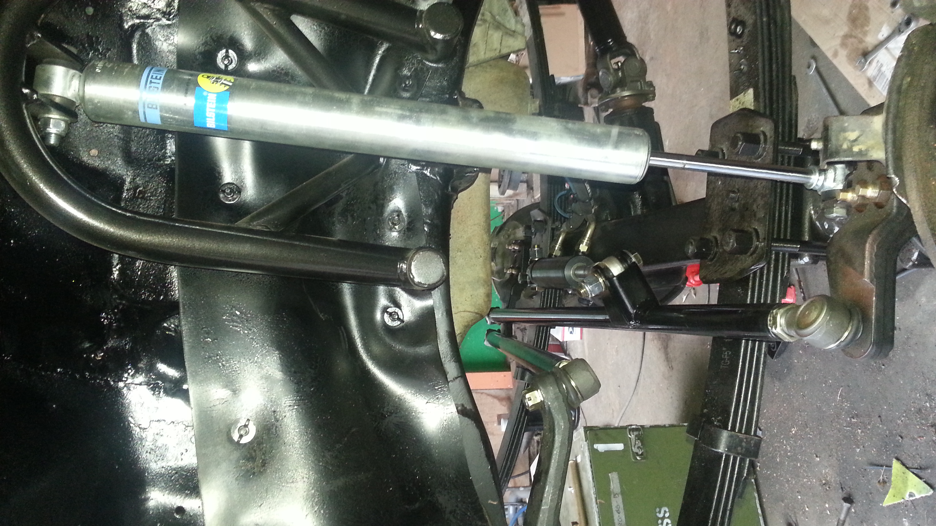

hydroassist in

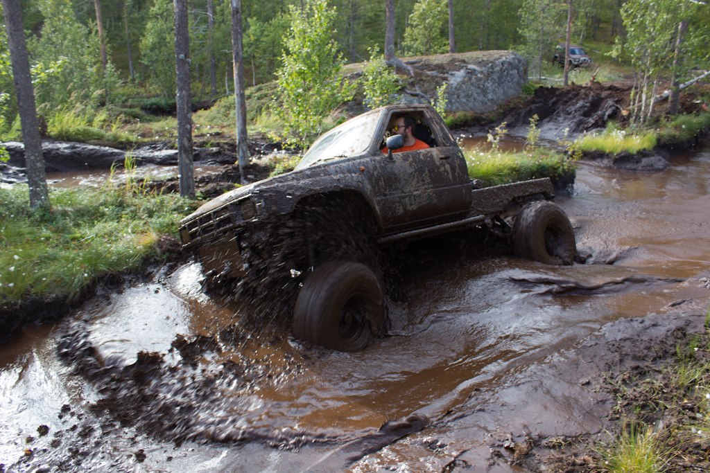

and then went wheeling
Planned to use the PTO winch for this setup, but wanted a flat belly, so i went for a TG 8000, setup works flawlessly, and the snatch block in that distance to the winch makes the rope lay down perfectly on the drum, no matter what way i' was pulling.

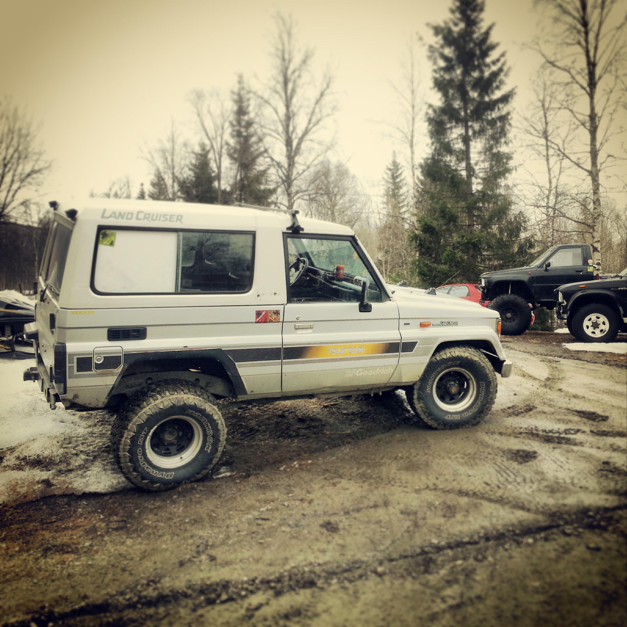

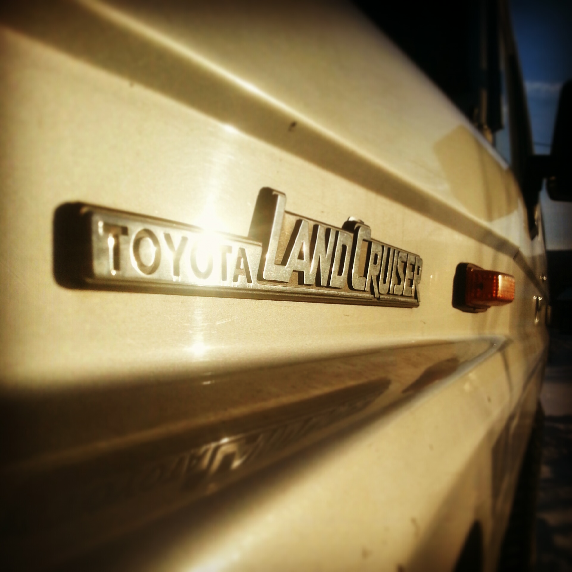

And got this thingy. 87' LJ73
2LT engine, FRP top, removable doortops all around, had a winch, put a used ome lift on it, 33's and a biig service, rebuilt the knuckles and so on.
Got some body rust, but it's tight and runs great. Great frame.
So all i gotta do now is sell the oldest hilux, put the money into a new ome on the 60, and keep the 73 as my DD, cheaper than the thirsty 2H TDI.

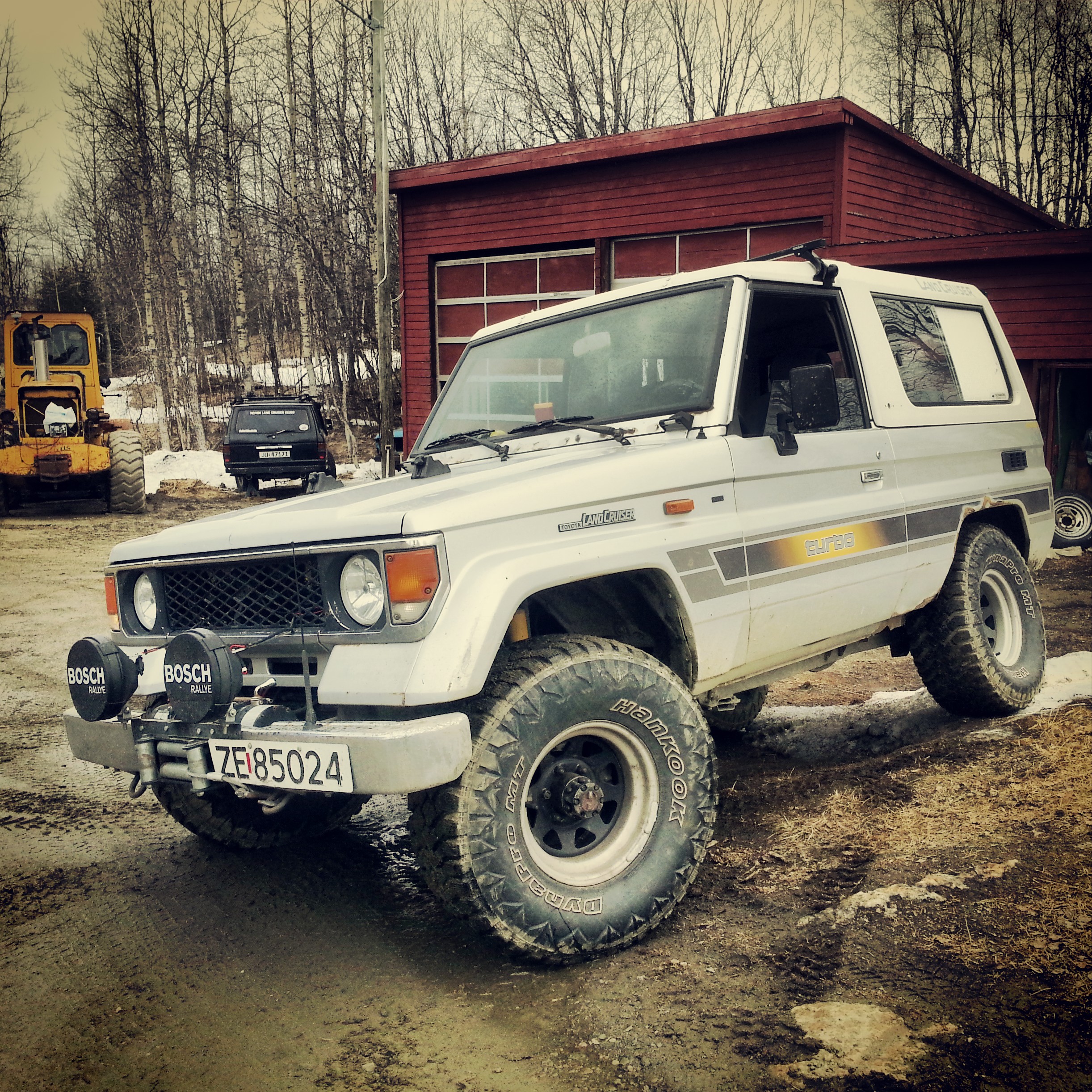

got back and got to work. the small 73 cruiser is a great little rig, but i bought a used rack of a friend and slapped on it. have done some service to the 73, still runs great.
had a few roadtrips this summer, fun to drive. but the 2lt engine is not a beast.
