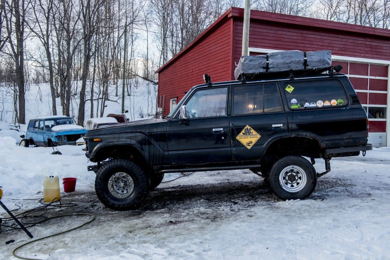

My HJ60, TDIC on 35's

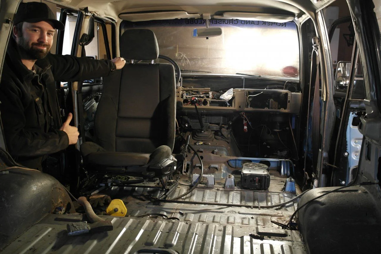

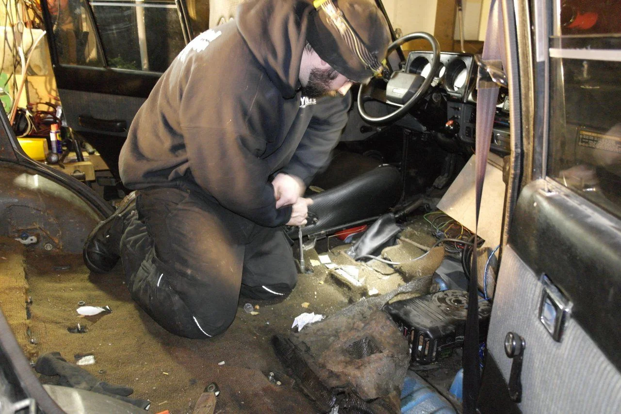

finally... im getting something done on my beloved cruiser again! ;) gutted the insides now, knocking out old sound deadning plates, removing ALL non 24v wiring. FINALLY!
doing the inside rust job. but debating on wether to install new dynamat'ish product, or some kind of bedliner.
Would really just do a non carpet trick, wich will be hard if i go the dynamat route. or Cruisercrap, depending on what i can get my hands on.
What are my options, of what i cant see? Silence, but ready to dip in water and mud?
Also mashing up the old oem interiour colours, tan and brown, and will make most use of the tan in other parts, both internal and external surfaces.

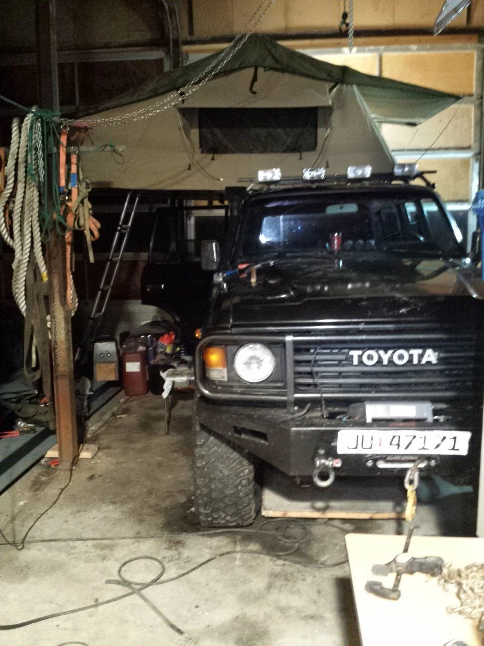

RTT is on, similar to the CVT tents, havent tried the annex yet.

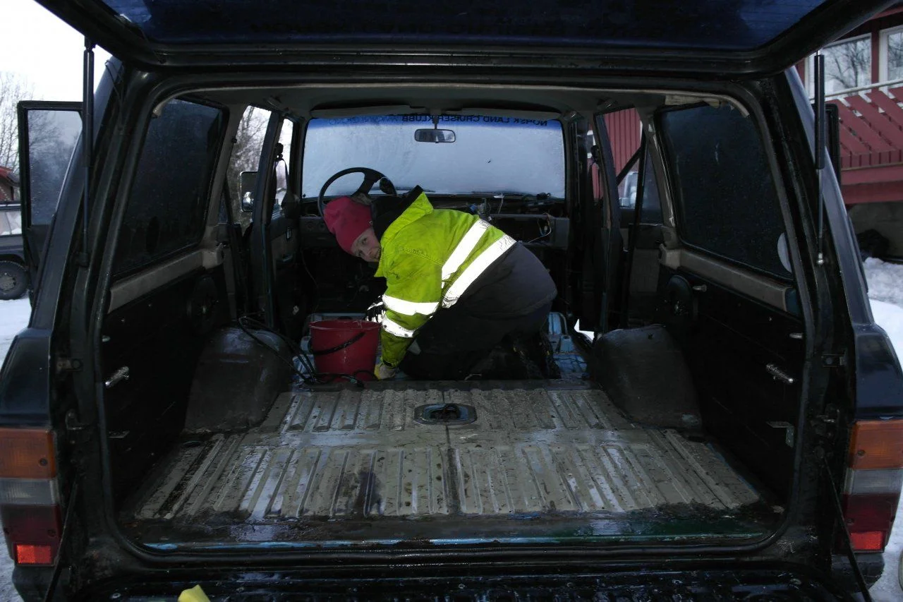

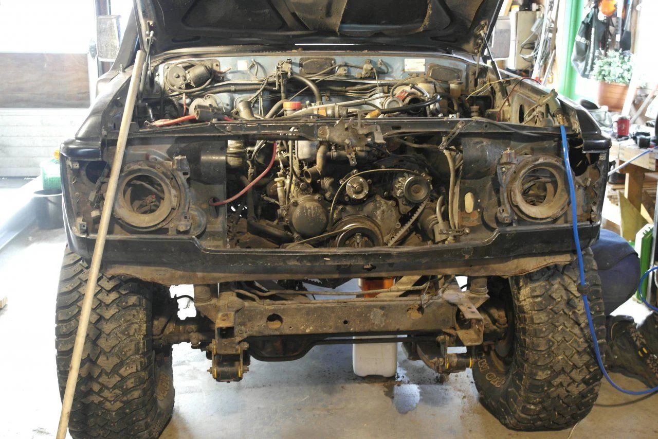

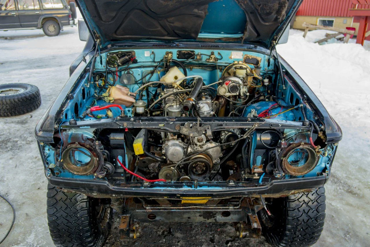

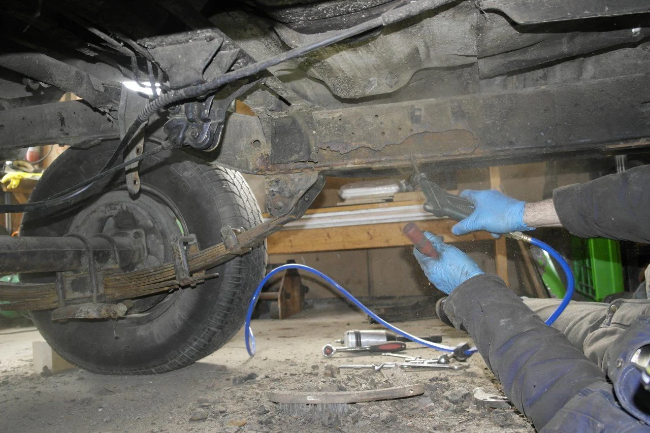

So we gutted out all interior, pressure hosed everything, removed all non oem wire, cleaned engine bay, stripped axles, scraped frame, gutted rust.
Basically, we took it apart. Just not frame off. Regret that, after spending lots of time on my back.
Before MAJOR cleaning:
After MAJOR cleaning:
Lots of gunk!
Cleaning out the interior, in freezing temperatures!!

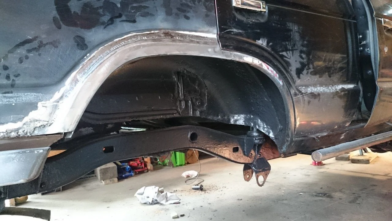

Cleaning inside of frame, and a complete section right next to the muffler was all rotted out.
Thirtytwo years of old junk build up was in the frame!
It's now welded and looking good ;)

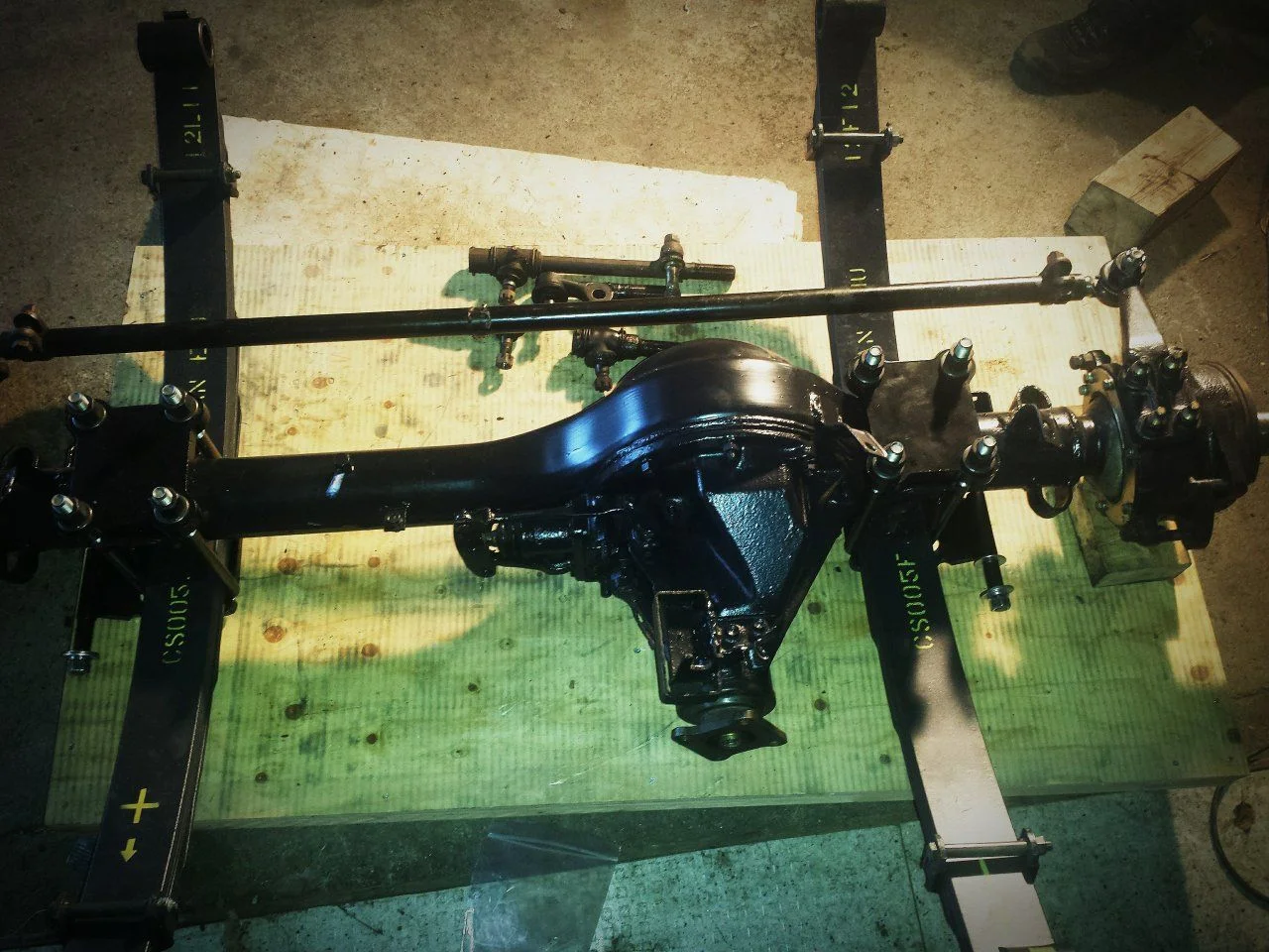

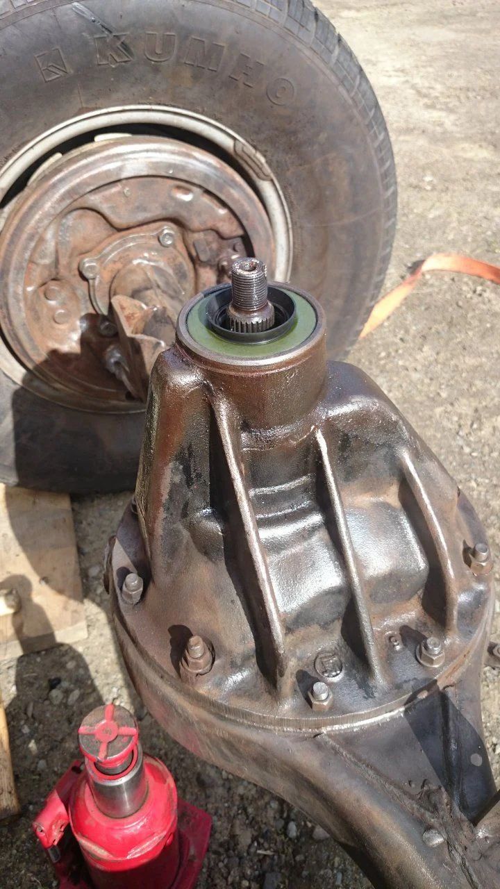

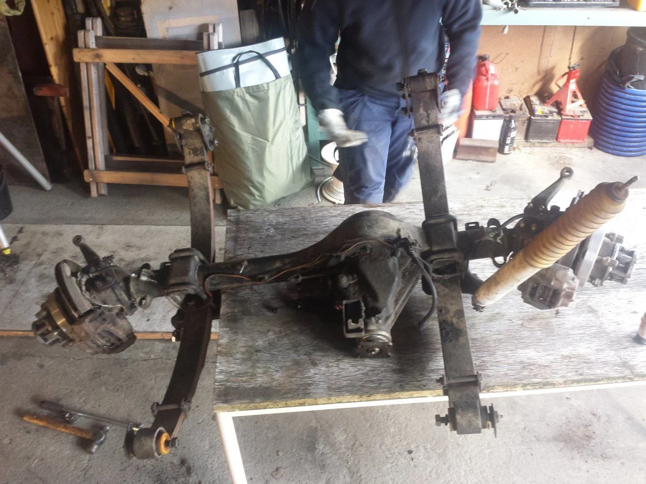

Ripped off the axles, they both needed a good cleaning and full service. EVERYTHING was worn out.
Cleaned, serviced, and painted. A happy axle!

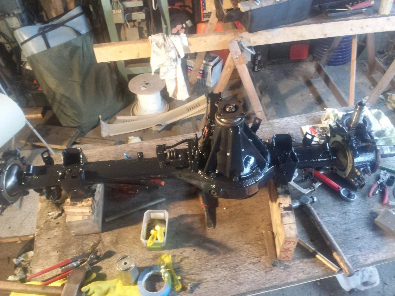

Rear axle is in progress, brakes will be serviced when i tuck it underneath the rig again.

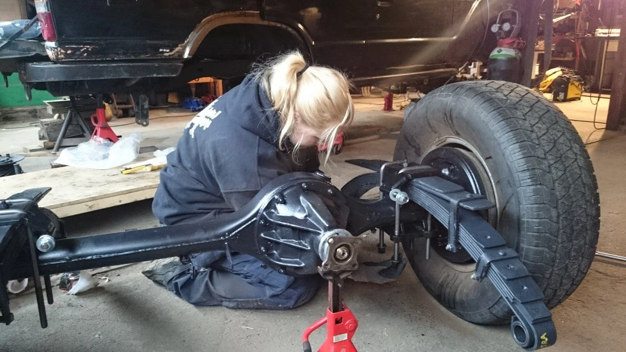

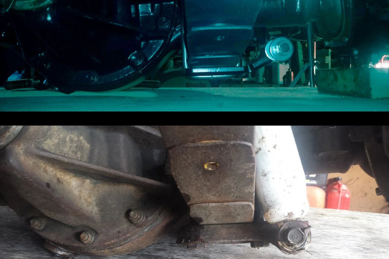

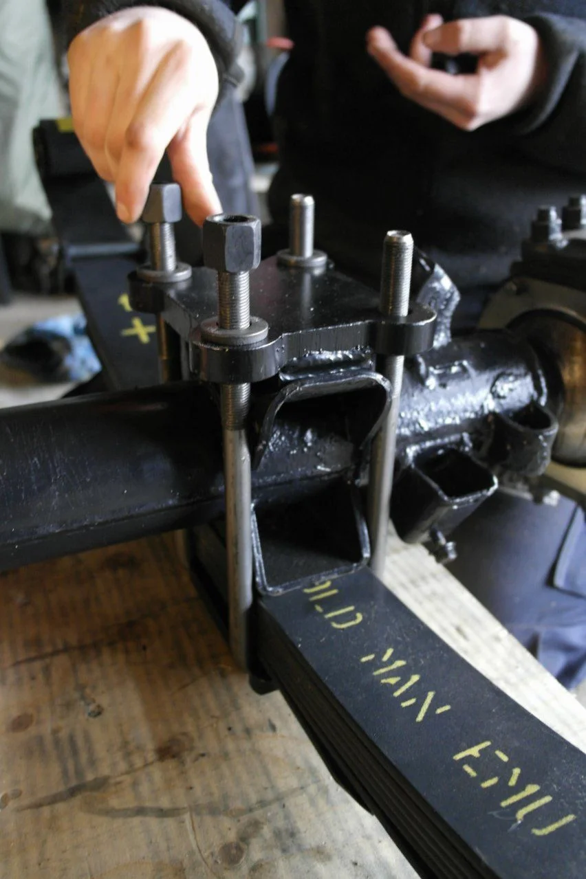

My GF is mounting the flip kit from Dave Gore.
Beefy and a perfect fit. New ome heavy springs.
TaDAAA!!
looks good, always a good time getting it cleaned up and serviced...in preparation for another trip / for the future.
Just a comparison picture of the OEM setup with OME heavy, versus @lcwizard - Dave Gores U bolt flip kit.
it shaves off quite a bit, and raises the shock an inch or two. I'm really satisfied!
I was looking for this kind of picture before i bought it, so here it is:

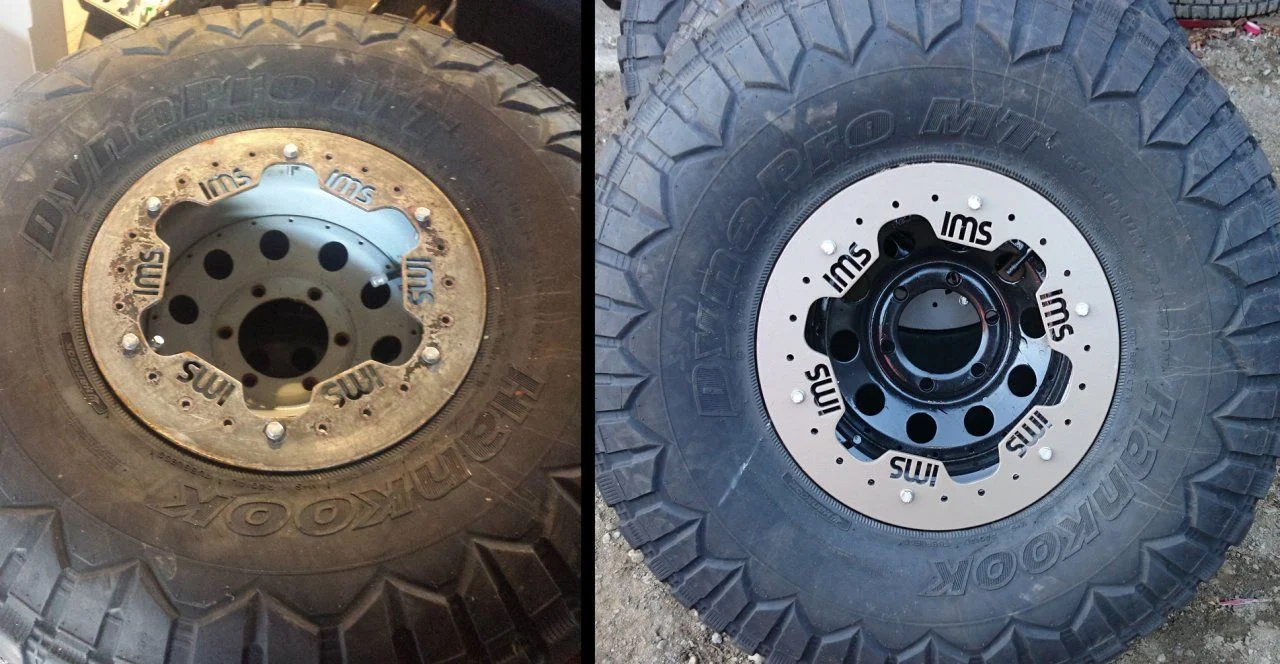

Wheels are getting new paint, and the beige color is scanned off the old dash from the donor cruiser.

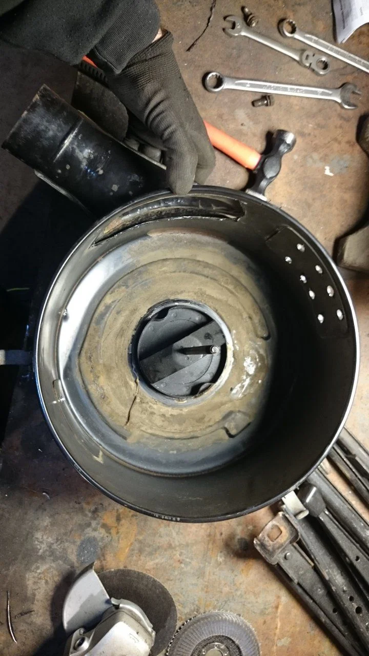

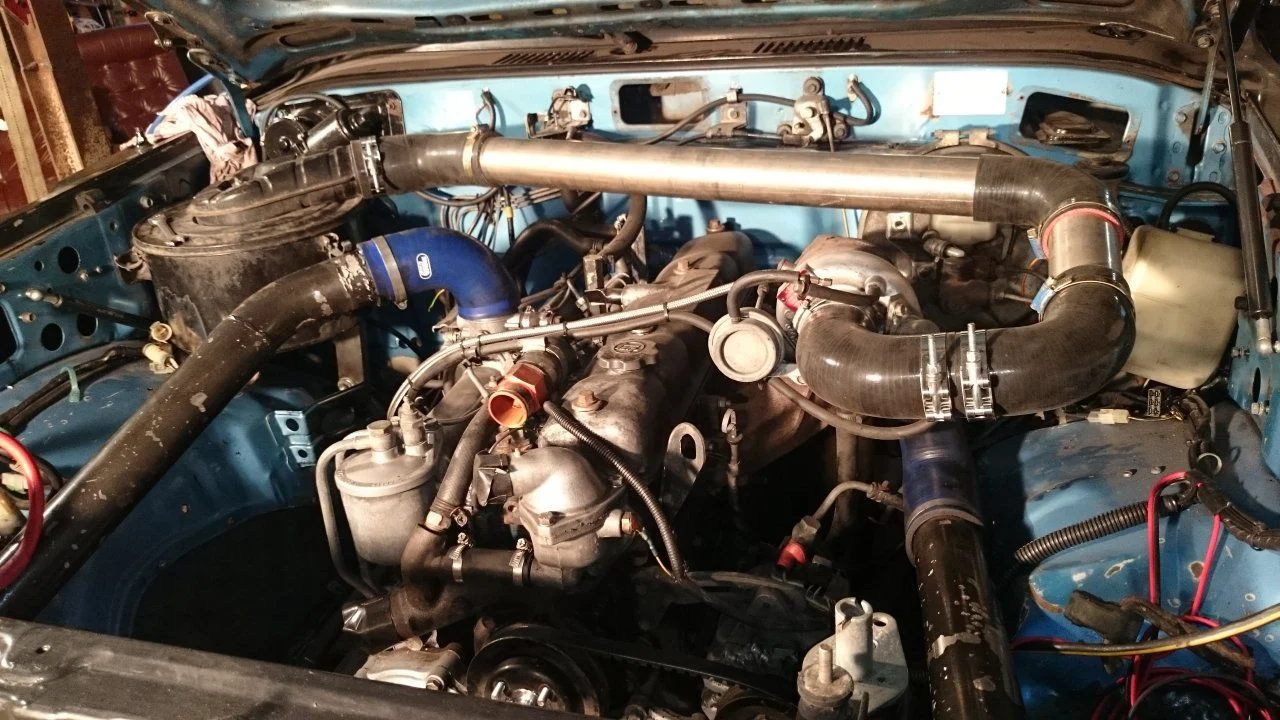

Air filter box had to be modded, to fit the new location, hooked up to the snorkel.
New feets, and managed to use the old hole for the inlet, just flipped the bend, shaped it to point more up, hooks directly to the snorkel on a 80-70mm silicone straight reducer. tight fit, but gets the filter in the right location.

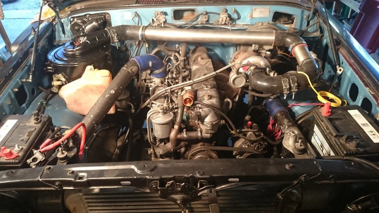

This means i need to relocate the preshaped washer fluid tank... thinking of finding another tank, not so oddly shaped. Made three new mounts for the filter box, and moved on to the pre-turbo tubing.
I really wanted to do something else, not having the crossover pipe 2" above the exhaust, there is just no more room to move it back and over the booster. And i got by with the parts i had of stainless and bends. Bent up a little support bracket that supports the end of the long tube, bolts to the booster.
I could have gone diagonally across the engine, but that would mean blocking the easy access to the oil cap, and the dipstick. I'll wrap the exhaust and inlet pipe with shielding tape, hoping not to heat the inlet pipe too much. Maybe i'll add a scoop direcly above the turbo, and make some kind of shield, but not sure if i can find time before departure.
I still need to make some more room for the rear 2" of the batteries, they are turned 90* to allow the IC tubes to pass between the rad and the batteries.
I also changed the fuel diaphragm in the ip, which was full of oil... and i replaced the primer pump and fuel filter, while down there in the dirty...

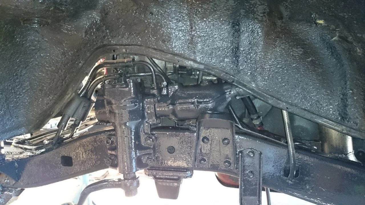

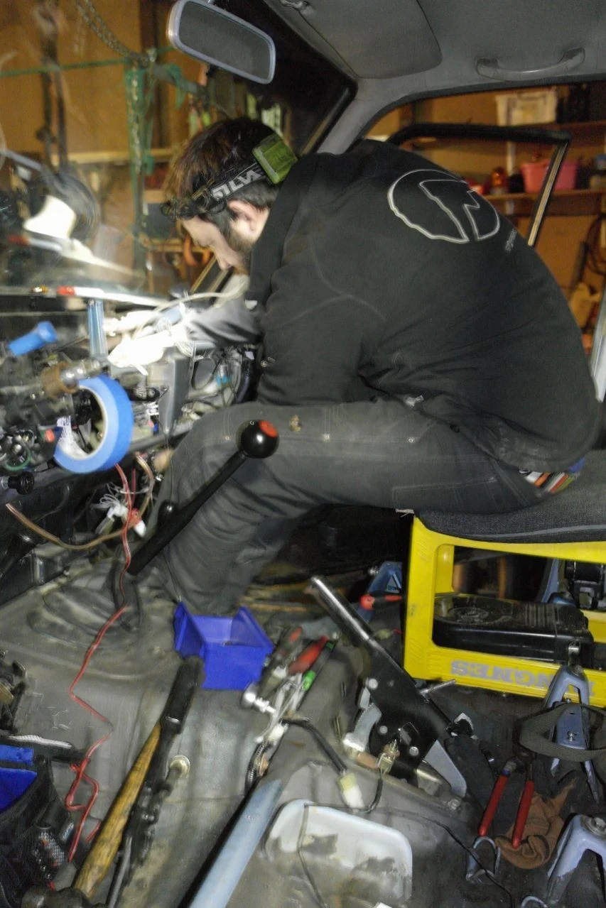

got some insulation laid down in the interior, rotted floor was patched up. bailey channels on front windows are spanking new and in place.
Not long before i can do the final electrics and button up the interior.

Handbrake is figuring out the new handbrake cable.

Within the next few days the engine bay should be complete again, just waiting for the EGT probe and some misc wiring.

I am still not perfectly happy with the location of the tube over the exhaust, but i'll figure it out when i get it running and can measure temps.
Will have to plunge in the oil catch tank into that short section somehow, sometime.
By "tube running over the exhaust" you mean the turbo's intake, right? If you flip that 180* up front then the tube leading back could be over the valve cover, then it wouldn't be over the exhaust.
yep, i could have done that, but it would be in the way of the oil cap and directly above the dipstick.
after i get the ic and radiator in, i can see how much room i have in the front, maybe i can extend it forward from the turbo.
But i cannot move the outlet of the filterbox more than 10* degrees clockwise, then it will collide with intake.
If i pass the intake, it is too close to the hood... blah.
I hear you there man. I'm still trying to figure out what the best intake setup would be for my rig without eating up all of the available underhood room on the passenger side.
Yeah, its hard with the turbo mounted high... and a front ic...
When all is in, i guess there is no more room. makes wrenching a pita. so im at least trying to make things easy to disassemble, welding nuts and using 12mm heads on most stuff.

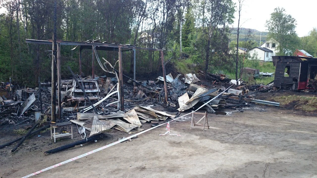

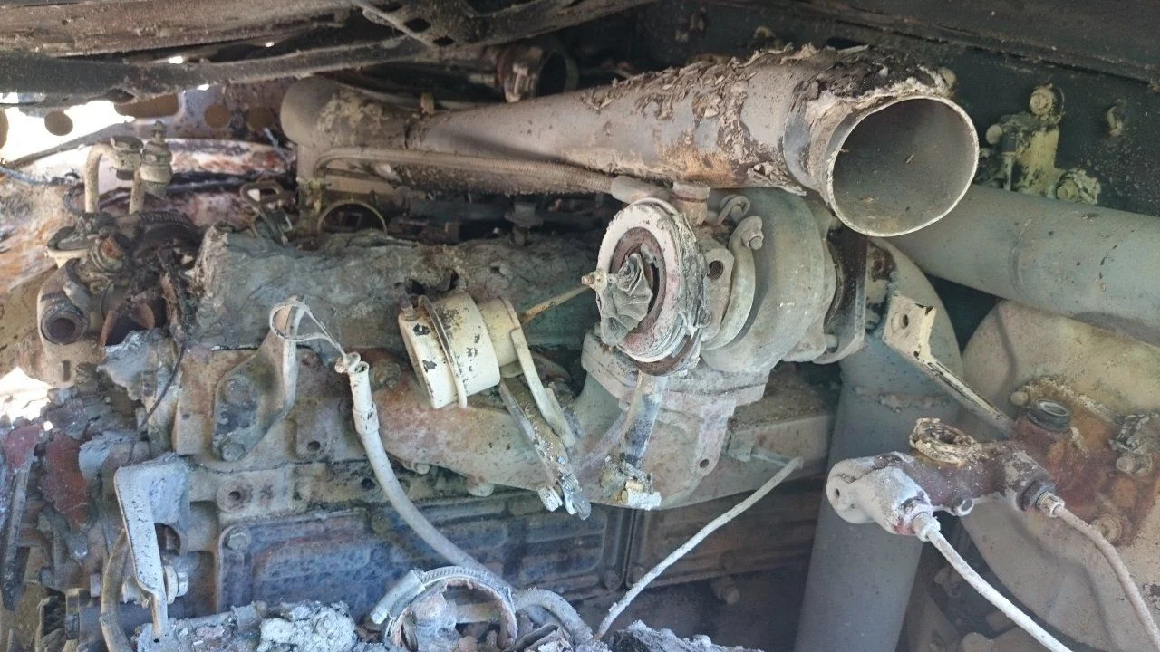

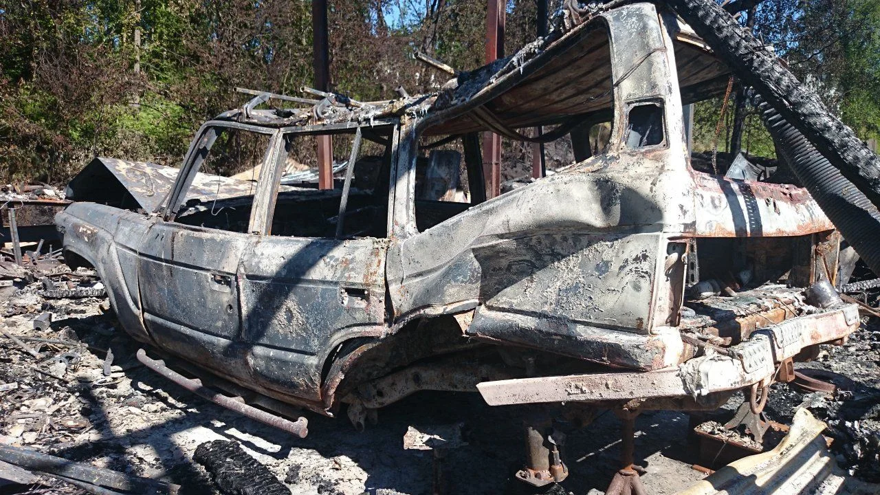

Monday was the worst day in my life. While i was at work, the whole garage and the beloved sixty burnt to the ground. Barely saved the house, everybody lived.
There's nothing left. And no insurance will cover it. Just the building. A family member is gone.

Pieced together the engine bay, got the washer fluid tank mounted in the only place available.
Got the filter box painted and mounted to the snorkel with new filter.
Assembled the new fan clutch and blades, new water pump, belts and mounted the rad overflow tank.
Everything fitted in nice. (not final picture)

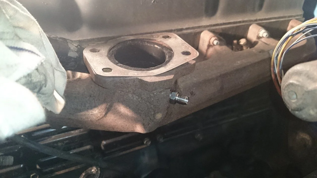

Drilled and tapped the manifold for the egt probe and a AutoMeter pyro gauge.
