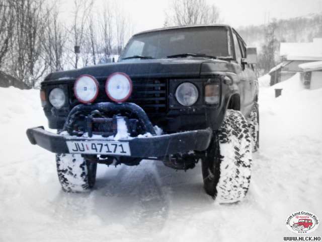

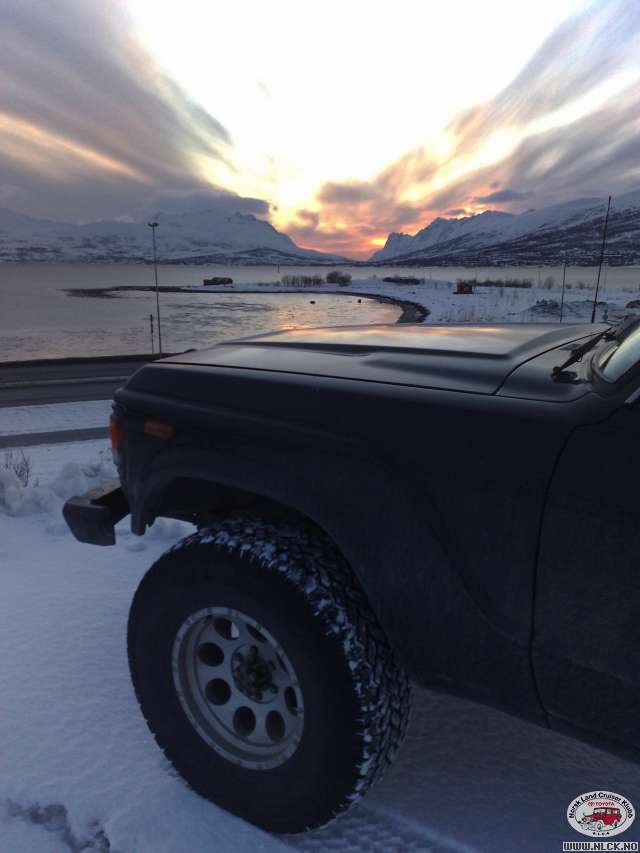

HJ60, TDIC on 35's and the mod' mood is on!
Hi, first i just wanna say I've been watching this forum for years, sufring mostly the 60 series for ideas, inspiration and knowledge.
That's actually one of the many reasons why i now own a HJ60.:cheers:
Now i just want to present my car here, for a few new eyes and some feedback.
First, the pix! yeah, i know you all love pix!:clap:
This is how she sounds when she's happy!

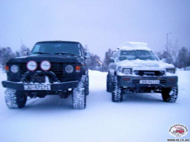

Together with my previously owned 4runner
On the 33"MTR's from the runner

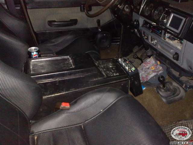

Just raised the center console 8", and put in a 24v-->12v converter in a drawer.
There is also a 2DIN Eclipse unit in there with a TomTom gps.
Just needs a little touch-up, paint or something.

When that's said, i can do som info.
T5 Volvo turbo
Iveco Intercooler.
3" exo
OME 2,5" lift
Powertrax locker in ta back.
Original PTO winch, just some mods to the front ends.
Hella Luminator xenon, rocks!
Defa warmup/central locking.
35x12,5x17" Procomp AT, soon to be 37 MTR's.

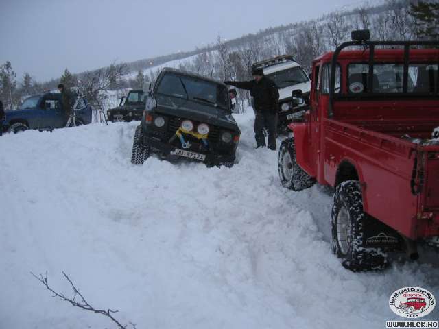

Drivin in the snow, fields, tractor roads, to my cabin, and wheeling around with my friends on roadtrips and so on.

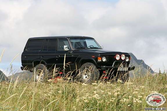

Was just road-cruising in the Easter Holiday, but the norwegian landscape can take my attention off the road sometimes...:cool:
Was just standing there talking with a fisherman via the CB...
Some of "Lyngen alps" seen from the north.

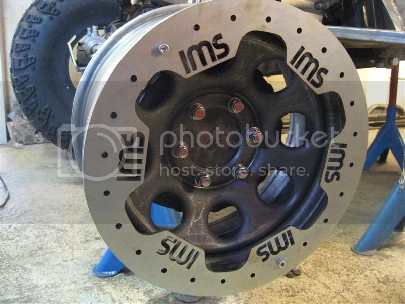

Now i got a set of 37 mtr's, custom made swi beadlocks, and as soon as i get a set of 15"steel rims i'm going to weld them on, i paint the rim black, and keep the SWI beadlocks as they are, not to create a big black hole in the wheel area, and of course to show these badass beadlocks off! (pic borrowed from the guy who made them)
To get the wheels on without spoa, i need to get a 2" bodylift. (you know where to get them?:clap:) Maybe i'll have to make the BL spacers myself, it's a few different diameters on the chassiemounts.

The center console is my version of a tuffy, and also proveides space for the 12v converter, nice placement of the CB, and under the lid there's going to be a 6switch setup for rarely used stuff. The console also gives nice support for the elbow. 4in1 for a few hours spent.
