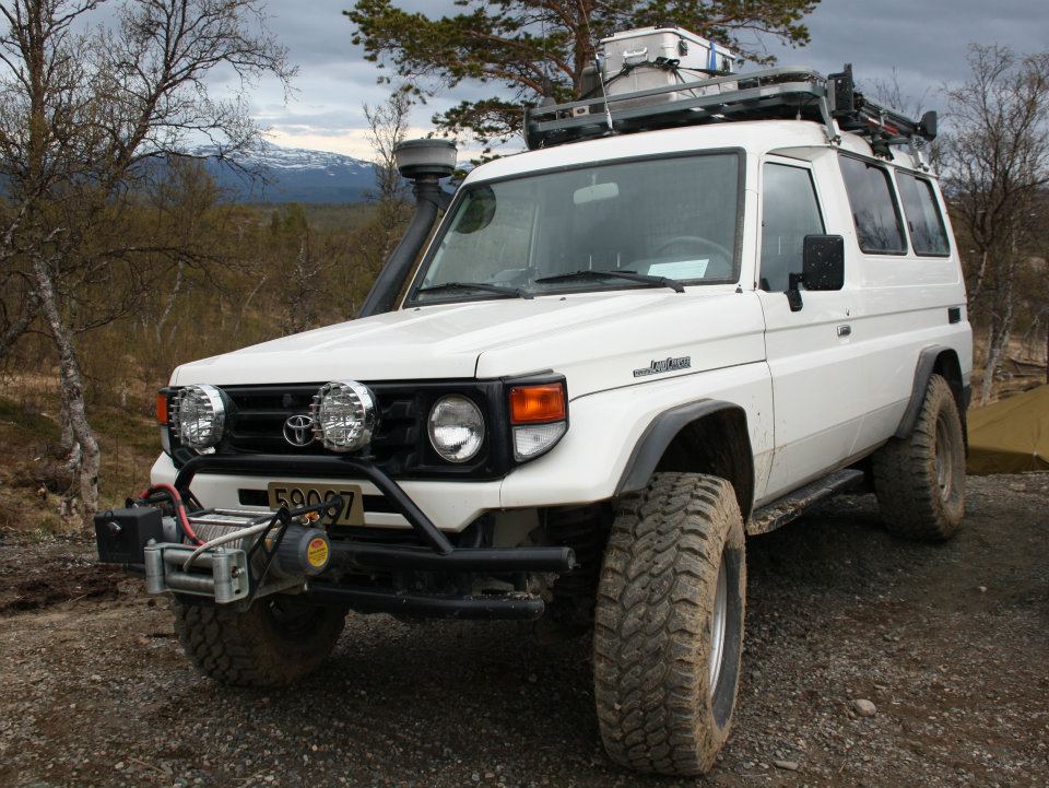

Been lazy on the 60, but tomorrow the sliders are done.
here is some in progress pix:
Something happened with the order at TG, so i got the same length as a singlecab hilux. No problem, i just put them into the DOM-stretcher.
Also decided to flip the rear end inside out, makes more sense to me, and adds more protection to body, and more step for passengers.
All tacked in. Maybe they seem a bit far out, but they are flush with the upcoming OEM fender flares. Wich means half an inch inside outer wheel. Half an inch down from body, 2inch tilt up.
Good protection, and a perfect step for roof access.
Dont know yet if i will fill in plates. Will be great in winter to avoid slush, but a mess in the mud, keeping all the debris on there... we'll see.

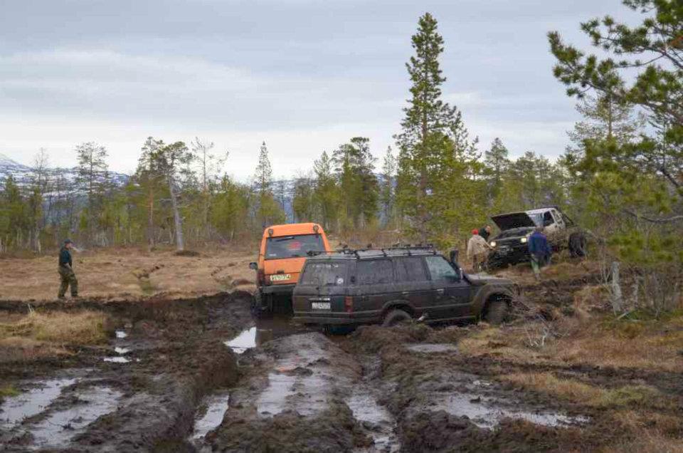

Heres a pix from last weekend, did not take any myself, so i will post more borrowed pictures.

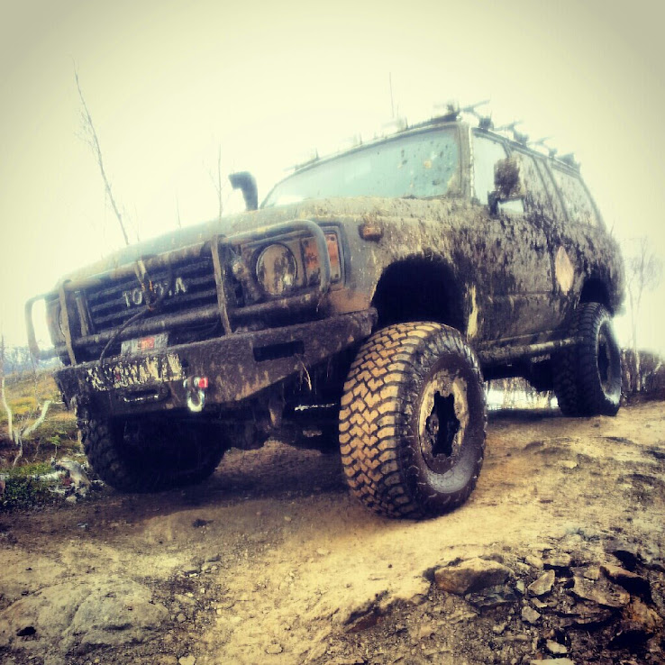

The front bush guard and the sliders were done just in time for last weekends awsome event.
Man-o-man, that's a lot of mud:hillbilly: She's looking great man, good work!!
Thanks, i like the added protection, and the bush guard doubles as a quick place to hang the winch line.
Got the sliders tested out, fell down about 15 inches directly at it, right behind the front tire. No slack.
And the bush guard also defended my headlights, blinkers and fenders as my hilux buddy slid onto me. great!
Now i just wanna change tires. Theese are becoming more of an AT, half worn.

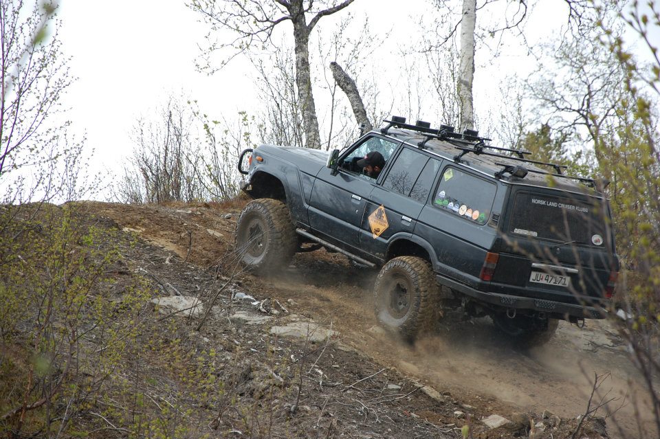

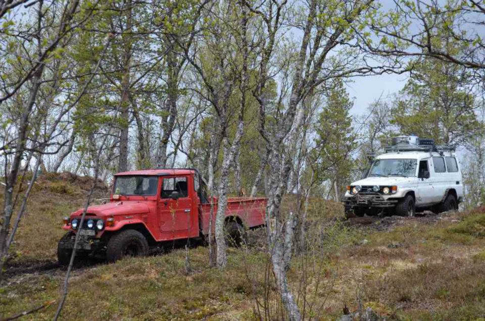

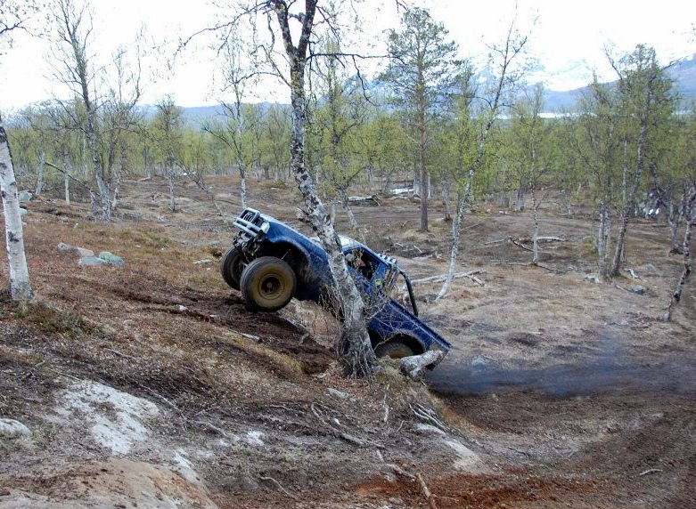

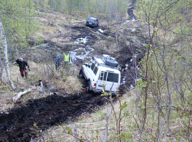

Enough tinkering, got more pix from last weekend, took none by myself:
