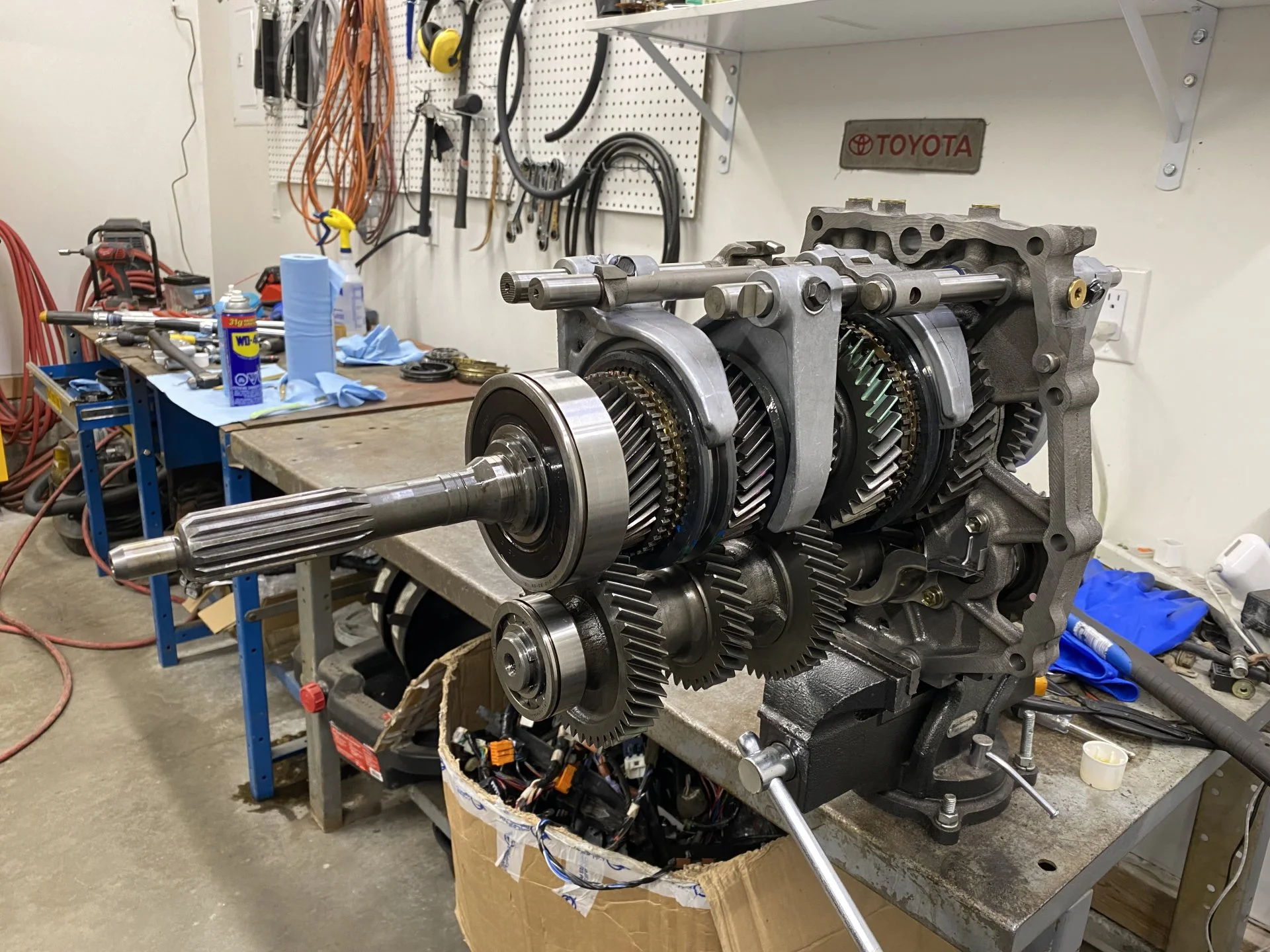

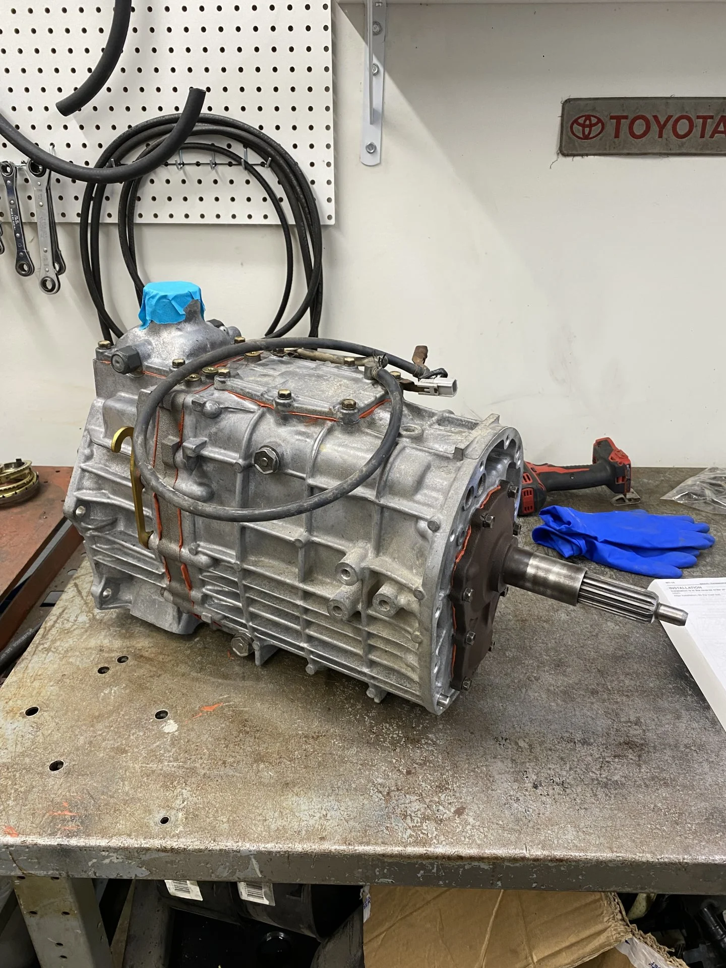

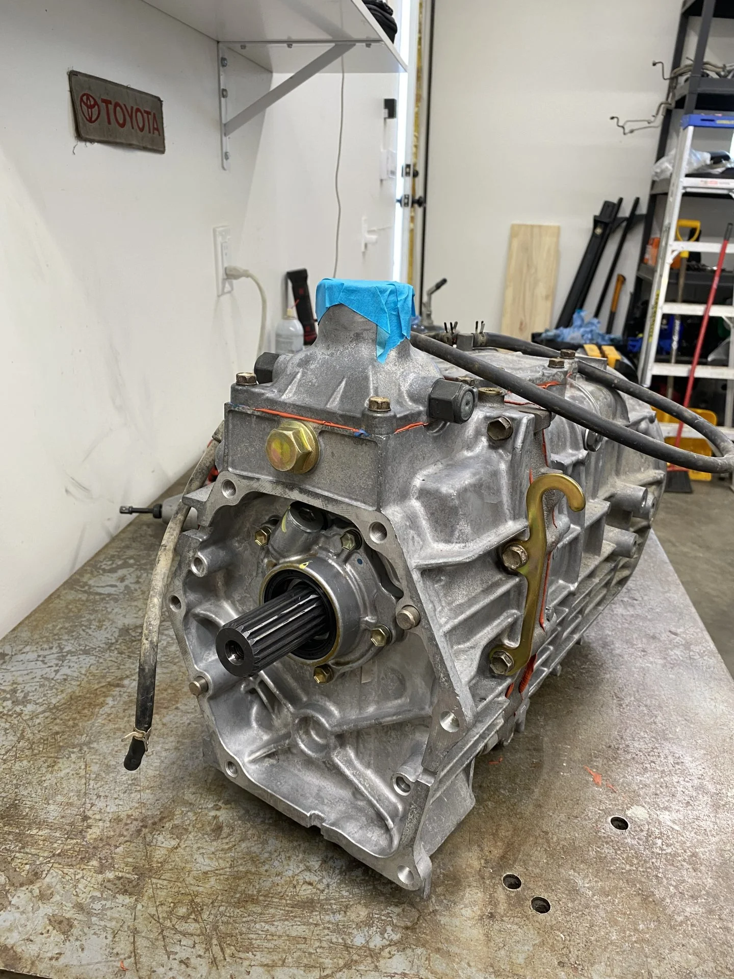

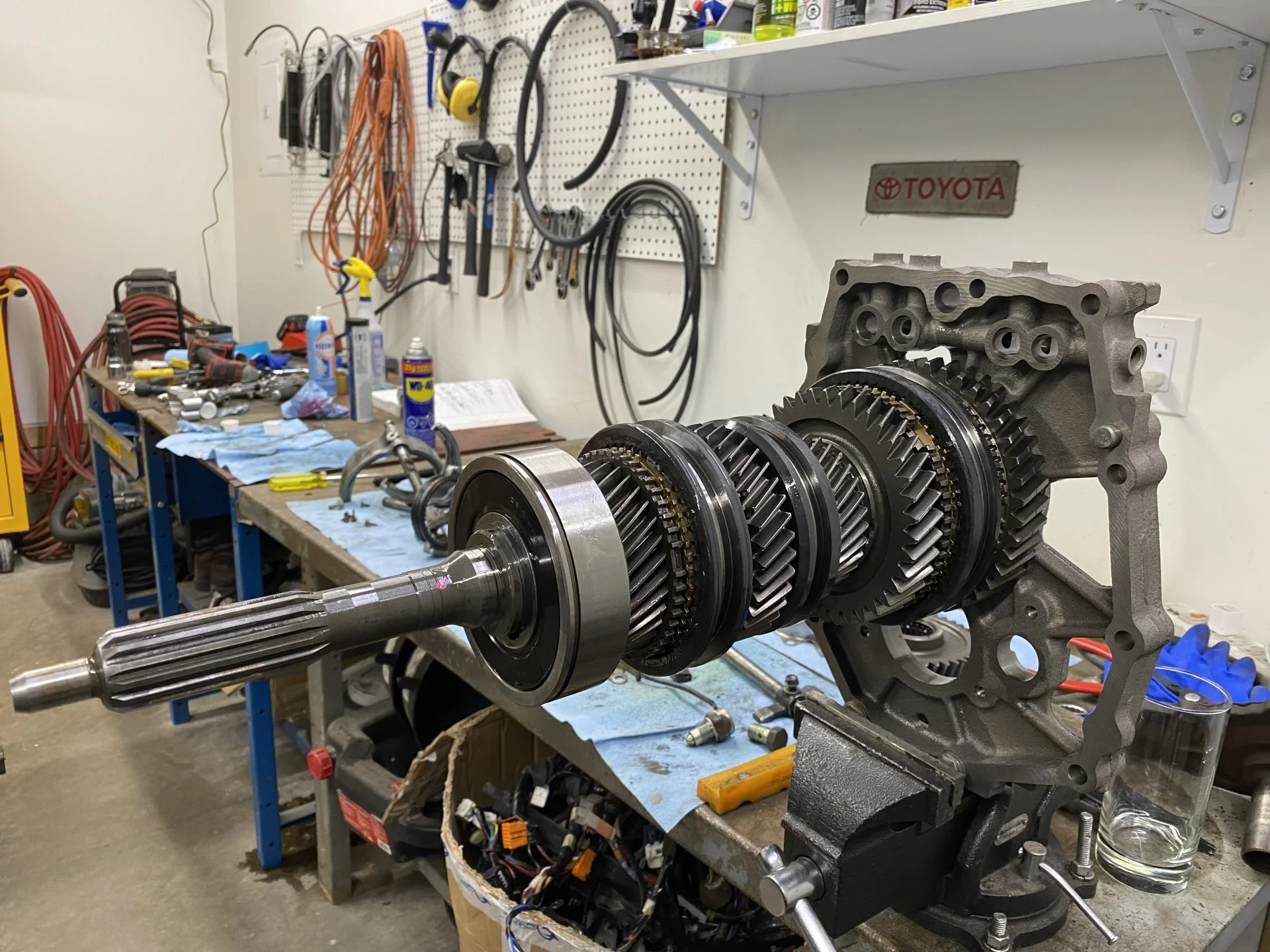

H151F Rebuild Complete
The gearbox rebuild was my last critical path prior to engine install. Next step - assemble drivetrain and then the engine goes in!

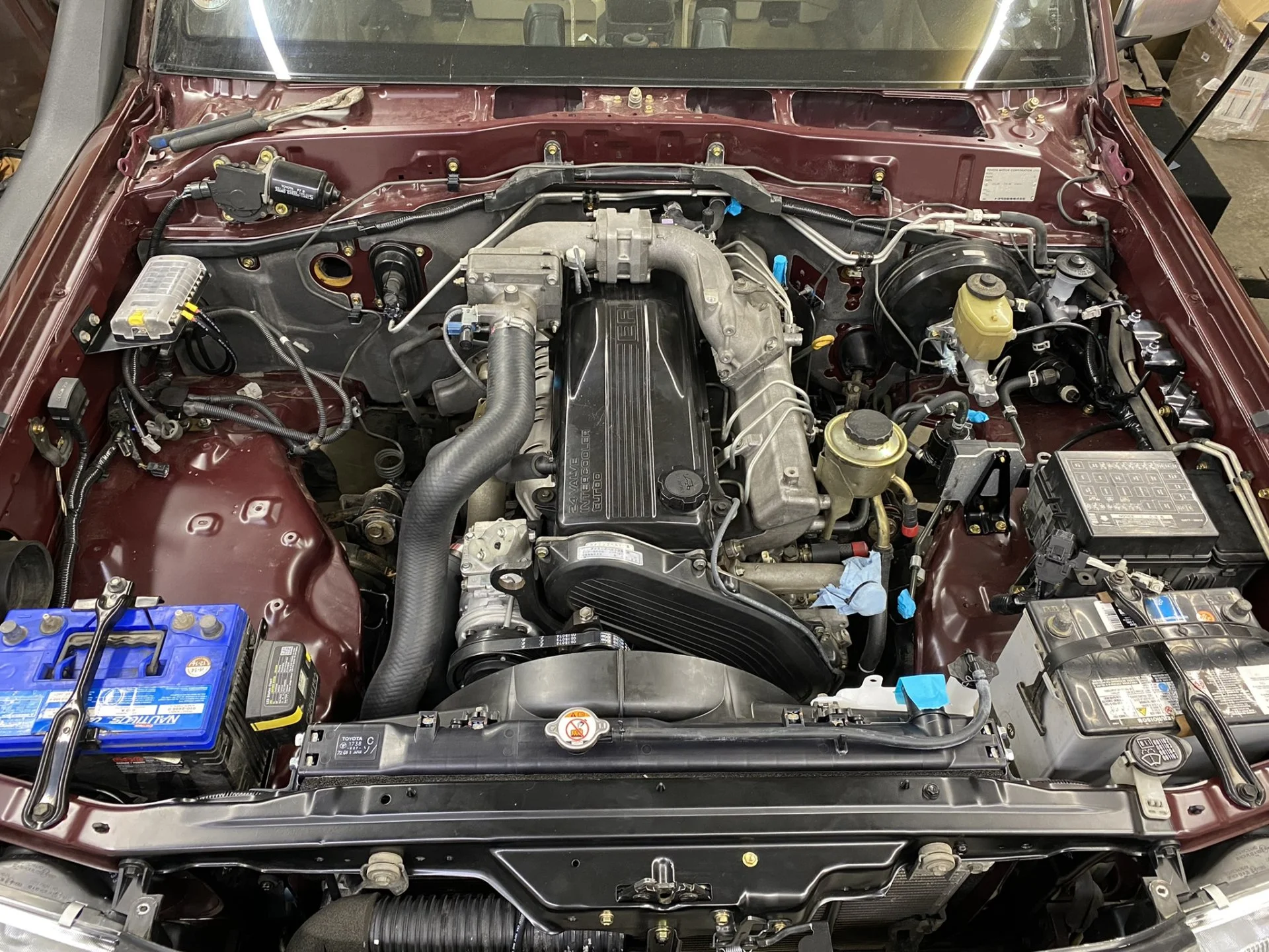

Well that was a pain in the butt.

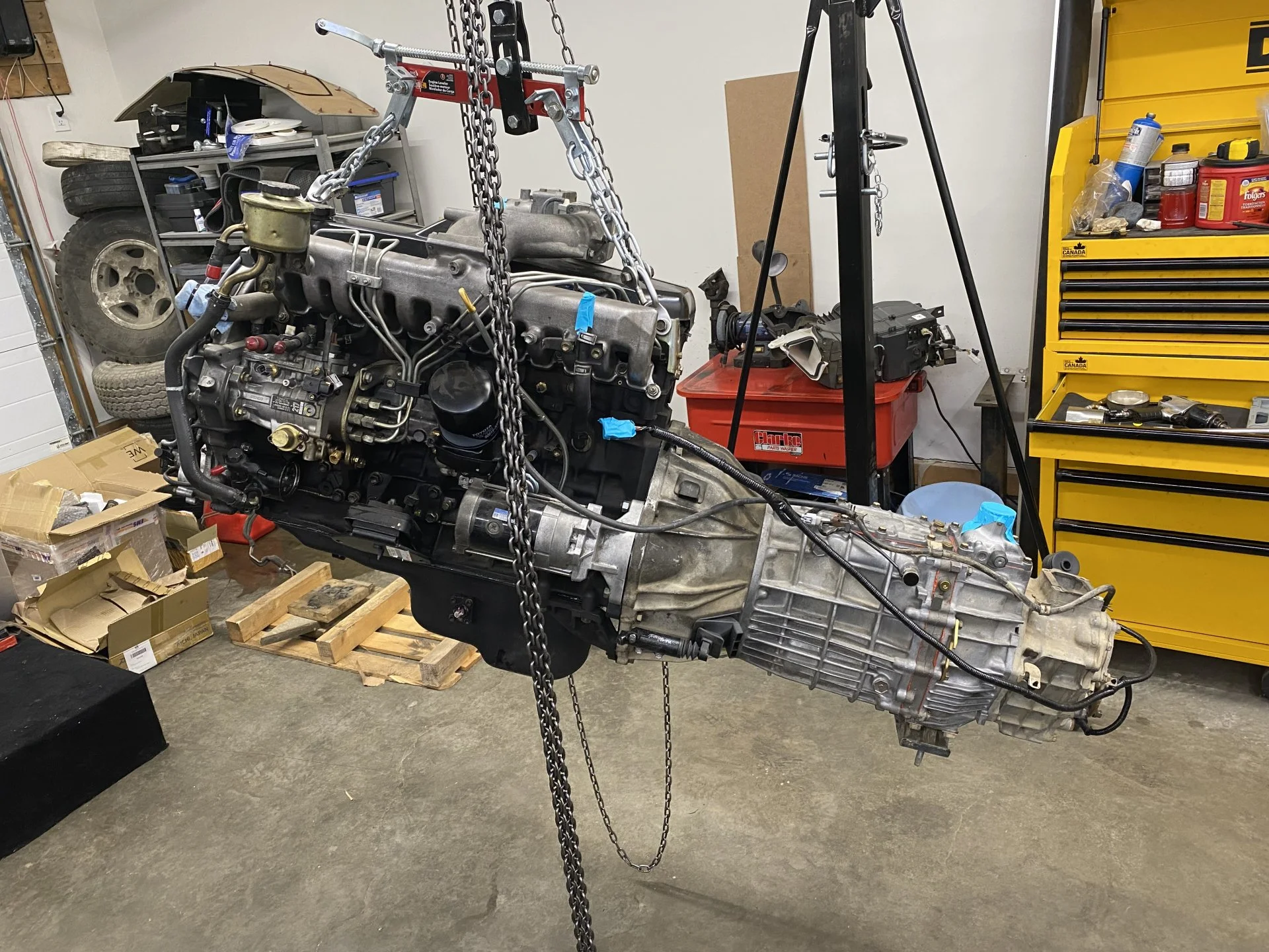

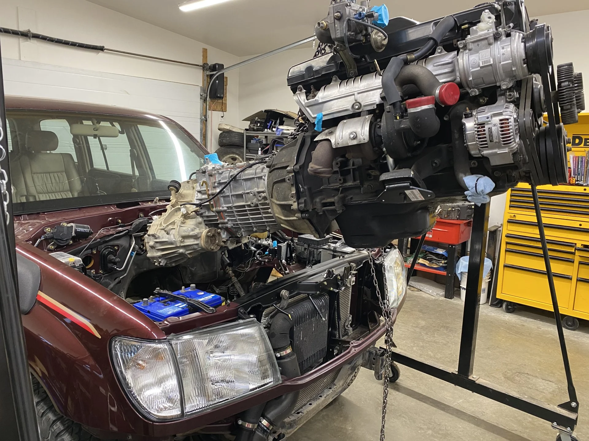

Assembled the drivetrain and put the motor in last night! Took the entire day yesterday to do the job, it was not easy. The motor fought us every inch of the way, but it's in and looking really good.

Very very busy weekend but it paid off Sunday night!

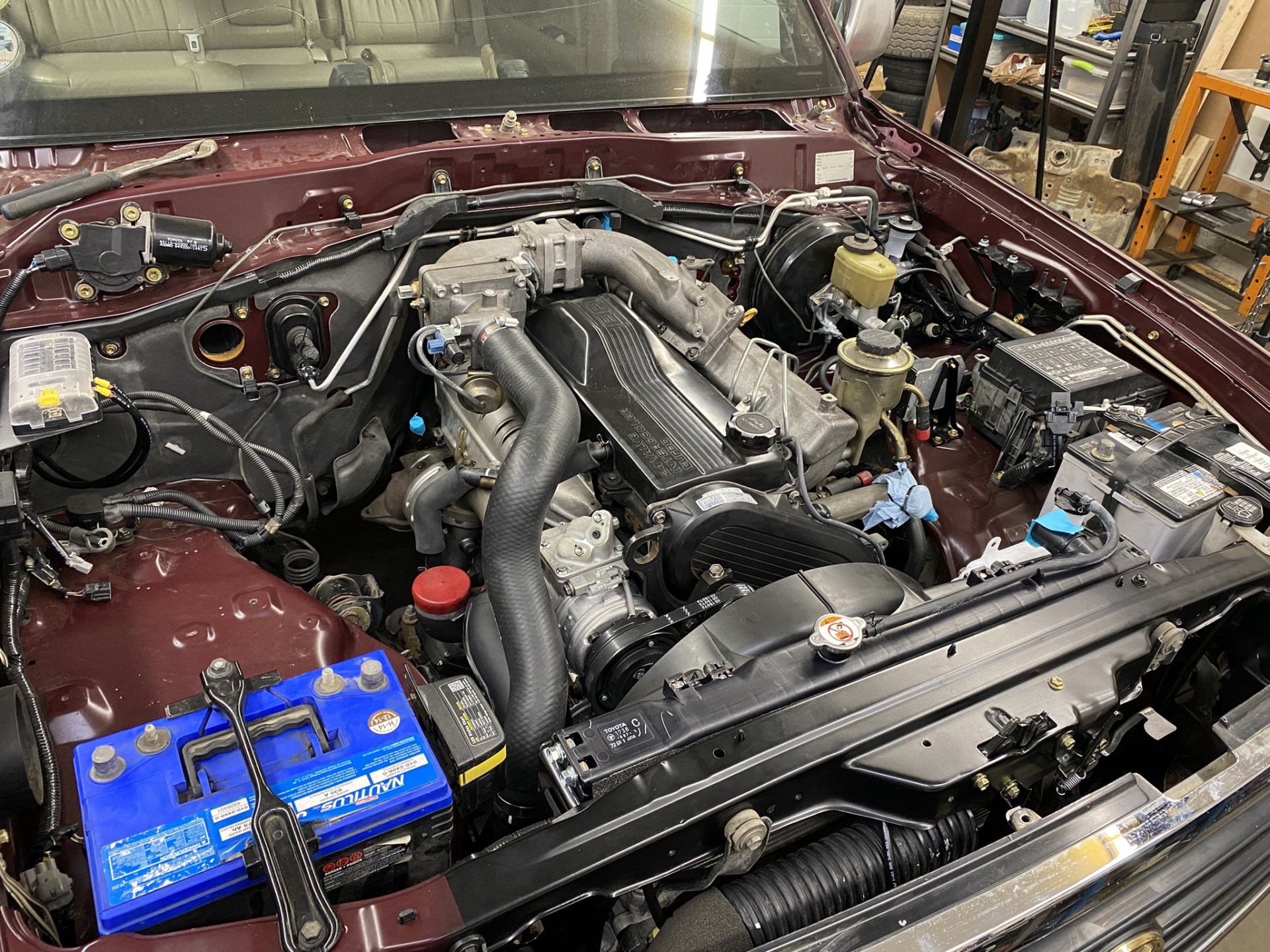

This isn't first startup (that video I've saved for a Youtube series) but boy this motor runs nice.
Hey Nick, what turbo are you running in the FTE? (apologies if it's listed previously, I couldn't find it)
Hey there! No worries at all, I have not posted that information yet.
I am running a stock turbo. I'm keeping everything stock on the motor. I want this thing to last a long time and adding power is inversely proportional to reliability.

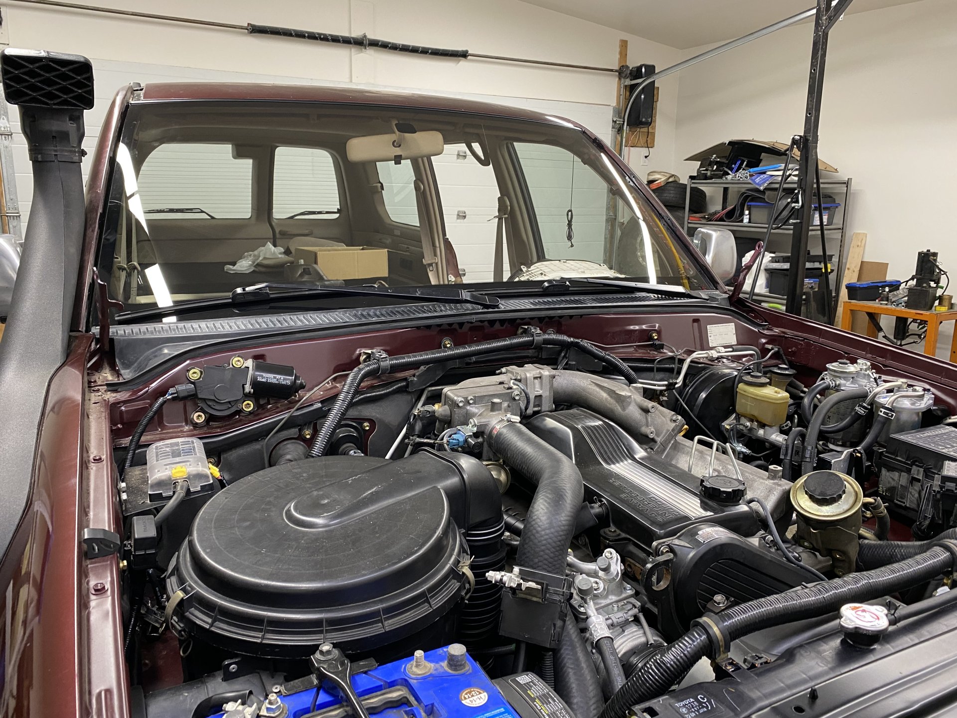

Is it just me or is that air box HUGE?
This is the diesel airbox. It's pretty substantial, as is the filter. It's also water washable.
Did you get an engine with the European VNT turbo or just the regular CT26?
