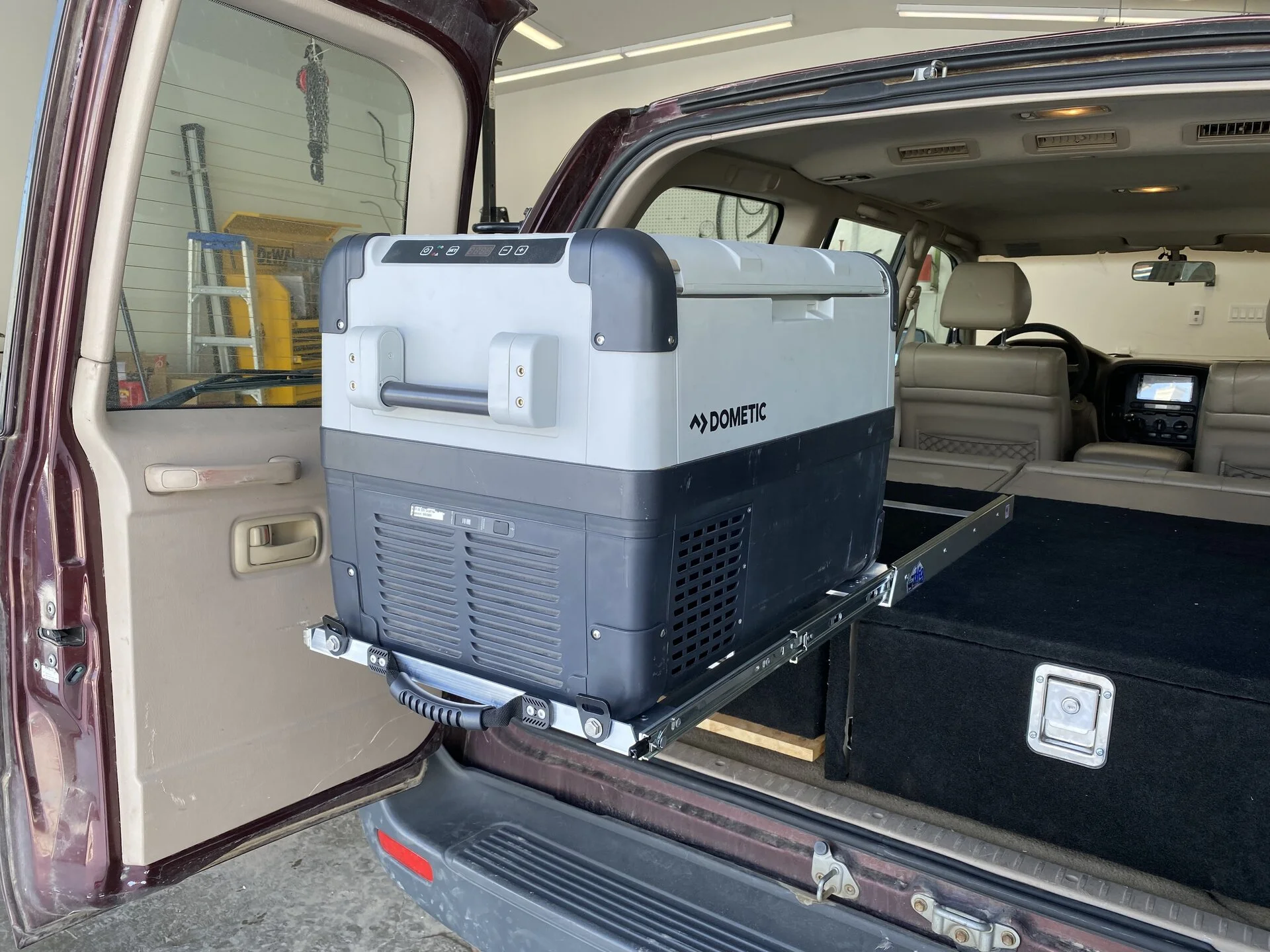

FINALLY got a fridge slide. I know, late to the party...

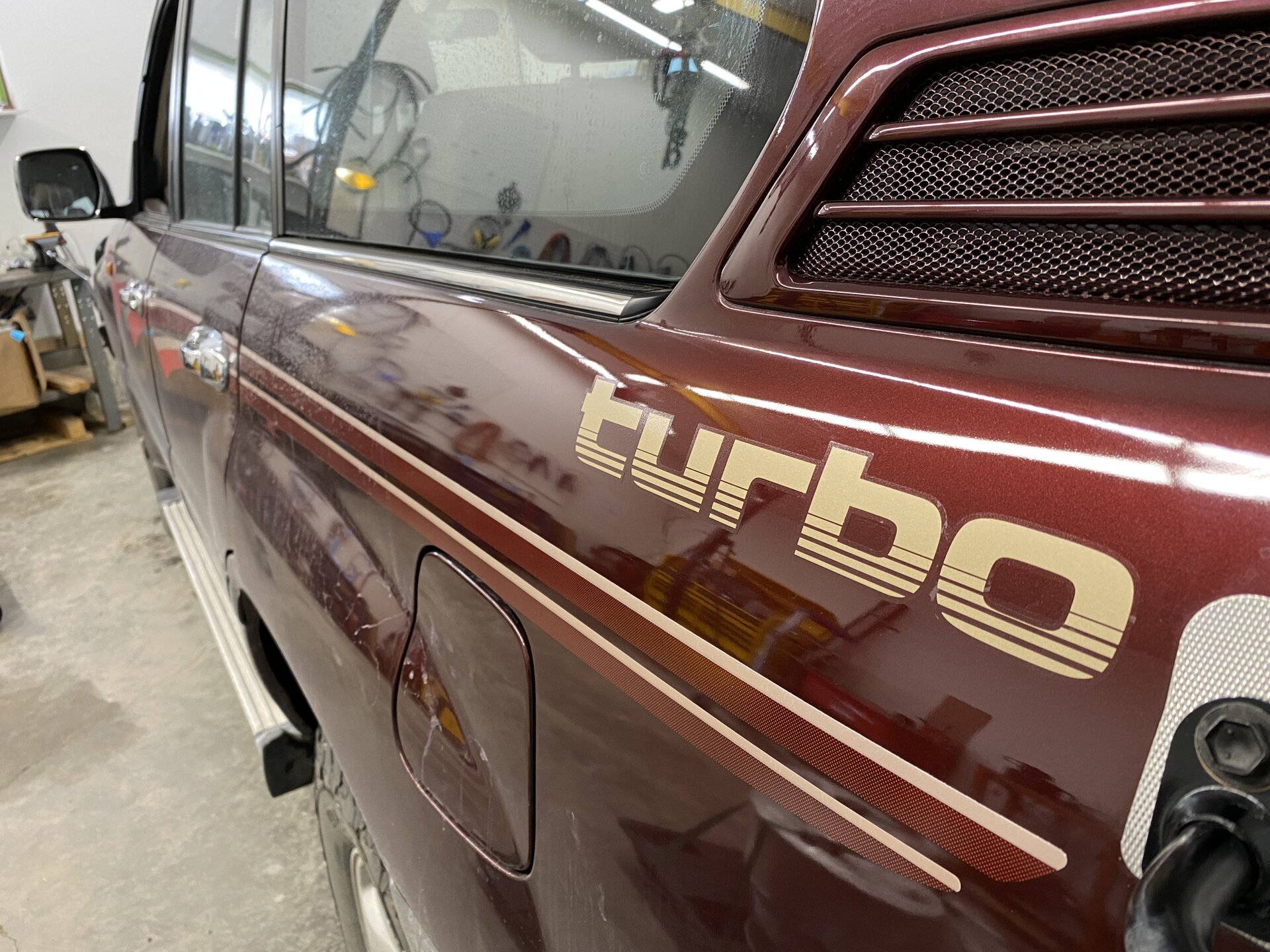

I put the icing on the cake this week as far as the conversion is concerned. Replaced the “4500 EFI” stickers with the OEM “turbo” stickers for the FTE. Totally digging the colour.

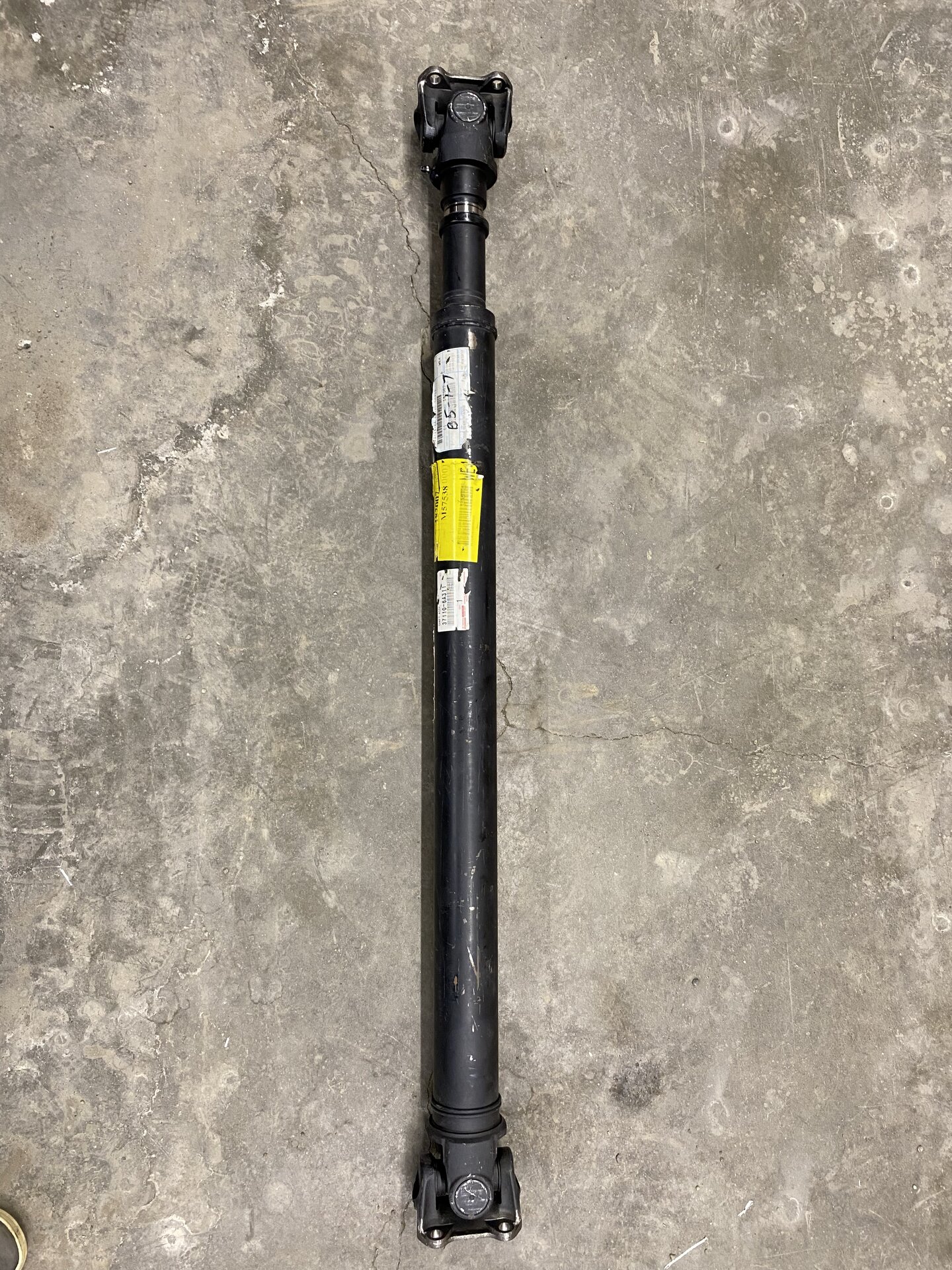

Also my replacement OEM driveshaft arrived from Saudi, courtesy of my parents. This is the OEM manual trans, part time transfer case version. Highway vibrations definitely reduced.

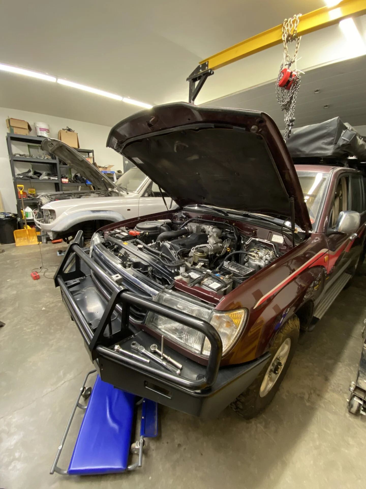

Well I figured out why my pump wasn’t getting good prime…

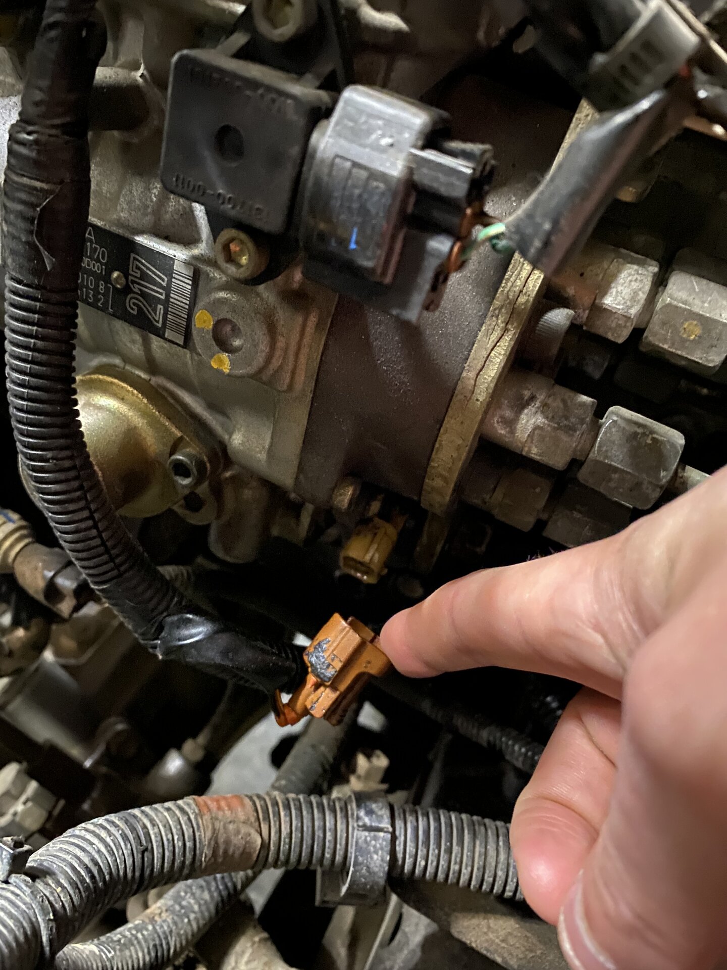

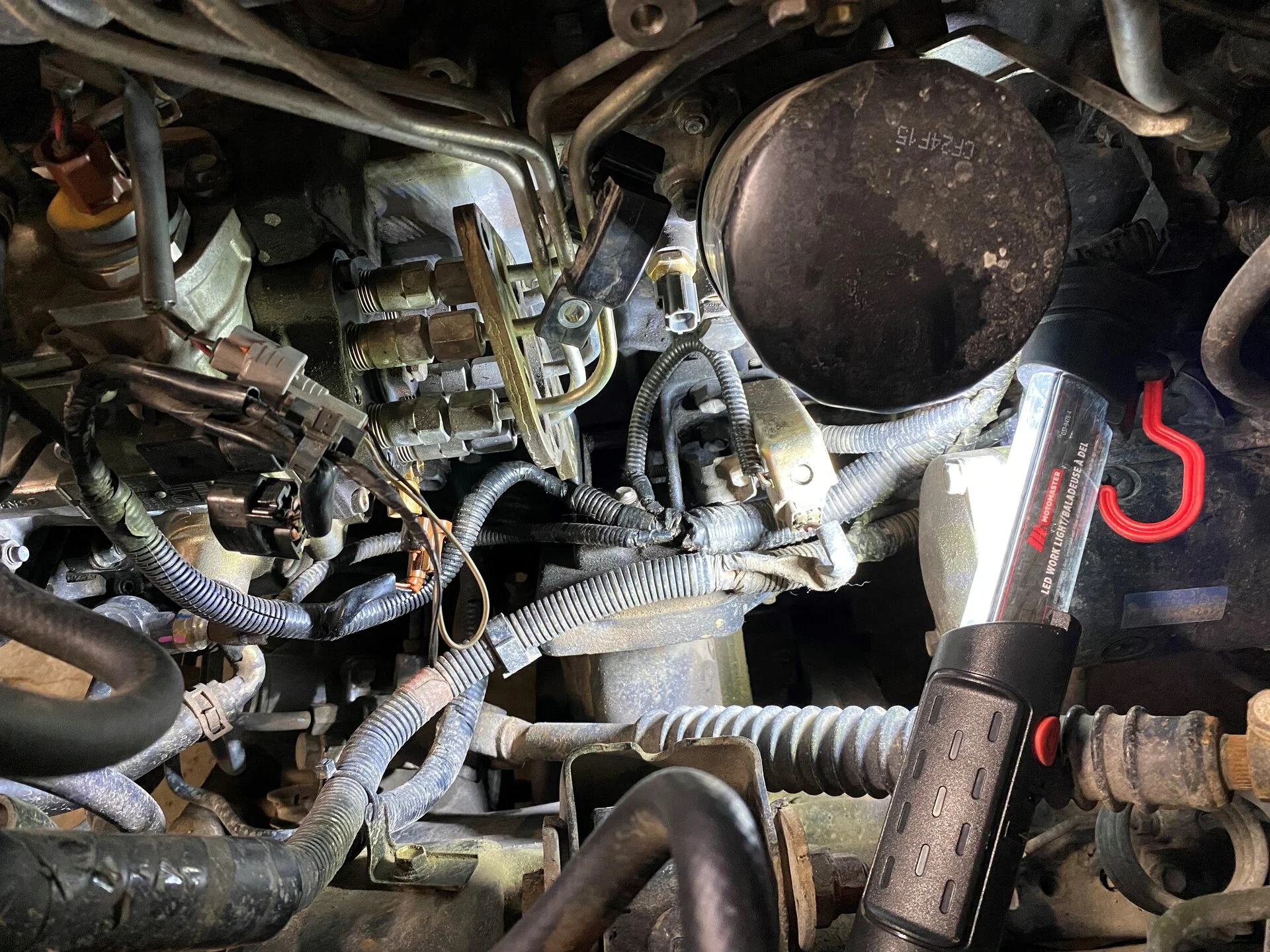

Noticed the motor had a leak the other day. Thought it was an oil leak but managed to trace it back and turns out it’s a diesel leak!
Timing control valve is leaking, apparently it’s quite common. Now I gotta figure out how to get one. It’s Denso P/N 096360-0580.

But in other new, injection pump leak is now fixed!
Got a new timing control valve from a Denso supplier in BC (which was more money than I ever expected this to cost...)

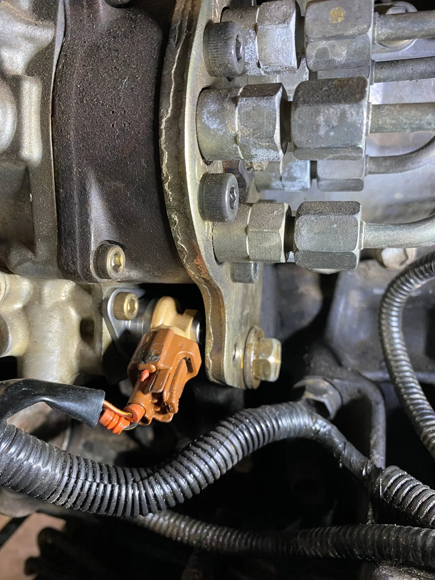

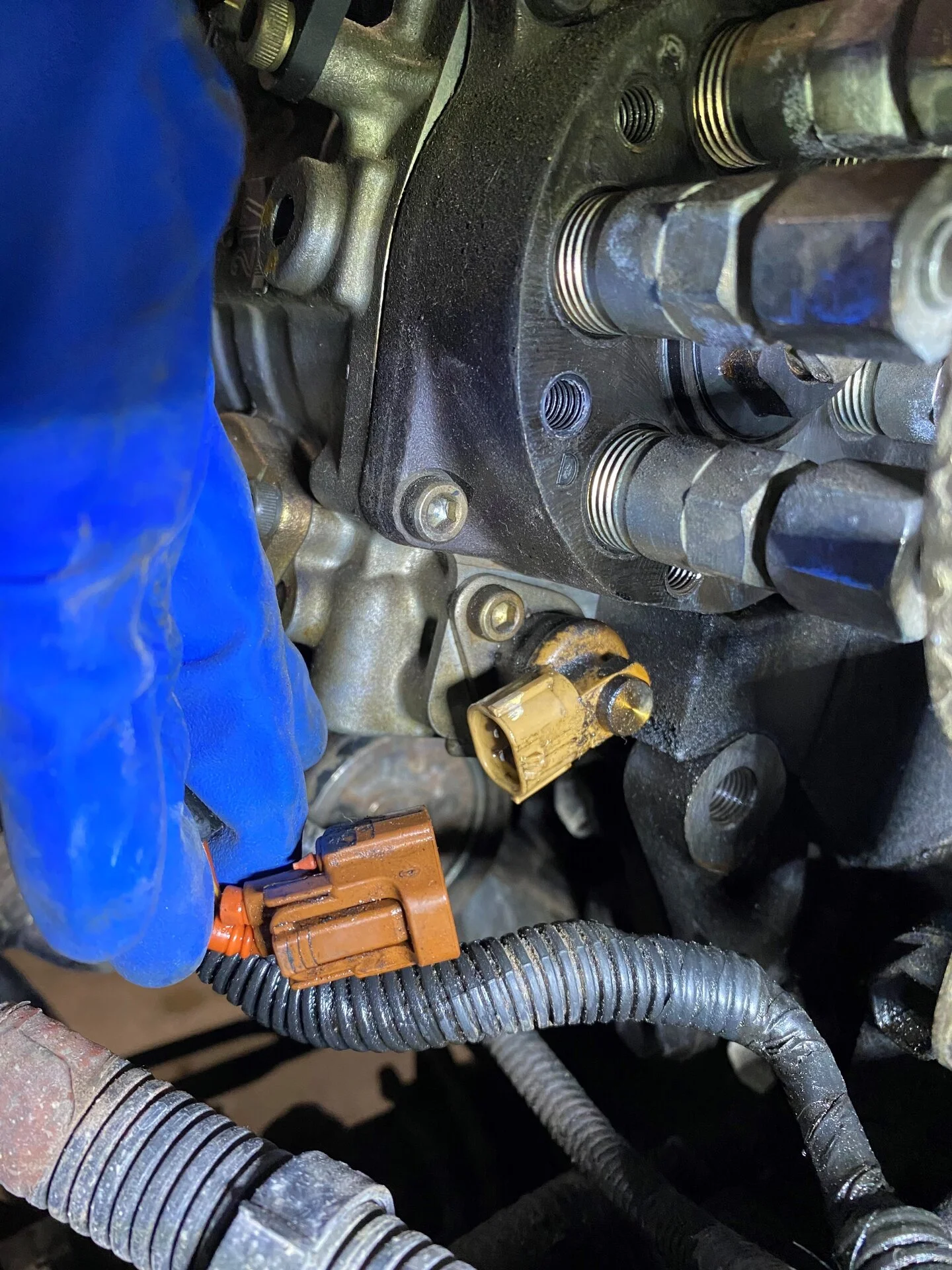

Getting access to the timing control valve was relatively straight forward. Just took some patience. Just had to remove the support bracket at the injection connections which has around 7 thousand bolts attached to it. Then just slid it towards the right and presto - plenty of room.
Here's the leaky control valve. It would literally fill the inside of the connector with diesel which also managed to push out the waster proof orange seals on the other connector.
