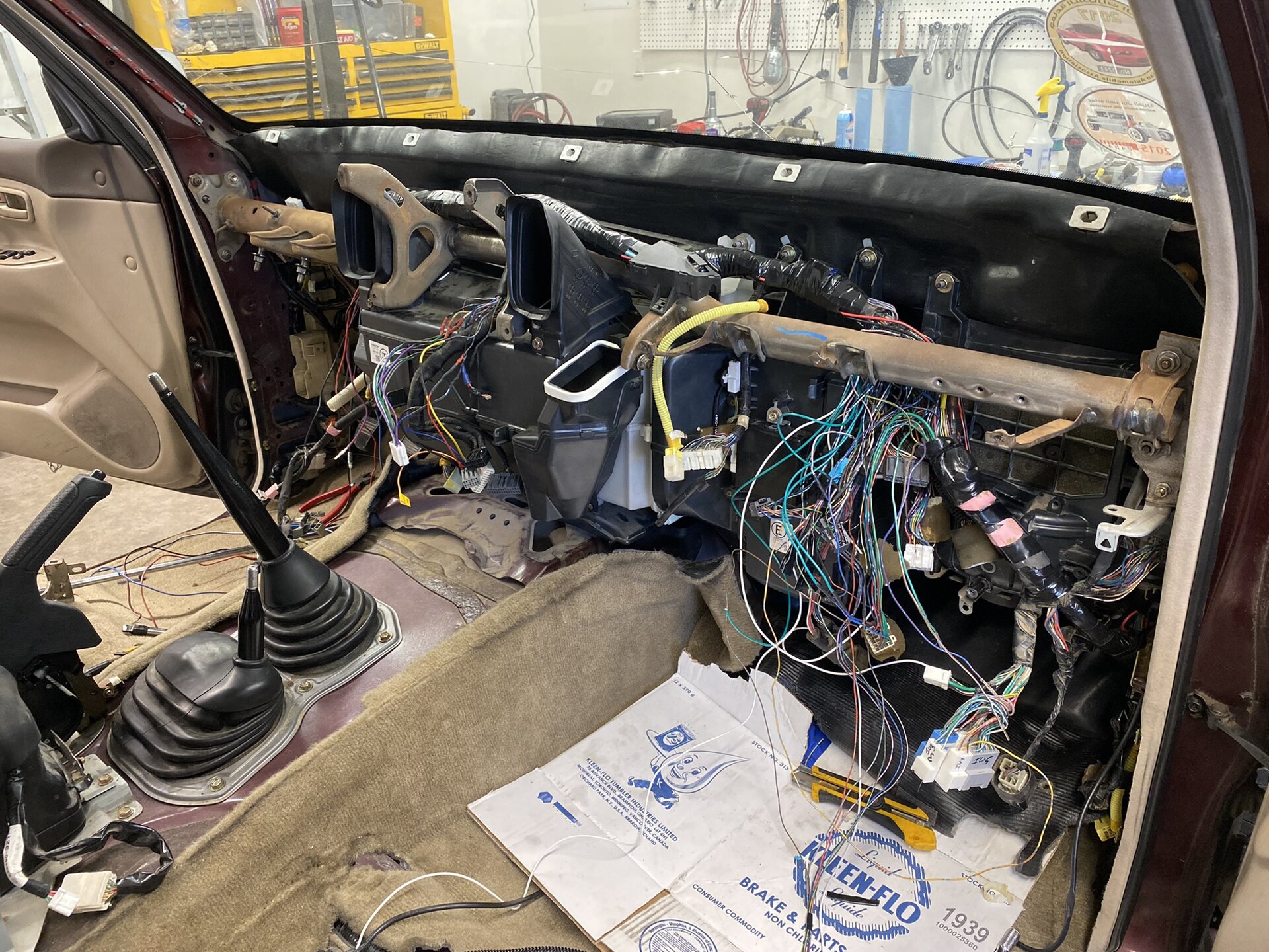

I forgot to post my progress pictures of my interior and wiring adventure.
As mentioned before, I decided to do the conversion wiring completely custom myself. The reasoning was that the GCC options on this truck are so specific, it would be near impossible to find a diesel donor harness that would be compatible with this vehicle. Therefore, I ended up learning the Toyota EWD for the 100 and all the ECU wiring and sharpened my soldering and taping skills.

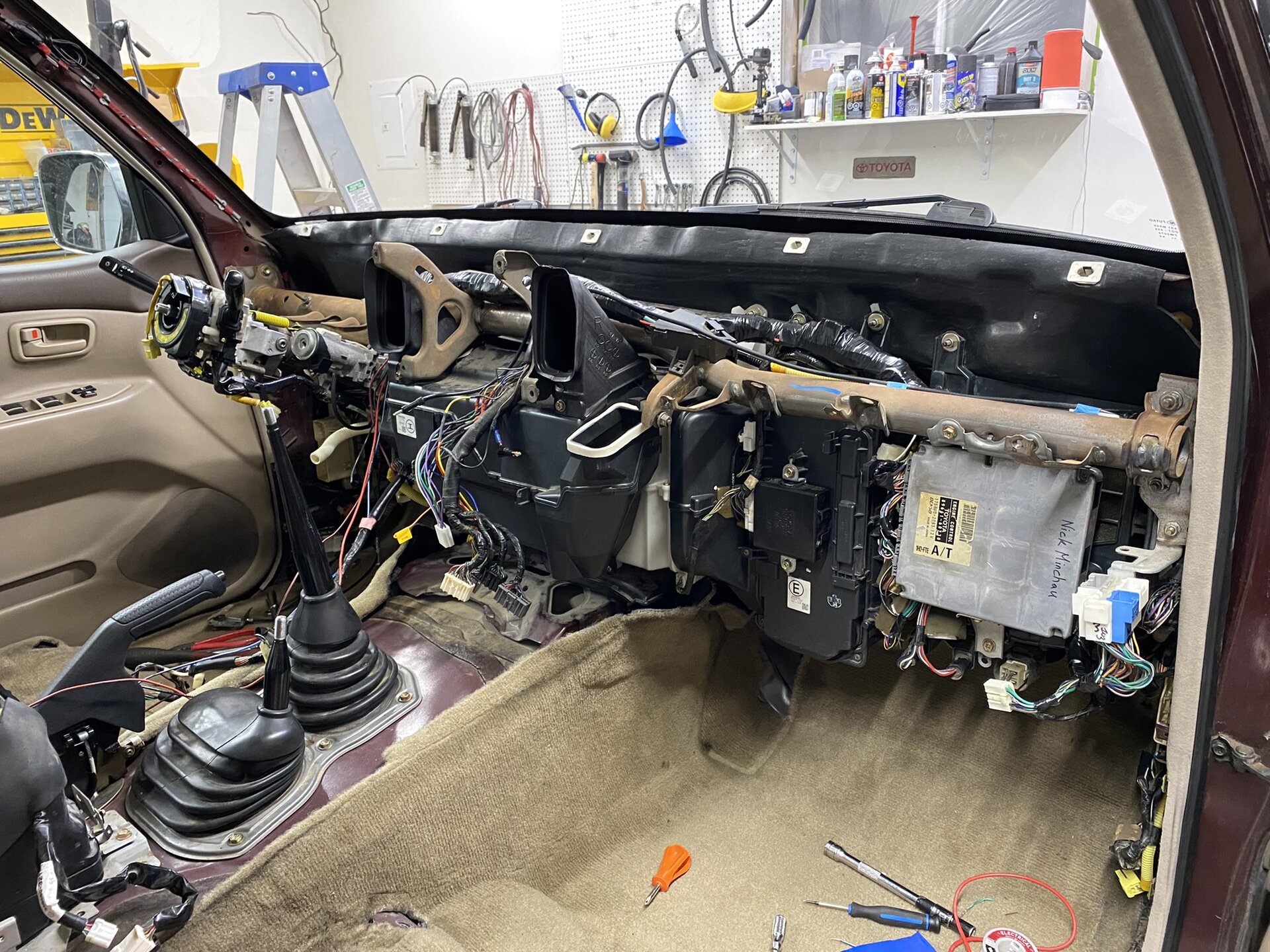

Below shows all the ECU wiring where I had to add almost 20 wires for the accelerator pedal which is fly by wire, cruise control, various spill valve wiring and various additional items that are specific to the FTE. There were also a significant number of wirings I had to delete and tape off that were gasoline specific.
Wiring consolidated with ECU mounted. This was no small feat to get everything to fit properly and reliably. I want this to last 20 years so I can’t risk any wiring rubbing on components and wearing out over time.

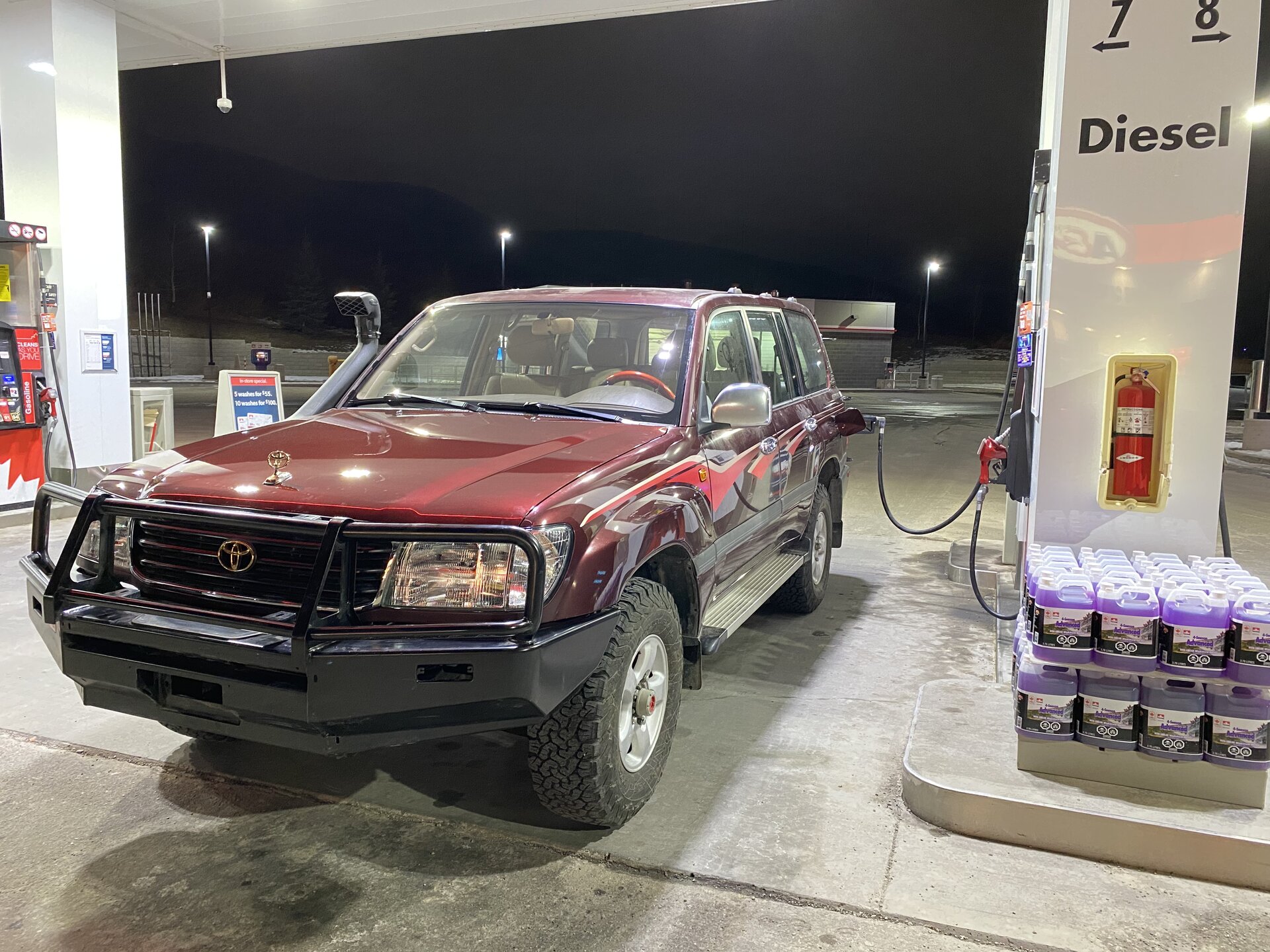

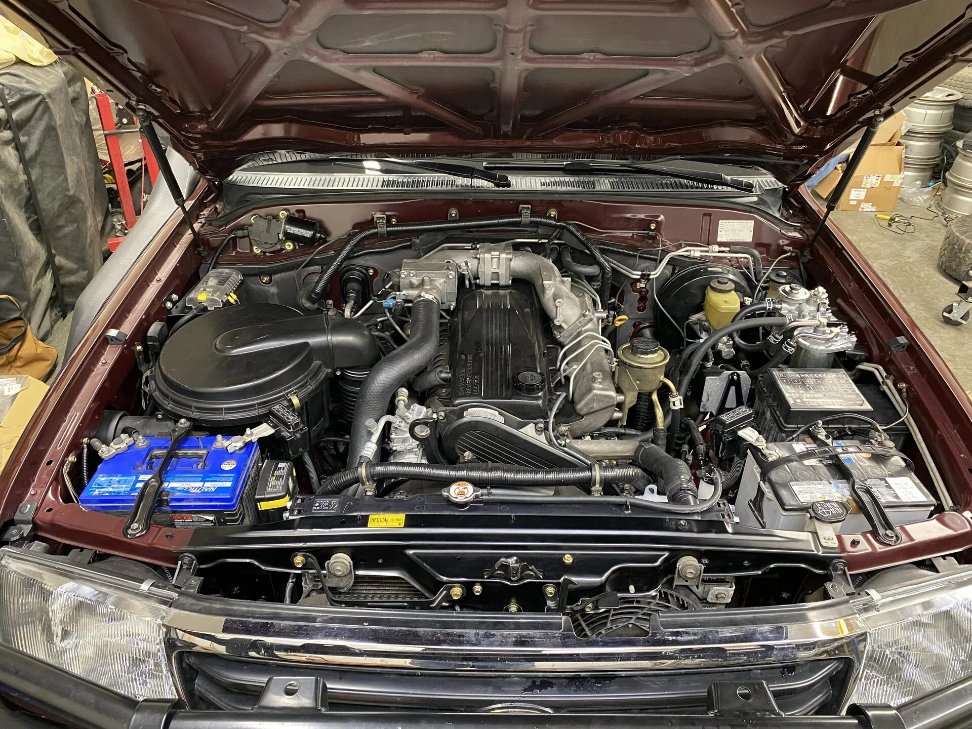

It’s done and on the road!
This whole process has taken me almost 3 years of research, finding parts, planning and probably 500+ hours of my own labor.
It drives perfect, it’s smooth, relatively quiet and is better than i expected. I had a fear that doing this big of a conversion, ultimately being a one way trip for this truck, would create new problems that I’d have to live with. But I’m happy to say, so far, I’m quite happy with it. Maybe time will tell.
However, there will be no more wrenching for me, I’m taking a hiatus for a little while. This took a very large portion lot of my time and energy (and not to mention money) which I’d like to focus elsewhere.
For now, I’ll leave you with photos of the finished product, and stories from future adventures this summer!
