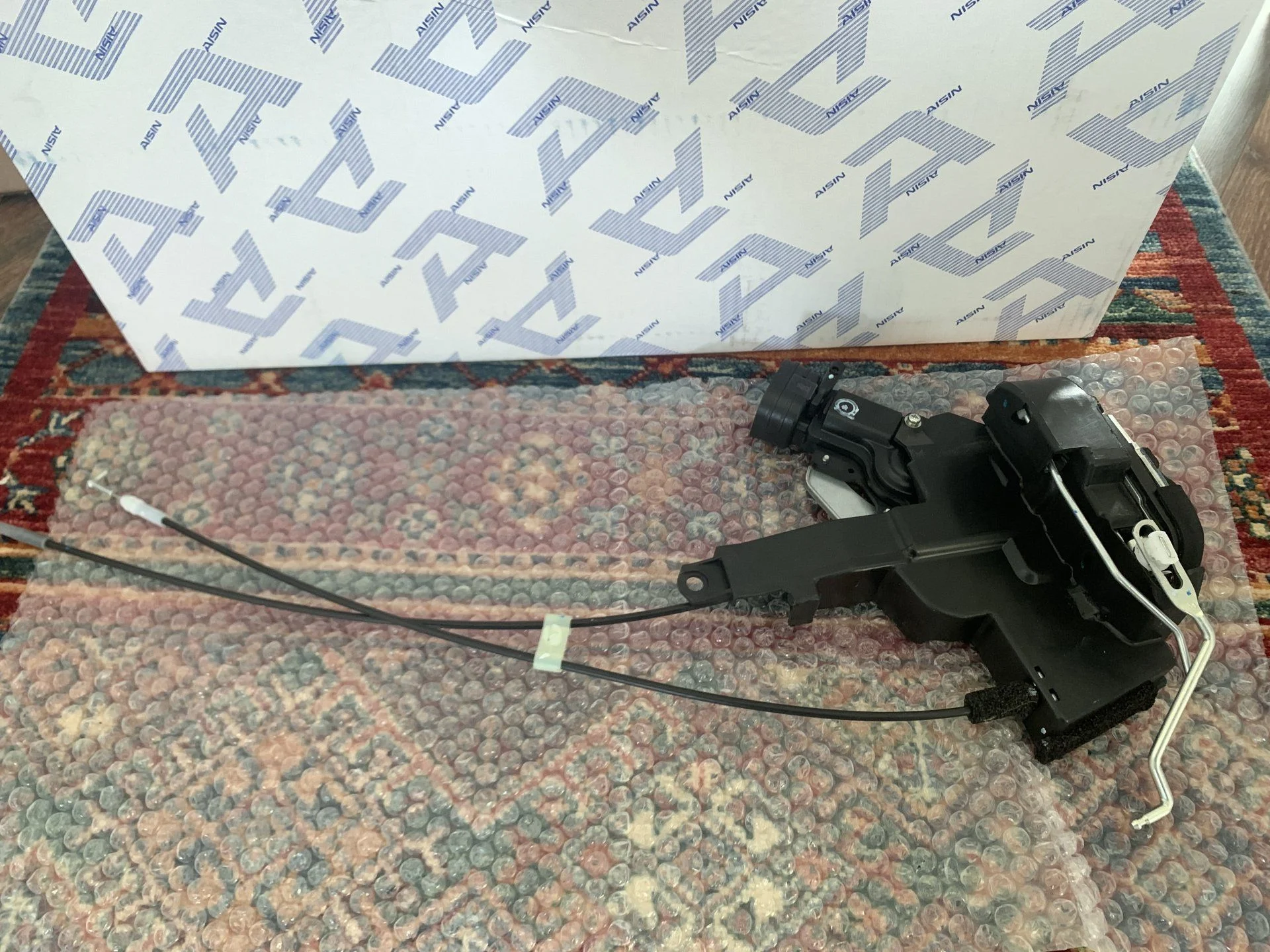

Took apart the door panels to replace the door lock actuators. My truck has the classic "slow locks" issue. So I bought new AISIN actuators from Rockauto, and much to my surprise, they were made in Japan! Far cheaper buying them this way, in my opinion a no brainer!

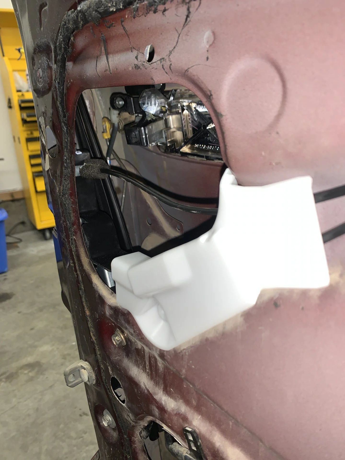

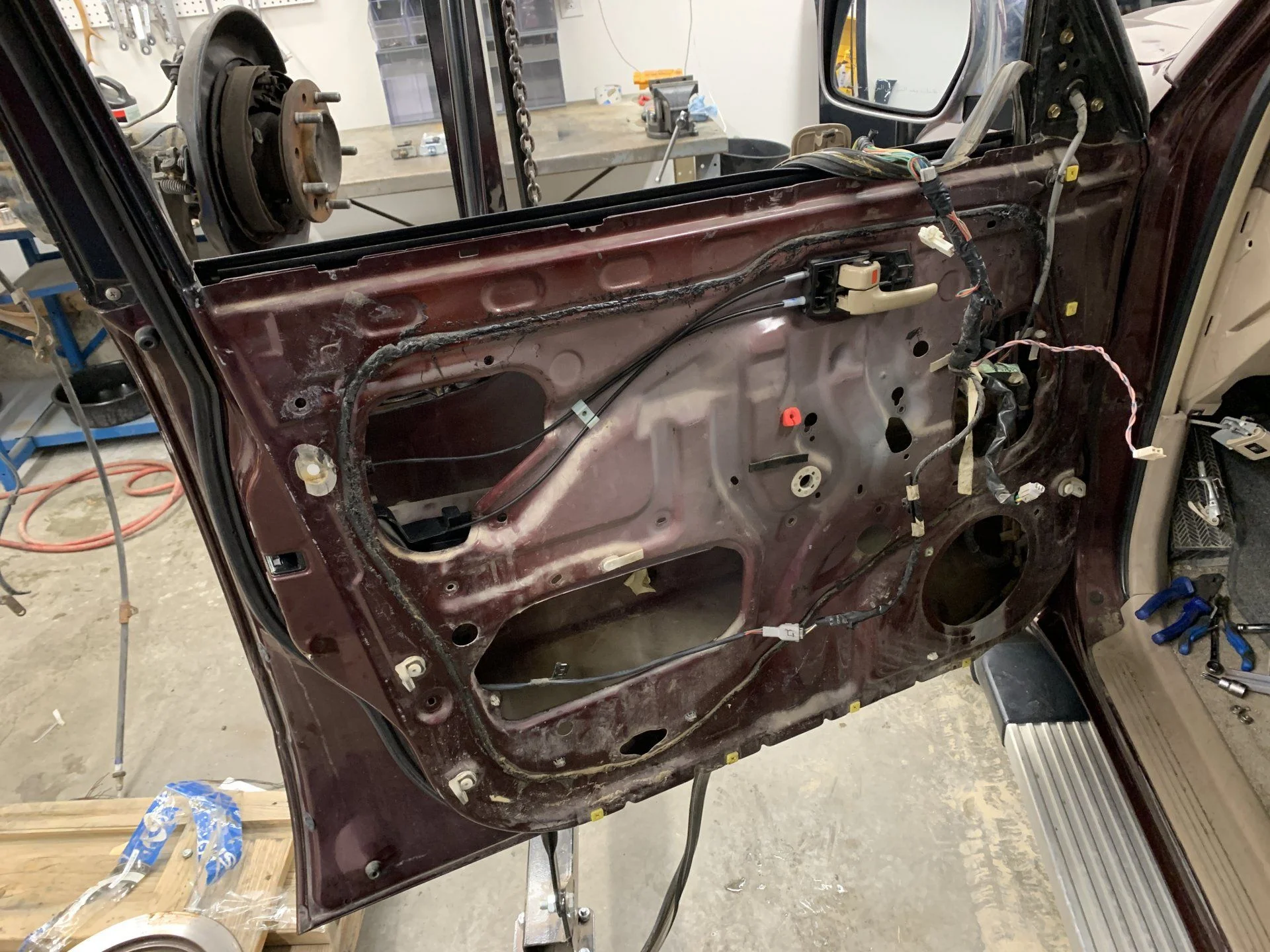

When I removed the door cards I discovered that the insides of the door panels were an absolute MESS. They are going to need a ton of clean up, new parts and restoration.
All locks work perfectly now.

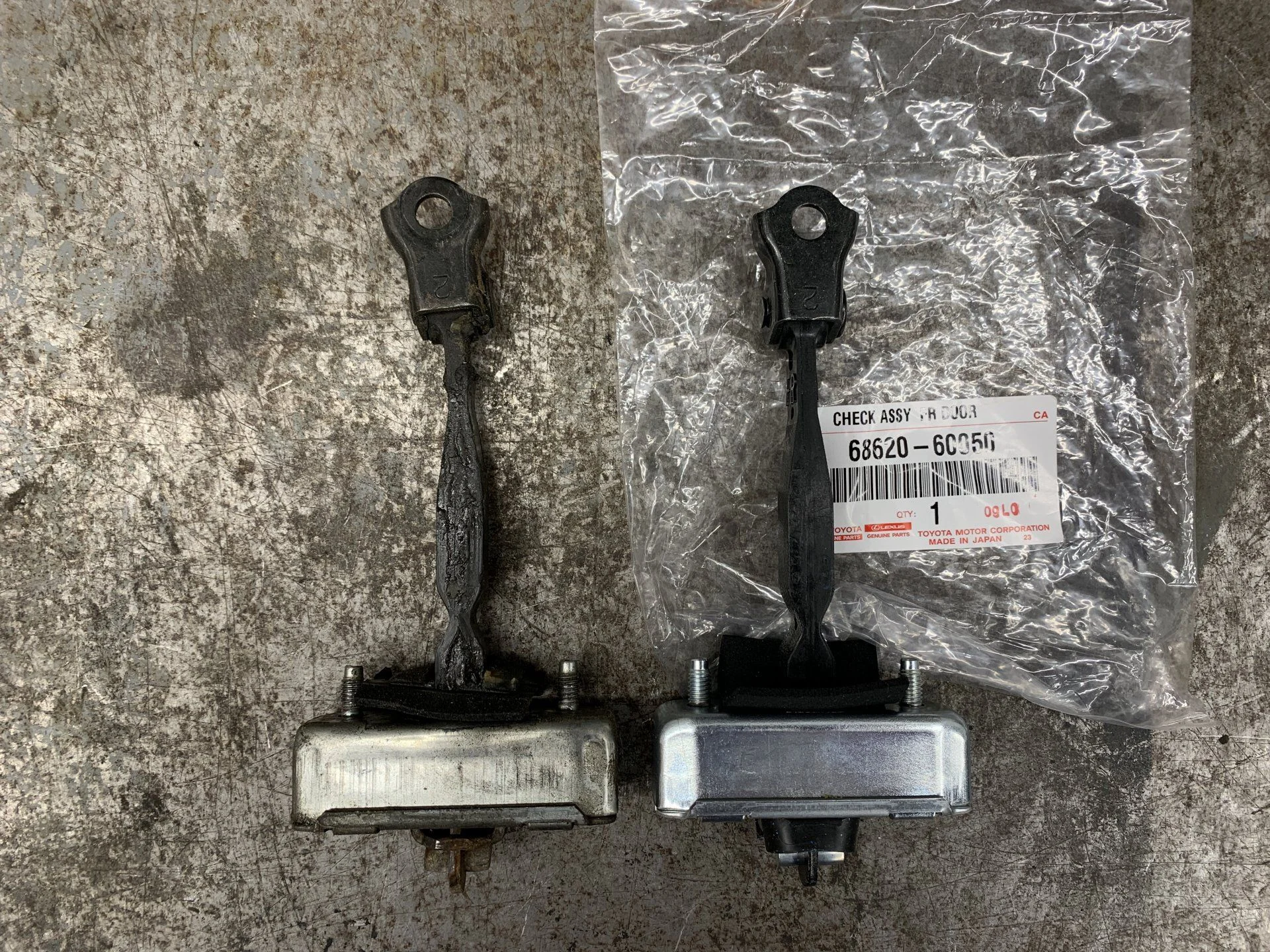

I discovered that the driver's side door must have had some sort of mishap during its life. The door check was colliding with the window run guide (which explains why the window would make noise when it went down). Check it out, it's bent out of shape! I promptly replaced with a new one and fixed the damaged window run guide.

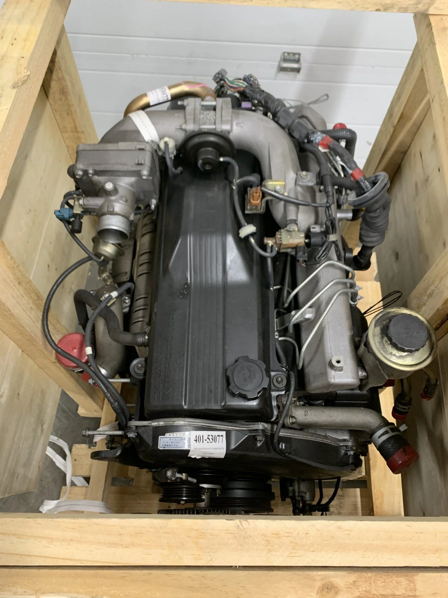

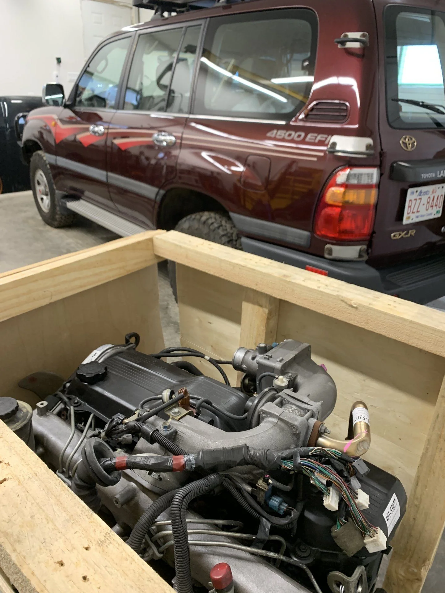

But AFAIK you can't import them in the States yet. How did you mnage to get the engine though and how are you going to register it?
1HDFTE, baller. I assume it's much easier to swap this into a 1FZ equipped 100 vs a 2UZ.
Curious though, you can get a factory LHD manual 100 series diesel from europe for 15-30k euros, wouldn't you be better off going that route?
Technically yes, but my truck didn’t cost me anything other than shipping. Plus I prefer the barn doors and sub tank included. Euro market has none of those things. 15-30k is significantly more than 0. Haha

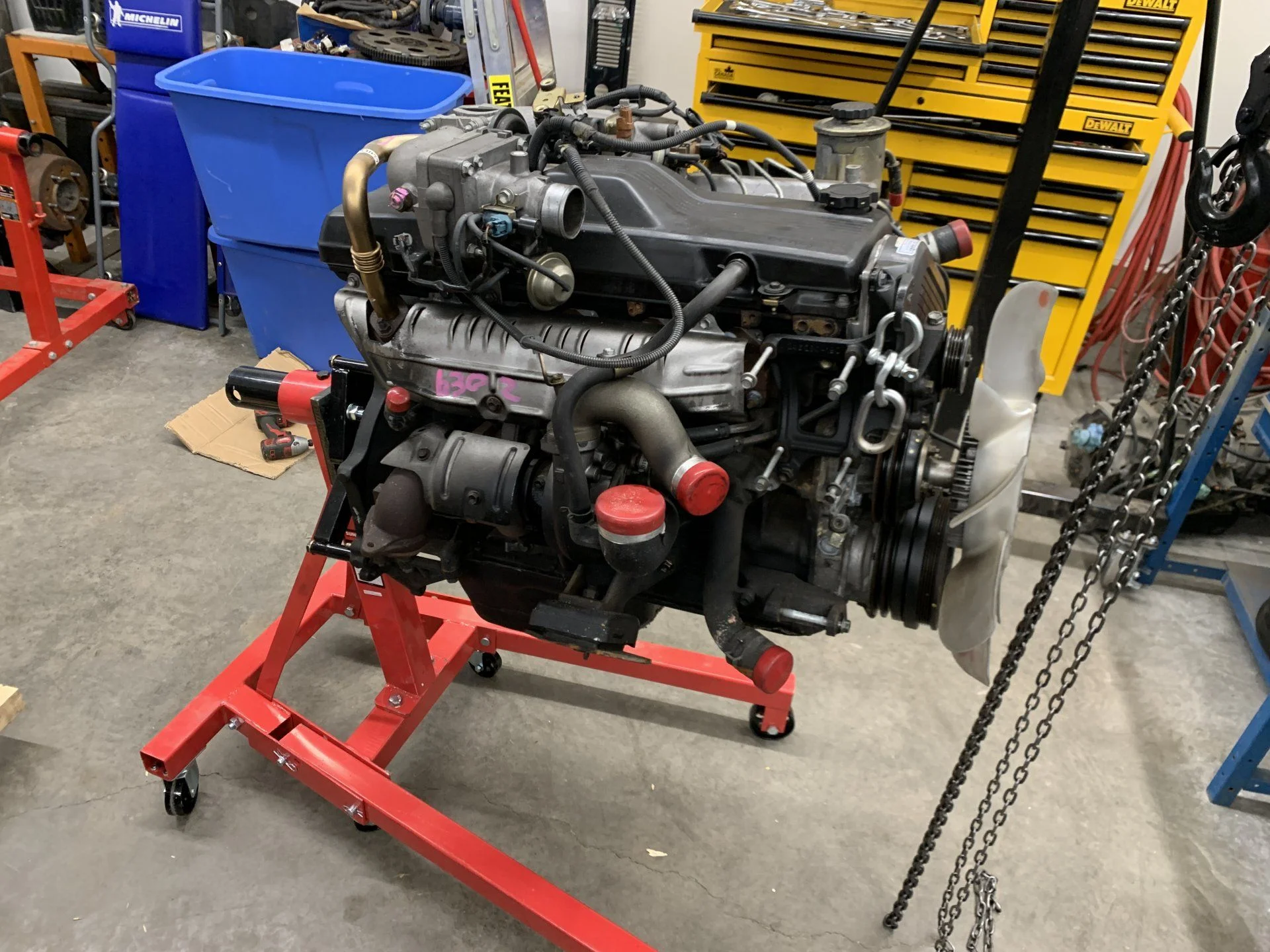

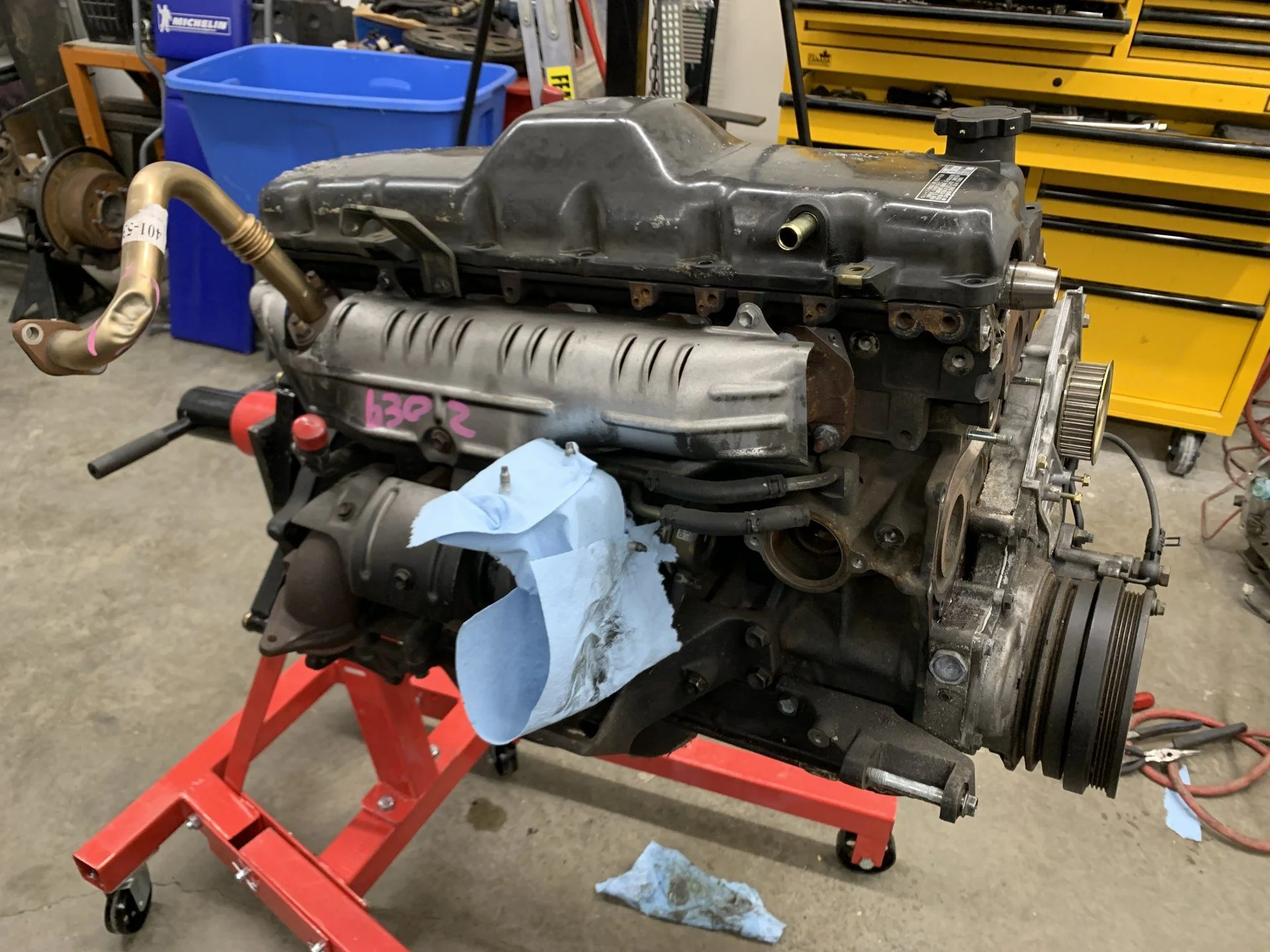

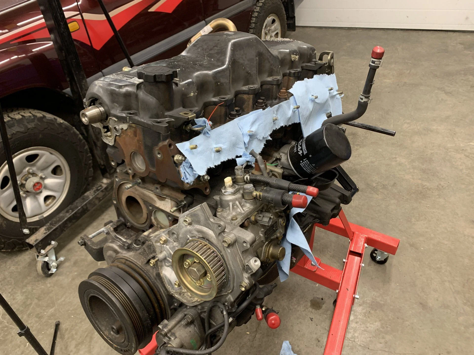

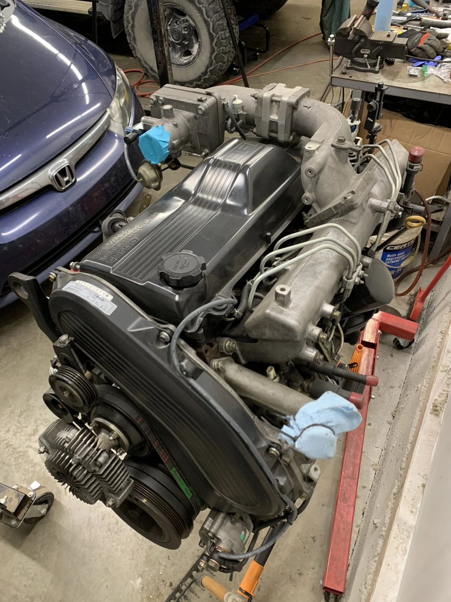

Finally managed to find an engine stand that can hold up this beast... ended up needing a 1 ton stand for this heavy beast.

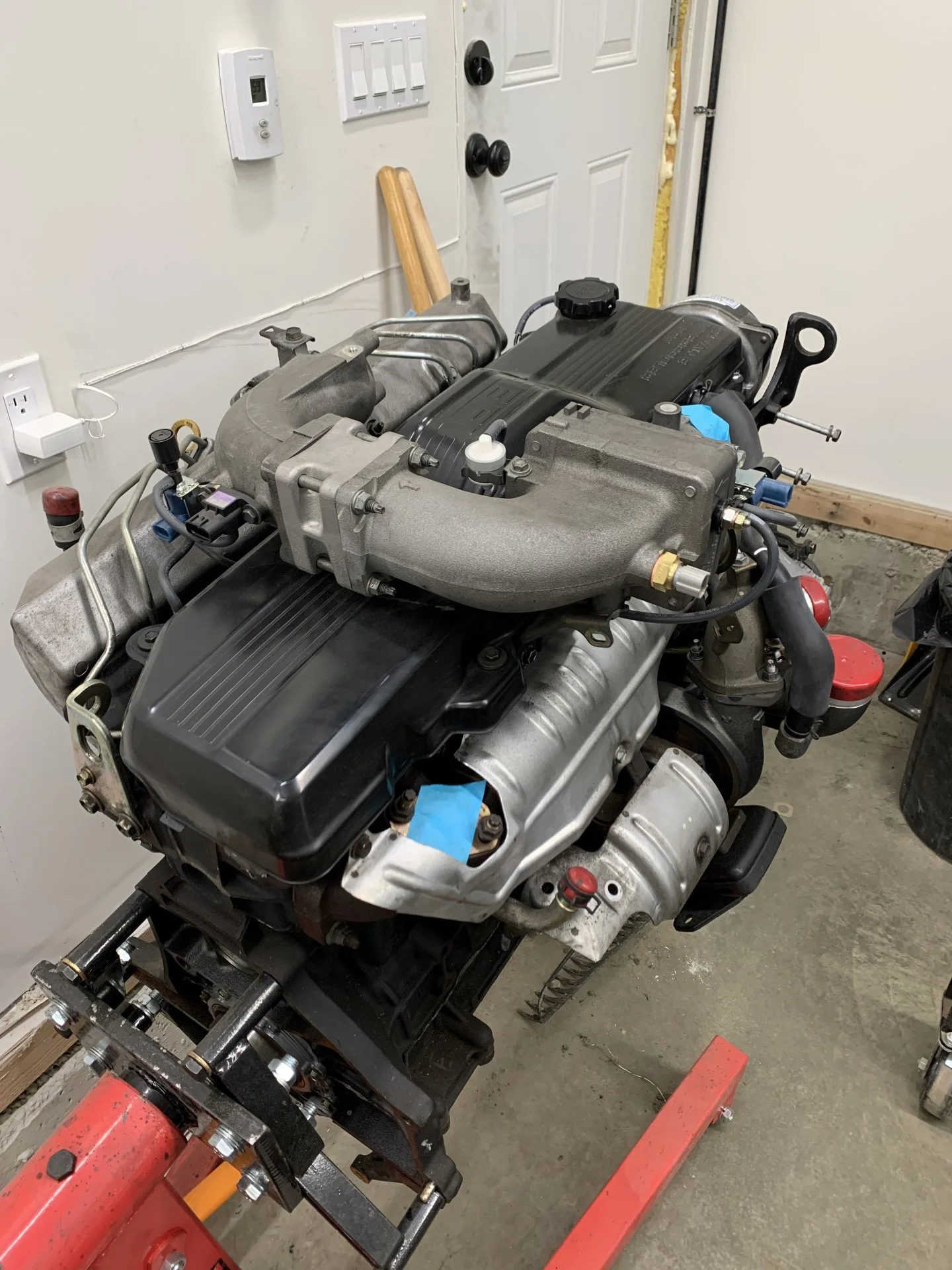

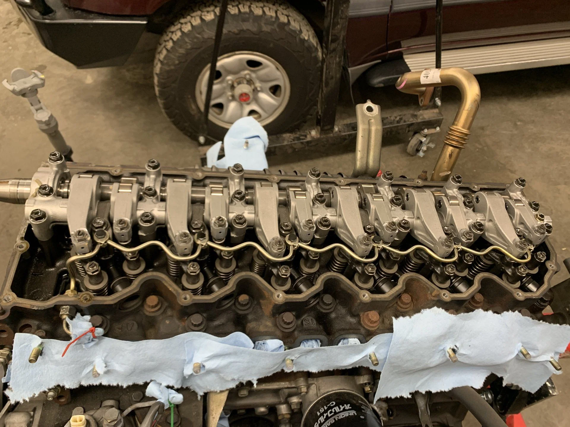

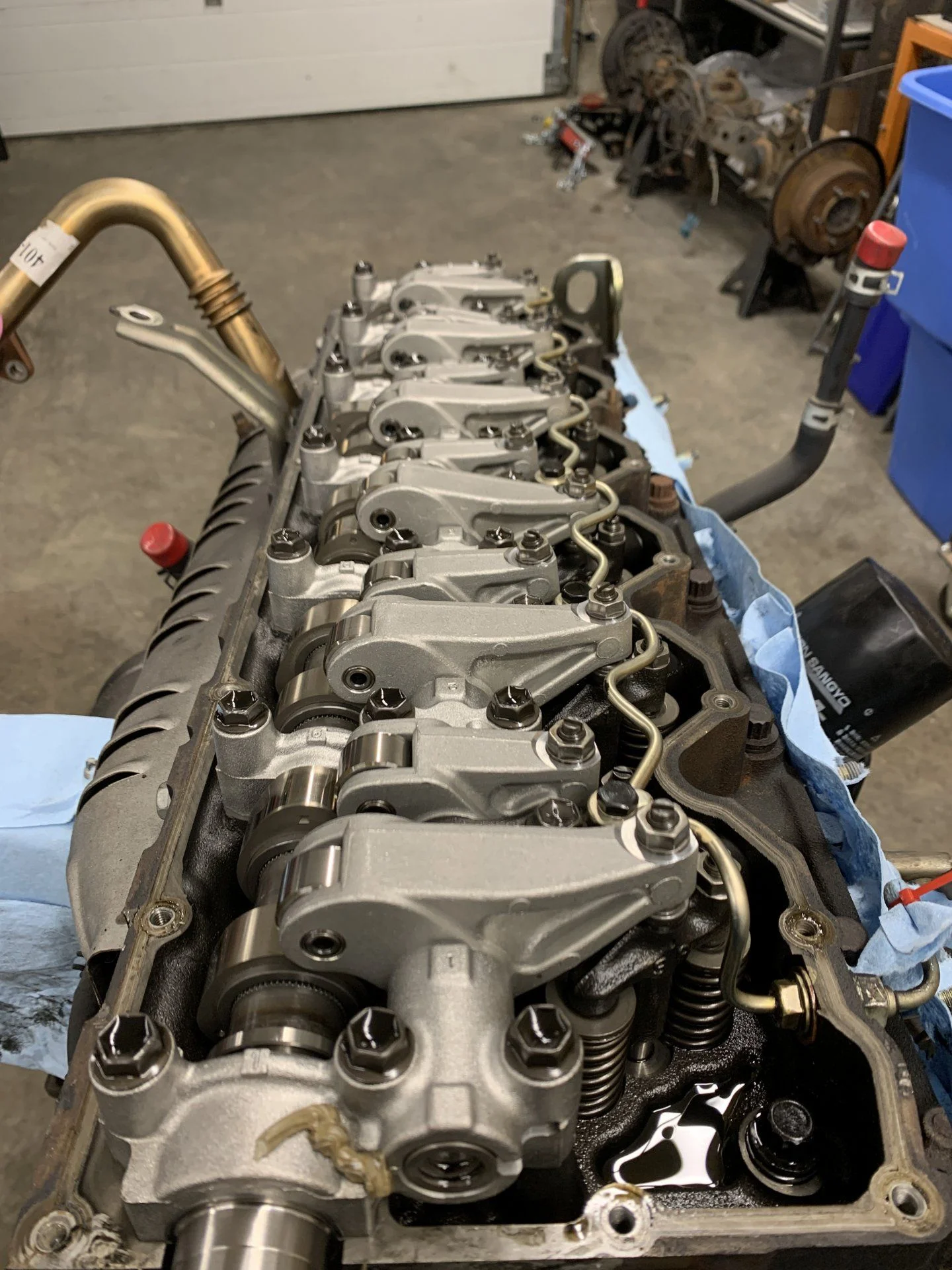

Take a look at the valve train on this thing. It's mint! I couldn't believe how clean it was. Wow!!
This is where I got to... ordering parts this week. Only doing a light refresh on this thing considering its low mileage and quite good condition!

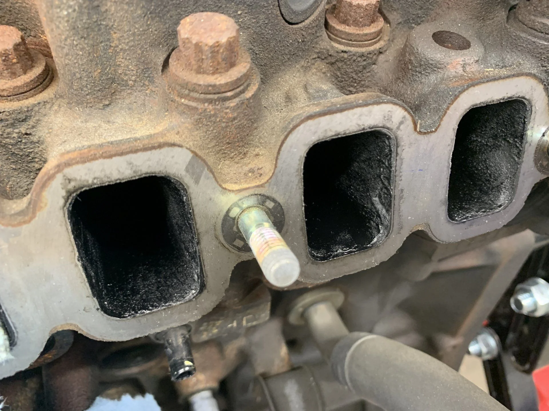

Man that is really clean. How did the intake look? Clogged up or not so bad? EGR delete is the 1st thing these need IMO. Let it breathe!!!
They're gunked up... but could definitely be worse!!

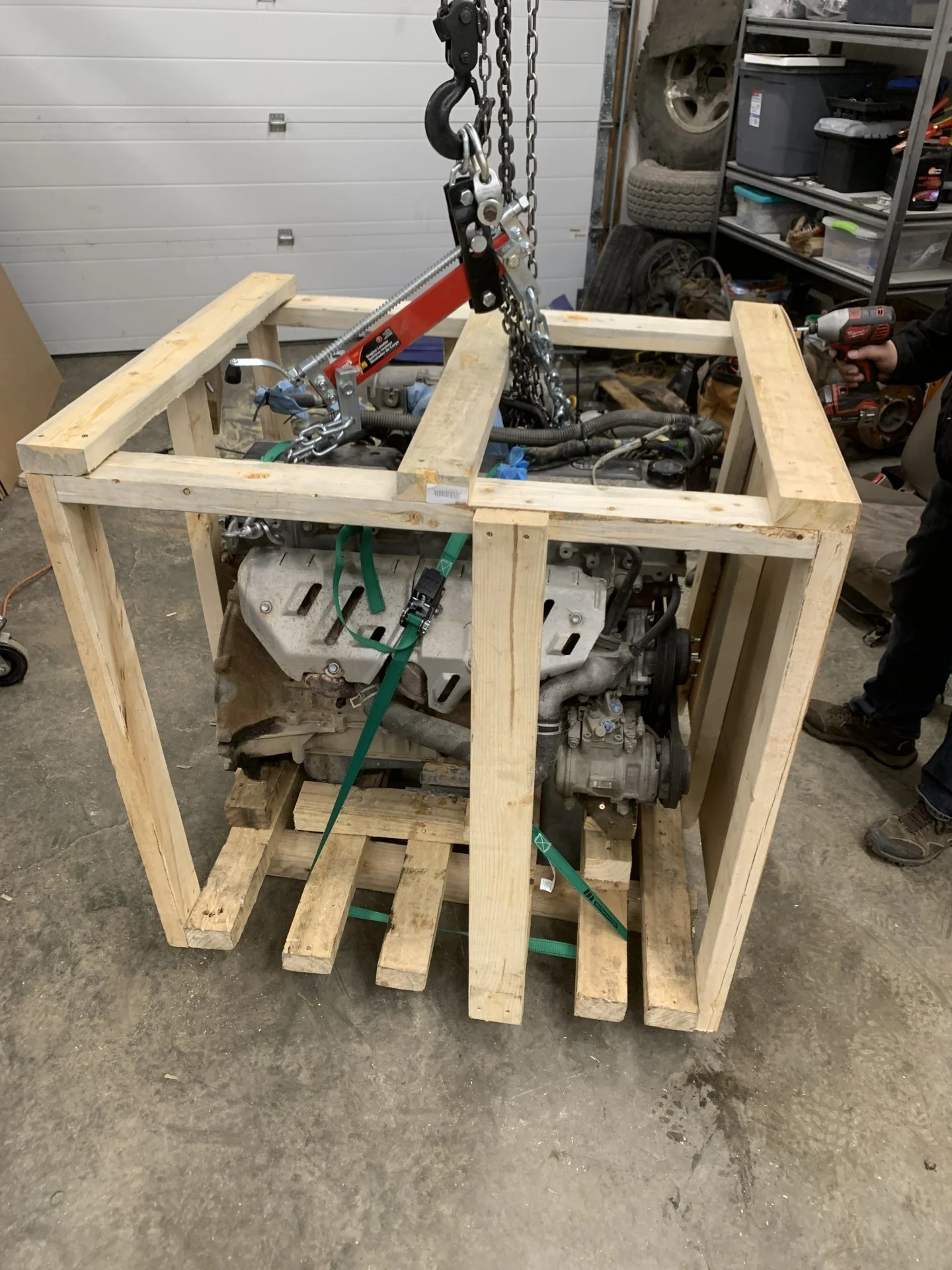

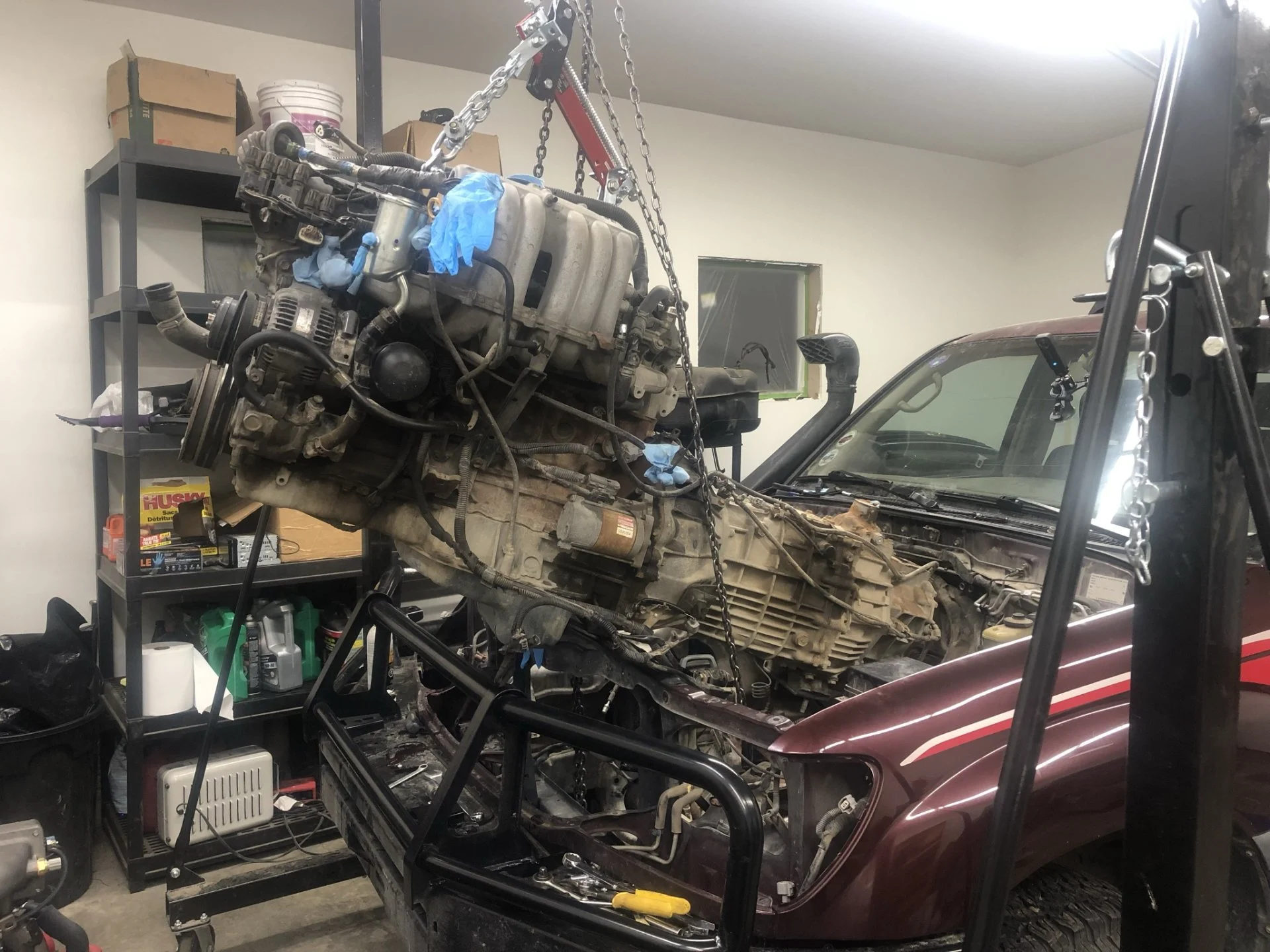

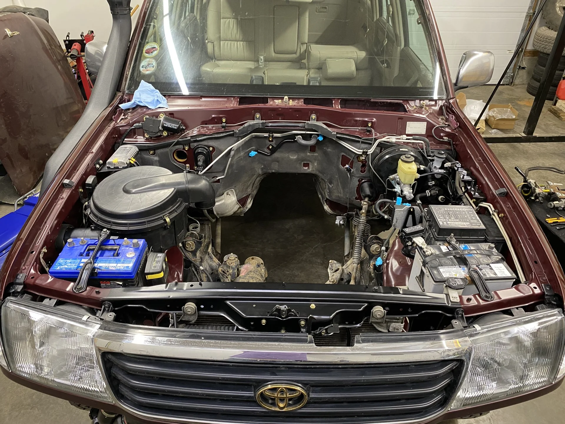

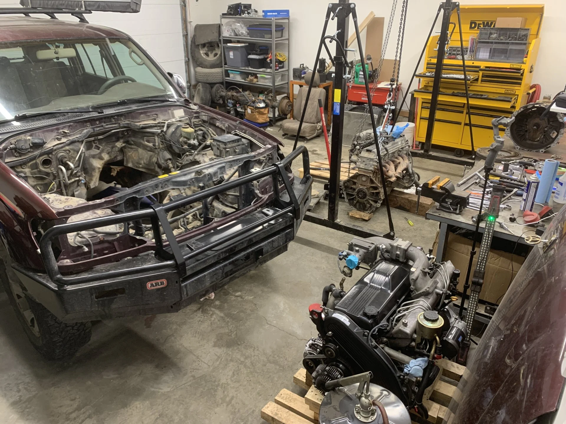

We removed the 1FZ last week and have been packaging it up for a mud member that's got their name on it! Overall, engine removal was a breeze. I've removed full drive trains on other cruisers (80s and 100s) with the auto still bolted on, but I have to say, removing the drivetrain with the H151 is MUCH easier. Probably took half the time overall I would say.

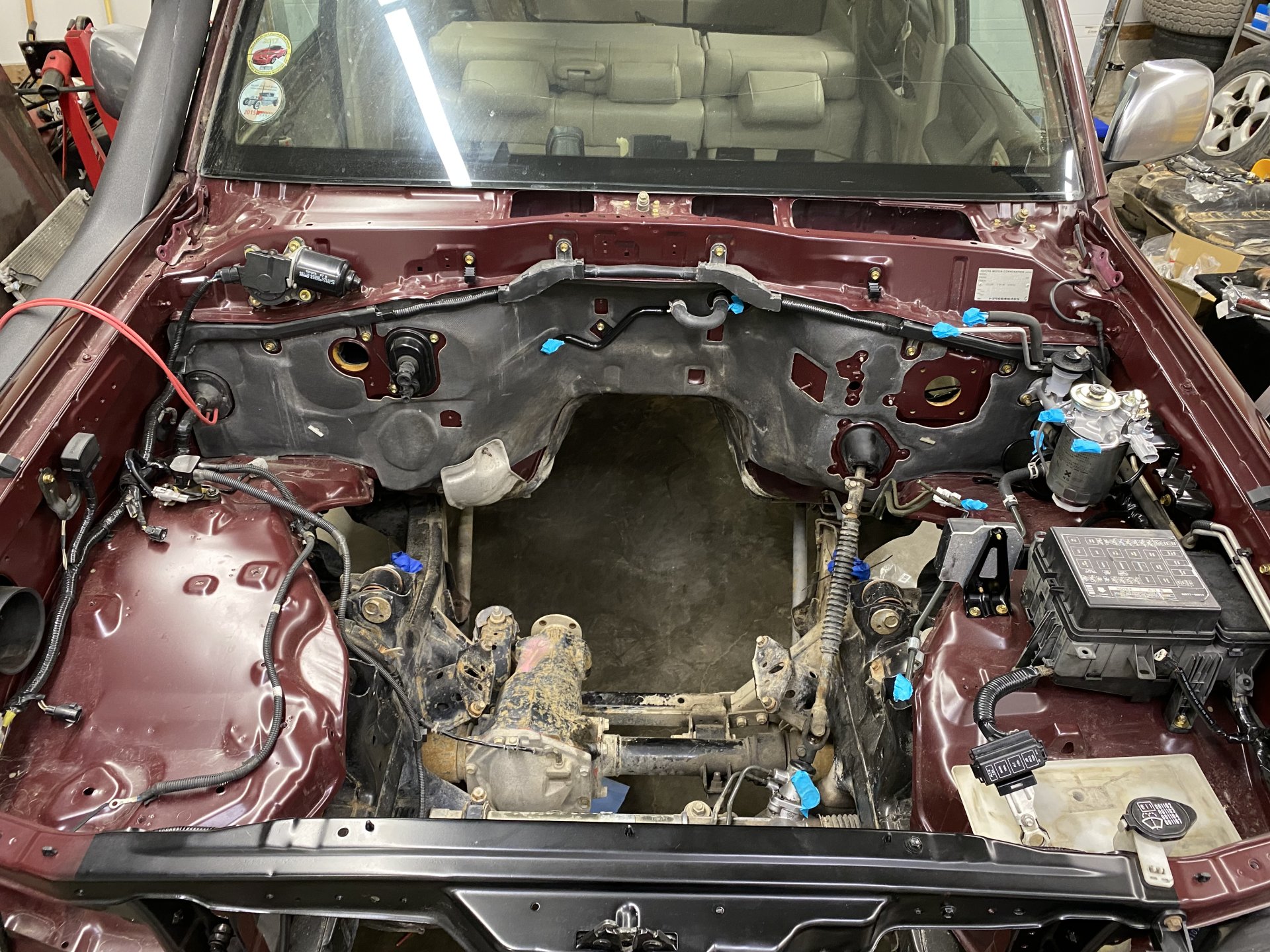

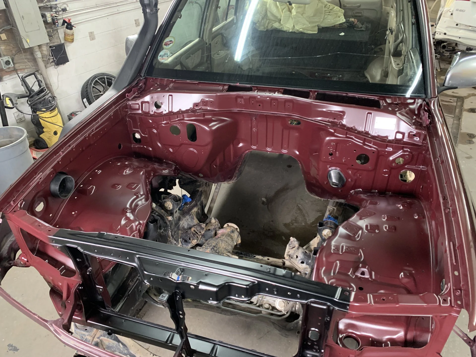

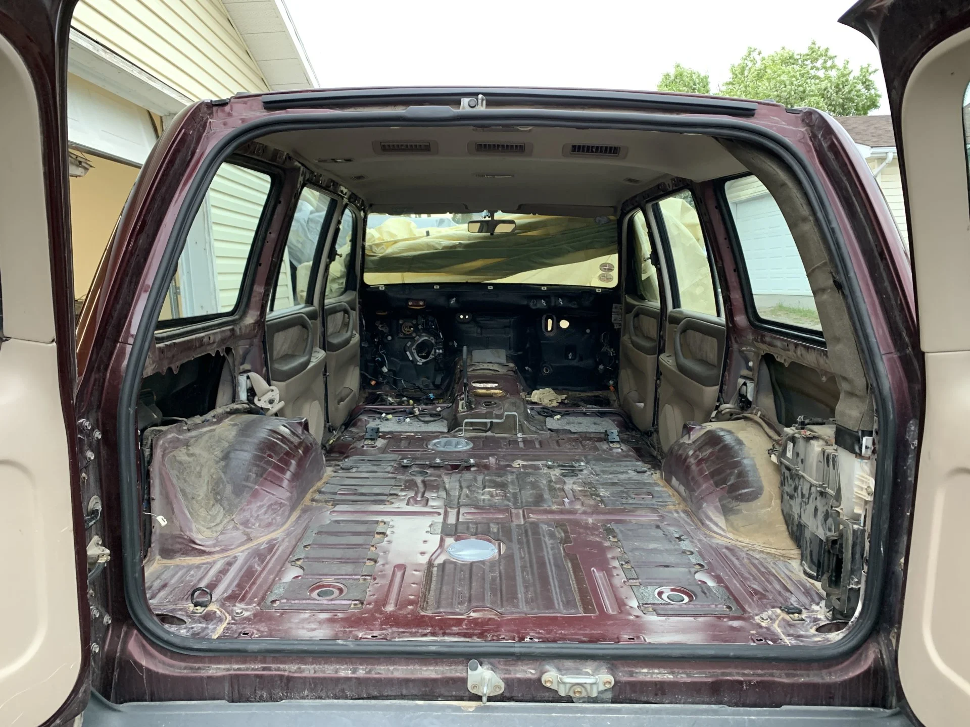

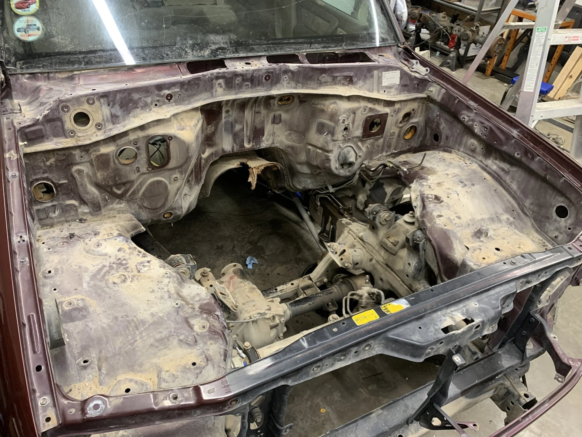

So I pulled absolutely EVERYTHING from the engine bay. It was filthy, and needed a ton of work.
I got it cleaned up and took the truck to a body shop to have the engine bay sprayed. I also had them weld various capture nuts on the firewall for the FTE gas pedal, along with some new brackets for my fancy interior overhaul. The engine bay turned out VERY nicely.
Here is where the truck sits today. This was a LOT of work. I took the FZJ100 engine bay harness and modified it by hand to incorporate the FTE stuff including: spill valve wiring, new starter wiring, water trap sensor, fuel heater, intake screen heater, modified alternator and AC compressor wiring. Also, since the harness was in terrible condition, I re-sleeved the entire thing, cleaned it up, re taped and even put in new PVC sleeves for the electrical connectors. It looks great, but it probably took me 15+ hours on the engine bay harness alone. Oh, I also got the bolts yellow zinc coated too. :cool:
You can also see the new fuel lines are installed as well. I managed to order a new 12mm diesel main fuel line from Japan (getting it here was a HUGE challenge). The best way to install fuel lines on a 100 is to actually lift the body off the frame on the LH side. There's no other way to do it. We unbolted the LH body mounts and lifted the body ~2" and the fuel lines went in instantly. Very easy.

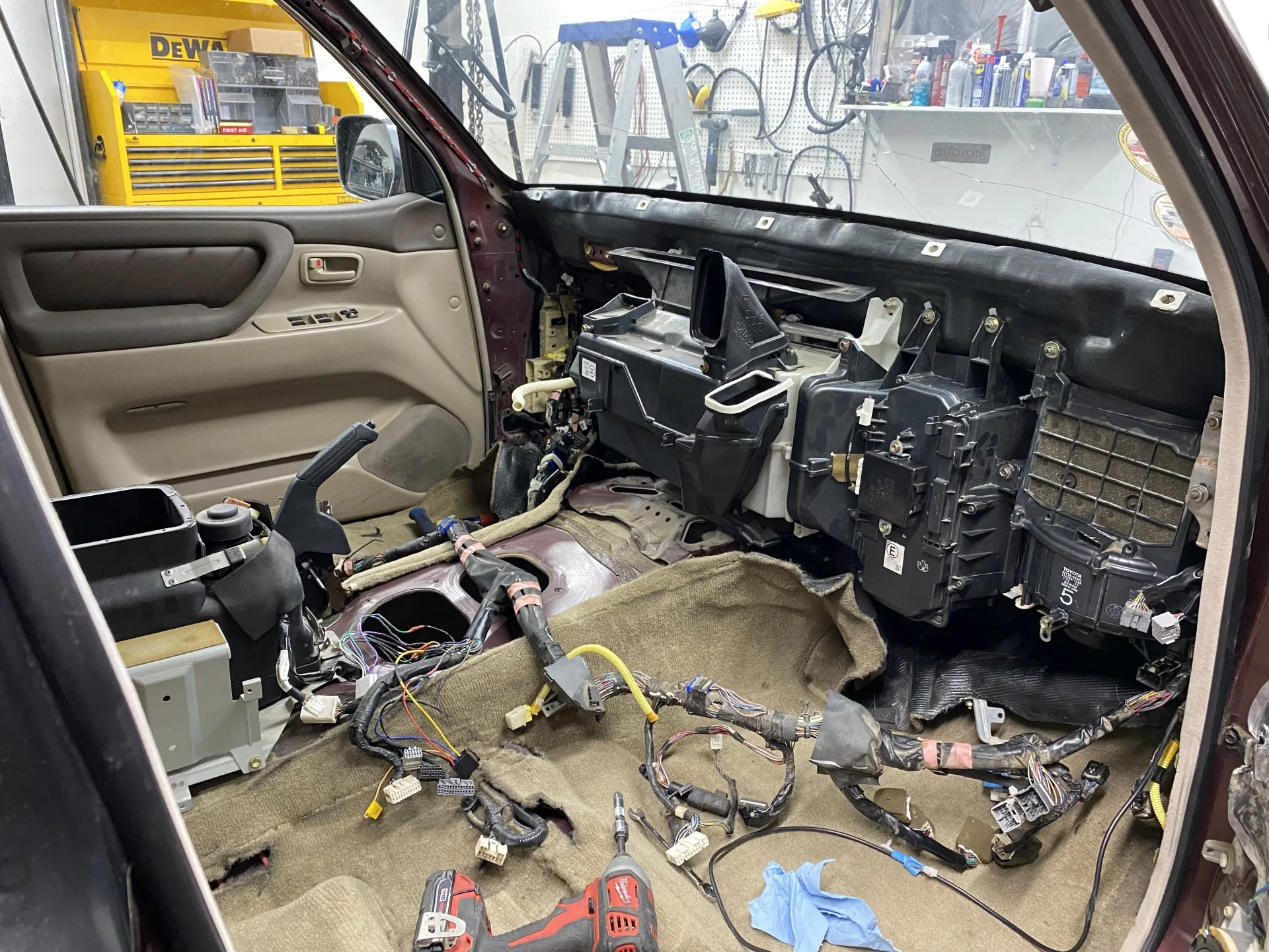

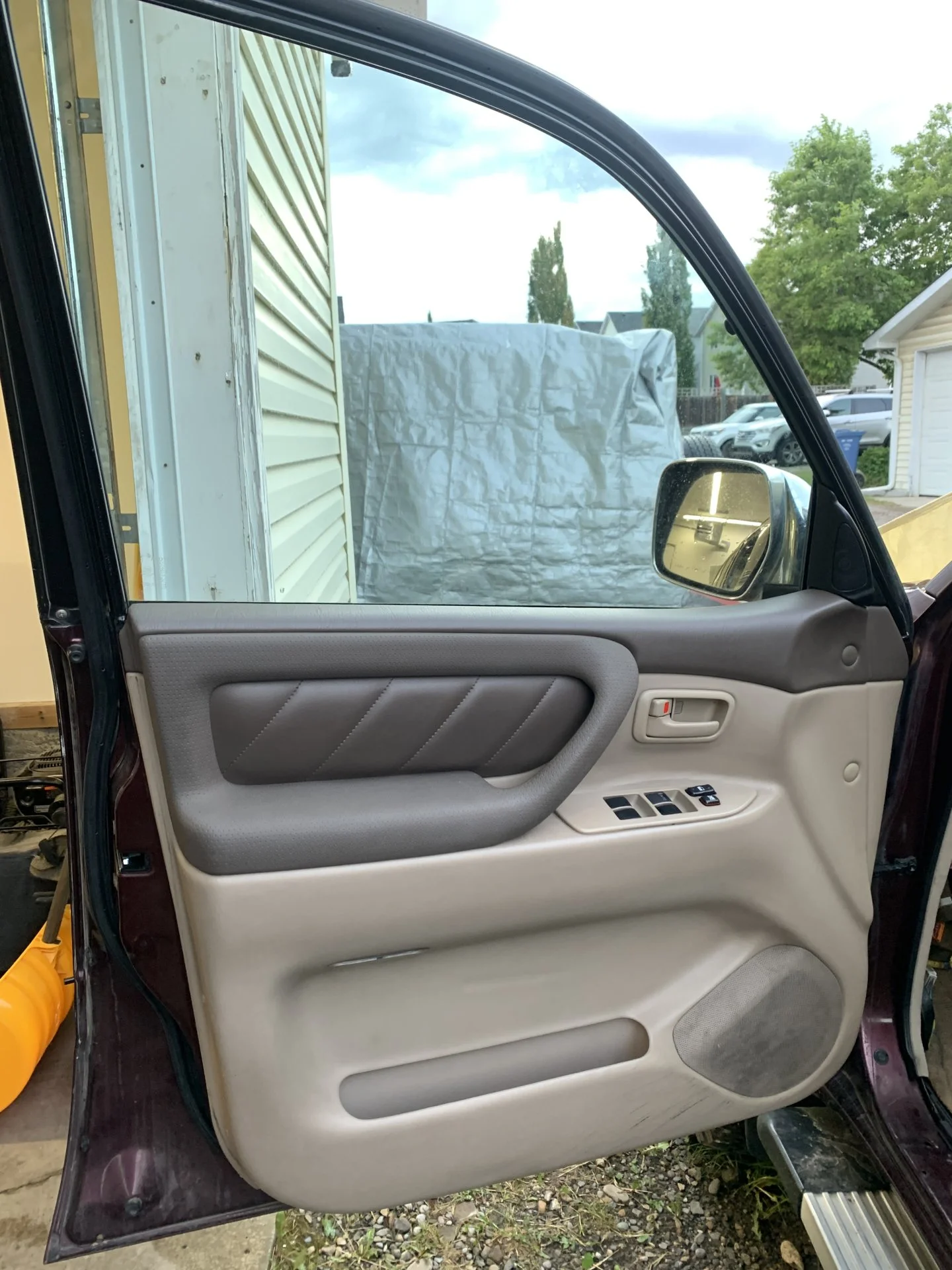

Along with my commitment to "while i'm in there", I took out the entire interior. All the FZJ100 stuff was basically shot, so I've been retrofitting a full interior from a minty HDJ101 and man it's starting to look very very sharp. The door cards are a preview for things to come. :)
Installed minty door card and replaced the window motor, regulator and the door seals.
Making lots of progress... Interior is mostly back together, minus the dash. I'm thinking the dash will be the last step, after motor is installed so I can make sure all the wiring works out.

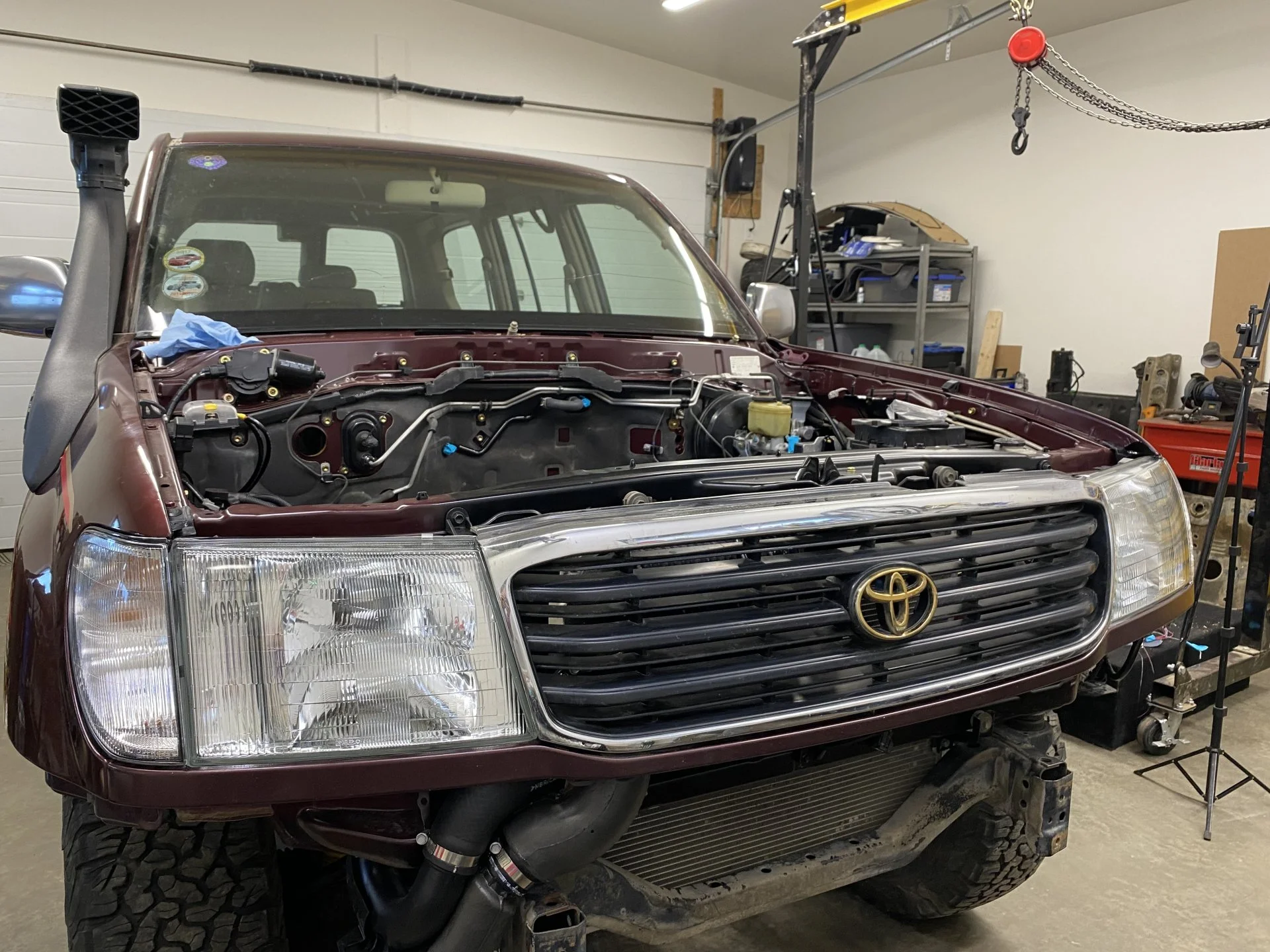

Front end is looking awesome. Got overseas spec DEPO's and OEM clear lenses. Also test fit everything in the engine bay. Man it's looking awesome.
