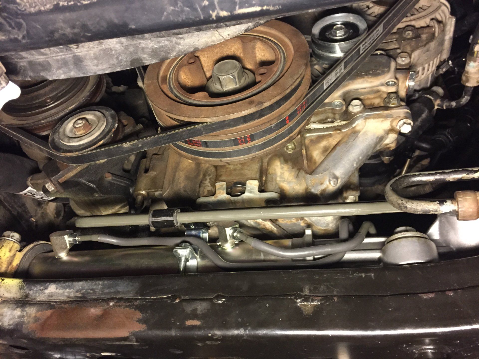

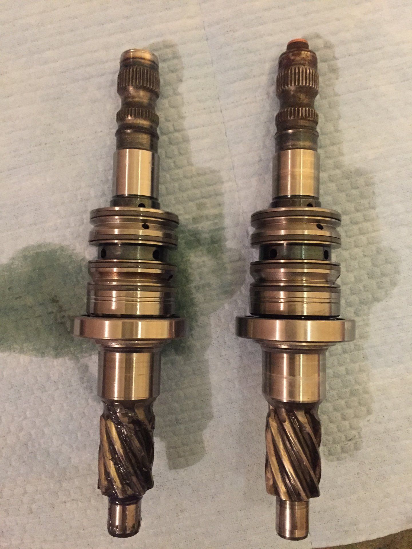

I got a new steering rack that's meant to go into a US spec. There are two different steering racks for 100 series, 44250-60050 and 44250-60060. Looking at the EPC, the ONLY difference between the two assemblies is the valve part #. So, I removed it from the new one and the old one to compare. Aside from the connection at the top (which is cross compatible) they look identical. Maybe the torsion bar is different between the two?? The one on the left is meant for the 2UZ models, the one on the right is for the inline 6, 1FZ/1HD IFS models.
NOTE that removing these is a huge PITA. I regretted it the whole time. I now understand why people don't rebuild these themselves. You need a very specialized tool to remove the nut that holds the valve in place. You also need a 0-30 in-lb torque wrench to set the pre-load properly and a fitting to use it. Took me a while to get it all back together properly. Without these tools, don't even try rebuilding these. I had to make my own...

I too have an HD-T just to be clear you are running a 44260-60050 steering rack?
Please tell me it’s so. The 1HD model steering rack cost a fortune ☹
Yes I am running 44250-60050. HOWEVER. I am getting weird steering wheel feedback in 4th gear at 50 km/hr but only when I turn the wheel and ONLY when at speed. It's very weird. I get no noise but it feels like air or something... and my PS reservoir looks wet. I am not sure if its an incorrect install on my part since I filled it from empty or if the 60050 rack is incompatible with the pump. I'm leaning towards install as the rack is essentially identical. If you do go with 60050 please let me know what your results are! And yeah, the cost was more than double for the 60060 rack...

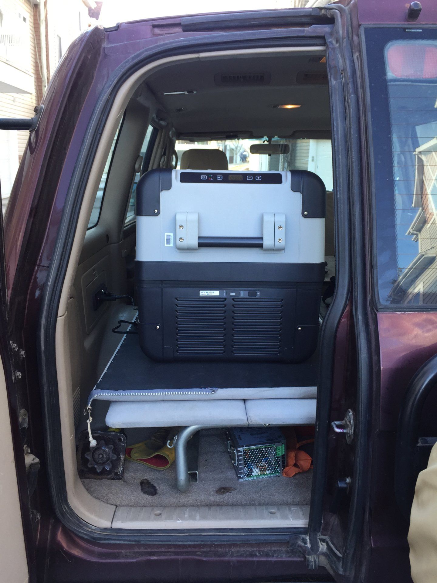

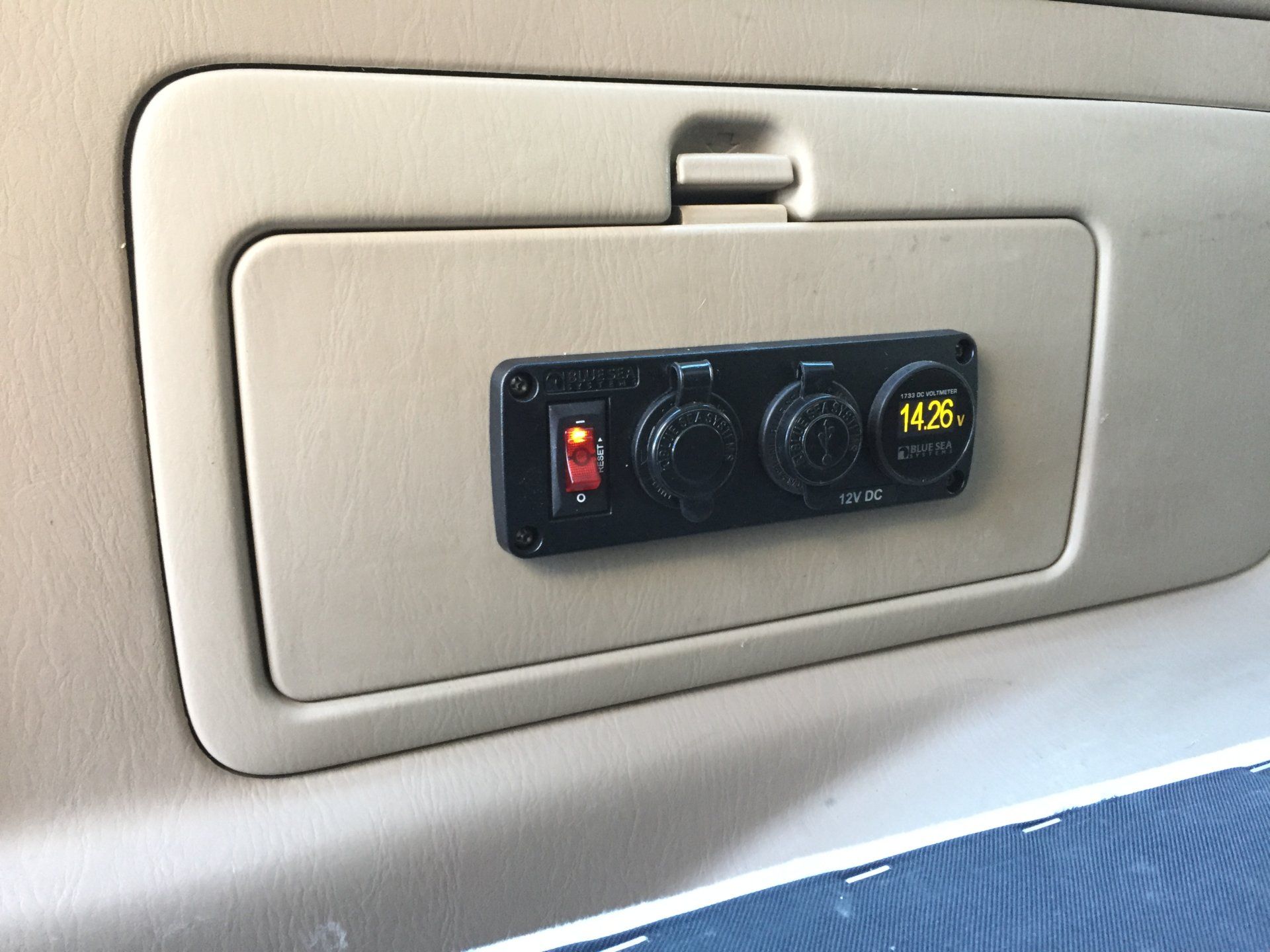

Big progress today! Finished up my dual battery and fuse block install. I now have a powered CB and 12V rear receptacle for my Dometic fridge. One bit of advice when doing this is keep the wire size big for the fridge. I got a huge voltage drop when the fridge kicked in with 18 gauge wires, so we re ran with 14 gauge and it made a huge difference! My cousin did most of the electrical work and it looks wicked.
This Blue Sea receptacle is a great little unit. This one has the 12 V plug, USB and voltmeter option which should work great for my camping trips. I opted to install it on the storage cover in the case I wanted to move it elsewhere as I would only need to replace the cover instead of the entire quarter panel trim piece.
And I finally get to use my 50 quart Dometic fridge! This thing is huge, I don’t think I could have sprung for the larger units.... especially the 65, it would have been WAY too tall.

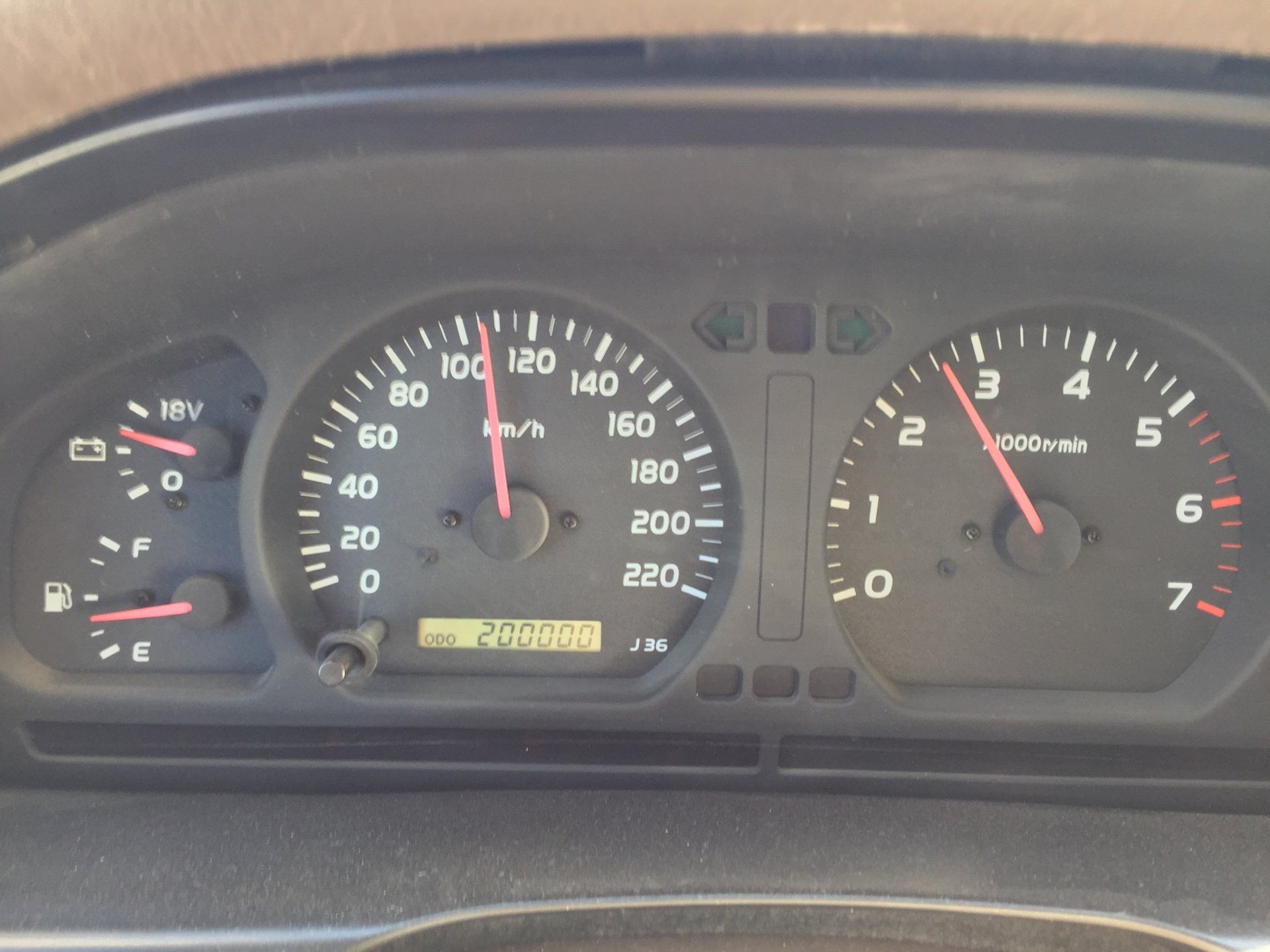

The 100 crossed over 200,000 km driving back into Salt Lake City!
