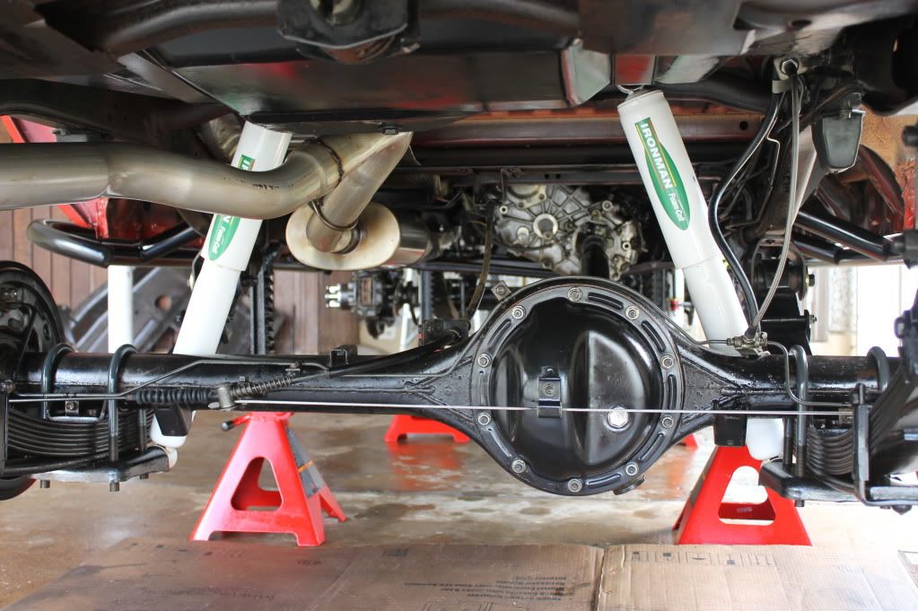

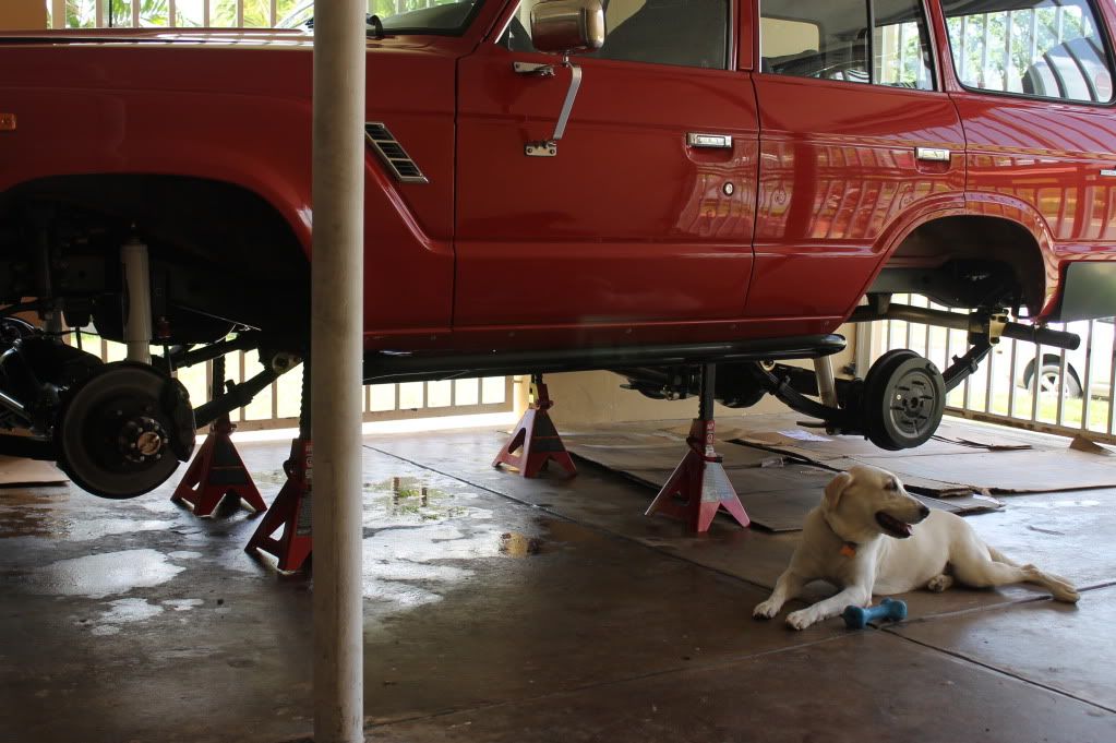

Day 1. Remove under armor. Pressure wash the underside and let it dry overnight.

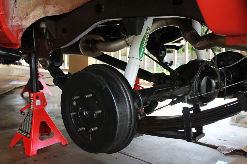

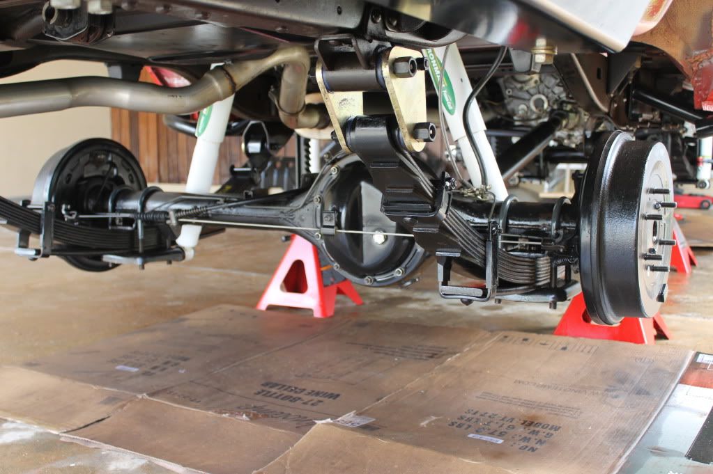

Day 2. Jack up the truck and place it in jack stands. Spray the underside with the mixture and let it drip overnight.
Day 3. Rag dry the excess mixture and pressure wash the mess in the garage...

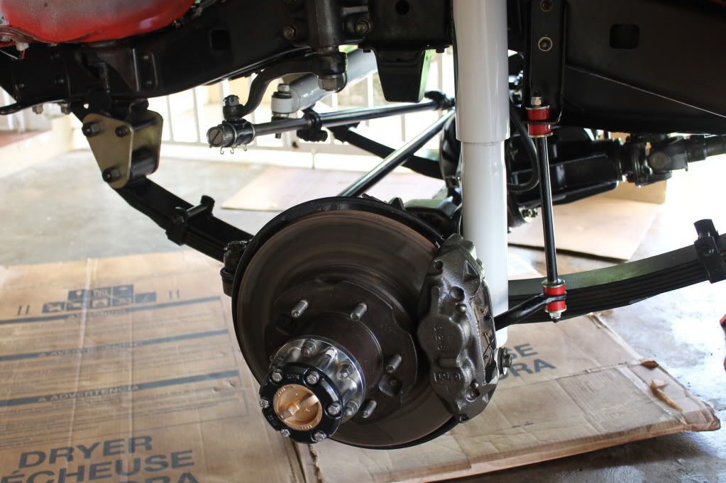

Some pics from Day 3.

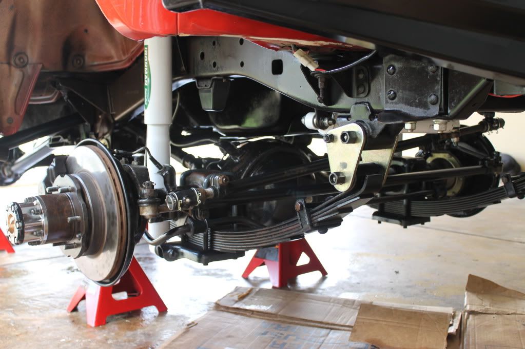

Had to fabricate new sway bar links. Somehow I managed to crush the driver side one. Refreshed the sway bar with new axle bushings as well.

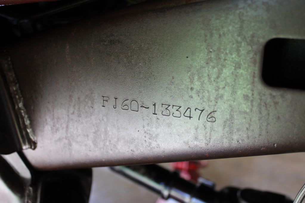

Look what a nice little detail I found at the chassis...
That detail gets checked every year overhere and yesterday the technical road licence guy looked at the thick layer of grease I put in/on/over the number and he said "I remember this from last year" :D

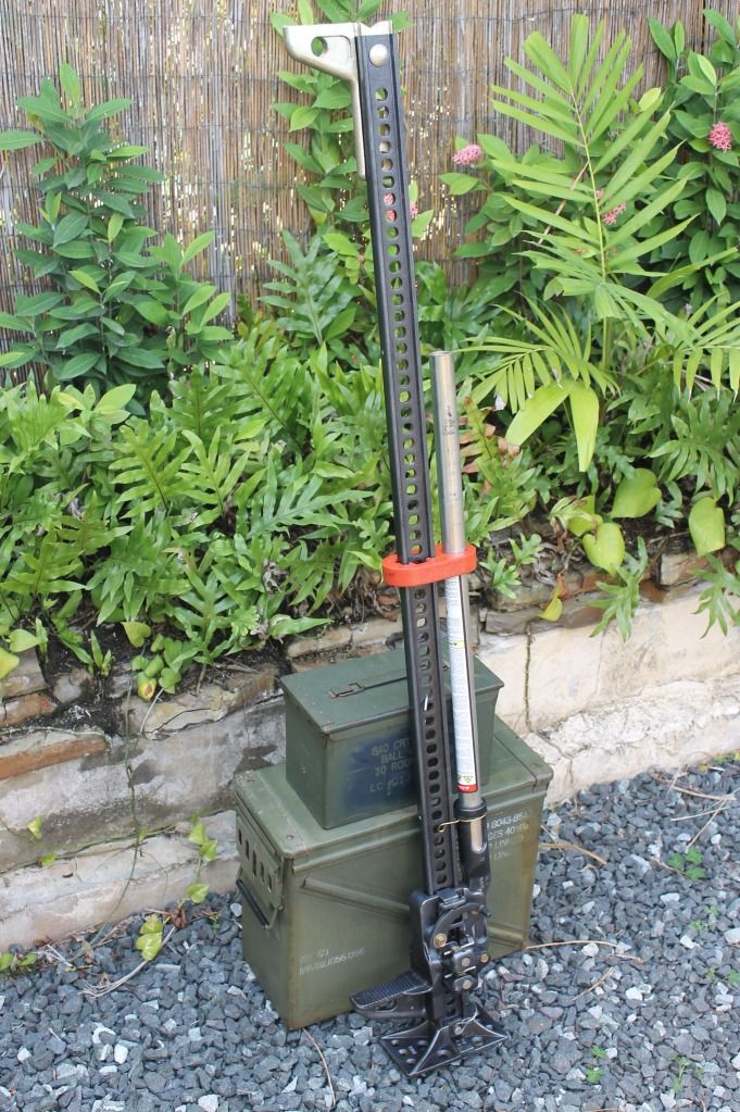

Today cleaned, inspected, lubricated and reorganized my Recovery Kit and want to share some shots with you guys.
This is it, a Hi-Lift Xtreme and 2 ammo cans.

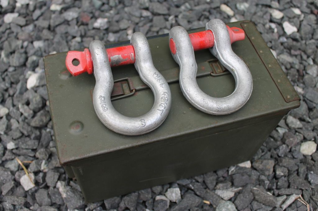

2 shackles that usually ride in the rear bumper. Will get another one soon.

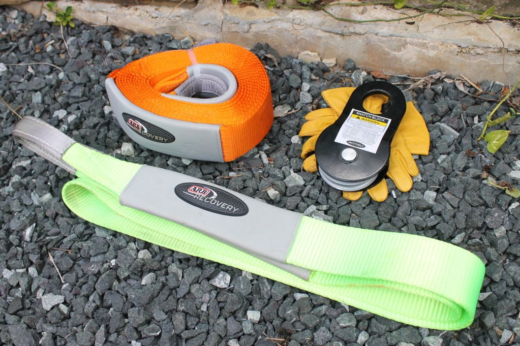

ARB Snatch Strap and Tree Trunk Protector. Smittybilt Snatch Block and horse hide construction gloves.

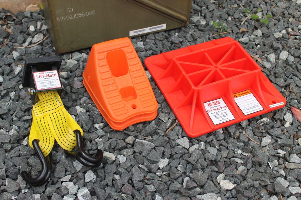

Hi-Lift Base, Lift-Mate and wheel choks.

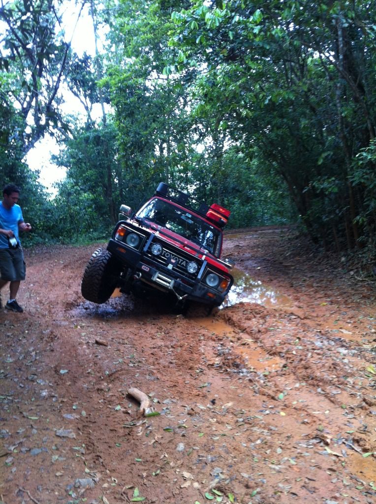

Tac, Just wondering how did you manage to miss the entire right side of the road and ended up in the hole.LOL Still nice to see that your putting it to work and stretching those springs.any damage at all?:D

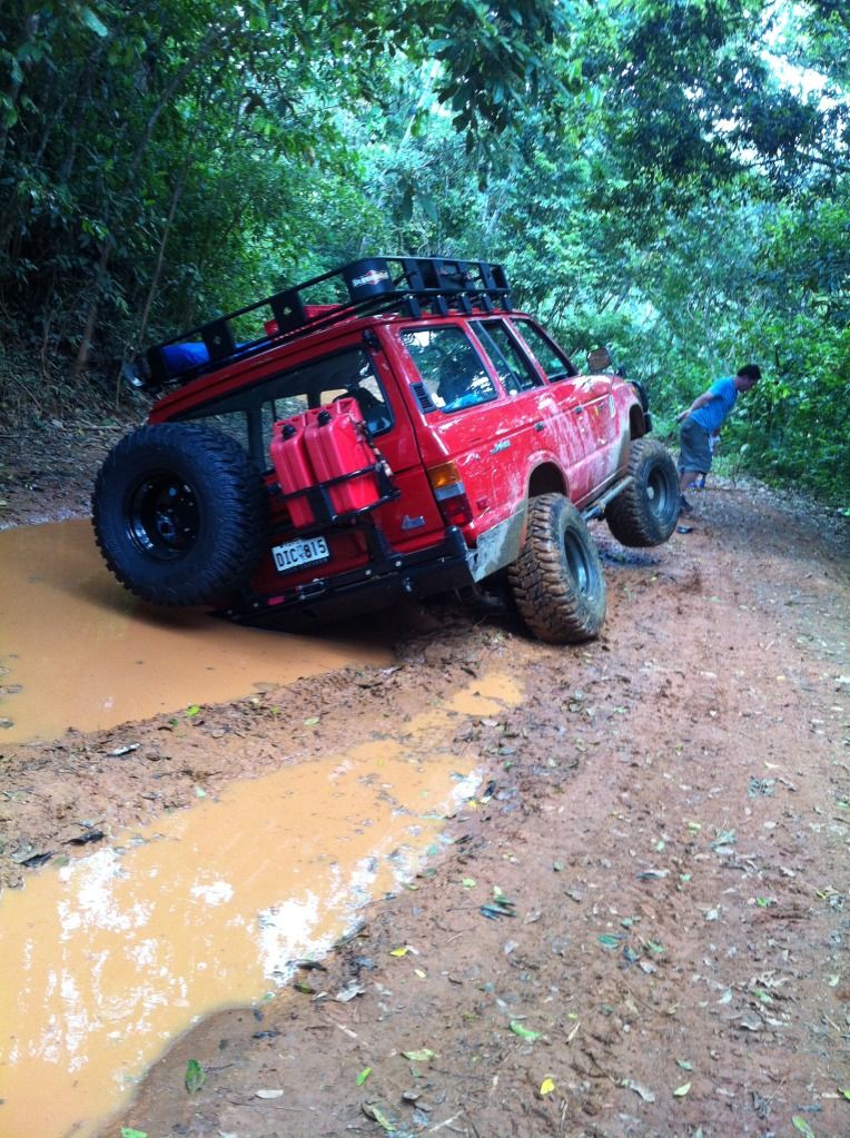

I did skip the hole using the right side of the road.

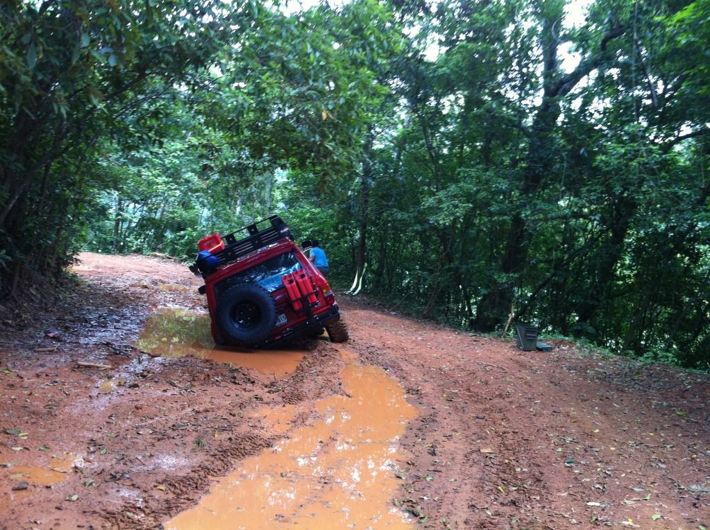

In fact this was stupidity at its best...
A few yards ahead the trail was blocked with a mud slide. I was alone (just 1 vehicle) and was running short of time to make a 3hr ride back to my home. So I decided it was time to return. When I was backing in reverse looking for a good place to turn I got trapped in this mud hole.
The only damage to the vehicle was a blown reverse light bulb due to the fact the rear light fixture and the side marker light got drownwed in water for a while. Easily fixed with less than a $1.00 :)
Glad to hear that everything is ok,i think we all have made some sort of stupid mistakes in our past.keep us posted on your adventures.
