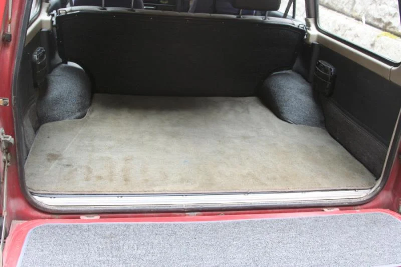

What you see in the pics is not what I got 2 months ago. I restored the front grille, all lights and light bezels. Throughly cleaned the engine and disassembled the interiors (including dash). The carpet and gunk (under the carpet) removal/clean was 3 days of work!
Installed a new antenna, rear door shocks and Bronco rear view mirrors. New radiator was also installed.
I used a diamond pattern plastic for the cargo area and back seat. I got it at American Plastics and Fabrics. Used 3 yds @ $21.00 each. Also sanded and painted the back seat moldure.
Installed a center console from Cool Cruisers.
I have spent about $100 just in screws :eek:
Window crank handles are aluminum and to be honest, way superior to OEM. Got them at eBay. I covered the speaker and power window switch holes with .08 kydex.
