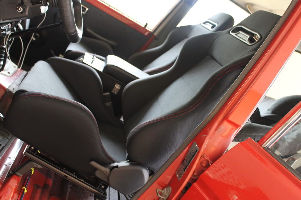

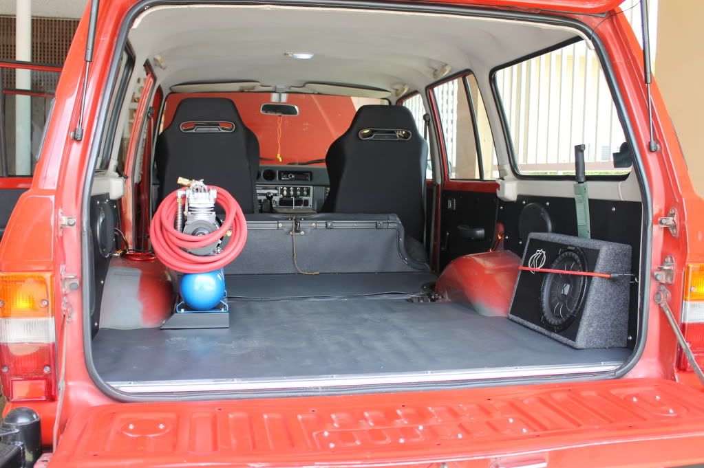

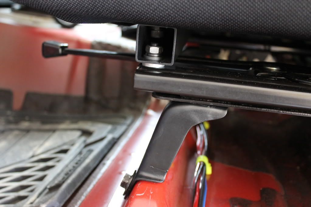

New NG-R bucket seats (RECARO knock off). I’m impressed with the quality and comfort so far. To be honest, any new seat is gonna be a huge improvement over the shot OEM seats and these seats have good reviews in the import/compact forums.
Made new adapter bases for the seats using 1.25” square tube, grade 8 hardware and the OEM slider brackets (used same seat holes as well).

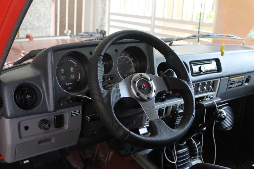

After the seats install, noticed the OEM 16” steering wheel was too close to my legs specially when getting out of the truck. So I placed a visit (again) to my local racing shop and picked up this Tenzo Turismo 350mm (13.75”) steering wheel (MOMO knock off). Again, I’m impressed with the quality and comfort so far. Used a MOMO 7713 hub (adapter).
The Tenzo horn button WAS NOT compatible with the MOMO hub, so I decided its time for a custom horn push button…
Actually a marine (stainless) momentary push button and a piece of kydex.

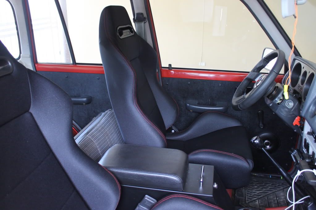

Couple of pics of the driver seat and steering wheel relation. Pretty comfortable ride if you ask me.

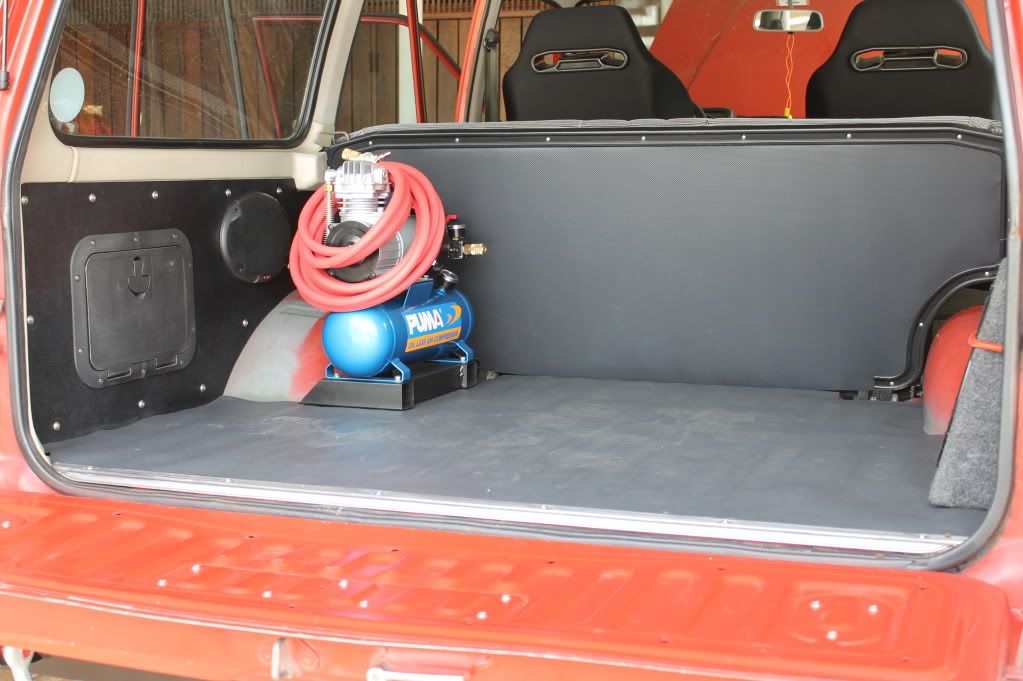

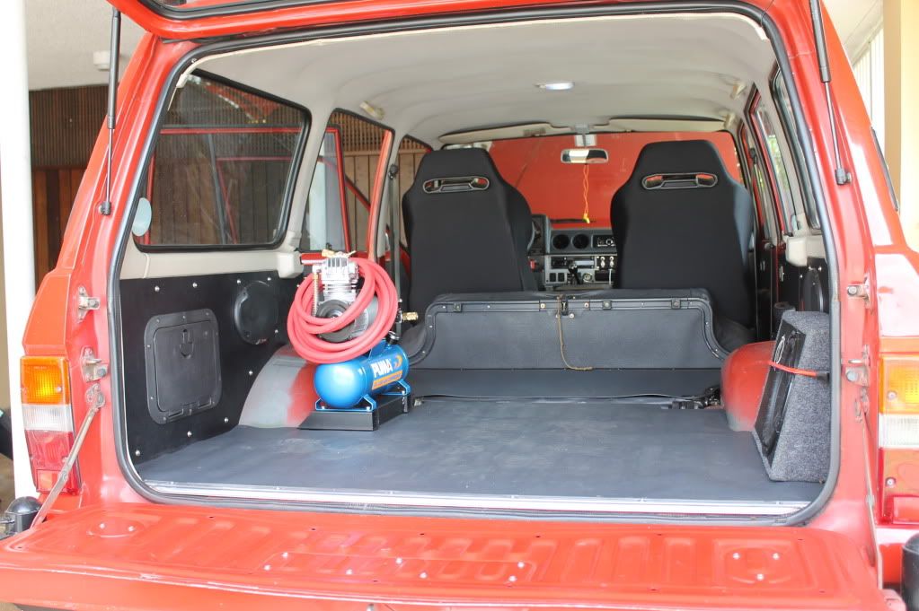

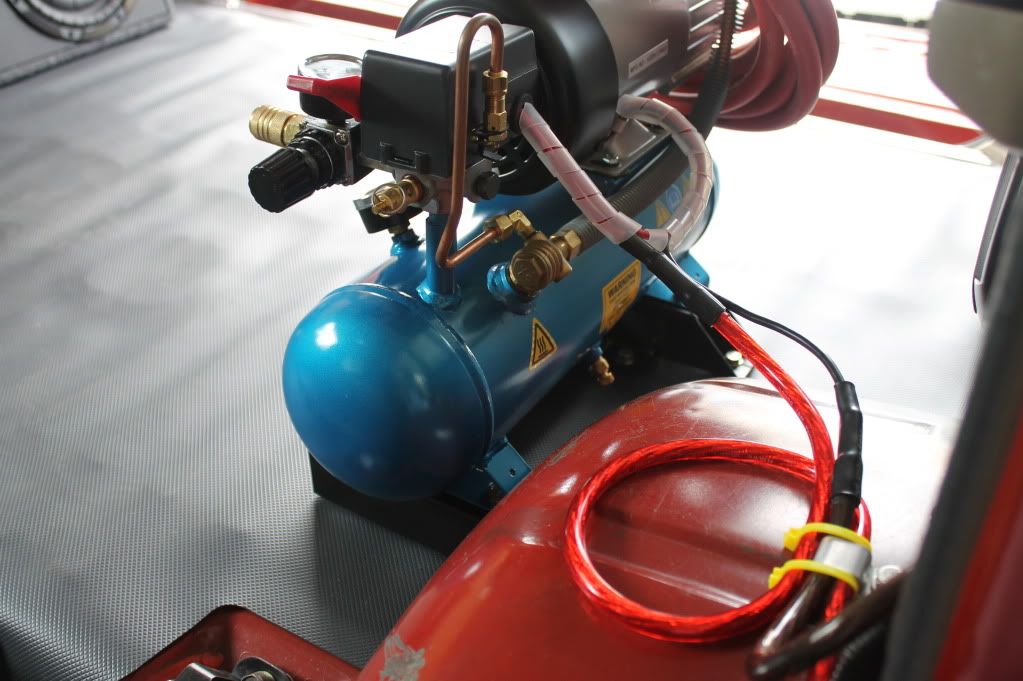

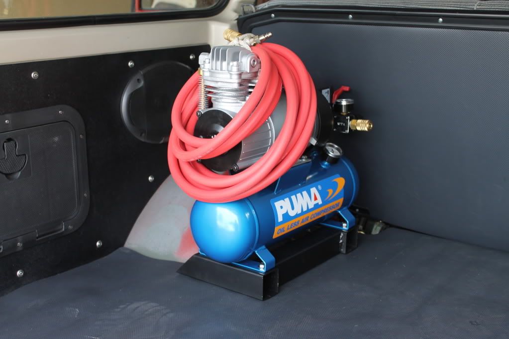

Father’s Day present: PUMA 12V Air Compressor. Not tiny and definetly not light, but the little bastard can PUMP!
Cargo Area- back seat up
Cargo Area- back seat down

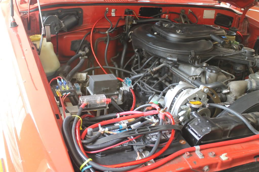

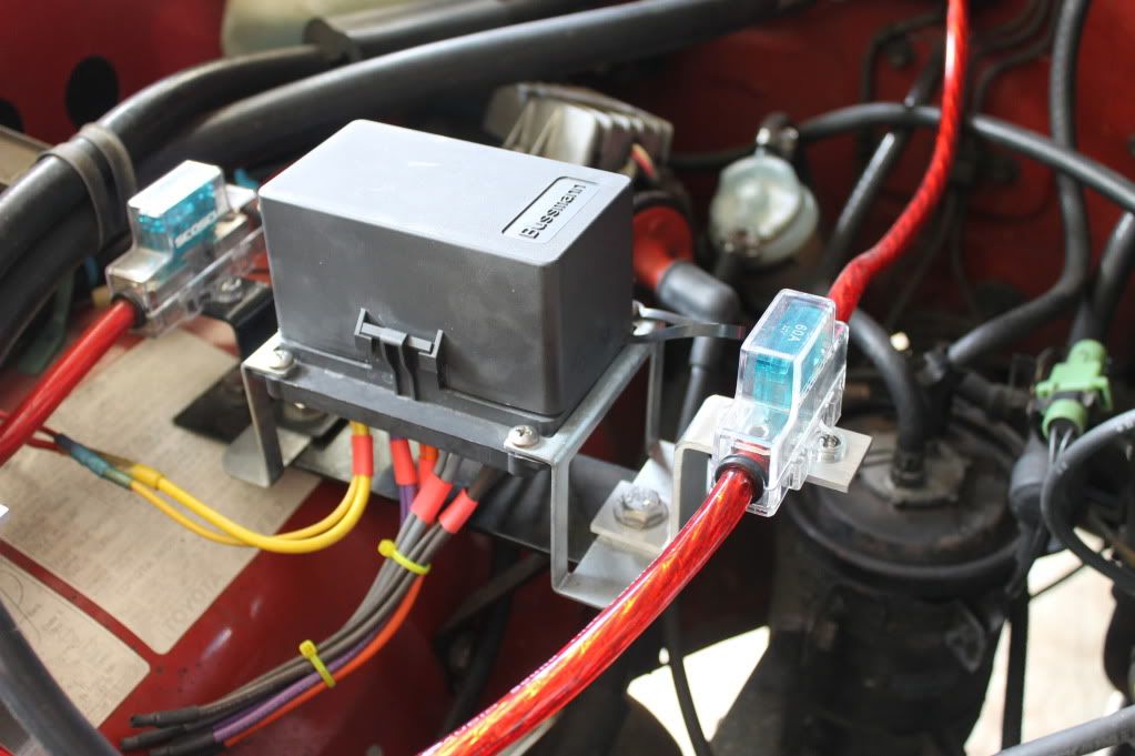

For the connection used 4ga cable and a 60amp maxifuse. Grounded to chassis.
Added the fuse holder on the right (alum branch) for the PUMA compressor.
Hands down the best off the shelf 12volt compressor out there. No affiliation, just very impressed and satisfied customer.
Oh, nice build too TacDoc. My Puma resides on the right side of my cargo area.
How's the cabin temps with no carpet, can you feel it on your legs?
It gets hot near the exhaust tube, more noticeable on long trips.

I like those seats. I don't know how you get in there over those bolsters though haha.
I've never heard of those compressors before. I'll need to check them out.

I've read that Puma is making all the compressor pumps for the "better quality" Chinese compressors...
