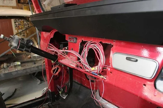

Allright...got an email from Don (wiring guy) tonight....he found alot of issues that would have had to been traced down...so at this point he has torn out all of my wiring and is starting over...Im driving down there before work tmrow to just go over it all and make sure the goal is understood. Will take a bunch of photos and post them up tmrow night if I have time.

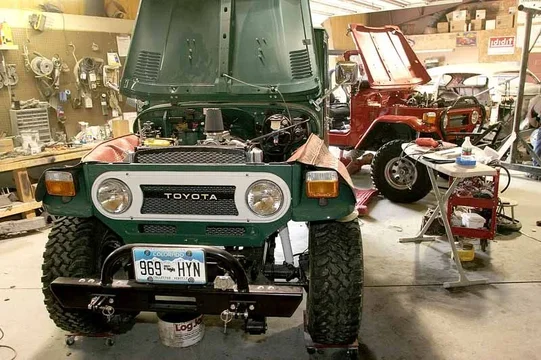

The green cruiser is a off body that the shop was just finishing up...very very clean. First cruiser that has had a "new car smell"
Mine is the red one in the background
