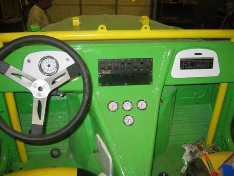

Jeff, I actually plan on taking out the axles and current suspension and doing the SOA here in the next few weeks..I cant stand driving it now because untill im above 50MPH its super super stiff. In the mean time I am revamping (cutting out all the extra) wiring, installing the TBI, and cleaning everything up...I also think im going to design a custom tranny cover that comes up higher and has room for a cdplayer, and the ECU for my projection
Something similar to Jeremia's rig...but it wont come up high enough to meet up with the dash, and wont have the sides box up under the dash.... newt1.webp
