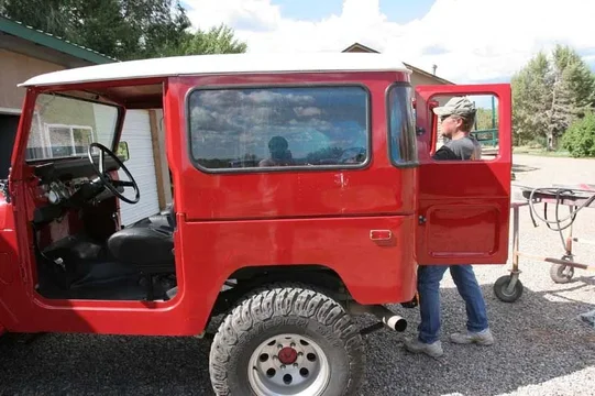

Some photos taken during the hardtop mounting and fittment

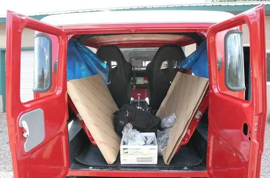

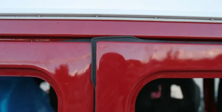

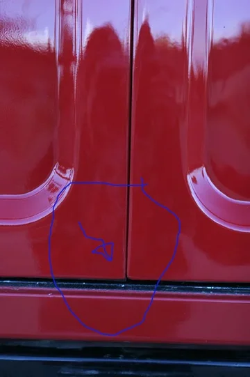

These photos give an idea about the fit of the ambi doors...
First photo- the bottom of the doors are a bit too close, and the only inconsistancy in the lines...When I drilled the holes for the bottom latches I drilled them a bit larger than they needed to be so that I could have a bit of angle play, I should be able to just pull both doors out a bit on the bottom and fix that issue.

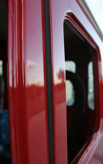

Second photo- The OEM seals....I have never seen anyone with stock seals that had this tab on the top of the ambi doors???? Is that supposed to be cut off?

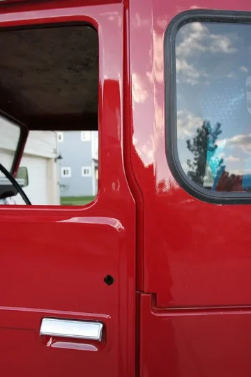

Third photo- I am missing the bottom latch that holds both doors at an even position I believe that is why there is a forward gap....when the seals were off they lined up perfectly because there was no resistance....

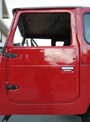

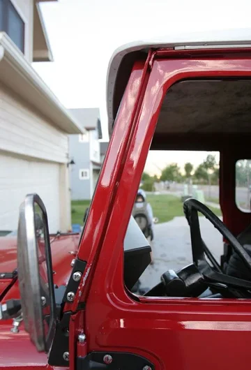

Now to the front door issue:

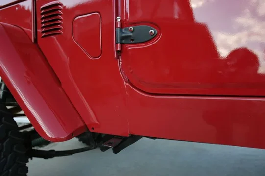

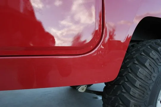

first photo shows that the bottom and sides are now clearing fine and appear to be even (critique). Im not sure how much space they shoud have, so clue me in if that is wrong.
second photo- shows the bottom gap after being raised so it can clear the top of the tub.
third photo- same idea as secod

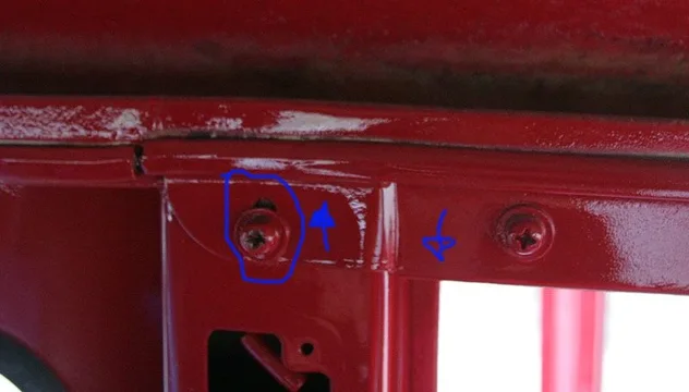

ok so I think this is why I have the gap at the top (still big enough to see through when sitting inside. The way I figure is this: since my lines on the bottom and sides are even, and the front of the top is right, I think my problem in this photo where that adustment is as high as it can go (this is where the accident happend where it was all bent and the painter fixed it) I think if I undo that screw and pull down and tighten it will close the gap...hopefully a whole inch worth!
yesss
that is all for now...comments on fittment etc?
I am guessing it has to do with you alum tub not being on perfectly straight..... so it effects it when it lines up with the cowl????

ugh see looking at those photos, (just put on the weatherstripping) it looks like all of my lines are correct except the top back...Even with the weather stripping there is still a small (maybe a centimeter) gap at the top back..and that is on the PS where the gap is alot better than the DS. meh
Those Ambi doors look pretty good all painted up there Eli. And I'd say the fit looks pretty close.
wow...looking great!
No, it's supposed to be there.
The big gap on the top of the doors below should be filled by the stock rubber seals. It doesn't look like they're in there yet? It freaked me out too, but the rubber filled it (barely).
Are you talking about the stock rubber seals that are cemented to the doors? I just finished installing that today and dont have picks up..from the outside it doesnt look much diferent, but from the inside it seems to be filled (for the most part).

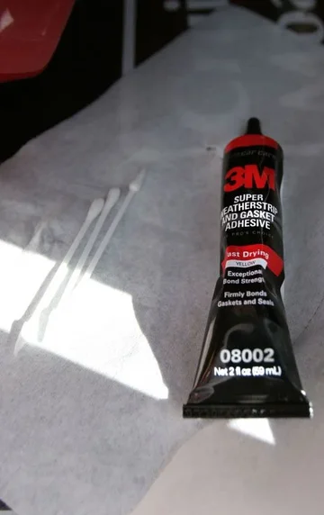

I spent a good half of they day playing with that damn gap at the top of the doors...after putting some thought into it, I drilled out the front door latches (slightly bigger than 1/2) so that I would have a bit more angle adjustment. This did help, slightly, but enough to make me say- aw puck it -and continue on to putting on the door seals. After securing the seals (reccomend 3M for that job....just be carefull because the yellow goop gets everywhere and doesnt come out!) I then began the task of measuring the latch placement and drilling and installing the latches...The doors latch and seal like a charm *cept for that small (maybe 1/4") hole at the top back*

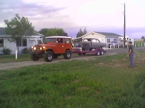

In the mean time this guy who has been helping me out was calling his buddys trying to find someone to use their truck to pick up his drag car that was just soda blasted (because it was looking like it might rain) I suddenly remembered that I had a hitch on the back of the 40...so we loaded up the trialer (20') and went to go get his car. On the way there we noticed that not once did it missfire, burp, or lose any power...just glided along smooth as can be. Got his car and drove back...expecting it to just be a fluke on the drive down...but allas, same thing.
