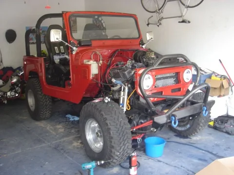

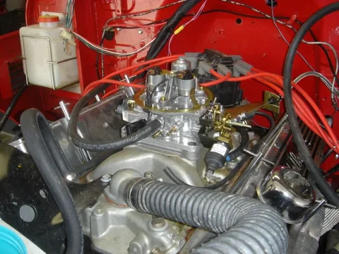

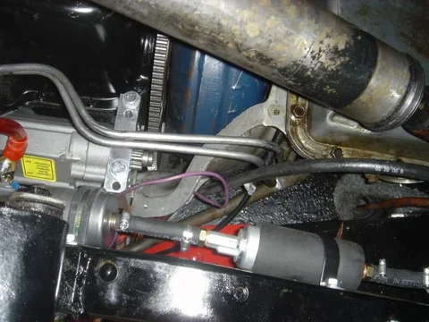

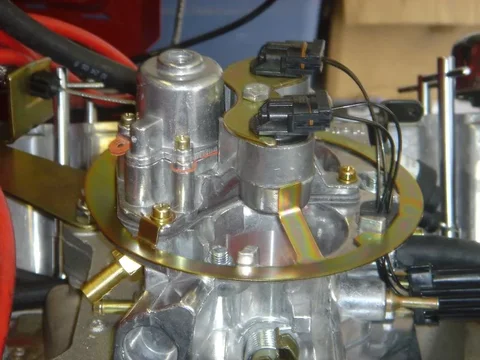

Took me forever to get these up...but here are some photos ... as she sits with the TBI setup. I had to reseal the intake manifold...which wasnt as bad as I was expecting... Tonight will retime it and hopefully find that the vaccume leak is gone!:rolleyes:
photo1; bending hardline for TBI return line
photo2; just chilln there
photo3; closeup of throttle body
