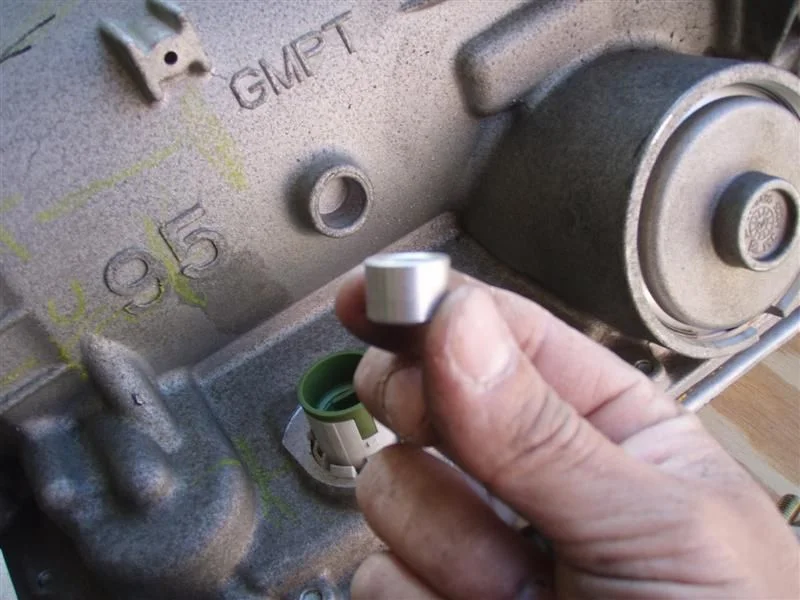

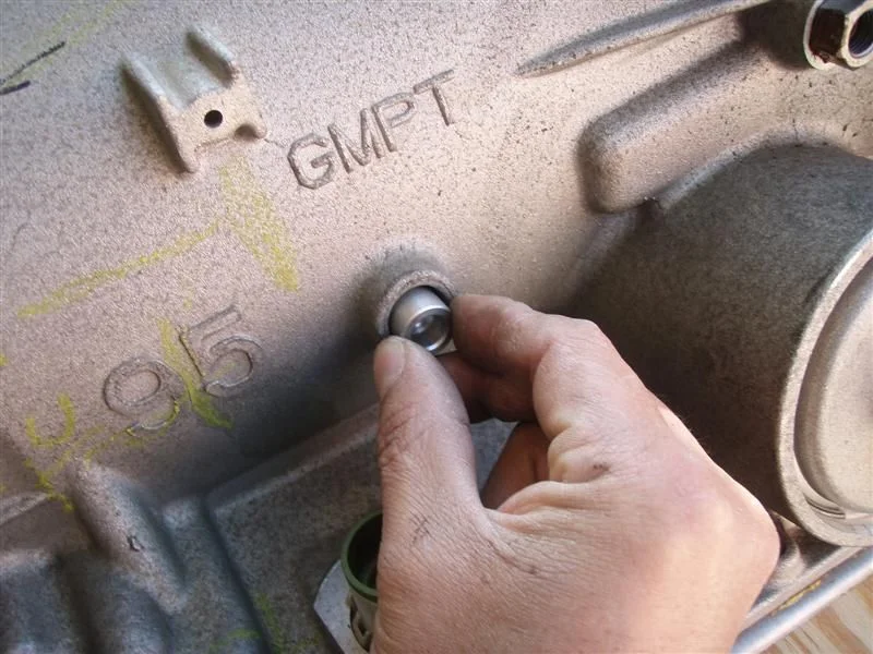

Randy, do you have a part number for the fitting that goes to the GM power steering pump? I got a kit from Downey but I dont think it will work... again I'll post pics to show what I got.
And re: the adapter I got from yah.....where does that thing go ? :confused:

The adapter you have from me goes to the rear of the block where the oil sender is. Screw the GM sender in the top, Screw the whole thing in snug then mark where you need to drill the hole for your toyota sender. After that you will have oill press. What I do on my hose is take the yota hose and the GM hose to a shop tell em how long and there ya go. If you don't have the reservoir hose get it at a junk yard anything 01 and up will fit. Great progress and keep at it.

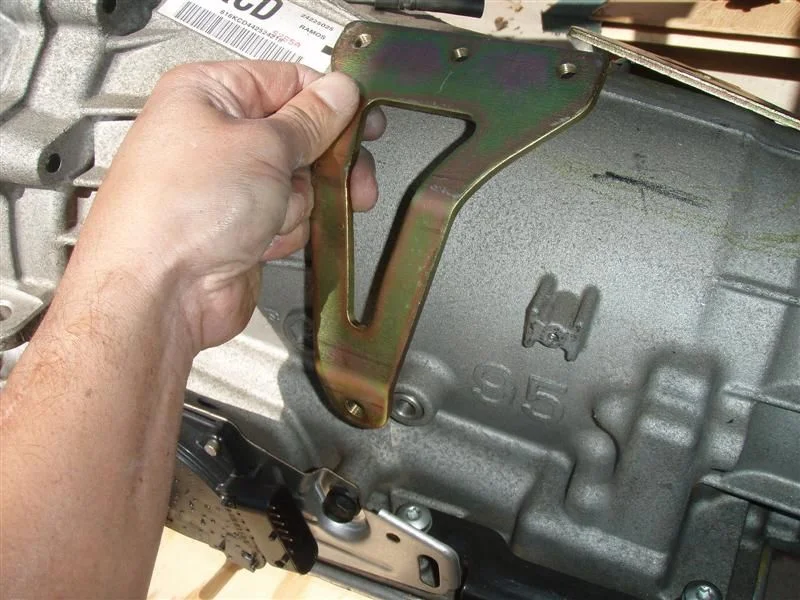

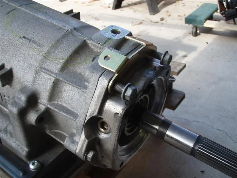

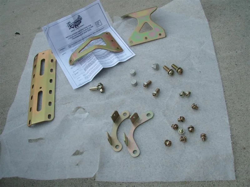

Ok guys.. not much progress but none the less here are some pixs...
Lokar shifter parts and vague instructions...

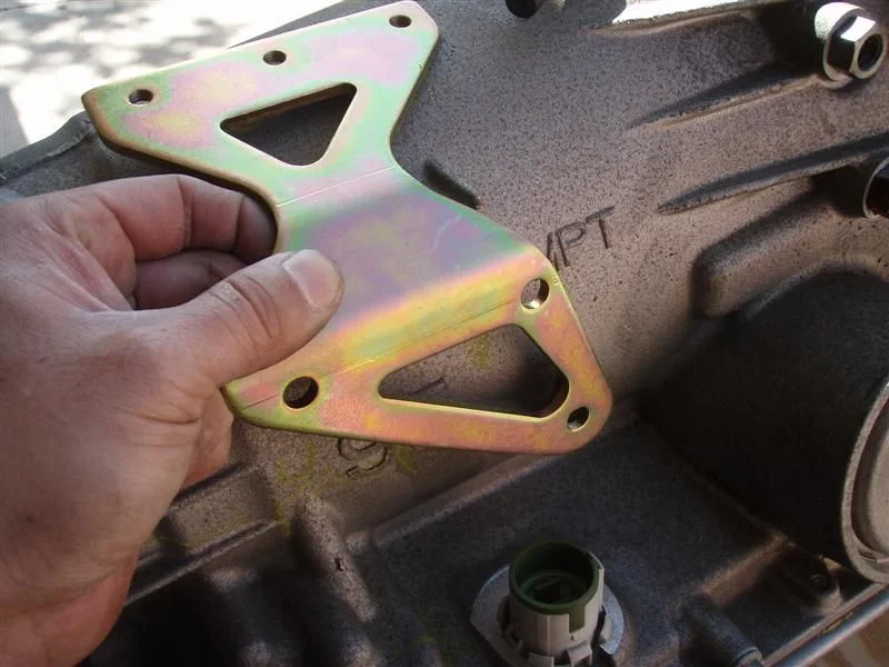

Rear bracket, had to pull the adapter out to install this little piece

Installing side brackets......

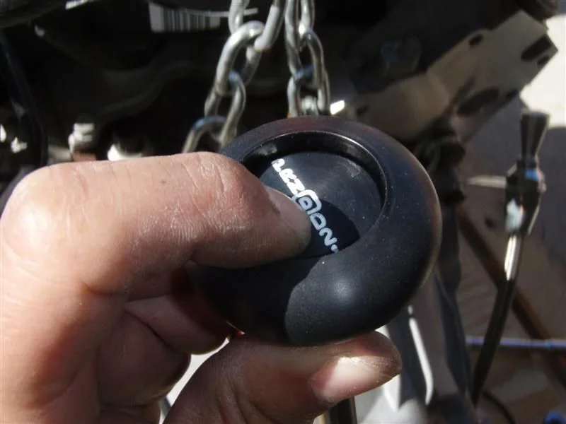

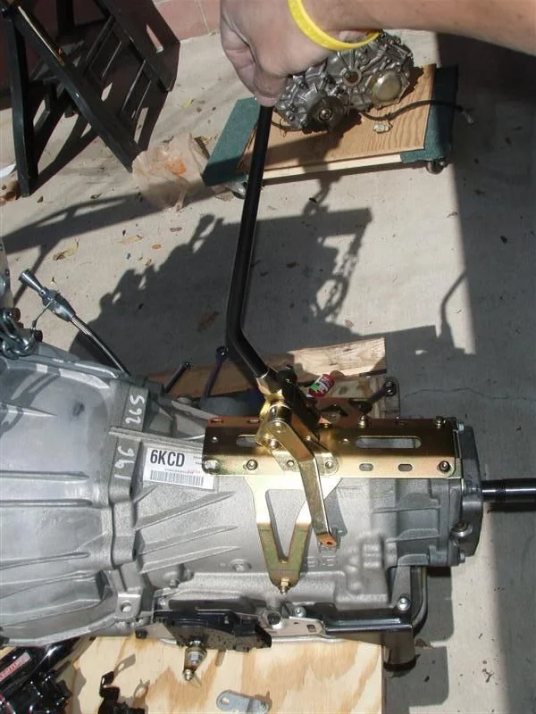

Trial fit on the shifter and I really like this feature on the knob.
Push to shift... I might get the shifter knob adapter later on and use a toyota shifter knob.

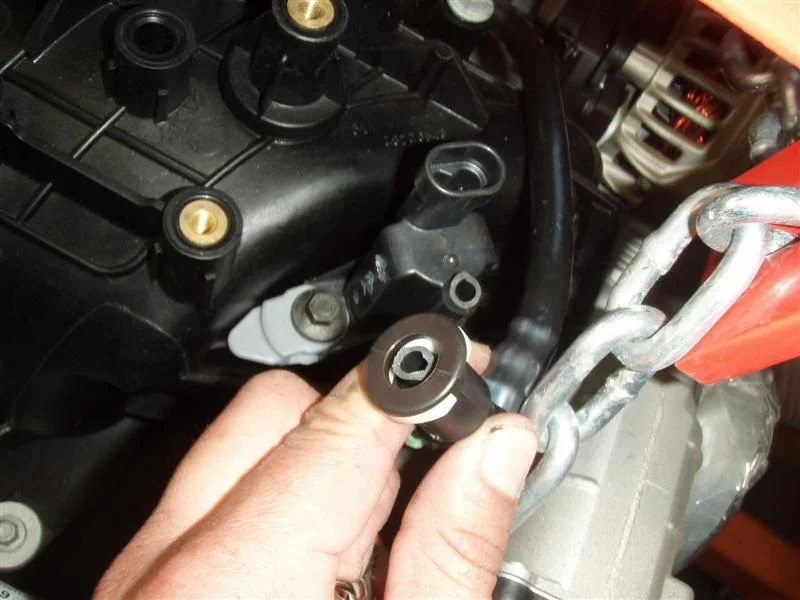

I broke the purge/vent connection and now I gotta find a replacement ( wohoo:mad: )
