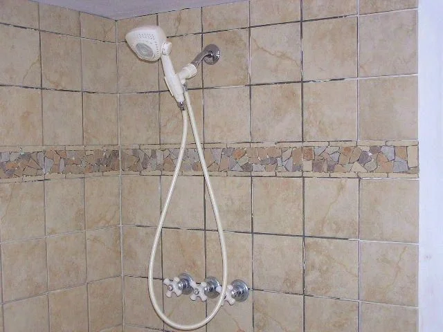

Frank has been helping me tile my bathroom the last few weekends. I am going over there on Saturday to finish up his trans mount and finish up the other welding. If your not working Shane you should come out there with me. Once the mounts are all done he just need to wire and plumb it. He is not that far from being done Just a few parts to collect and a bunch of finish work.
Dynosoar:zilla:
I will be grouting the shower on Sunday!
Dynosoar:zilla:
Sure. As long as it's in the earlier part of the afternoon (have to work at night on Sat.) and the warden lets me :D
