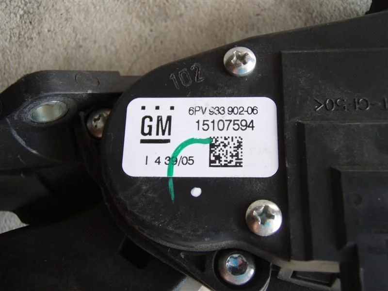

Peter any chance you can post a pic of your pedal with part number and what the connection plug looks like?

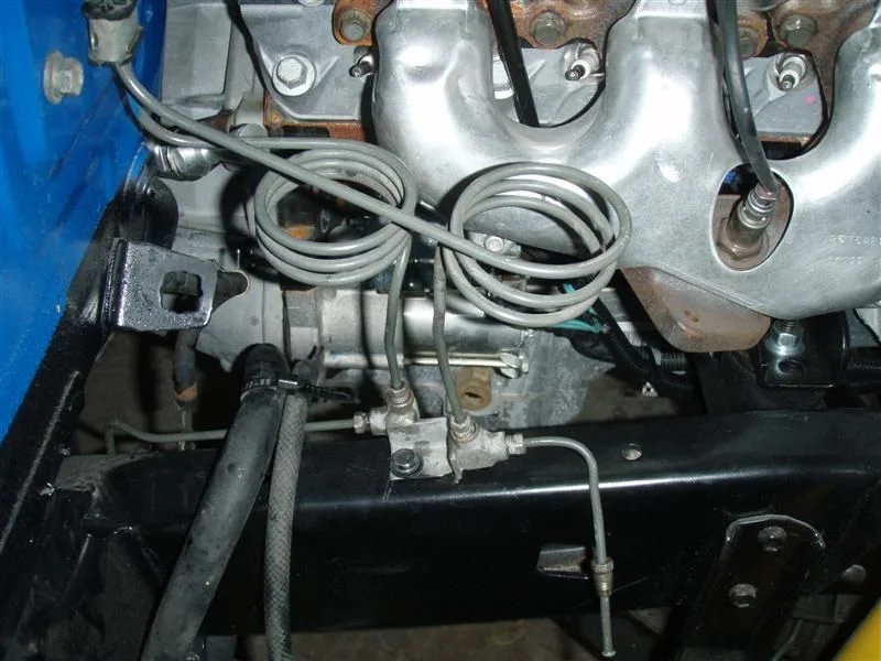

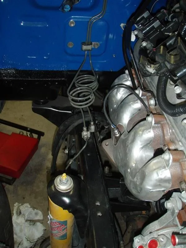

Moved the brake line a few inches back by cutting an "L" shape on the bracket and moving it back.. I'll bring the hard line in between the frame by drilling a hole through the frame.

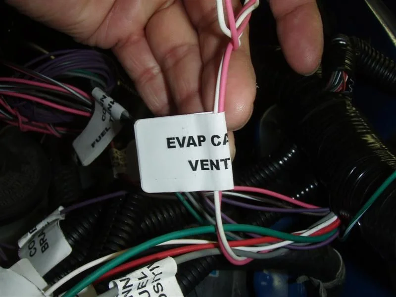

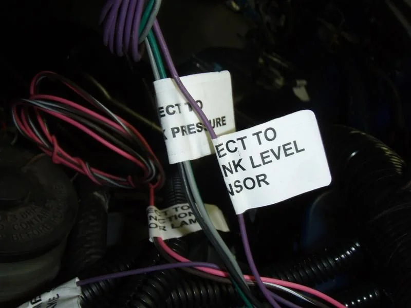

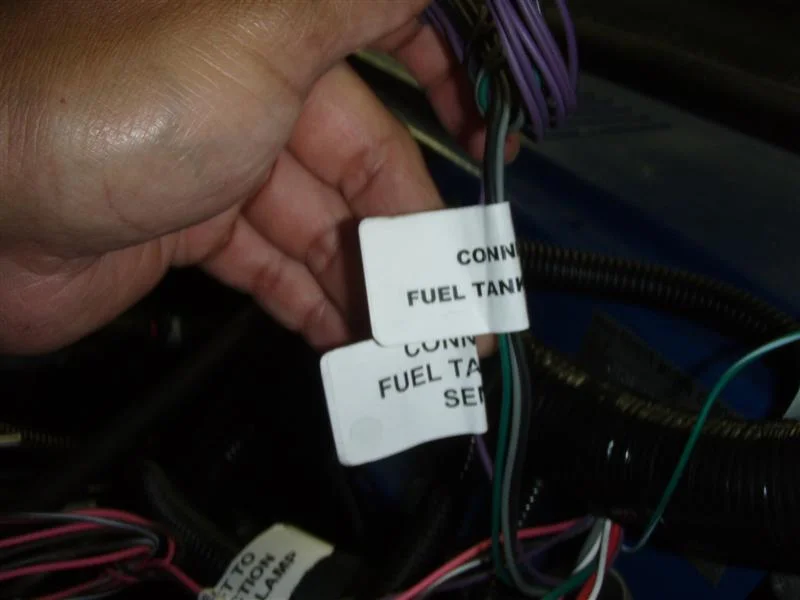

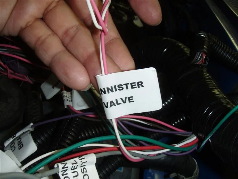

This reads connect to Evap Cannister Vent Valve
If I dont need any of these connections do I need the ECM reprogrammed or can I leave it the way it is without connecting any of these wires??

When you bought the TAC module did you also get the wire that comes with it.
I had Fuel Injections Specialities make me one but as you can see on the pics I posted the fittings are different.
After some e-mails with Jeff over at FIS, Im sending him the pedal so he can/could reference the connectors and determine what series connector the pedal takes.
Let me know, I rather give him the info than be mailing parts back and forth.

Edit: FIS in Tx is having no luck on finding connector information for this pedal and are suggesting buying a 2005 pedal for $100
What did Jeff say? Did he give you his PN#? Doesn't matter I have the picture you posted. If I can find you one what all do you need? Just the plug, the whole pedal, Etc. BTW my price would probably be a whole lot cheaper than yours. BTW I told you the pedal would be :banana: :banana:
Randy I dont have the PN#..... If you find the plug it would have to be for 2006. If you find the whole pedal it has to be the plug that FIS supplied.. yeah both are posted on this tread post 230 and 28...

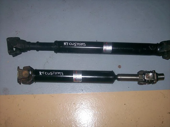

Randy..where did you get the adapter for the front drive shaft pictured below.. was it from Downey ??
attachment.php
Im definitely going to need it...
