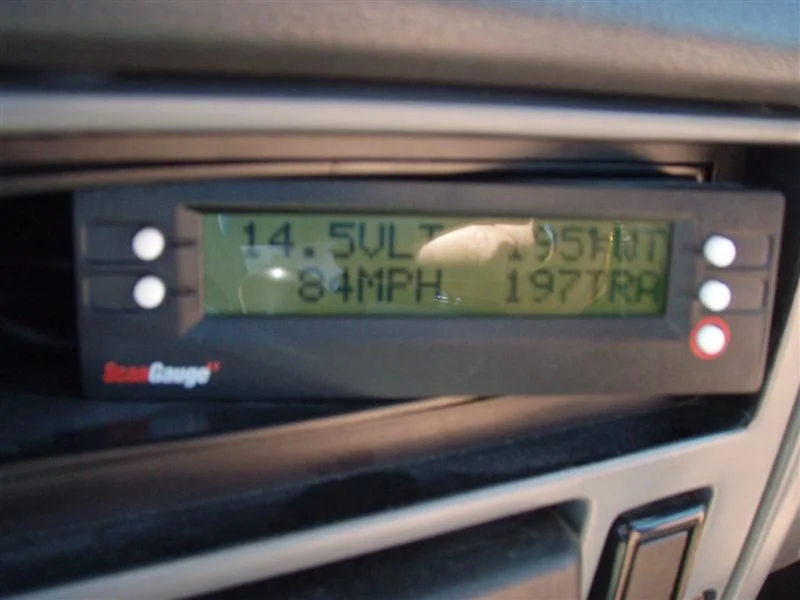

Here are some poser shots and scanner readings....

Obviously that reading is incorrect.....84mph in a cruiser?! :flipoff2:
